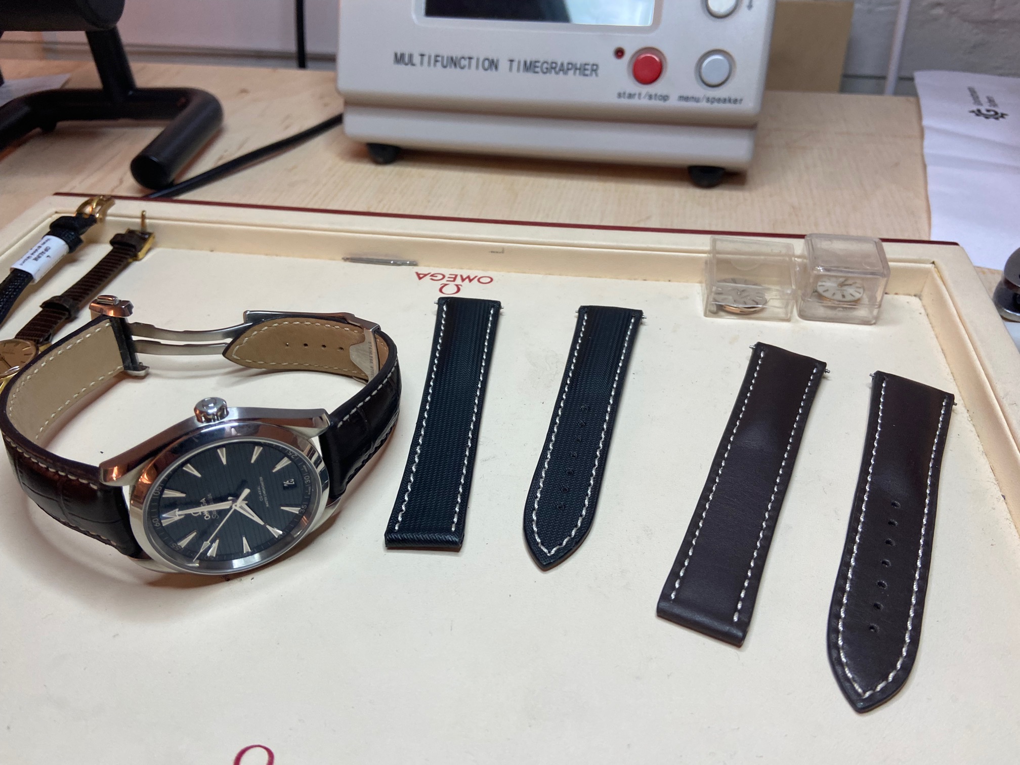

Since OEM straps are on a price level beyond all rationale and I'm not willing to support this twice a year (for me beeing a leather strap killer) I've found these here which fits the 18mm clasp perfectly and are of good quality for roughly 10% of the Omega straps in terms of pricing.
This is the crocodile style strap
BOB Marino Alligator Deployment Strap for Omega, 20-22 mm, 4 colors, new! | BOB | WACCEX WATCH ACCESSORIES
and the nytech
BOB Marino Nytech Deployment Strap for Omega, 20-22 mm, black, new! | BOB | WACCEX WATCH ACCESSORIES

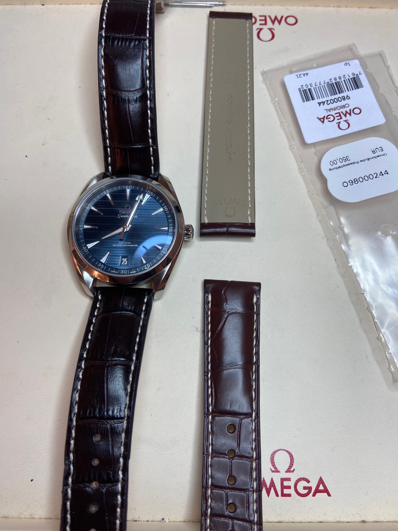

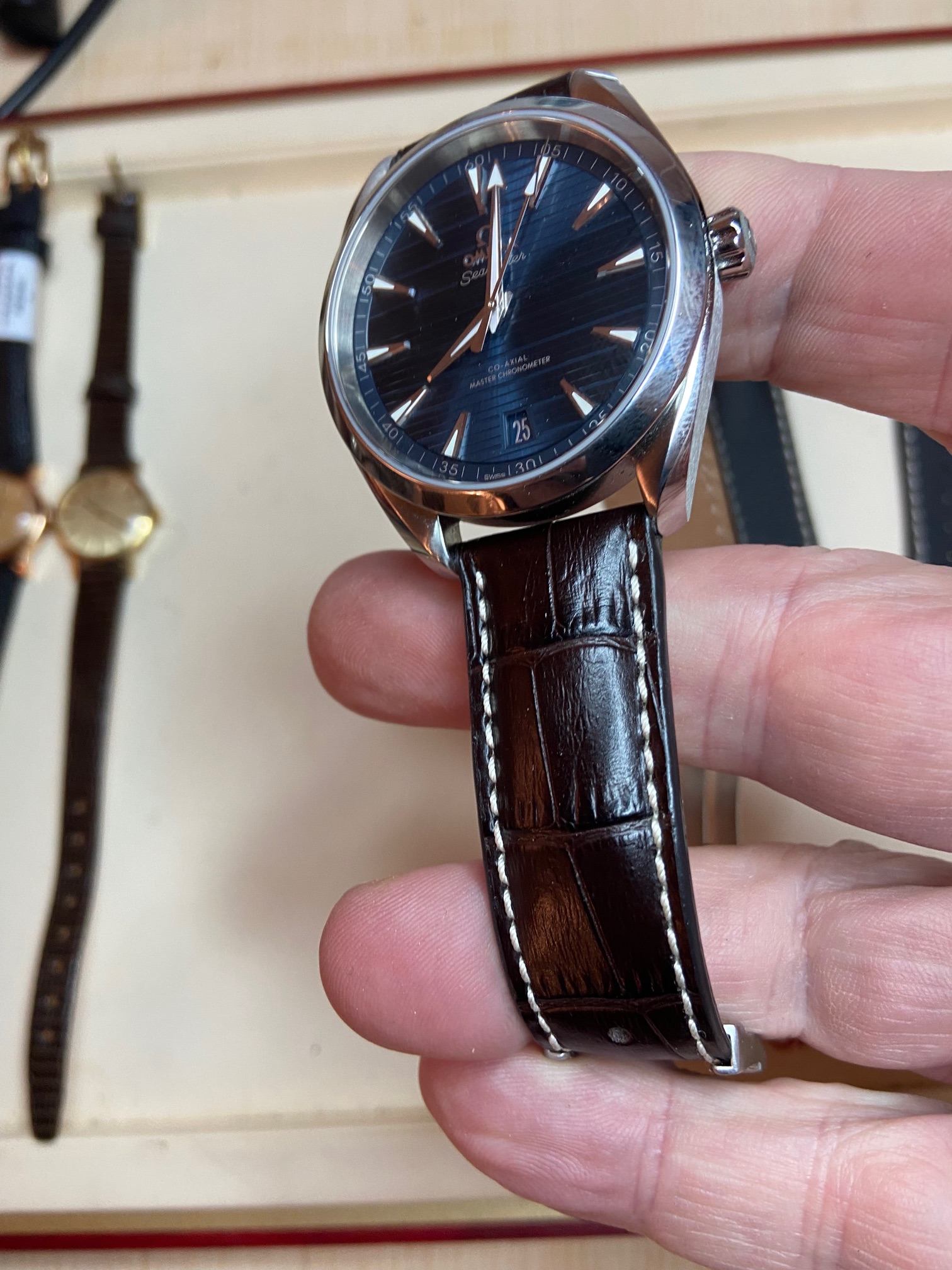

I've bought both with white stichting and it works pretty well. For comparison the AT on an original croco strap (ref. 98000244):
and here with a brown croco style BOB Band with the OEM Strap lying next:
