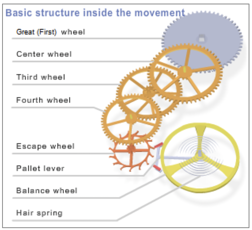

There are several different types of hacking mechanisms, but commonly, a lever stops the balance from moving. In that case, I don't see how the mainspring would continue to unwind because the oscillation of the balance regulates the rate of power loss.
18,730
38,879
As Dan indicated, once the escape wheel is stopped, all movement in the going train is static.

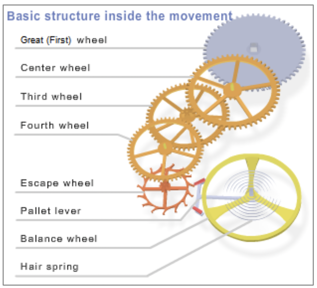

You are wrong. Once the balance is hacked, it no longer releases the escapement, and the wheel train can’t move, so the spring stops unwinding.
