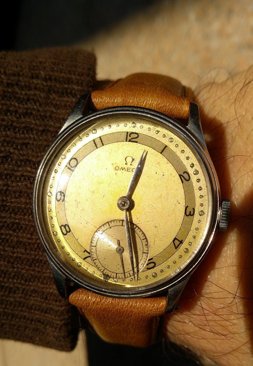

Dear Omega friends,
in a previous post I was looking for other ref. 2190 watches - like my new 30t2. Noone commented, so I think 2190 may be quite rare. Now I would like to ask what you think about the dial of my watch. It shows age/patina, but do you think it is authentic? Thank you in advance.

Dial and hands look OK to my eye, but let's politely ask forum expert @mac_omega for a review. He may know more about your 2190 case as well.

I only wish I had aged as well as that dial. It's original and stunning. Great watch.

Thank you, guys, for your help, I am happy to hear this. (But if someone has other opinion, please post it.) I love the genuine helpfulness of this forum and the immense amount of information one can find and learn here.

A-ok. Can you share a pic of the movement?

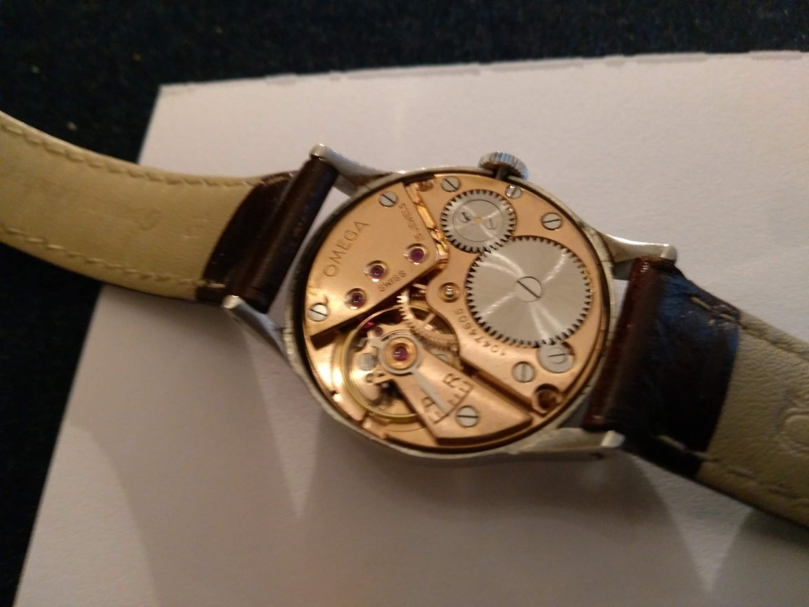

Sure. Sorry, it's not the best photo, I took it in a watch repair shop when I asked them to open the case. Serial is 10474605. What is your opinion?

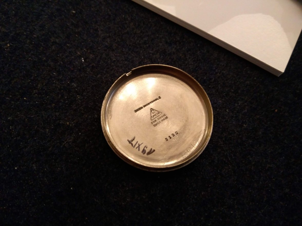

And another pic of the inside of the case.

My sense is the movement likely falls within the range one would expect from the reference. There does seem to be a bit of space between the movement and case. Hopefully Al or Chris will weigh in.
Case is ~ 33 mm?

Thank you for your observations, Art. I do not have the best tools to measure, but the case looks to be 32,5 or 33 mm to me.

Movement fits snugly into the case back which snaps into the case.

You can see a large lip on the caseback that would replace that springie-thingie a lot of these have.

The serial no. puts it at around 1945 or 1946
The movement looks to be a 30 T2 PC AM 15p (or a 17P), both were created in 1941. Omega say these calibres were the first they made with Incabloc shock protection (https://en.wikipedia.org/wiki/Incabloc_shock_protection_system) so you have a nice historical movement there !
Where do you see an Incabloc in this photo? I can´t... maybe I have to go to the optometrist... or is it you to do so? 😀

I was also wondering about this because I cannot see the incablock. Is the lack of incablock something problematic regarding authenticity or is it normal? On Chrono24 I can see some 30t2 watches with around 10.5 serials and no incablock.

Your watch is perfectly fine with an original dial and a clean looking movement which is a cal. 30 T2
Case is a special construction to prevent intrusion of dust and sweat.
There are no case screws required nor a movement spacer ring with flaps as the movement sits snugly in the case back.
This is not a common snap back but is like a (deeper than a regular case back) "container" which is deep enough to embrace the whole movement and precisely slips into the upper case part and is friction held. A good first attempt to protect the movement - much better than a regular snap back.
If I were you I would not bother that you can´t find information about this particular reference - all you need to know is there and clearly visible... or would you like to know production numbers - this is (likely) impossible to find out unless you have access to the holy inards of the Omega archives...
