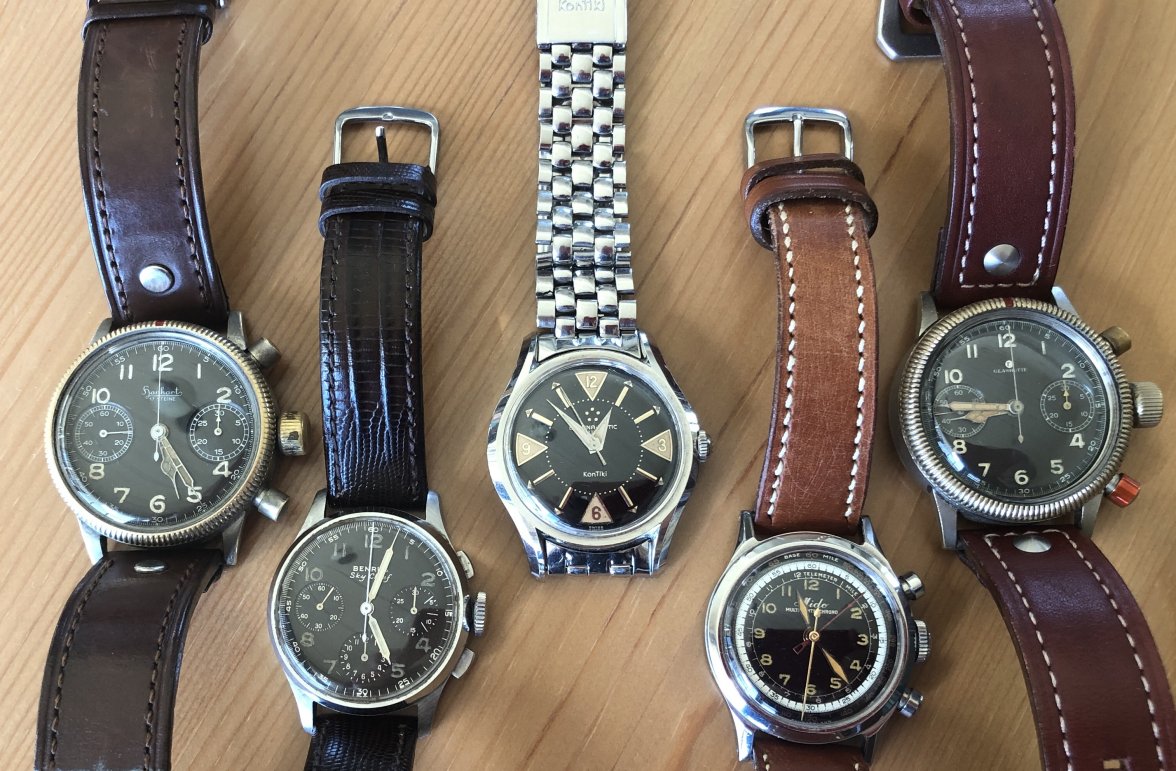

However I spent some time evaluating radium lume before adding pieces to my collection. My opinion to proceed was based on what I was able to find at the time, and that data satisfied my personal risk/reward balance.
I believe the highest risk for my own personal assessment would be the ingestion of any flaking radium lume. I manage that by not proceeding beyond opening a caseback for taking a photo or making a simple regulation adjustment.
A second risk is the generation of radon gas. Without getting into specifics, any radon gas that may be generated would be dissipated rather well by how I store my watches.
So that leaves the risk of any radiation exposure from the watch itself while wearing it - both dial side and caseback side.
Taking the following watches to my watchmaker for a Geiger counter assessment shows truly minimal transfer through the caseback into my wrist. However the dial side may be quite hot. So yes, I don’t sleep with any watch on anyway- and specifically will not sleep with a radium dialed watch on my wrist and tucked under my head as I sleep.
And any watch service which may be done by my guys is then made with the knowledge that there is radium on the dial.
With the risks managed to suit me as described above, I then find the aesthetics too good to pass up. So I wear them in rotation and enjoy them.

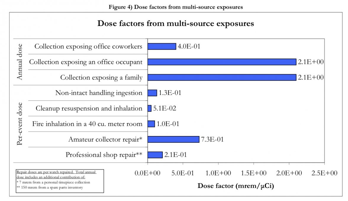

it seems like non-volatile daughter products of Ra-226 sitting inside the case are the source of most of the gammas. I still think the specific risk from Rn-222 being released wouldn't be a big deal.
Some interesting notes from the NRC people:
https://www.nrc.gov/docs/ML0731/ML073120009.pdf
Toddler-watch-breaking-and-lume-ingestion seems to be a relatively low risk factor, compared with exposing your unshielded dial to the toddler on a routine basis.
And apparently, repairs by amateur "enthusiasts" are considered most risky of all!

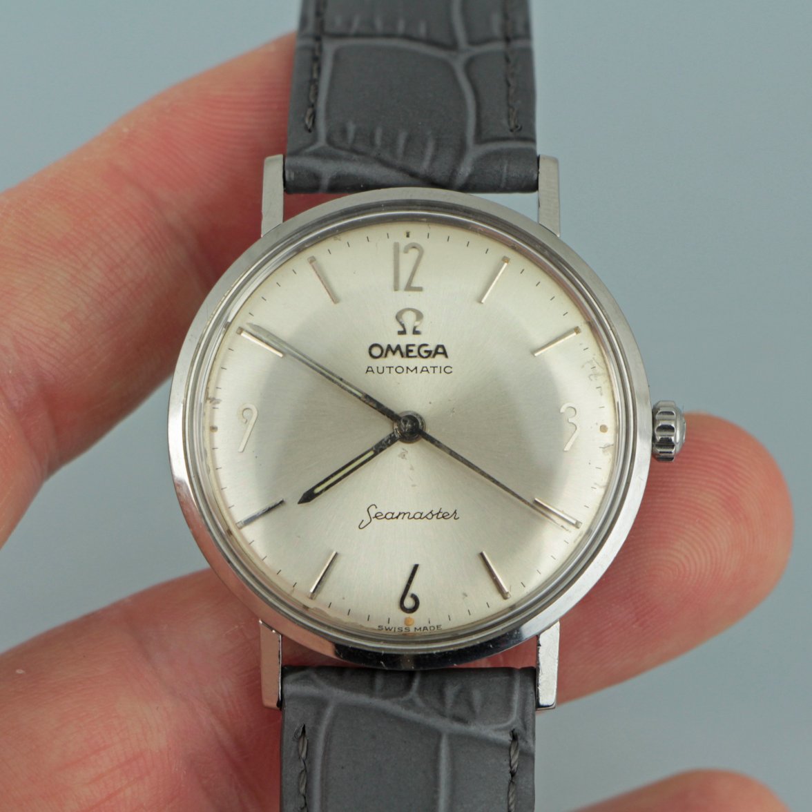

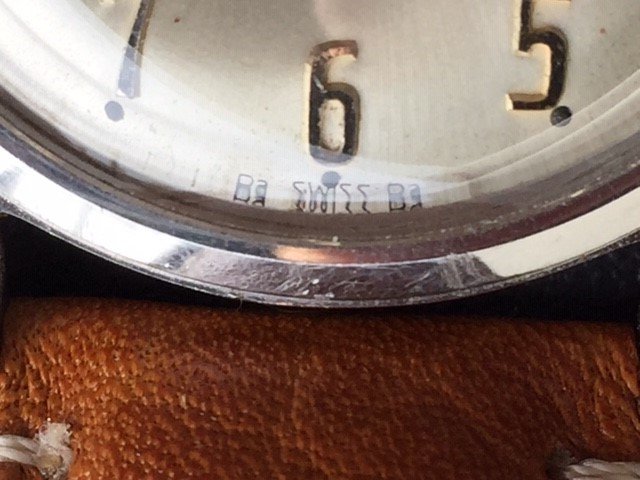

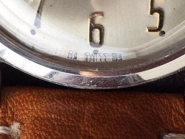

My 17 jewel Laufik (with a AS 1686 mvmt), dial marked "Ra Swiss Ra". So, I guess this means radium on the dial, and not Yay Swiss Yay!
But my 1961 Seamaster, ref 14765 2SC, radium or tritium?
24,810
55,144
Goooooooo SWISS! ::psy::

So....
what numbers do you see through the caseback?
I can't remember but it was very low. However, as others have mentioned, it's not the radiation that's the concern, more the radon that is released. However, without summarizing the whole report from a few yrs back, the readings were hardly completed in a controlled environment.
5,076
15,712
Radium, no T next to Swiss and color indicates radium to me.
Thank you. I thought there was a time early in the beginnings of tritium’s useage before they realized that differentiating with a T would be helpful.
1,504
2,435
The earliest I’ve seen anybody talk about Omega using tritium was 1962. I think Rolex started in 1963. If you’re confident that yours is a ‘61 then I’d lean with radium but a Geiger counter could solve the mystery quickly

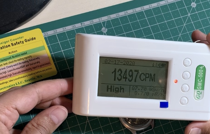

I just upgraded my dosimeter because I have a watch that got off the scale...
I was able to measure almost 90 uSv/h and over 13,000 CPM
What do you guys think? Would you wear this?
Still curious what you see *through* the caseback, if anything.
Wearing it dial-side down, 16 hours a day for a year would put you at the low end of the red section of this chart:
a slightly increased risk of cancer, but wearing such a beautiful watch should be worth it!

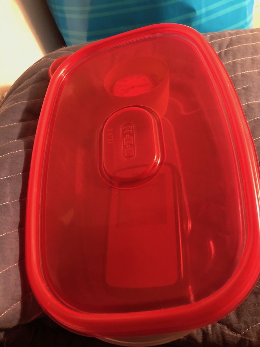

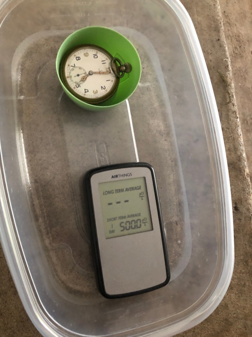

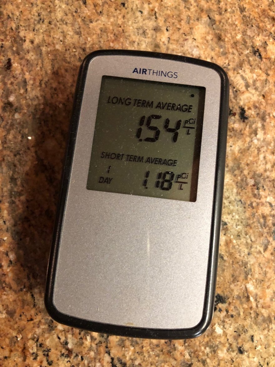

Based on the radon measurement via alpha-detection as discussed up-thread I wanted to further understand whether radon measurements were influenced by proximal radium.
Two exercises were run in parallel.
1) Contact Airthings directly about the Home meter and our question about meter accuracy with radium nearby
2) Do a semi-sealed enclosure test with a pocket watch and Airthings meter having ~15-20cm separation (longer than alpha particle travel distances as I understand it)
Short version of results: a) The meter is only reading the radon levels (via alpha particle proxy) and not being fooled by any radium in the neighborhood b) one can achieve quite a high concentration of radon with a single radium-rich dial in a small closed volume.
Just reporting some findings. Still pondering what they mean and any other thoughts are of interest. I tried to follow the radiation dosage chart above and it only confirmed that I don't understand much about relative radiation risks.
Long version of results:
1) Company responds (nice!) that meter is accurately reading radon levels and not being influenced by proximal radium
Hi David,
My name is Laoise and I am the Customer Support Specialist here at Airthings. I asked our in-house CERN scientist, and this was his reply:
Your question: In other words, is the meter still accurate when in close proximity (say <10cm apart) to a strong alpha emitter like these radium-bearing timepieces?
The answer is yes. The alpha particles from the radium in the watches can not reach the photodiode sensor inside the diffusion (decay) chamber.
If there is anything else I can help you with, please let me know! Thanks for being an Airthings customer 😁
All the best,
Laoise
Airthings support
2) My testing would seem to confirm the answer from Airthings.
Watch and meter were sealed in a generic food storage container. Surely not hermetic, but decent, and separation should be enough to diminish radium alpha particle influence. Airthing meter spiked in a matter of hours to saturation at 500.0 pCi/L 😲.
For reference, my typical home levels are 0.5-1.5 pCi/L depending on the meter location and day. Readings typically take a day to begin. Problematic levels begin in the 4 pCi/L range (again as I understand it).
I removed meter to inside and put watch in garage. After a reset it again quickly spiked to 500 pCi/L, presumably from retained radon in the diffusion chamber. Then tried to "air out the chamber" by going outside on a breezy day and waving it around for 15 seconds. Reset. Still spiked to 500 pCi/L quickly, though not quite as quick. Reset, and just let sit for a while ... down to 194pCi/L after ~12 hrs. Reset. After 24 hours I'm quickly approaching a typical ~1pCi/L. Sounds a lot like captured radon in the chamber slowly dissipating/decaying, all without any radium nearby.

This is all consistent with my observations and the information from the company sounds absolutely correct to me (i.e. the detector is shielded from ambient radiation). As you found, the radon emitted from a watch if contained in a small container will reach high concentration levels, and it doesn't dissipate readily without convection because radon is very dense. The only additional thing to keep in mind is that health effects are mainly associated with the total dose of radon inhaled, which is calculated as being due to a constant background level that is inhaled multiple times per minute, assuming a standard tidal volume. Despite the high concentration of radon in that container, the total dose of radon is tiny because of the small volume. To get a feeling for this dose issue, here is a rough calculation that I posted on WUS a while back, which was based on a measurement I made of 125 pCi/L when I put my meter in a container with 10 radium watches. My radium watches are not as heavily lumed as yours, and are more representative of 1950s wristwatches.
For a back-of-the-envelope wildly conservative estimate of the maximum dose one could potentially receive from opening a watch box, let's compare the total daily dose of radon one receives at outdoors background levels (approximately one-tenth the level considered hazardous) to an exaggerated dose that one could possibly receive from two daily episodes of sticking one's head into a sealed container of watches and breathing deeply for 30 seconds each time (1 minute total).
Outdoor background: (0.4 pCi/L)*(20,000 inhalations/day)*(0.5 L/inhalation) = 4,000 pCi.
Sealed container: (125 pCi/L)*(15 inhalations/minute)*(0.5 L/inhalation) = 937 pCi.
So even in the unlikely case that you would breath deeply for a full minute from the air at the bottom of a closed container holding 10 radium-lumed watches (and assuming that there is enough radon-laden air in the watch box to fill your lungs for that whole time), your total dose would only be about one-quarter of the dose you receive daily from outdoors ambient levels, which is itself 10 times smaller than the dose considered to be dangerous. So this one-minute deep-breathing exercise from your watch box represents about 2% of a hazardous daily dose of radon. And of course, because the assumptions used in this calculation are exaggerated (e.g. there is not actually 7.5L of radon-laden air in the watch-box, it's not likely that you would inhale the air from the bottom of the box, etc.), the actual dose you would receive from opening your watch box would be much lower.
To make the calculation more directly relevant to your experiment, you could replace the total dose from the sealed container to be the actual total amount of radon in that container, which is obviously the upper limit. This would be (500 pCi/L)*(1L)=500 pCi. This is assuming it was a 1L container. Of course it's unlikely you would be able to inhale all of the radon out of that container without trying really hard, but that is the maximum dose you could get, compared to about 4,000 pCi each day from outdoors background, which is the absolute minimum we are all exposed to.
These are all just numbers, and I'm not telling people whether or not to be concerned about increasing their exposure to radon by even a small amount. But data are data, and we can't ignore them. When you multiply the concentration by the volume (which is the relevant calculation), the numbers make more sense.
