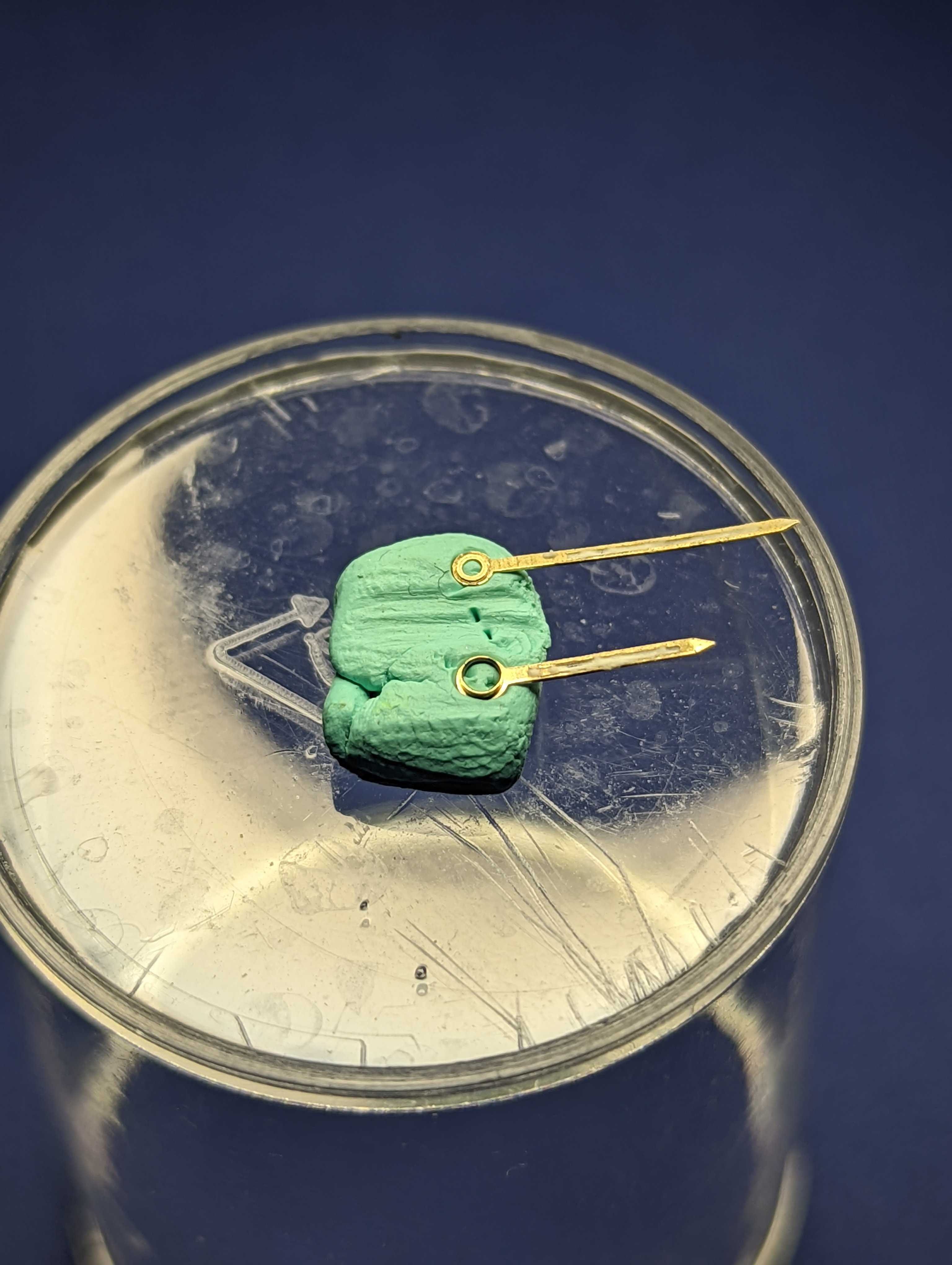

Do i have radium dust everywhere? 1959 Seamaster

Take the hands off, stick them in thinners which will remove the radium, then polish them with a rouge cloth and clean again. relume then job done.
Think hand hole is the same size as 500 cals.
This is a great site if you need to know hand hole sizes very useful indeed. http://www.ranfft.de/cgi-bin/bidfun-db.cgi?10&ranfft&&2uswk&Omega_600
Foolishly i put them in the bin already or i would have done this - DOH!!!
That site is great, it mentions the hand dimensions as 1.50 x 0.80 x 0.18mm - Excuse my stupidity what measurements exactly are these?

I think it will be much easier to remove the lume from the hands than any other option.

They are 100s of millimeters or fractions there of. Often written without the zero like 150 080 018. The sizes can also be + or - the last digit which I think is hundredths of a mm. The largest is the hour hand, the smallest the seconds hand. I have the numbers 141 065 017 written on the paper beside me. I think this is what I am using for the 351 hands I need.
Ranfft is the go to place.
There is a Bergeon tool which can grade hands. This will often be shown in the listing for the high end hands. One can also make this tool themself using steady pins or broaches. The hand is slid on the pin. If a sharpie is use to mark the pin then a scratch can be made. All the hand of the same grade will align with the scratch. One can also read this with a micrometer. The better the quality of the watch the closer it will be in tolerance to the published number.

Well i went trash diving and found them, used some thinners with a spell in the ultrasonic and they're now waiting for the new lume to dry (my first time doing this so not perfect by any means hehe). Thanks for all your help everyone!!!!

PS - If anybody has some tips on cutting down the female crown stem to the correct length (both in determining the correct length and pysical process of cutting/de-burring I'm all ears?!?!)
If you were brave enough to re-lume the hands, resizing the stem should not be hard for you. If I were to make a couple suggestions as someone who is trying to learn watchmaking, make sure not to cut too much off of it as there is no going back without using an extender. Also, try not to introduce metal shavings into the movement during the process. I would wash the stem before you install it.
This video shows how to adjust the stem after extending it, but the idea is the same if you are starting with a long piece without an extender:

Amazing thanks, thats exactly the sort of info i was looking for 😀
