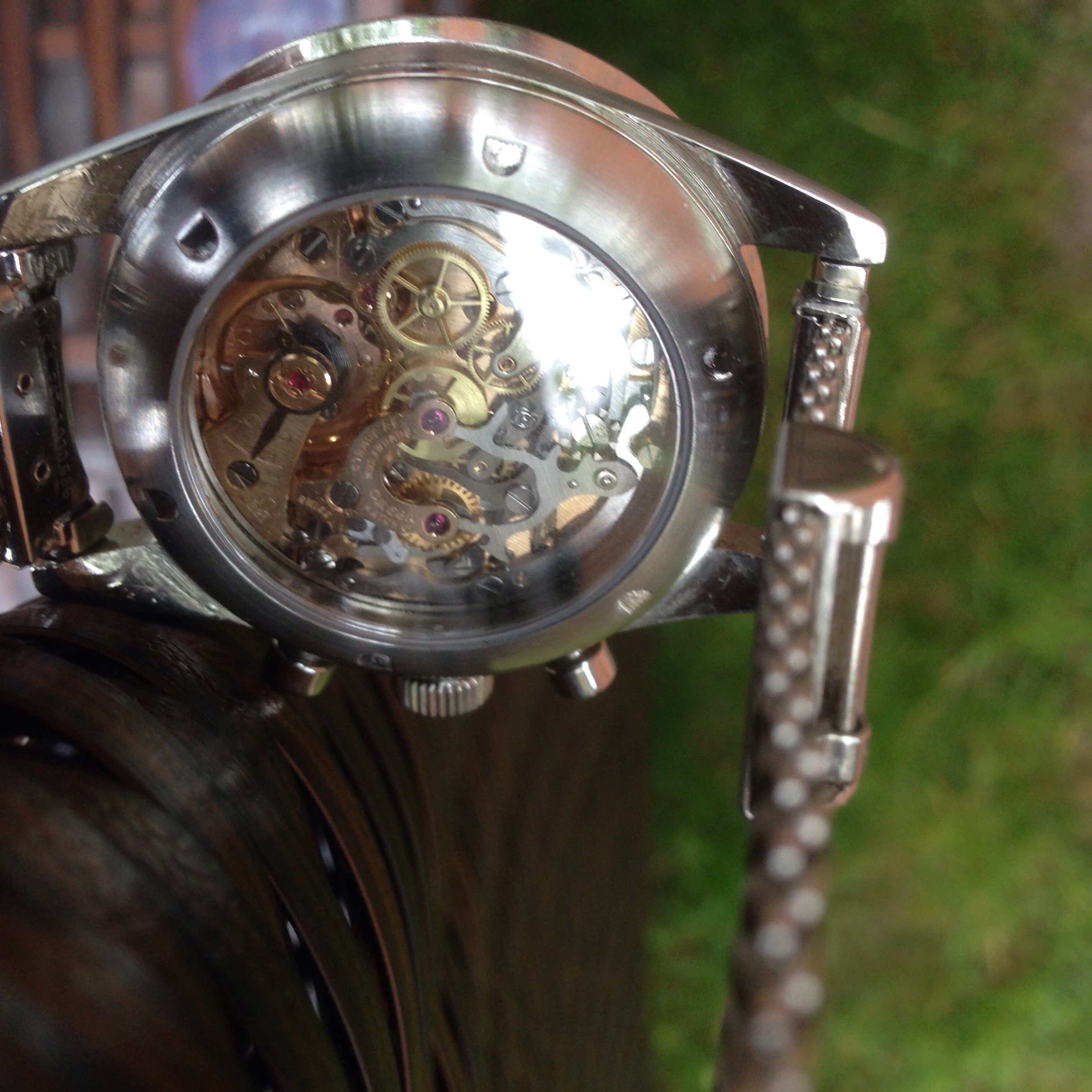

  1. imexian Apr 25, 2015

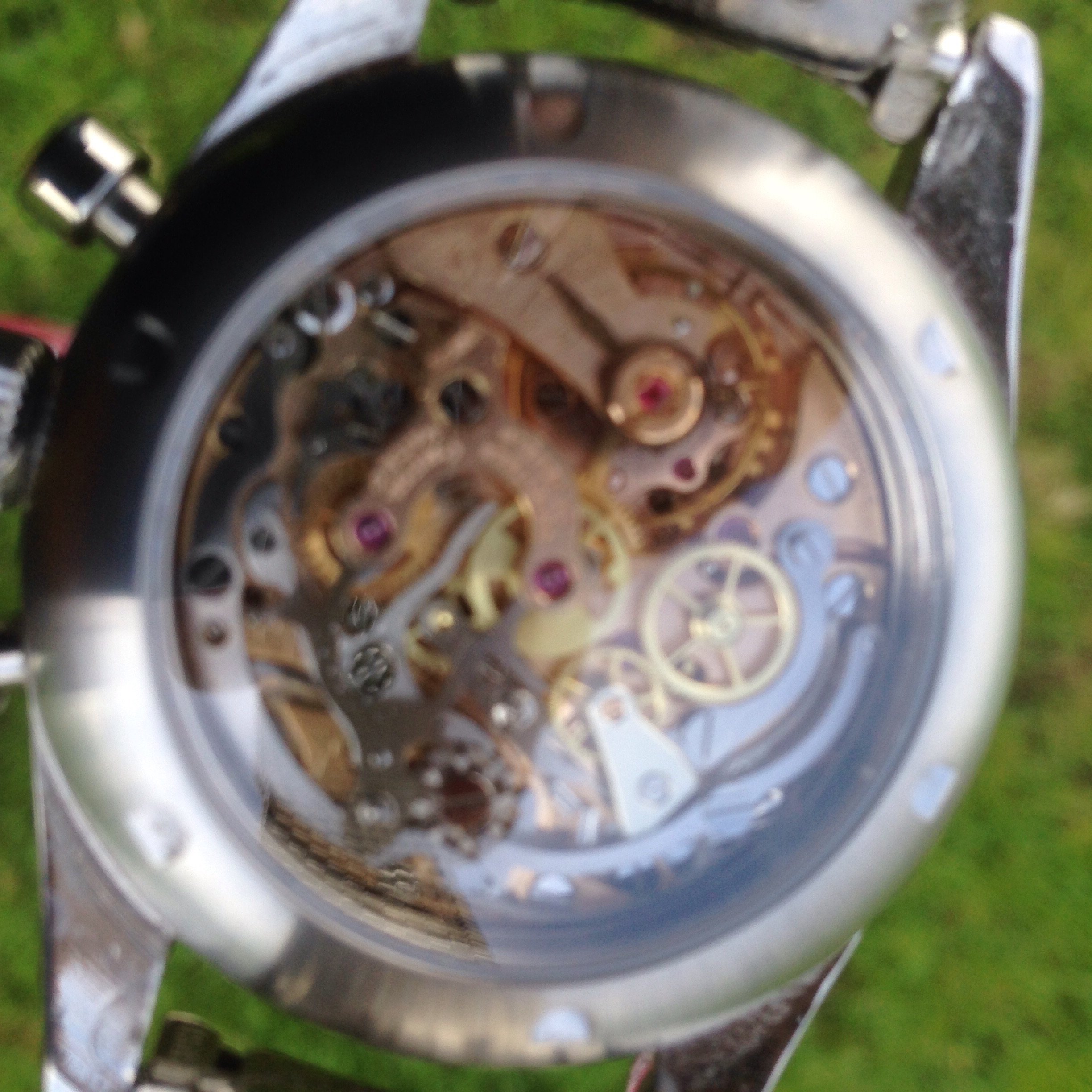

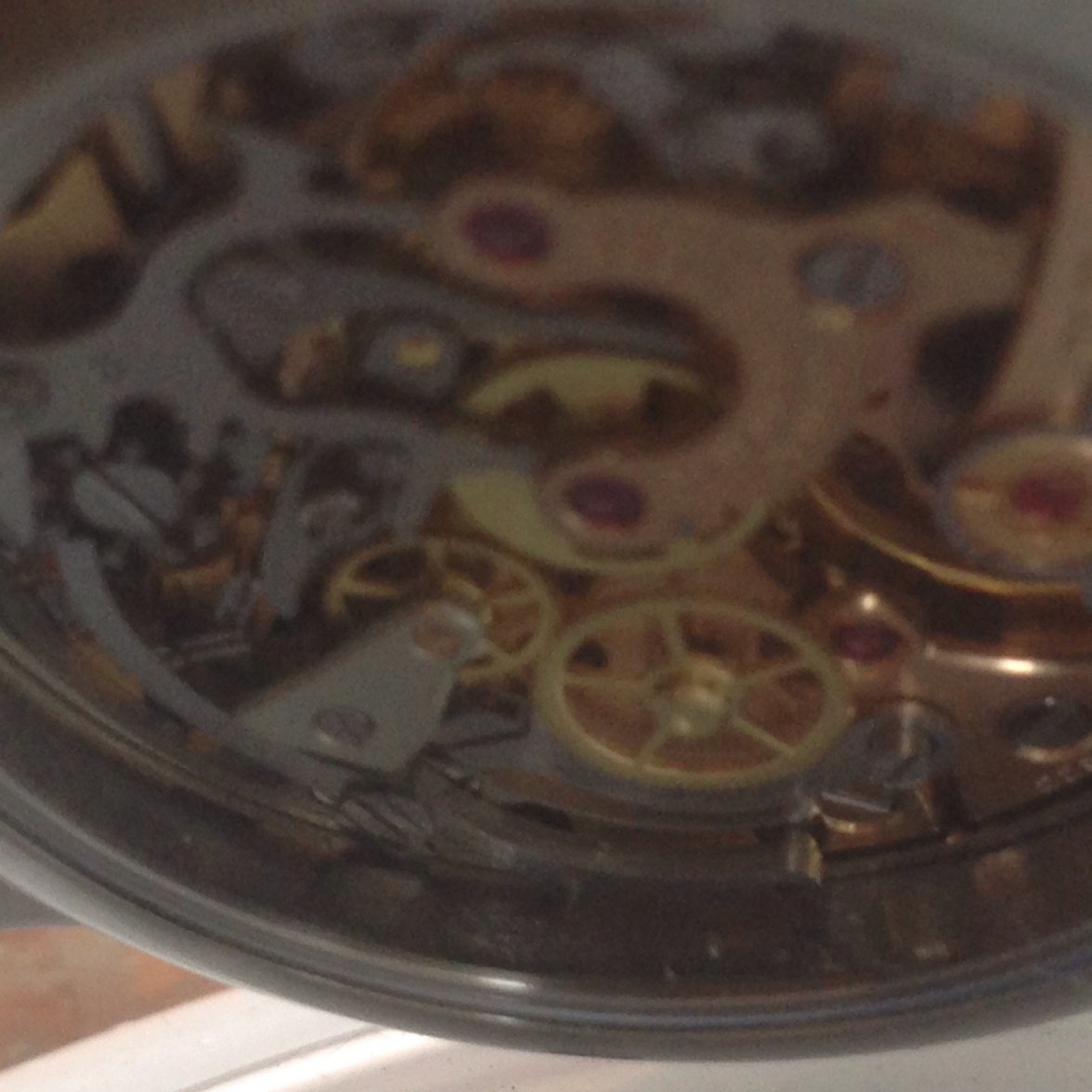

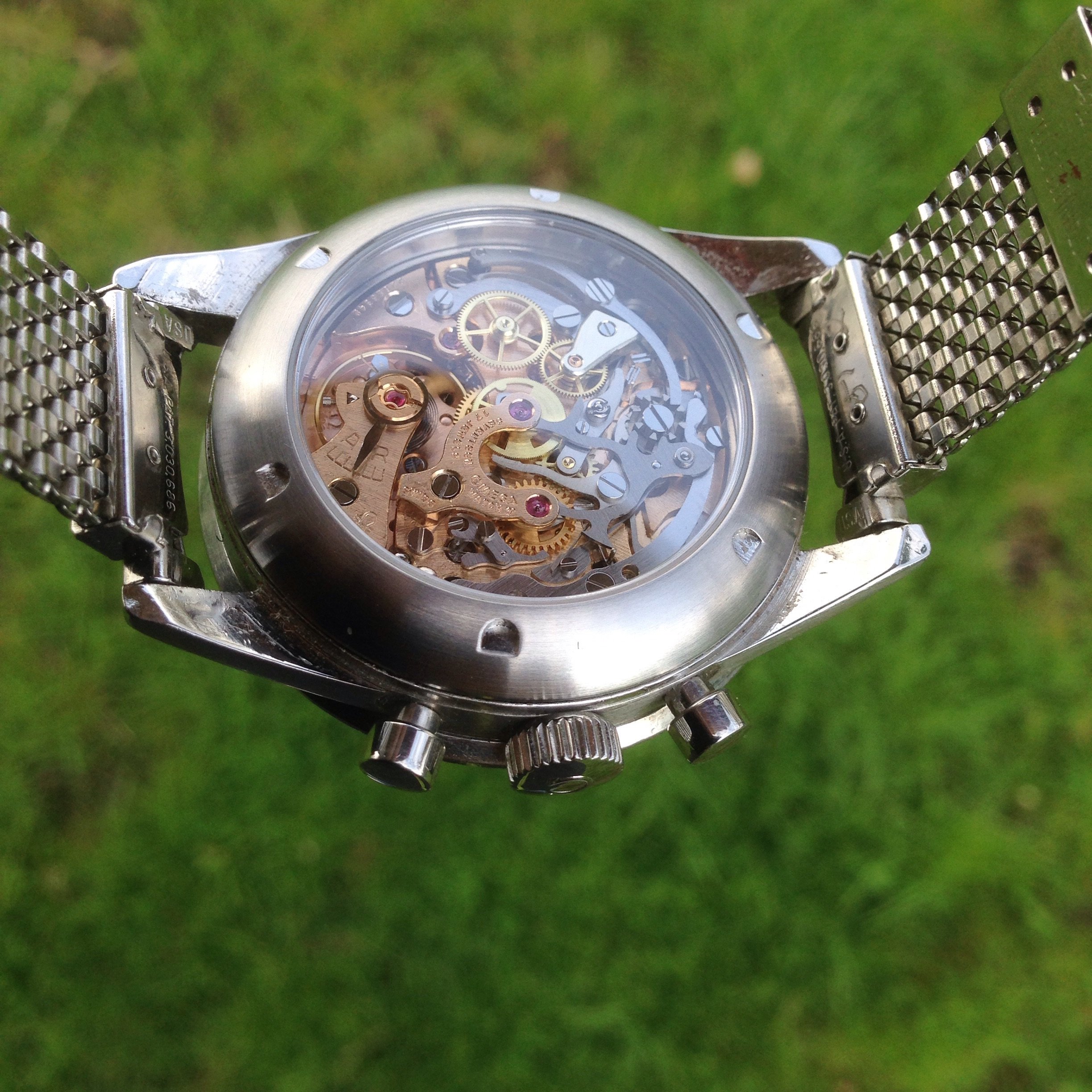

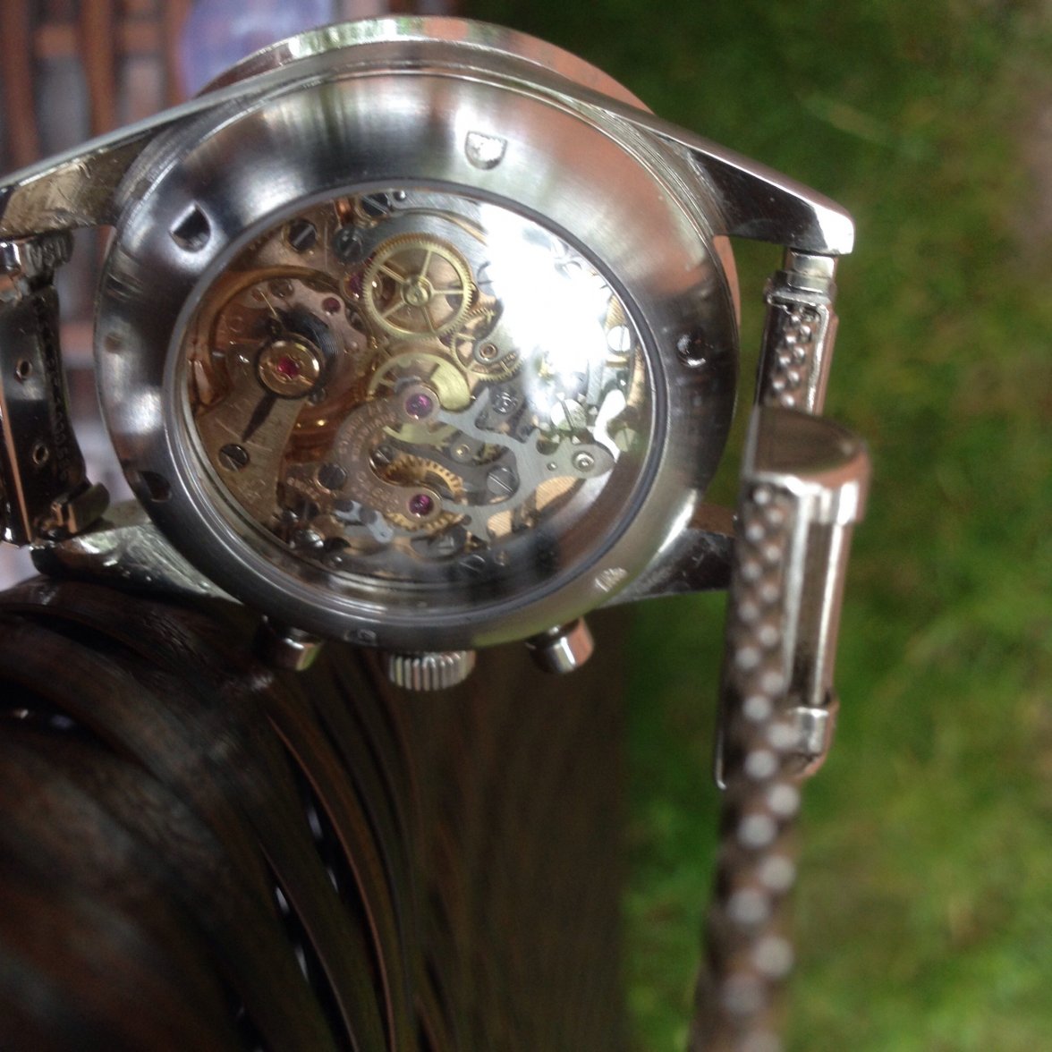

    came in post this morning, banged it straight on, and out with mutts, so quick couple of pics...

    Its a beautiful movement :thumbsup:

  5. miccro Apr 25, 2015
    78
    64
    looks good!- might need a bit of a careful tighten - seems to be space between the case and case back + movement retainer ring on the inside,
    enjoy!
  6. imexian Apr 26, 2015
    246
    111
    Thanks, i gave it a tweek with case tool but not sure if it supposed to fit completly flush anyone got pics of the caseback fitted?

  7. imexian Apr 26, 2015
    246
    111
    Does the spacer need a little sanding?
  8. JimInOz Melbourne Australia Apr 26, 2015
    15,398
    32,153
    Somebody here did one recently and commented that they needed to "sand" it a bit.
    Maybe some 600 grit wet and dry paper on a sheet of glass or your wife's granite kitchen bench.
    Use a small block of very soft wood (balsa from the model shop?) to hold it and do a little bit at a time.
    Clean it well and do a test fit, repeat if necessary.
    Let's know how it goes.
  9. Archer Omega Qualified Watchmaker Apr 26, 2015
    26,337
    65,027
    Is the movement being held in place, or does it move? If it moves, then the case back is not in contact with the spacer, so the spacer does not need sanding - it would only need sanding if it was too thick. A gap does not indicate it's too thick.
    Hopefully you lubricated the case back gasket, and if so it looks like the case back might need to be snugged up a bit more.
    Cheers, Al

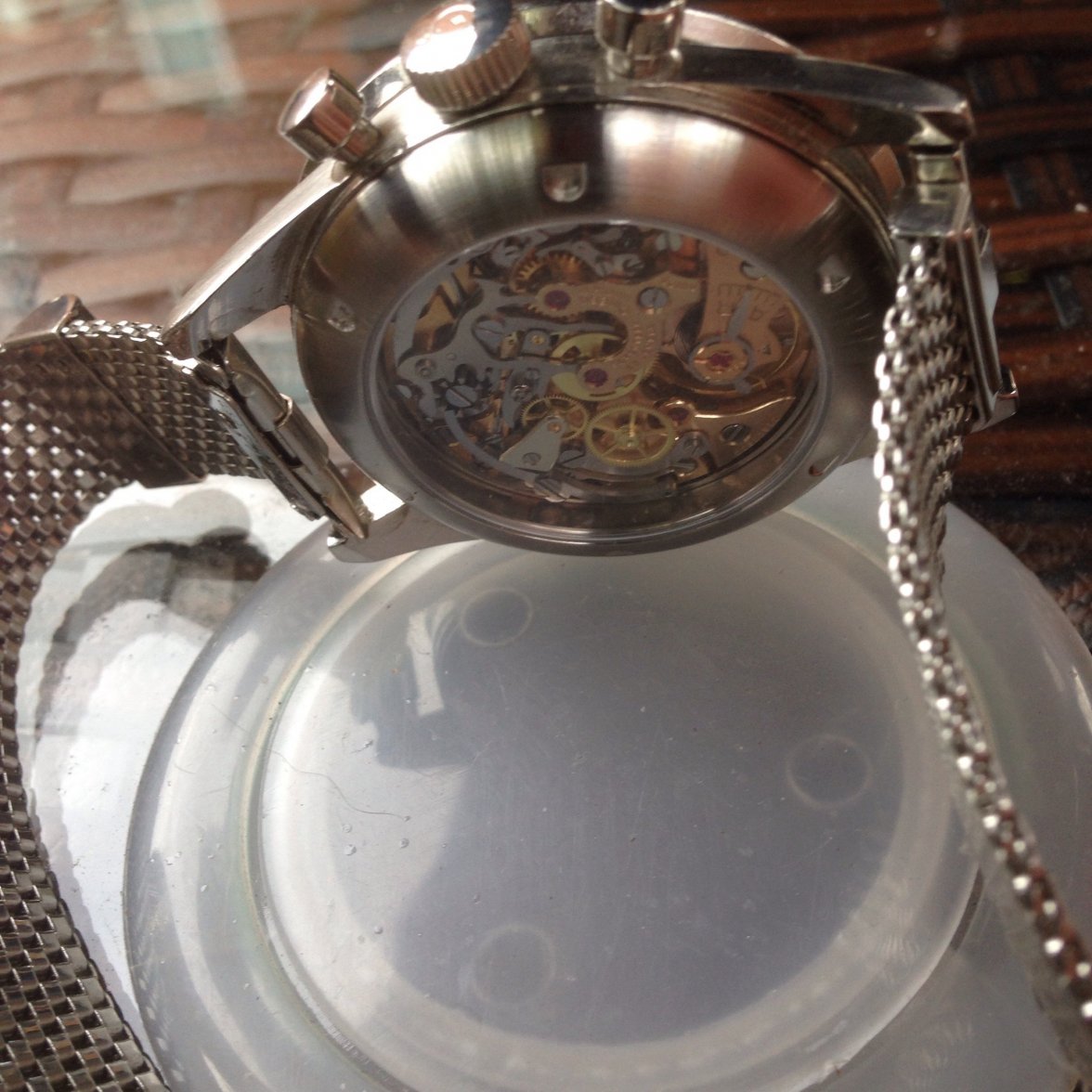

  10. imexian Apr 26, 2015
    246
    111
    Hi Al, I did not lube up gasket, I have a pot of silicon grease, is that good to go. Didn't want to get into a power struggle with the case opener, then slip and gouge metal !!! :)
  11. Archer Omega Qualified Watchmaker Apr 26, 2015
    26,337
    65,027
    Silicon grease is okay. The reason you lubricate is not to help the watch seal, but to prevent the gasket from catching on the case back and bunching up, causing it to stretch so it no longer fits properly, or possibly break.
    Cheers, Al
  12. imexian Apr 26, 2015
    246
    111
    Ok Al, will take off and refit, see if ok? Looks nice though, thanks dude.

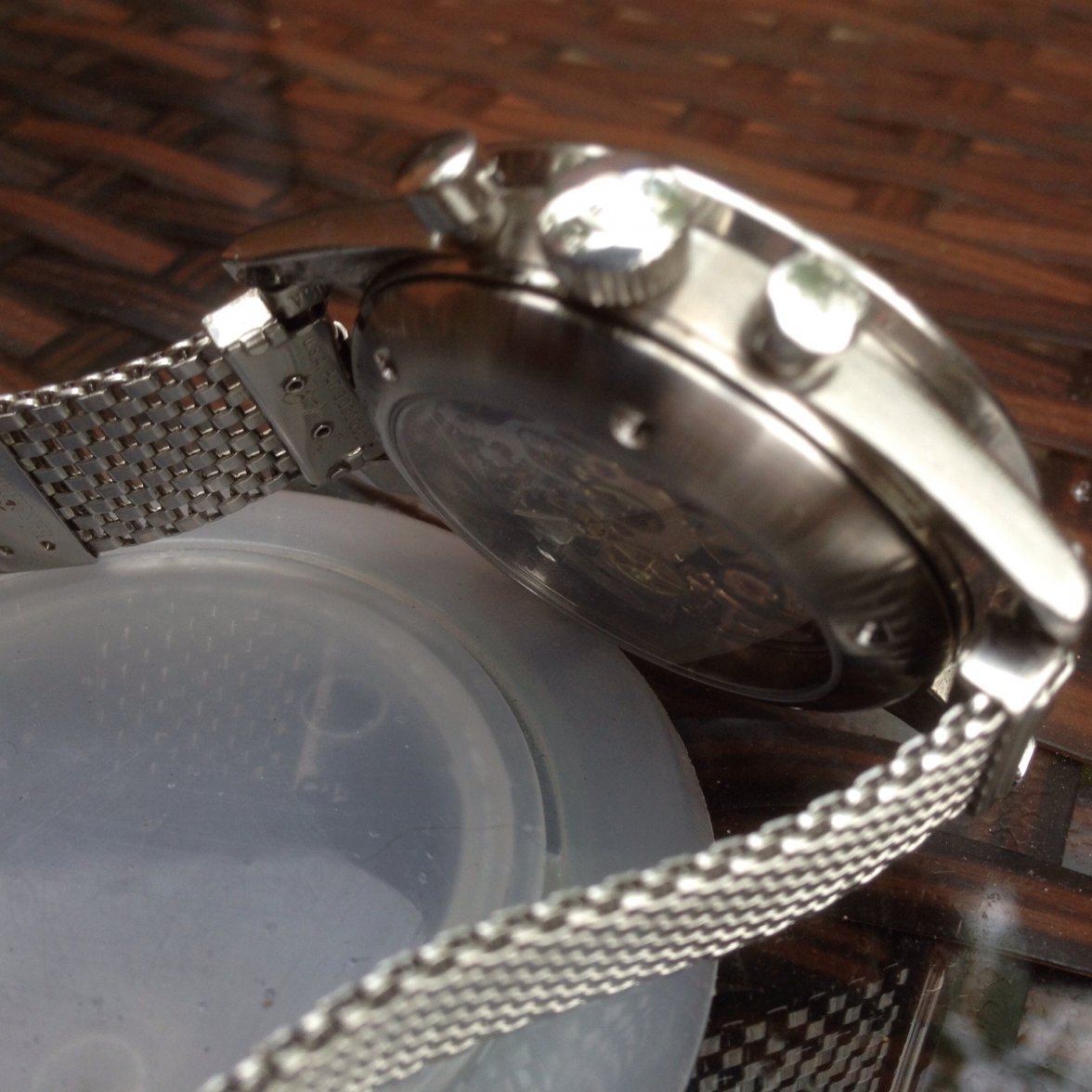

  13. pascs Apr 26, 2015
    1,634
    5,657
    I have a few of Thomas's case backs and they fit really well but there is always a small bit of the clearance between the case back and case due to the o-ring. I've not had any issues with moisture getting in through the case back although never had them pressure tested.
  14. Fost Apr 26, 2015
    2,052
    5,838
    Please no offence here, just my personnal thinking (not really important) but i find those generic see through case back ..horrible...it looks like the window of the nautilus... but maybe it is due to the pics...
    Anyway this 321 is really beautiful...

  16. imexian Apr 26, 2015
    246
    111
    hi PASCS, i think it seems tight enough?? Will not be going near any water anyway....!!
