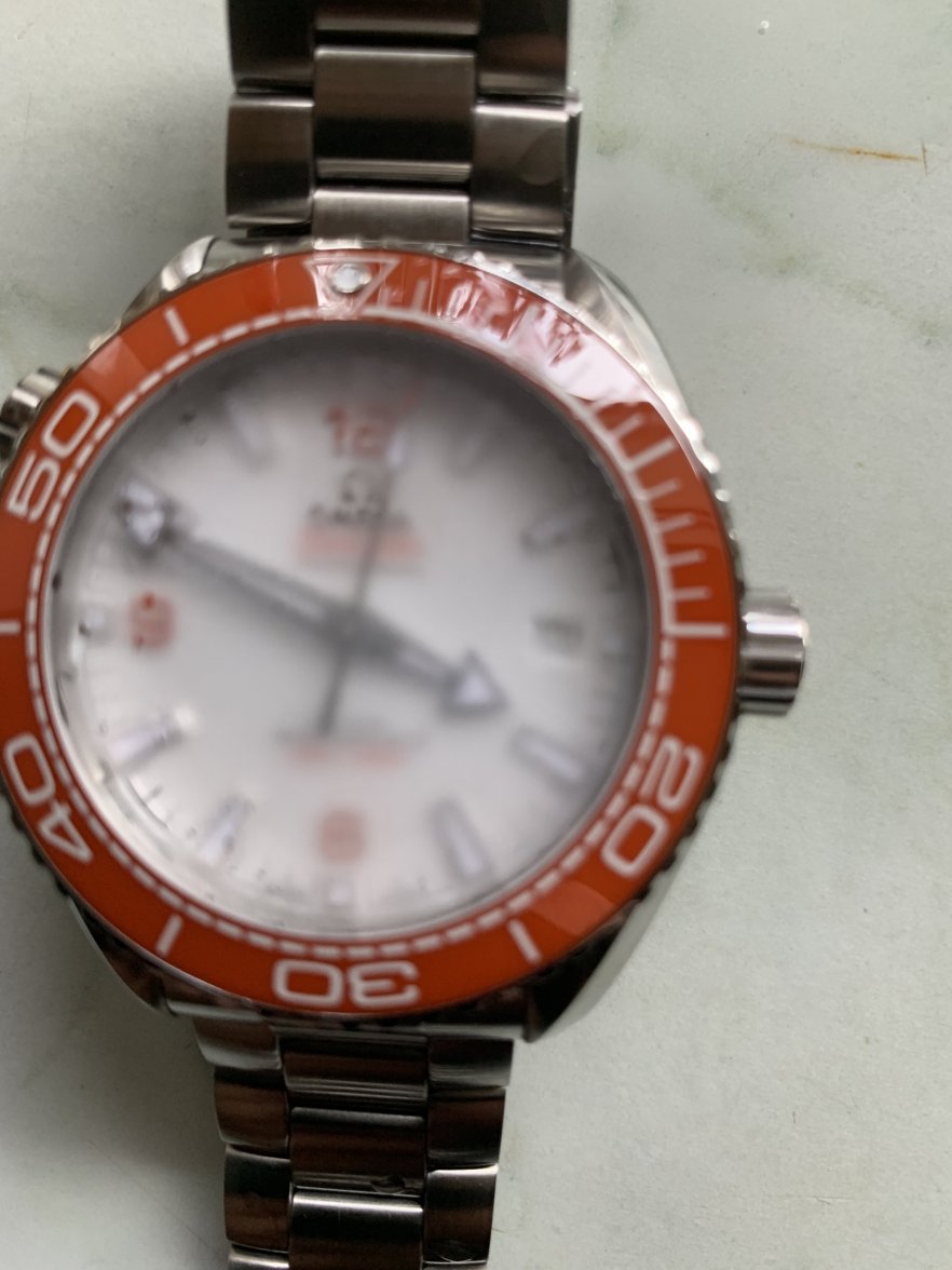

I bought from an Omega AD a month ago a brand new Planet Ocean 600m. The white dial and bright orange bezel one which I intended to use in the height of the summer. Unti then it would remain well packaged with silicone moisture pouches in my underfloor safe. The safe is not damp, it’s dry. The watch has never been worn.
The weather has been nice and so I took it out to wear it got the first time. As the cold dial hit the warm air it totally clouded over with condensation from the inside. I contacted immediately the AD who suggested I contact Omega direct, not because he was avoiding the problem, but because it would be quicker.
Quicker for what? I do not want a seal check and a service, I want to give this piece of shit back and get a replacement watch. Do I have to accept the same watch back in perfect order or can I demand a replacement?

One part of the description though I do not understand, and that is why condensation would happen on the inside when a watch is brought from a cold and dry environment into warm (and humid, I assume) air. Normally, condensation would then happen on the outside of the cold watch, where the humid air is now cooled below the dew point. Large amounts of humid air would have to get into the watch for it to condense there before the condensation on the outside has warmed up the watch.
A procedure to test watches for water ingress involves cooling the outside of the dial of a warm watch (e.g. by putting a few drops of cold water on the dial) and observing water condense on the inside. So the watch would have to come from a warm humid place into a cold environment, the opposite of what you described.
Quite puzzling.
Edit: just reread the original post; those 'silicone moisture pouches' hopefully were 'silica desiccant pouches'.
I was also wondering about this. Living in Florida, this is a common occurrence from me when I leave my car - the air vent blows right on my watch, cooling it significantly.
One assumes the OP checked that the fog wasn’t on the outside of the crystal only, but if someone has never experienced this Or understood the physics, I could imagine they’d think the water was inside.
