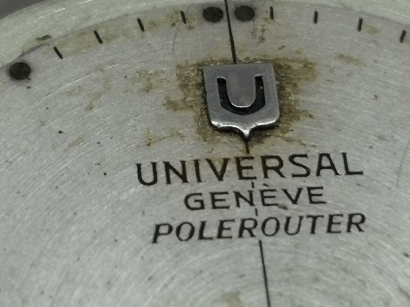

dirt on the dial
69
120
I often wondered myself about "patinated" dials, but who knows what kind of dirt this is:

Perhaps the source is from the under dial?

Maybe you are rigth so some kind of glue. Moisture alone leaves no dirt at all, there must have been some kind of chemical reaction. Or is it from the outside, some kind of dust or so? Iam still not sure.

Best bet is bringing it to a watchmaker and getting their opinion. I’d imagine there is some kind of hole that connects the UG logo to the dial, which is why I said it could perhaps be coming from under the dial given how many complications are under there, but best bet is going to a watchmaker you can trust. Do your research and you’ll be fine - I recently had to service an old watch for the first time and it was nerve racking but once you get a convo going with the watchmaker, you’ll be able to hopefully distinguish the experts from rookies

They are applied with some sort of adhesive - there is no hole through the dial for the logo.

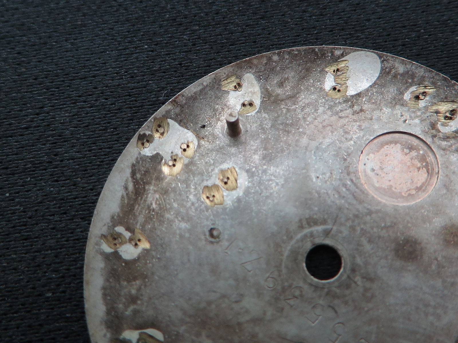

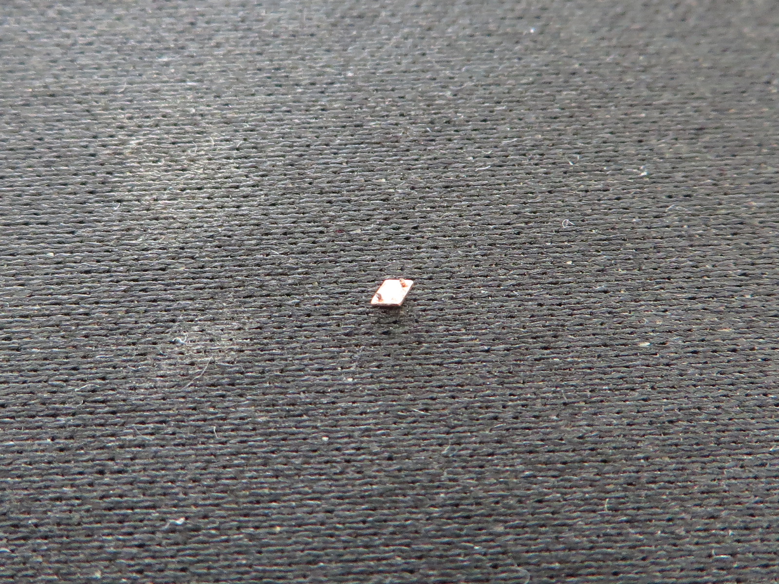

They are not applied with adhesive, there are holes in the dial, they are riveted in place.

It could be that the dial was cleaned with a mild solvent long ago without the removal of the riveted logo. The solvent didn't get enough penetration around the logo to properly dissolve the old lacquer and whatever dirt or grime had attached to it.
What you are seeing could be what the entire dial would have looked like if the cleaning never happened.

Whilst the dial you've shown is not a Polerouter dial, I think you are right.
That's not something that I had appreciated before. I have lots of pictures of the reverse of Polerouter dials and there are holes where the logo is riveted in place. The holes are often small and not at all obvious but they are there on closer inspection.

youre right, the loose dial i looked at was painted black on the back - looks like theres either 1 or 2 holes where the logo is joined.
