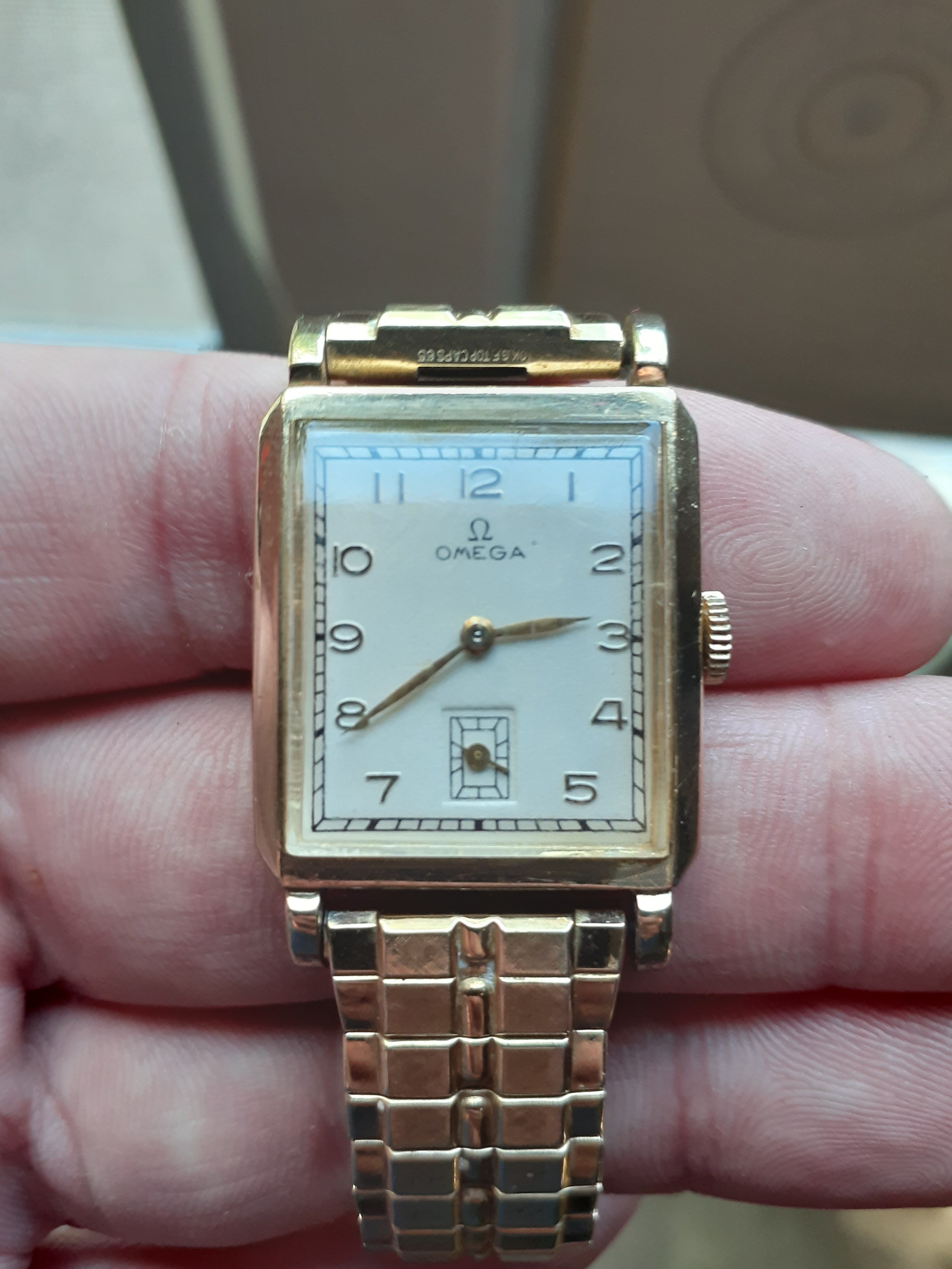

Hello! I'm new to the Omega forums and I was wondering if there's anyone out there that can help me identify a watch. So far, by way of doing image searches and comparing, it appears to be a 1947 Omega 17j dress watch and I would love to know more, it was my grandfather's and I'd appreciate any help. There's no external serial numbers and I realize the best bet is to have a jeweler remove the back, but I'm trying to stay home due to the virus.

American market reference N-6216.
Note there were a variety of dials offered, finding an exact match on the net may not be possible.

What other info are you looking for, I gave you the reference number. There is simply very little information available for these American market watches.

Finding an exact match may be difficult. The dial looks to have been repainted at some point - note the uneven subseconds markers, a bit wonky Omega text, and what appears to be paint on the sides of the applied numbers. Repainting was more common during a repair back in the day, so the work could be honest. Collectors frown a bit on redialled/repainted dials, but it was your grandfather’s and I’d wear it with pride.

Its very nice. Get it serviced and wear it !
The stretch band is not helping the watch's look .... consider something more ....... elegant ?

Yeah I realize the Spiegel stretch band isn't doing it any favors, lol. I guess it's most valuable to me just the way it is because that's how my grandfather wore it, we're all partial to sentimentality and that kind of makes it hard to change anything. I did find out the other day that after not being wound since the early 90's it still works perfectly!

The oils lubricating the movement have dried up ..... running the wach now is wearing it out do don't!
If you just want to look at it and not use it as a watch, a service is not needed. I think it would be a shame not to wear it.
On keeping the stretch band, I understand the sentiment and wish you the best with your watch

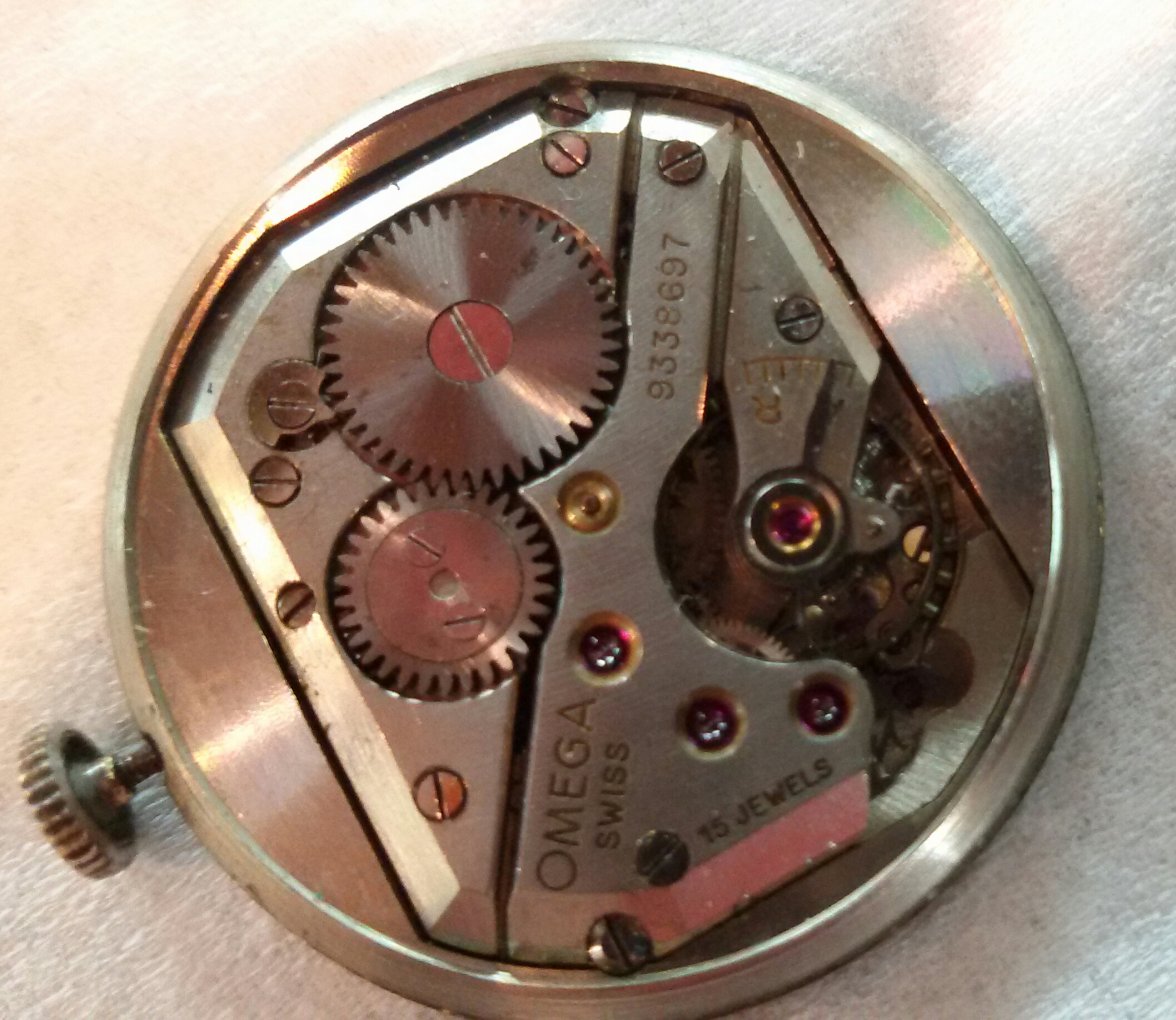

Could have a caliber R17.8 movement. Maybe a 302 (pretty much the same movement, but later version with shock protection?)

So far I've learned it's a 17 jewel movement, so I guess my question would be how likely is it to be the R17.8? I need to trust a jeweler and have the back removed.

It is a R17.8, I've had this reference in the past.
