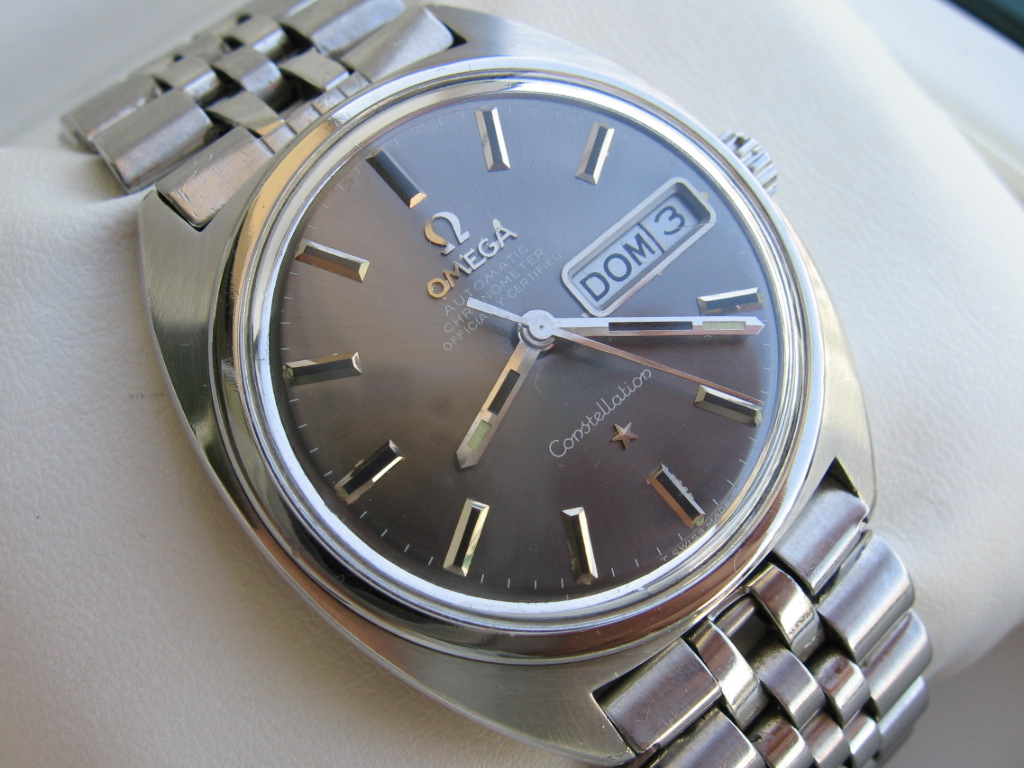

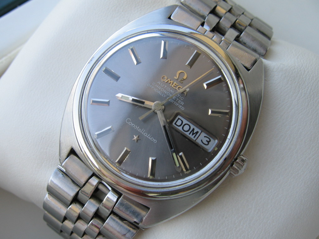

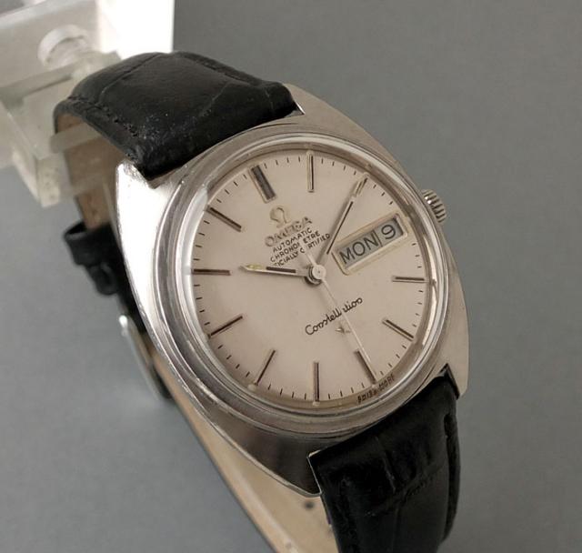

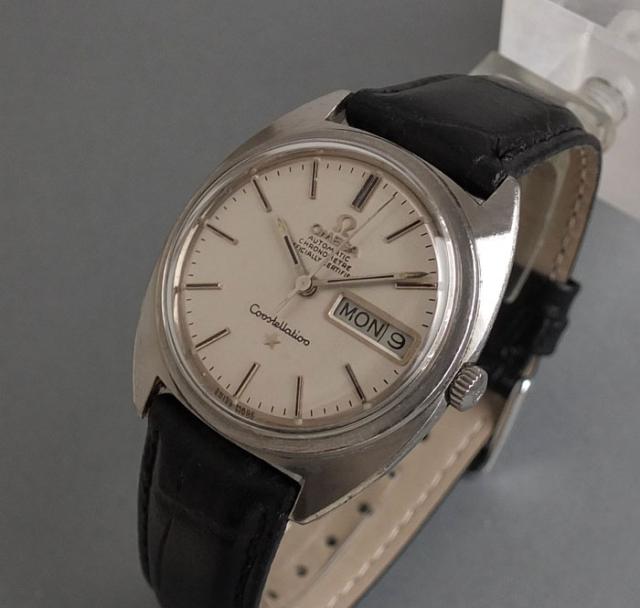

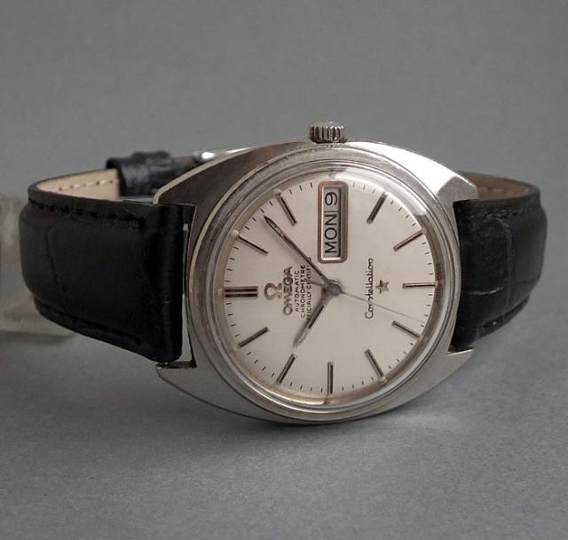

    Thank you Gavin. So, now, I have another doubt.
    Different sellers and (more or less) same watch: the first one (white dial) is about 950 euro, the second one (grey/silver) is about 600 euro. What could be the right valuation?
  4. NT931 Jan 18, 2015
    2,820
    14,424
    Hi ilrocco,
    The price of a watch depends on many things, not just dial. Case, movt, accessories (box etc) all play a part. Plus seller optimism too plays a part.
    I'm not sure about the 1st one , it looks like a redial (though it's just 1 picture), which would lower the value. I'm not an expert though, and would wait for them to chime in. The 2nd dial looks (IMO) to be original and not redialled / refinished.

  6. shaun hk Fairy nuffer Jan 18, 2015
    1,425
    1,516
    I too think the white dial has been repainted, there are no T's near the Swiss made and yet there is tritium on the dial and hands...
    ilrocco likes this.

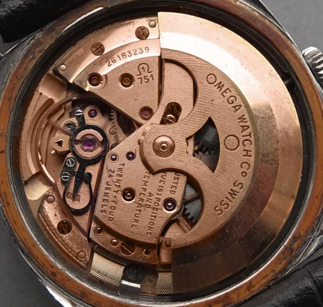

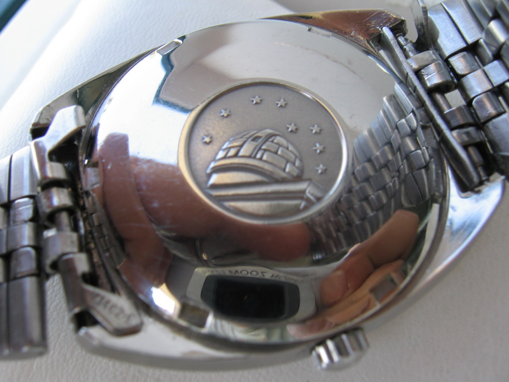

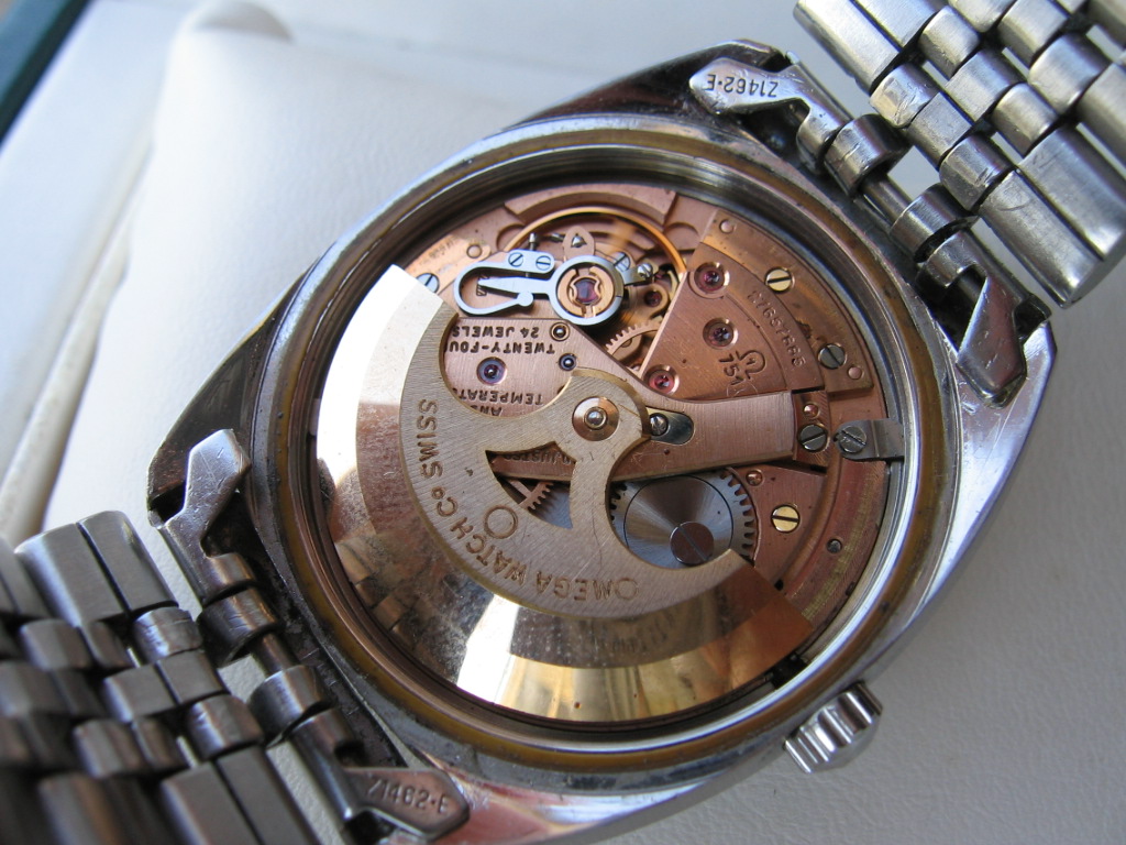

    Both watches have wear on the rotor edge where is contacting the back. Service will have to address this.

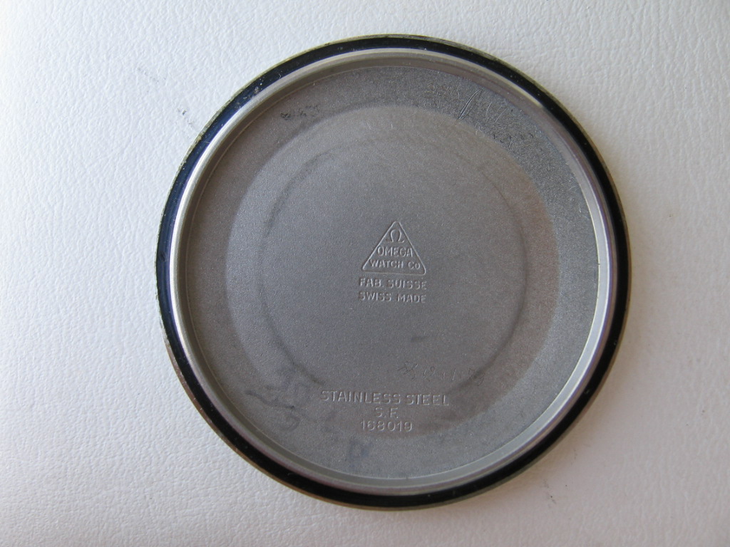

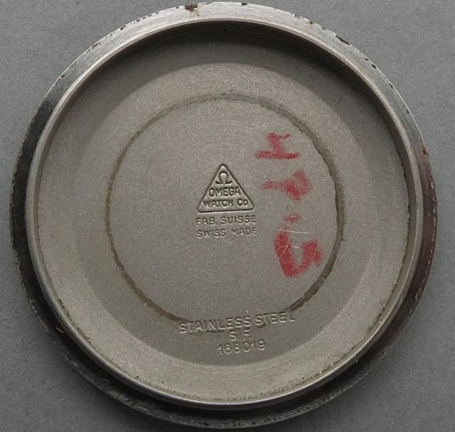

  10. Hijak Jan 19, 2015
    7,225
    24,337
    I personally would pass on both...
    This is one of many reasons why. (Look at the inside of each case back) 600 euro for grey one much too high.
