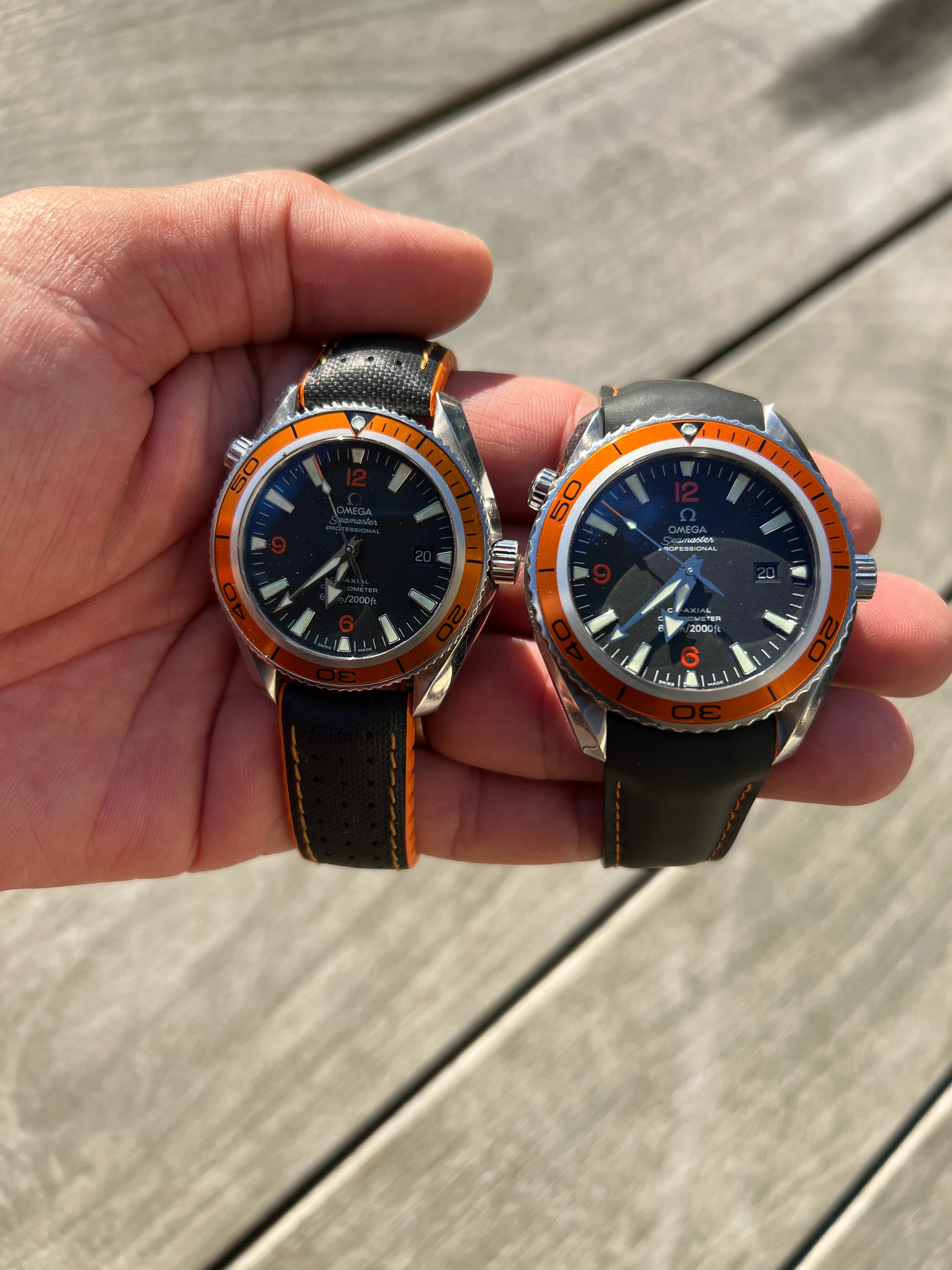

Also, I'm assuming it's the 42mm version you're looking for. As I'm sure you know, there was a 45.5mm version of the Planet Ocean in the same colorway and in photos it looks nearly identical to the 42mm version (other than the size, which is impossible to tell when the watch is photographed in isolation). The 42mm is model 2201.50 and the 45.5mm is model 2200.50.
For me, the "tell" in photos between a 42mm PO and the 45.5mm PO is that the 45.5 has a date that is further away from the edge of the dial (i.e., closer to the dial center). If you compare photos side by side you will see the difference. Unsophisticated sellers could confuse the two models.
4
Also, the "gear teeth" in the bezel are very different, with the 42mm being more squared off, and the 45mm being rounder and more pointed.
