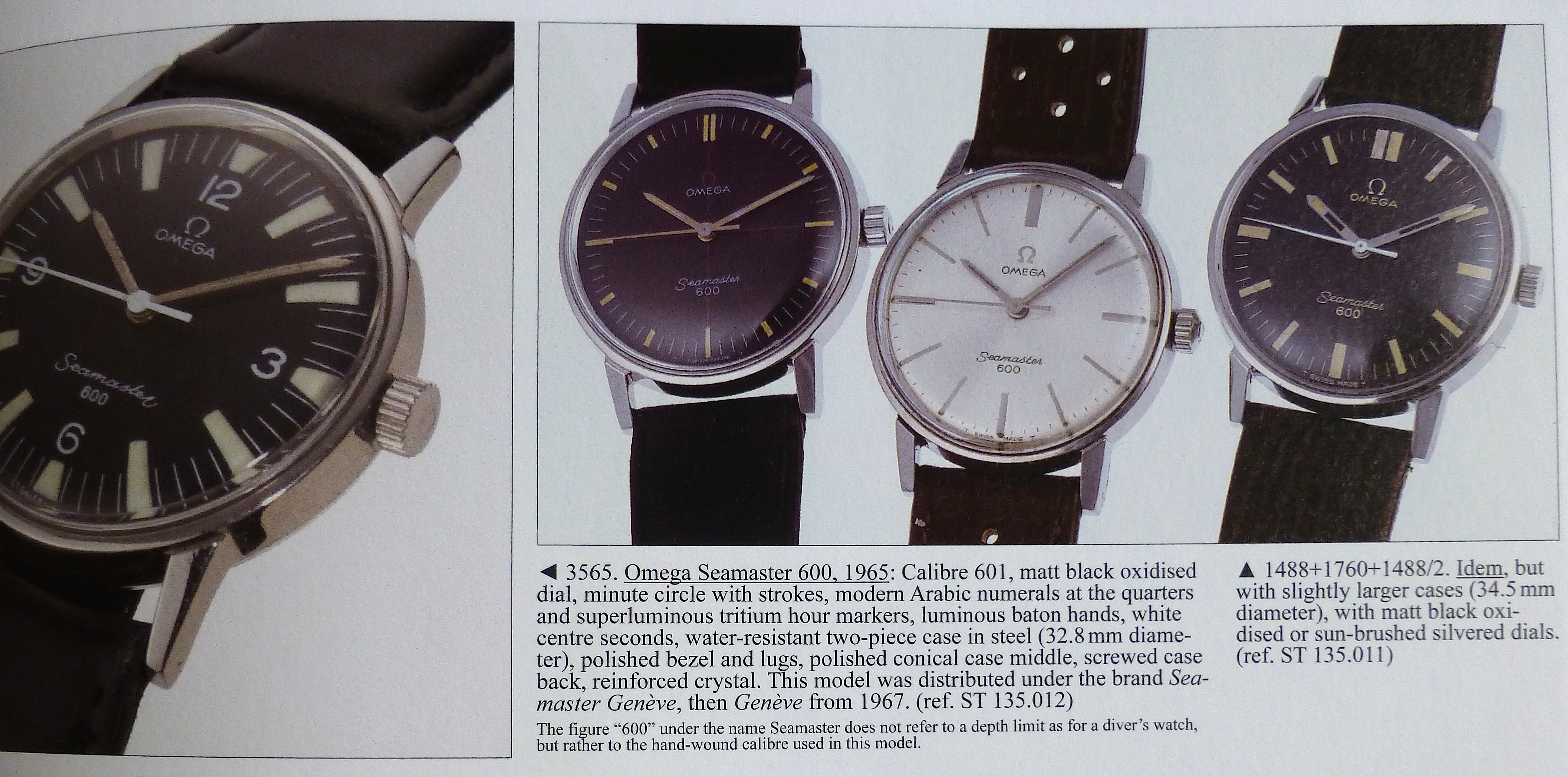

    I'm pretty sure the answer is no, but I've seen a couple semi-convincing ones that makes me unsure. What do you experts have to say?
    [​IMG] [​IMG]
    Just one example above, but are any of these black dials original?

    They sure did, but I don't know if that ^^^^^ style was originally black.
    I know of the black dial "Speedie" Seamaster 600s, in fact one is owned by @Alpha, who is probably never going to give it up.

    OPs watch appears to be correct and original.
    Printing appears to be gilt, which is correct and the gold figures are still crisp. Since the figures on this type of dial are not applied (removable) this points to originality since they are usually polished over when refinished.
