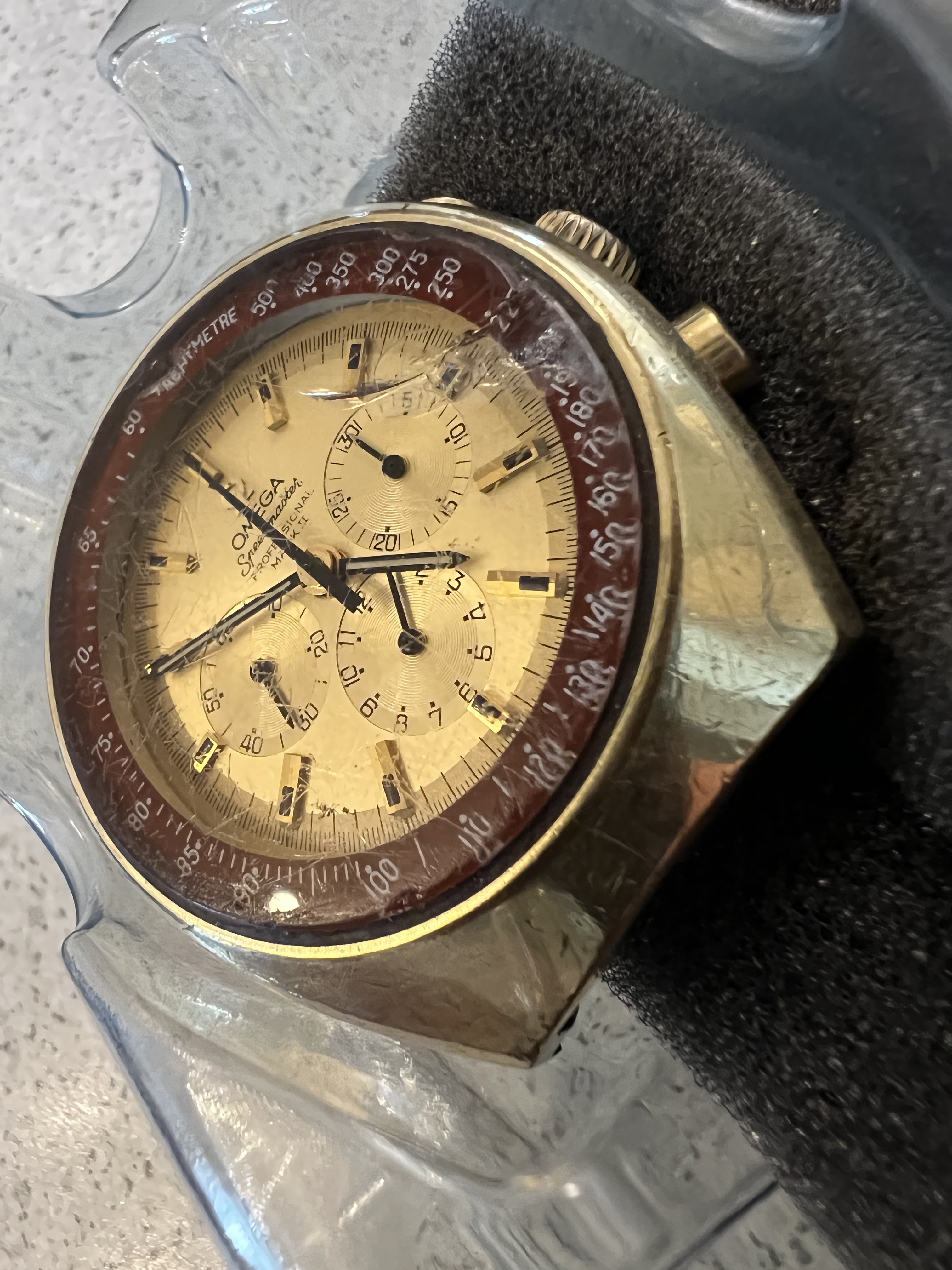

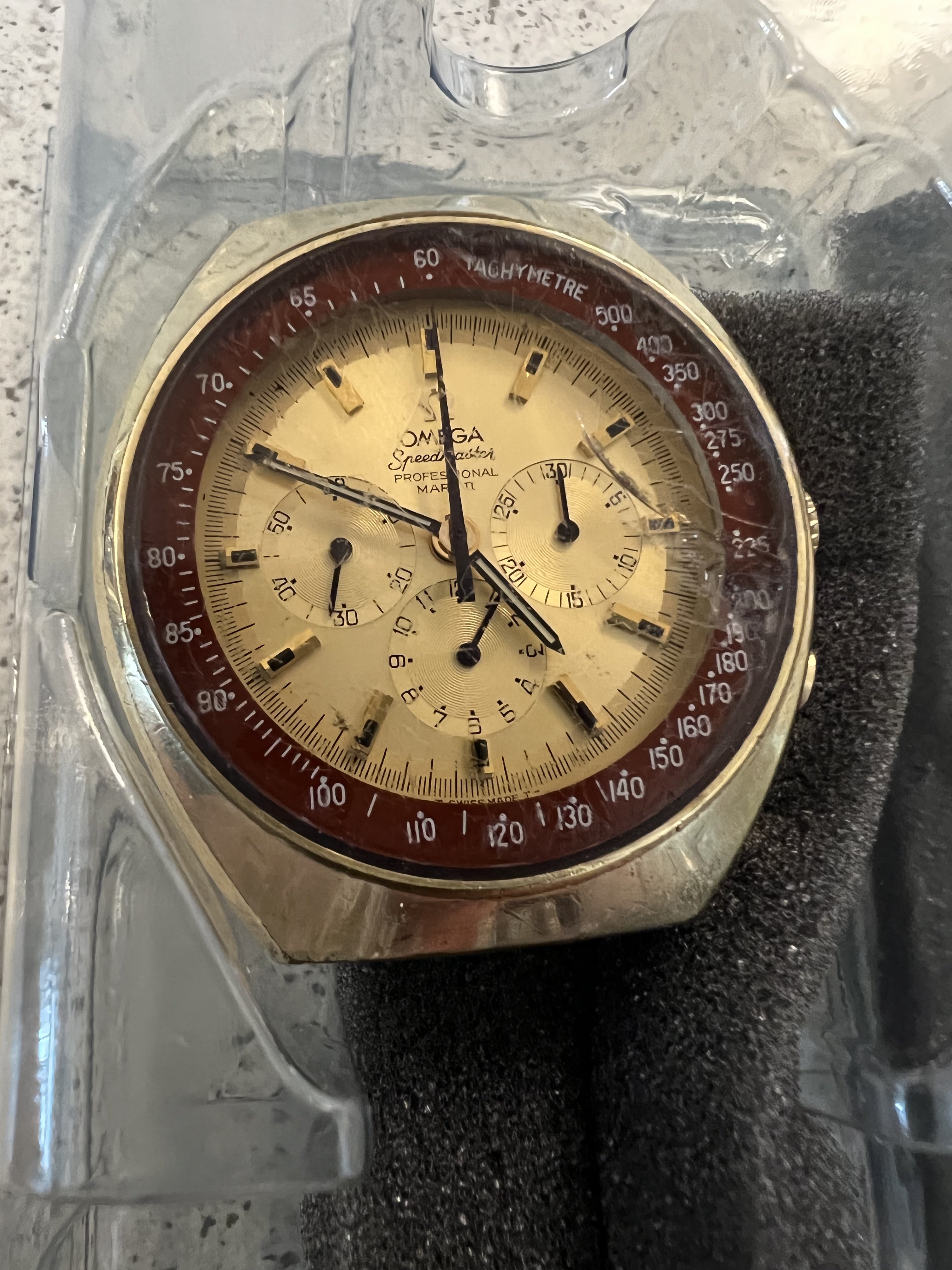

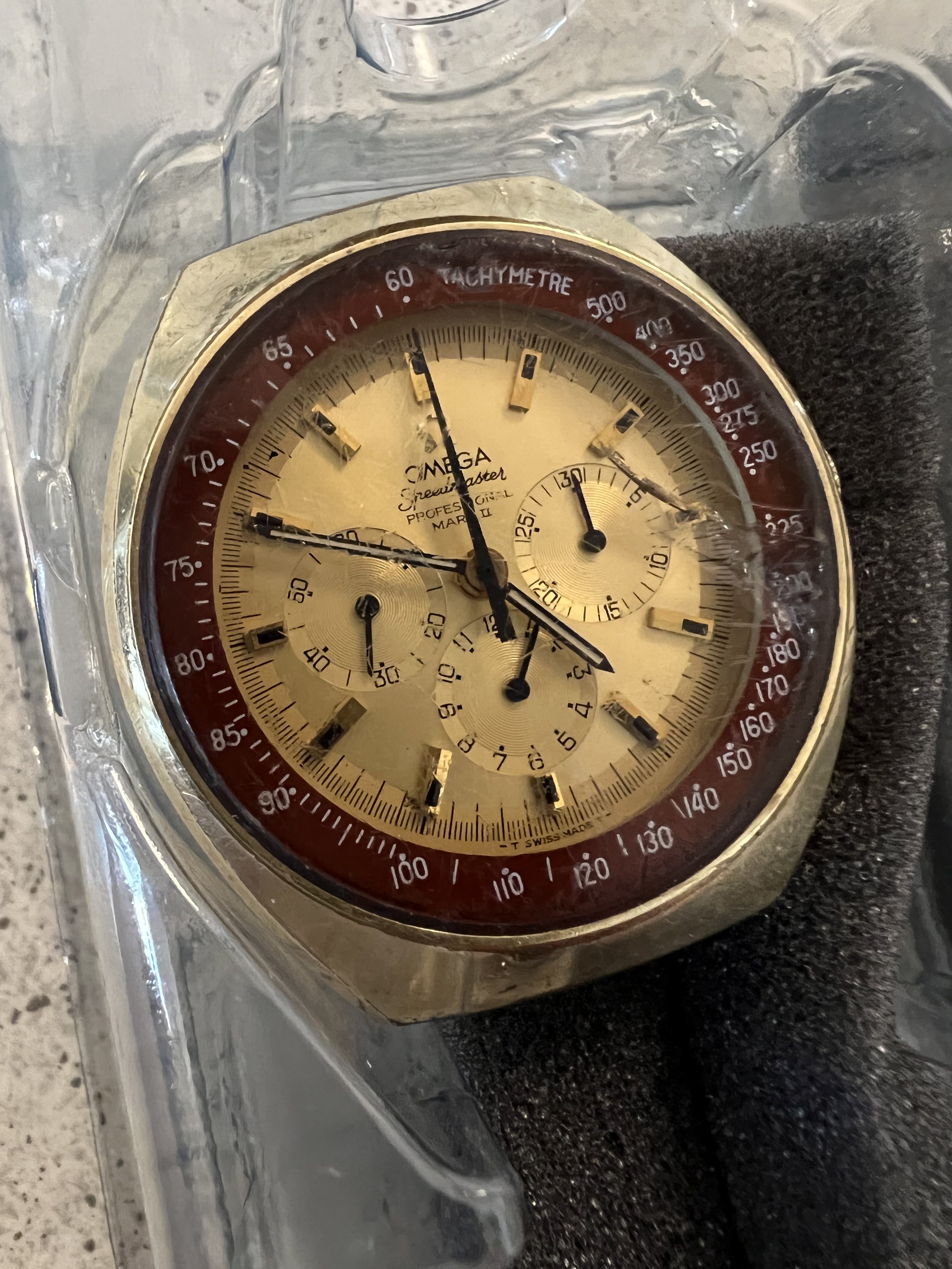

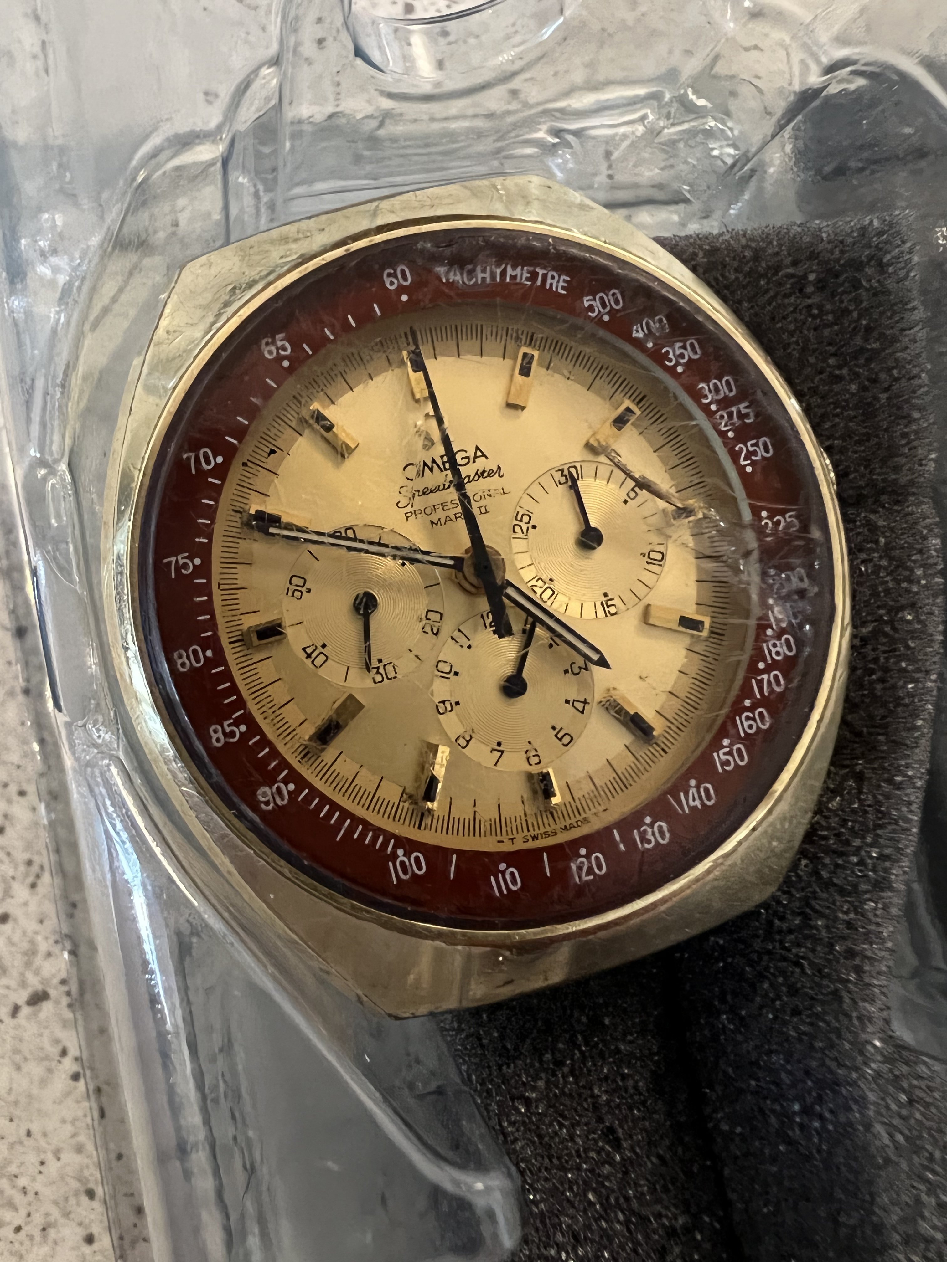

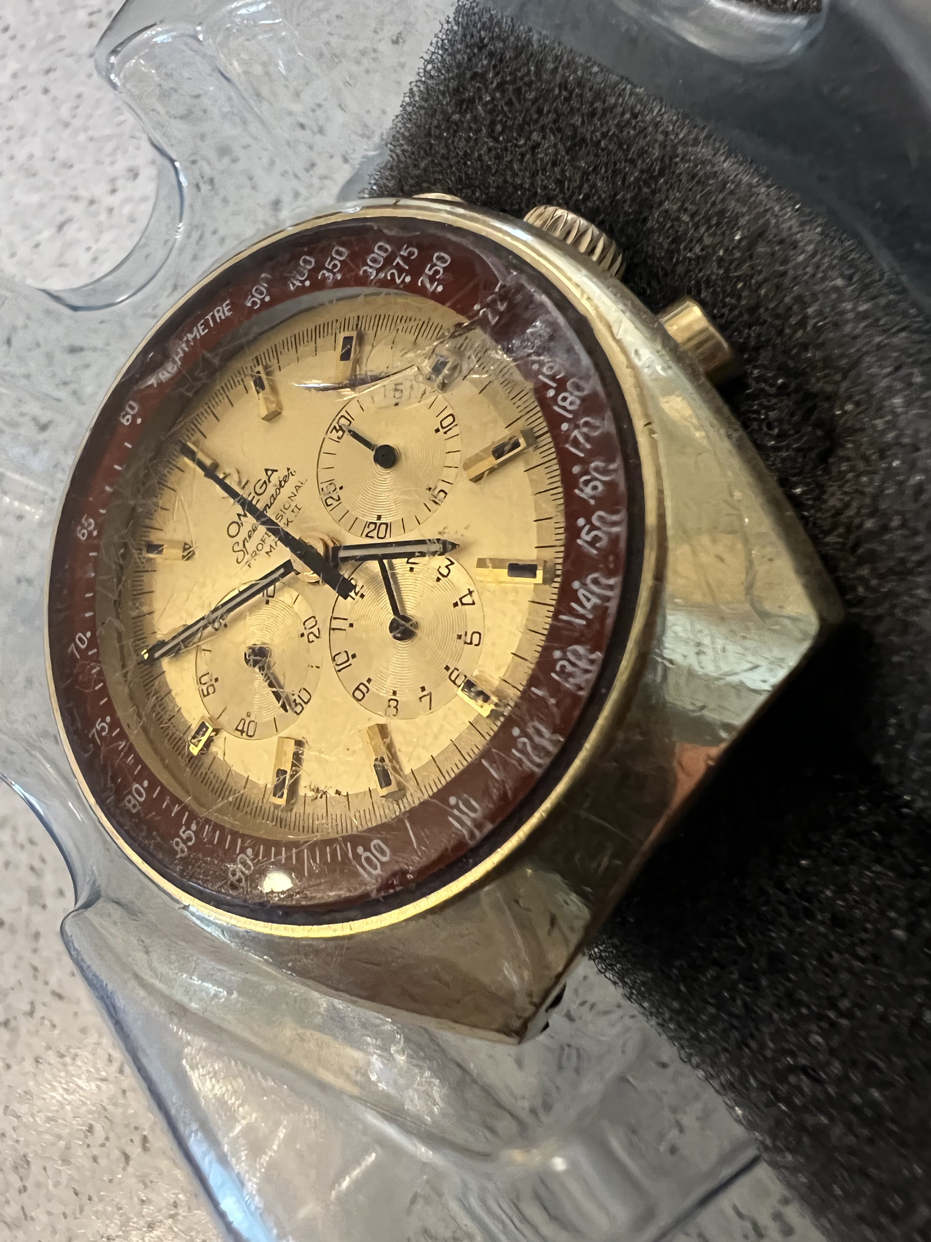

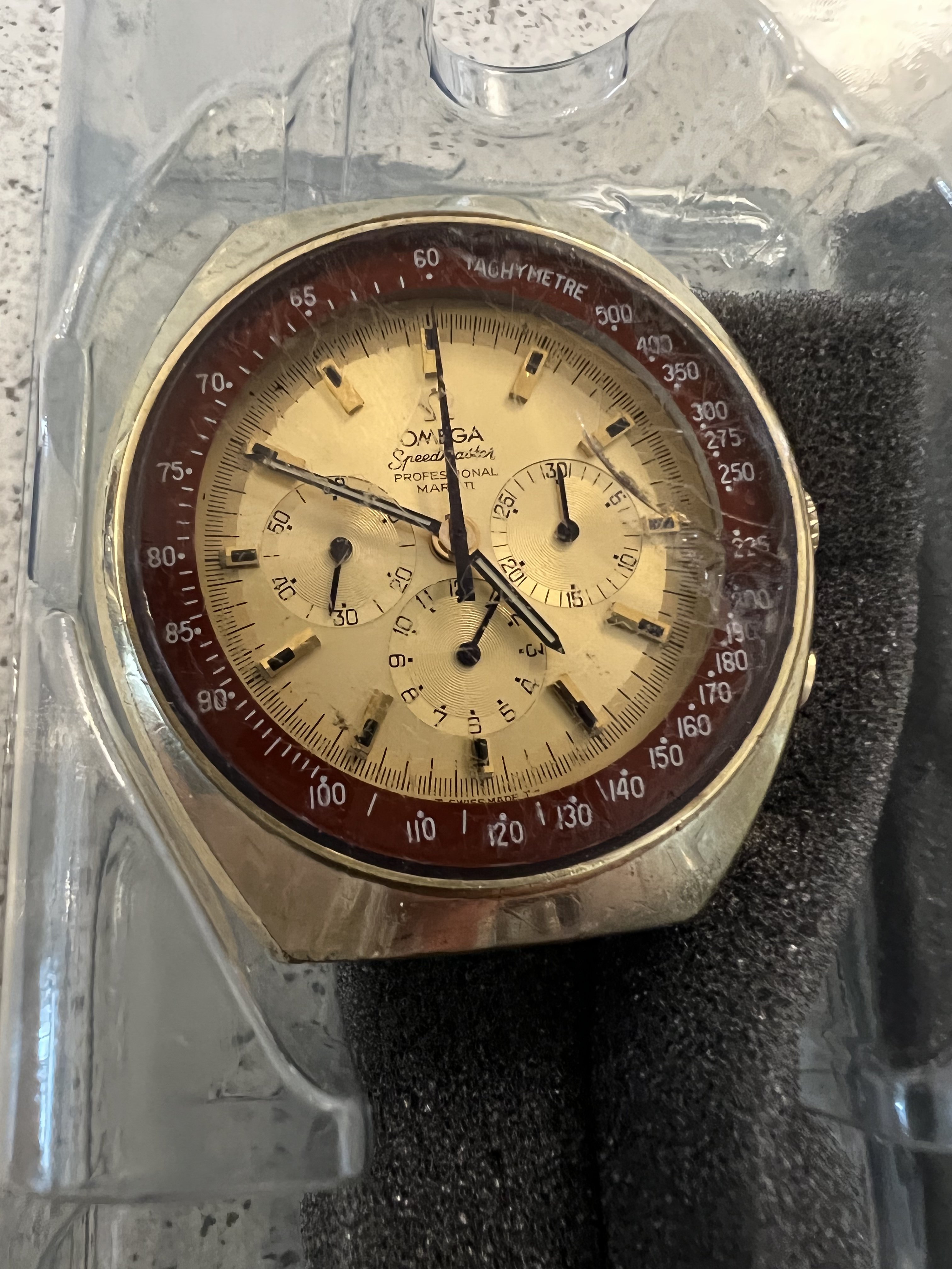

Based on these pics, I strongly recommend to get the watch back from Omega and find an independent watchmaker.
I don't see any severe problems with the dial and would leave it as it is.

I have the watch in my possession. I sent it out back in 2019. I was in my safe last night, and my wife asked when I was going to have it serviced.
