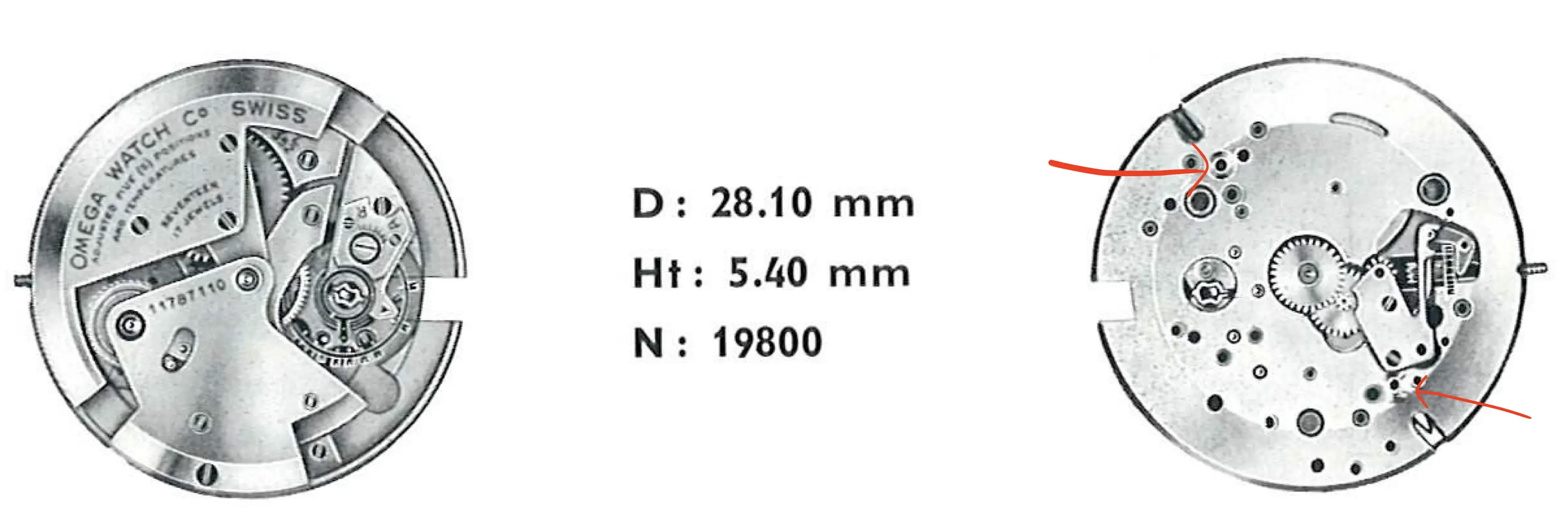

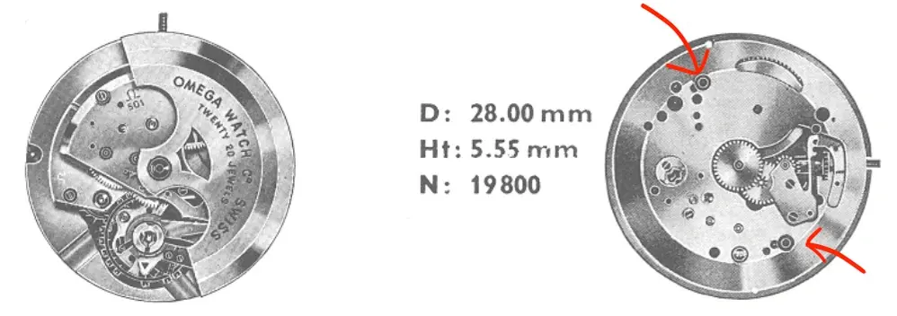

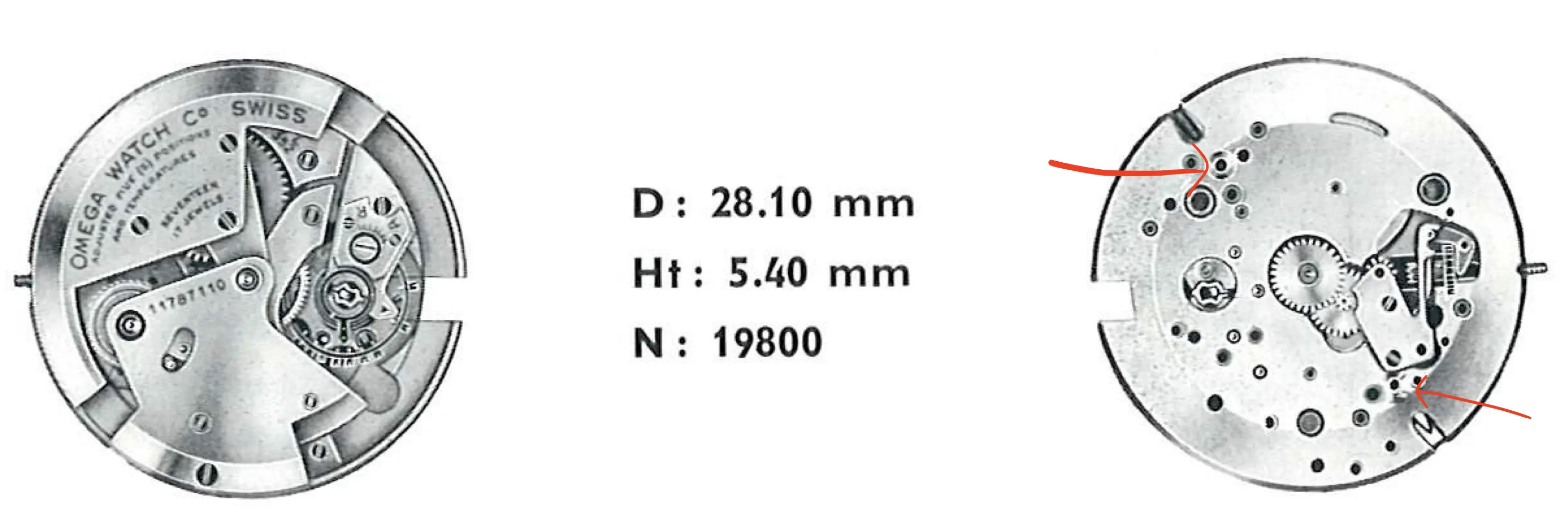

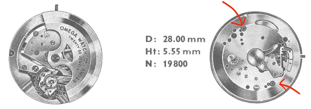

Hello 😀
I figured that using the original omega technical sheets would be good to show where the dial feet are.
I pointed them with red arrows.
You can use the crown stem as a reference for the positioning.
Cal.501
Cal.352
