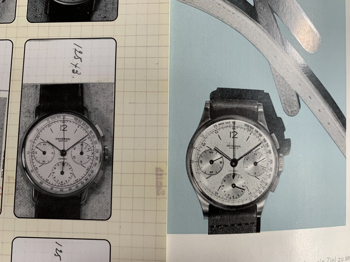

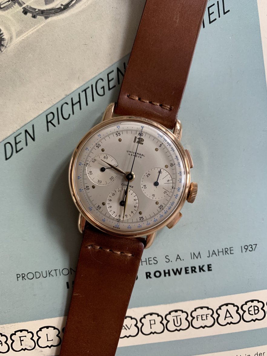

Hello everyone, I don‘t really know where this will be going to, but I have discovered a dial that is mounted on a different case (Ref. 12543) in the archives from the Sala book than in an old watch brochure from 1938. so, it’s the same dial, mounted in 2 different cases. Now, I own a ref 12543 (with a different dial), and the serial is in the 828xxx range. This hints that the case is from roughly 1941 to 1942. So, what do you guys think - did UG order dials at a certain point and used them throughout a couple of years until they ran out?
Here‘s Sala and the brochure side by side:
and heres my 12543:

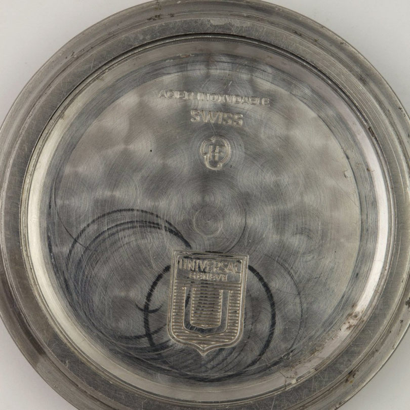

Anyone know who supplied these cases to UG?
If you are looking for a specific casemaker - there‘s a whole section about the casemakers in the sala-book. This applies to gold-cases though, as these were equipped with a hammer-logo with a number. The numbers referred to a case-maker. You will find these markings in the caseback of your solid gold UGs. Dunno if that helps.

thanks. I’ve seen this section and it’s very enlightening. I’m wanting to learn more about the stainless steel cases like those on the Polerouter Sub, Soace-Compax and the Ninas etc.

Me too. So, if there’s anyone who can enlighten us... 😀
