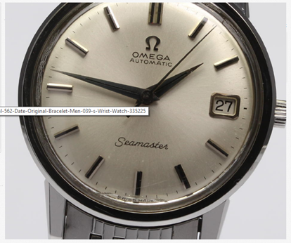

    Ebay:

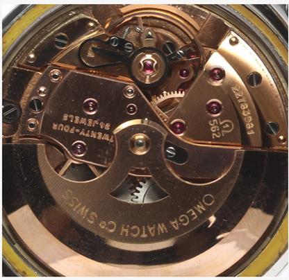

    Movement 562
    Cross-hair Dial and Dauphine Hands with Riveted Hour Markers
    The closest reference I found was 166.0003 (https://www.omegawatches.com/planet-omega/heritage/vintage-details/14477/). Please note that on the database this reference does not have a cross-hair dial and has the elongated "S" with straight lines. Is the one on ebay authentic?
    I found another watch online which seems to fit the ref. 166.0003, without the added cross-hair, however, the "S" of the "Seamaster" is once more the smooth curved "S" rather than the elongated one shown on the Omega Vintage Database. Does that mean it has been redialed?

    The answer to Question 3 is Yes. As far as is possible to tell from these photos, the dials look original on both examples you show. A more general answer to your post would be that there is no substitute for experience. For instance, did you spot that the crowns are different on both examples? It's probably best to do a good six months of intensive research before buying any vintage Omega. Good luck with that first purchase when you finally make it.
