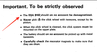

Hi
I bought a gorgeous Geneve f300 from someone on here. It's running beautifully, but when I do a magnetism test, it sends my compass 40 degrees off.
I bought a cheapo demag box. Can I safely use it on an f300, or does it need something different?
Thanks

Quartz watches have magnets inside, demagnetising them is intrusive since it'll likely mess up the motor etc.
I've just tested 2 of my 300Hz's - they are magnetic too
TL;DR: Don't 😁
