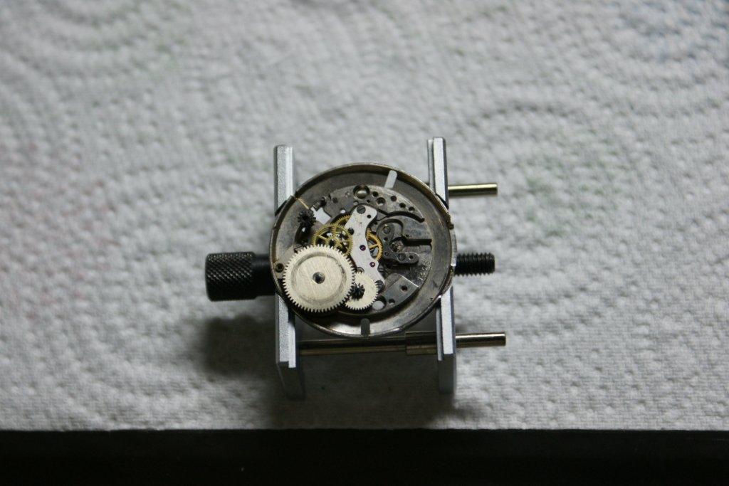

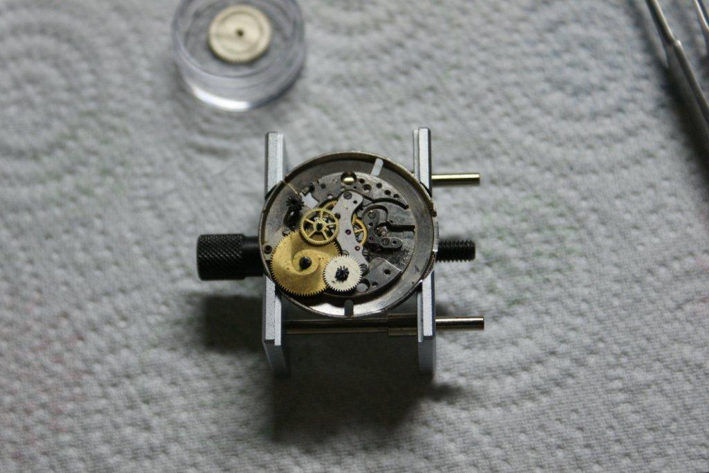

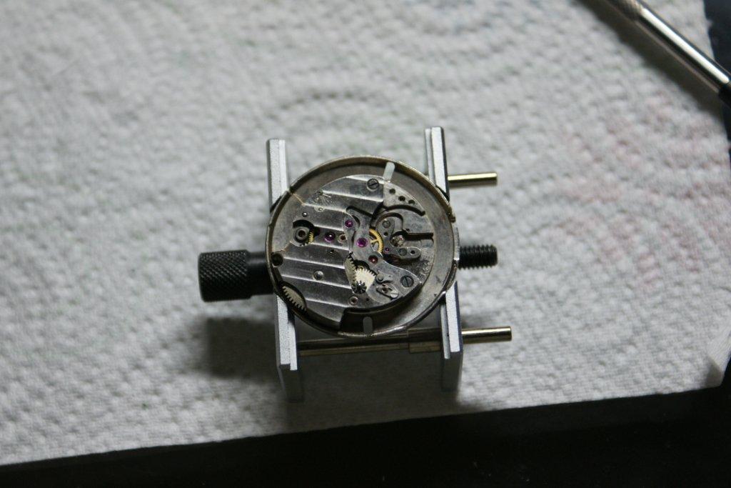

    Dr Frankenstein had really gone to town getting this one into its new case. There were six places on the base plate where it had been damaged or filed to get it to fit. For those new bumper owners, I took some pictures to show you what the oily bits look like.

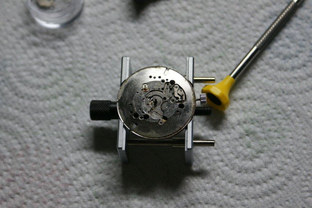

    Uncased, hands and dial off (plus two screws before I decided to take pictures)

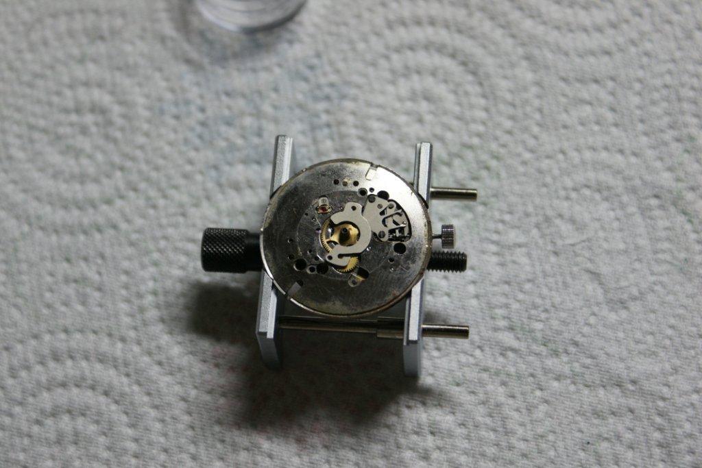

    The setting mechanism

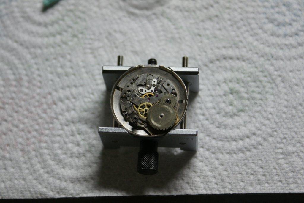

    Turned over, this is what it looks like whole

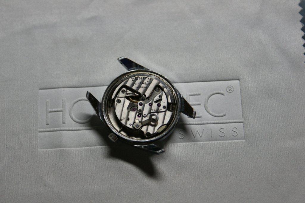

    The bridge for the oscillating weight removed
    The weight removed
    The balance cock removed
    That is one big, awkward shaped bridge removed. I suspect it will be an act of great patience to replace when I get onto the Chronometre

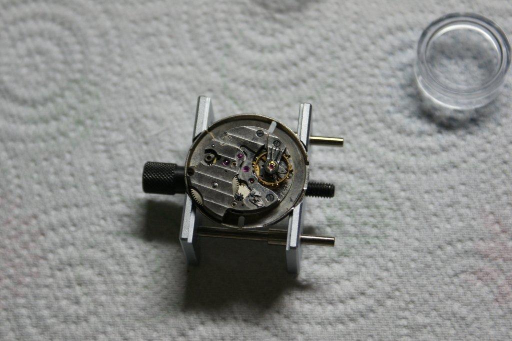

    Same view, turned through 90 degrees
    So that's where the mainspring is hiding

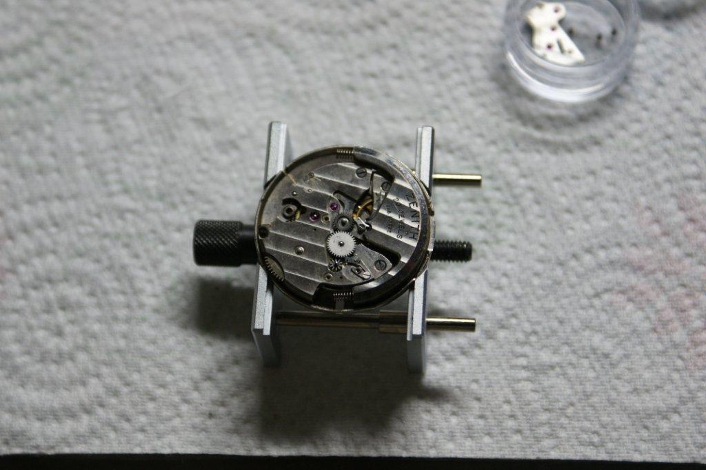

    Barrel removed, just the wheels, palet & bridge and that seized screw holding the flat spring on the left.
