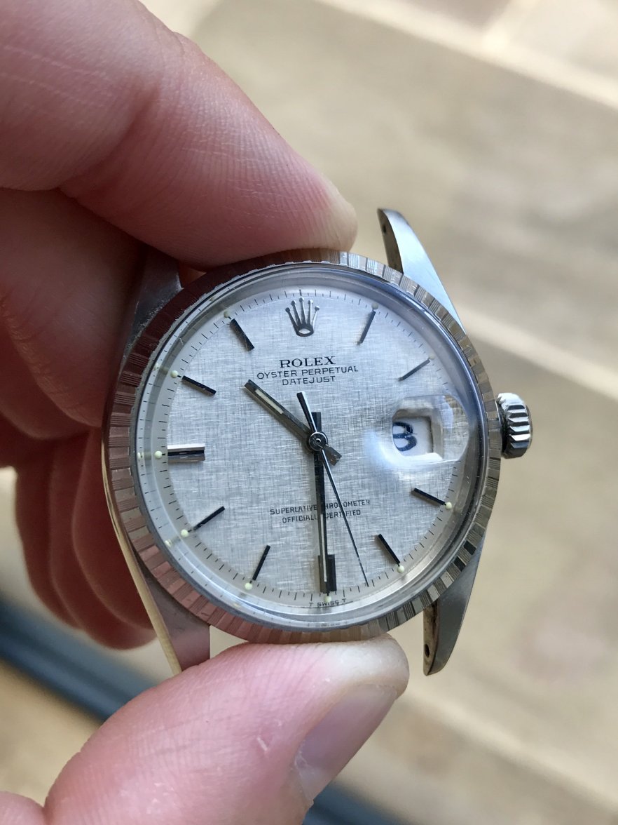

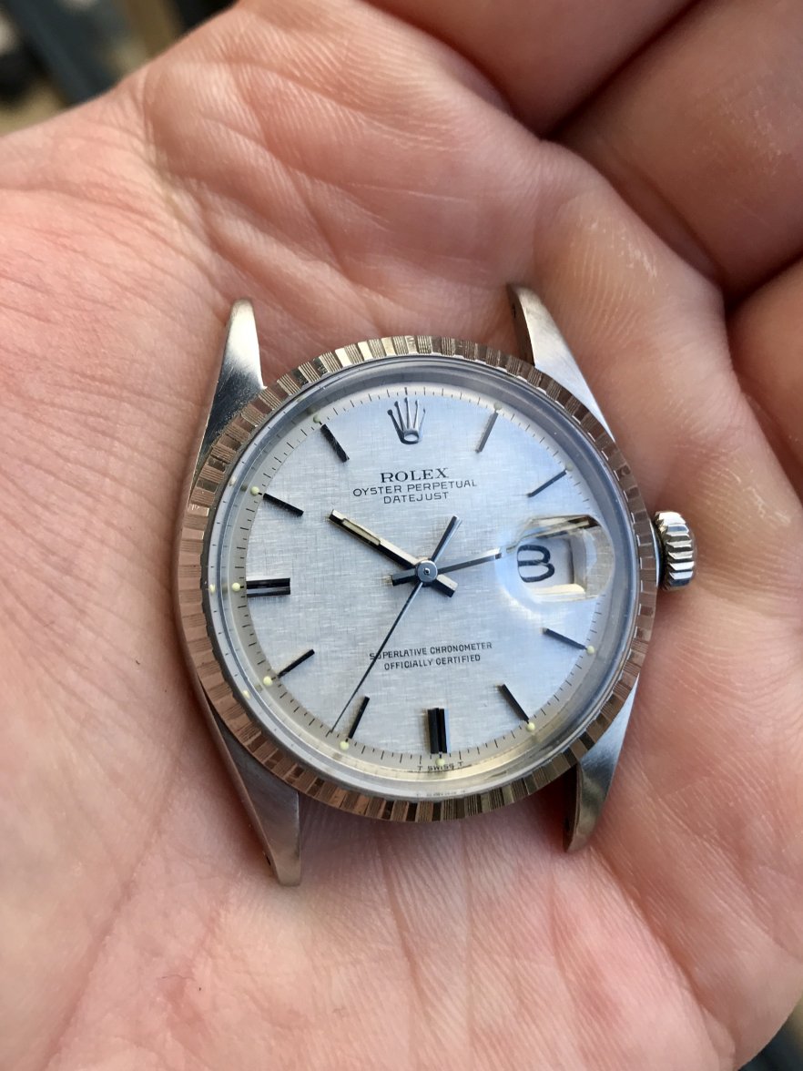

Anyway, this arrived this morning. 1603 with linen/textured dial, 2,2xx,xxx serial and what I think is the original jubilee. The lume looks wonderful and the dial as a whole I find mesmerising.
I just have one question on the 'J' in DateJust. Most dials I've seen have a 'crossed J' with a bar at the top. However, mine (and other examples I've seen) has a 'straight J'. I've only seen this is examples up to around 1970. Does anyone have any thoughts on this? Is it a legitimate 60's variation or is there something amis?

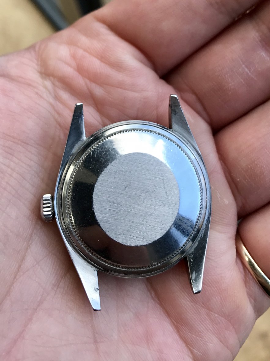

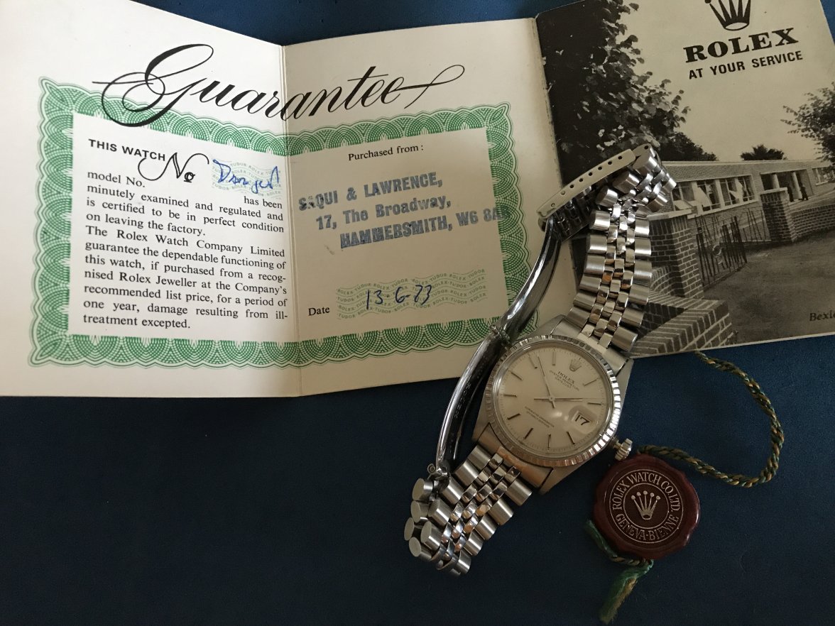

Its fine. I have a 1603 with the straight J. Ser 2,156,xxx, caseback made Q1 68, That was Sold in UK In 1973
1,325
1,872

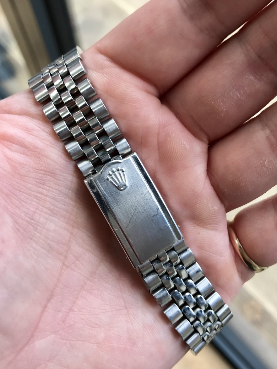

Forgot to mention, the bracelet clasp should be dated on the reverse of the clasp? And these seem to come with the drop down 7 date wheel, like this

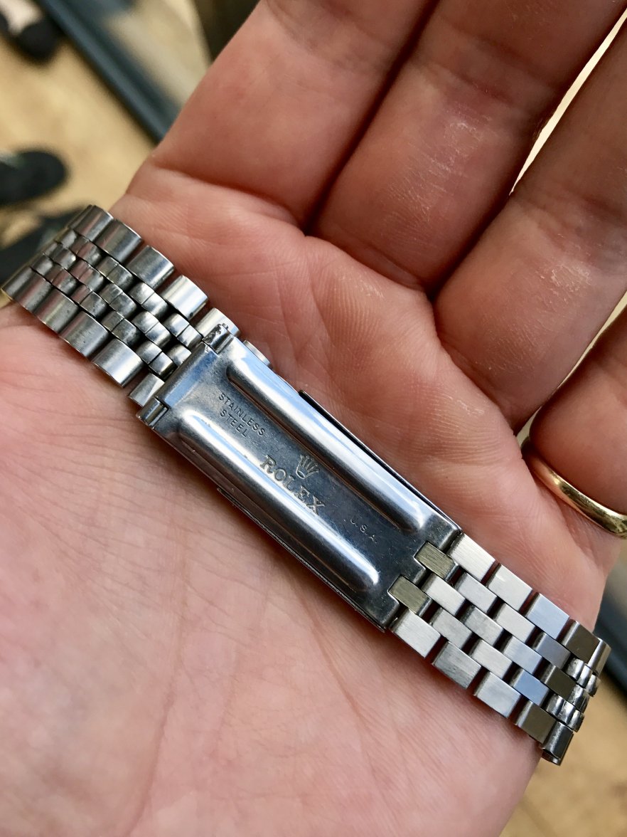

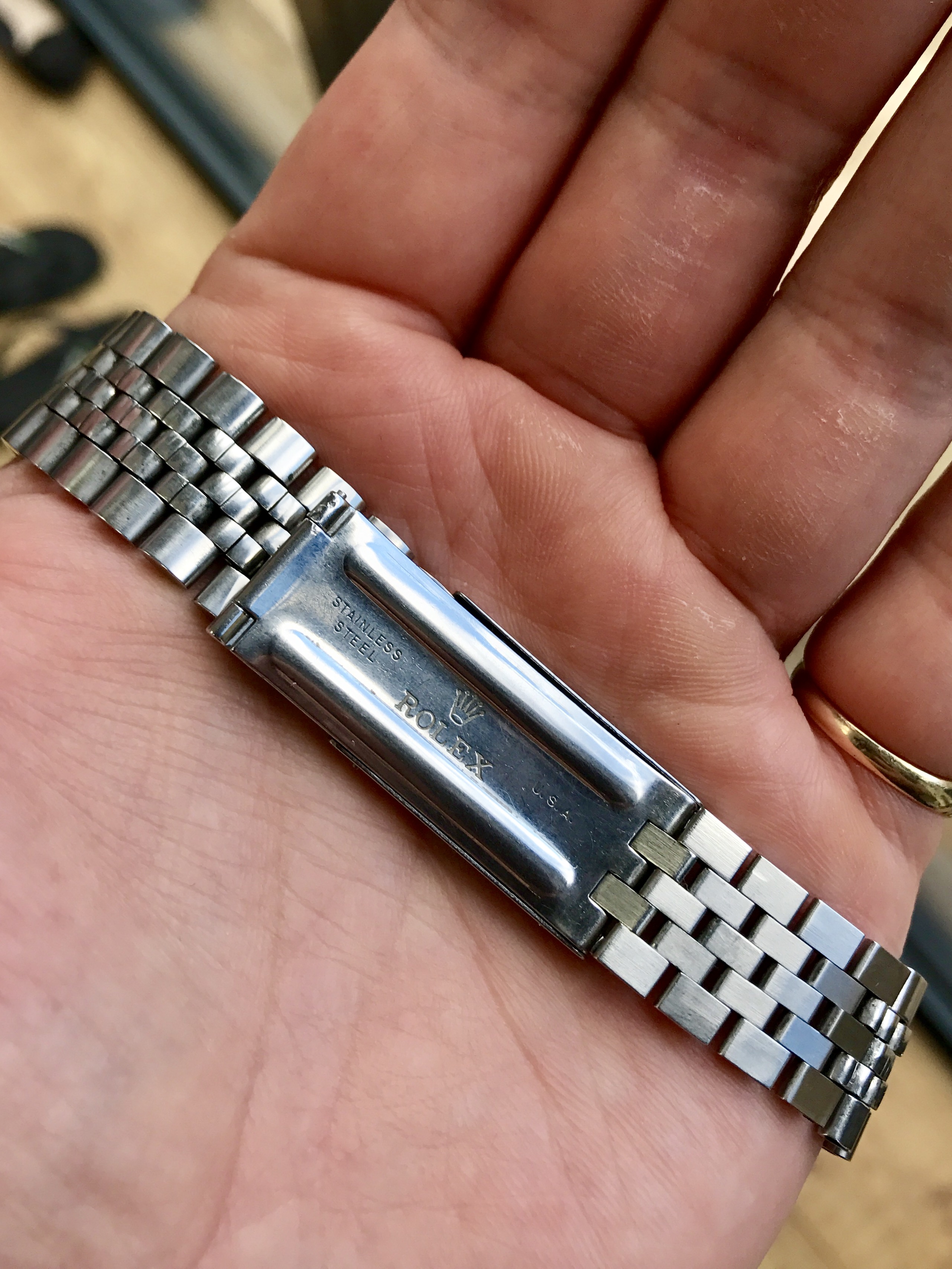

I'd be more concerned with the bracelet. Mixture of oval and D link
I just noticed that thought it looked weird
1,325
1,872
I spotted that too and sent David a message back channel

Funnily enough I didn't notice this until I saw my own picture. It's only the removable links so I'll try and source some correct ones.
All part of the learning process but as long as the head is correct I'm happy.

You might want to take a closer look as you might need more parts than that. Seems they got handy on your bracelet and cobbled a D link directly to your existing clasp as well.
13,522
23,461
I see what you're saying. It's not ideal but I'm sure I can sort it. The dial was the main attraction for me so if the only issue is the bracelet I can live with that.

Oh you did just fine I'm sure. Bracelets are interchangeable but a lousy head is a much bigger problem. Yours is a stunner. Let me know if you need any original USA oval links as I got some along with other bracelet parts.

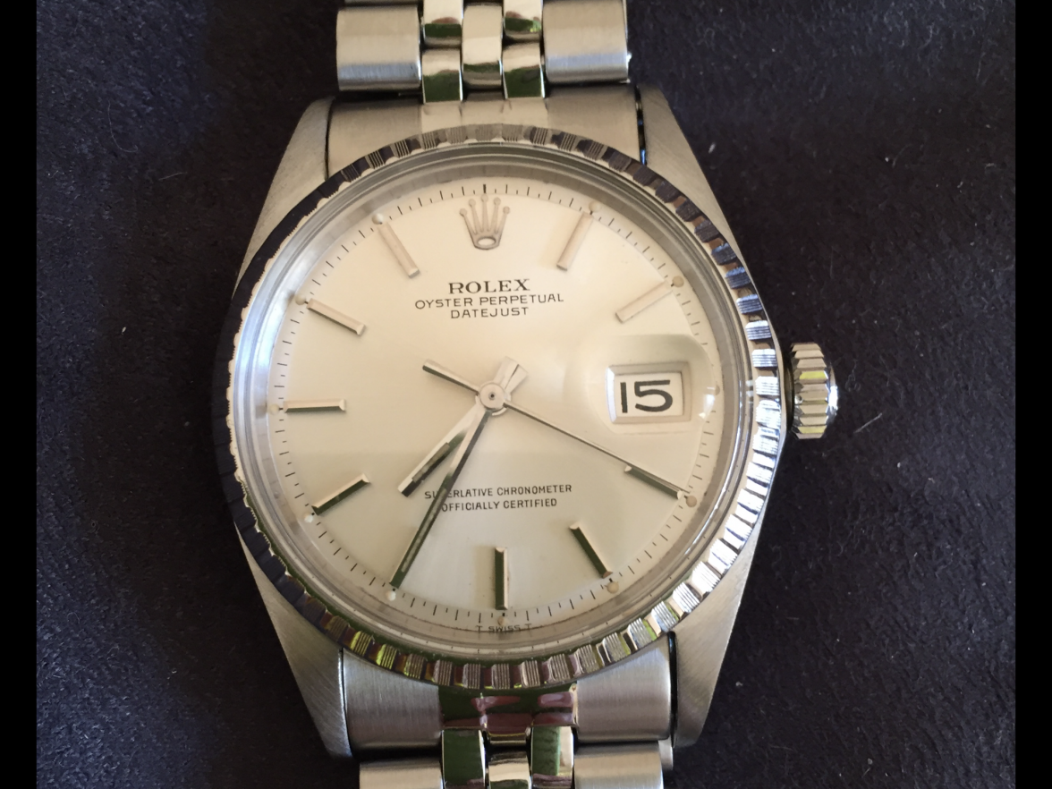

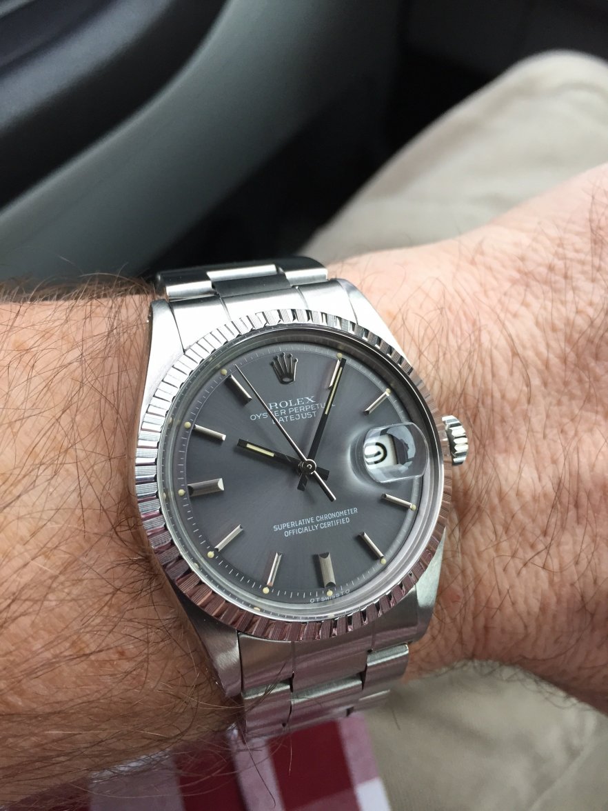

Beautiful classic Rolex .....with a beautiful dial...enjoy here’s mine..
