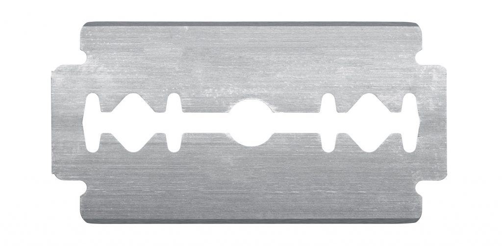

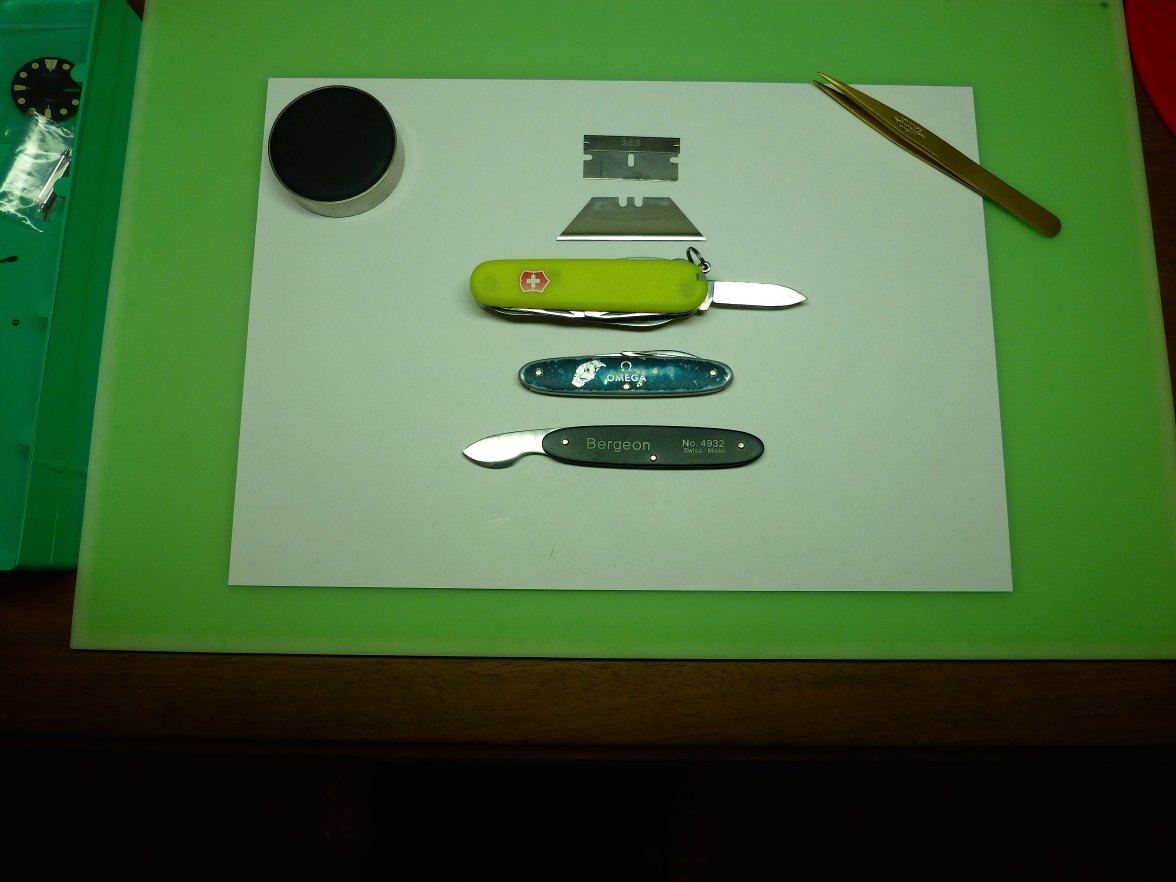

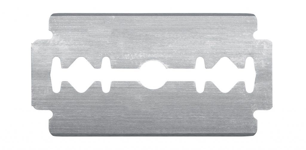

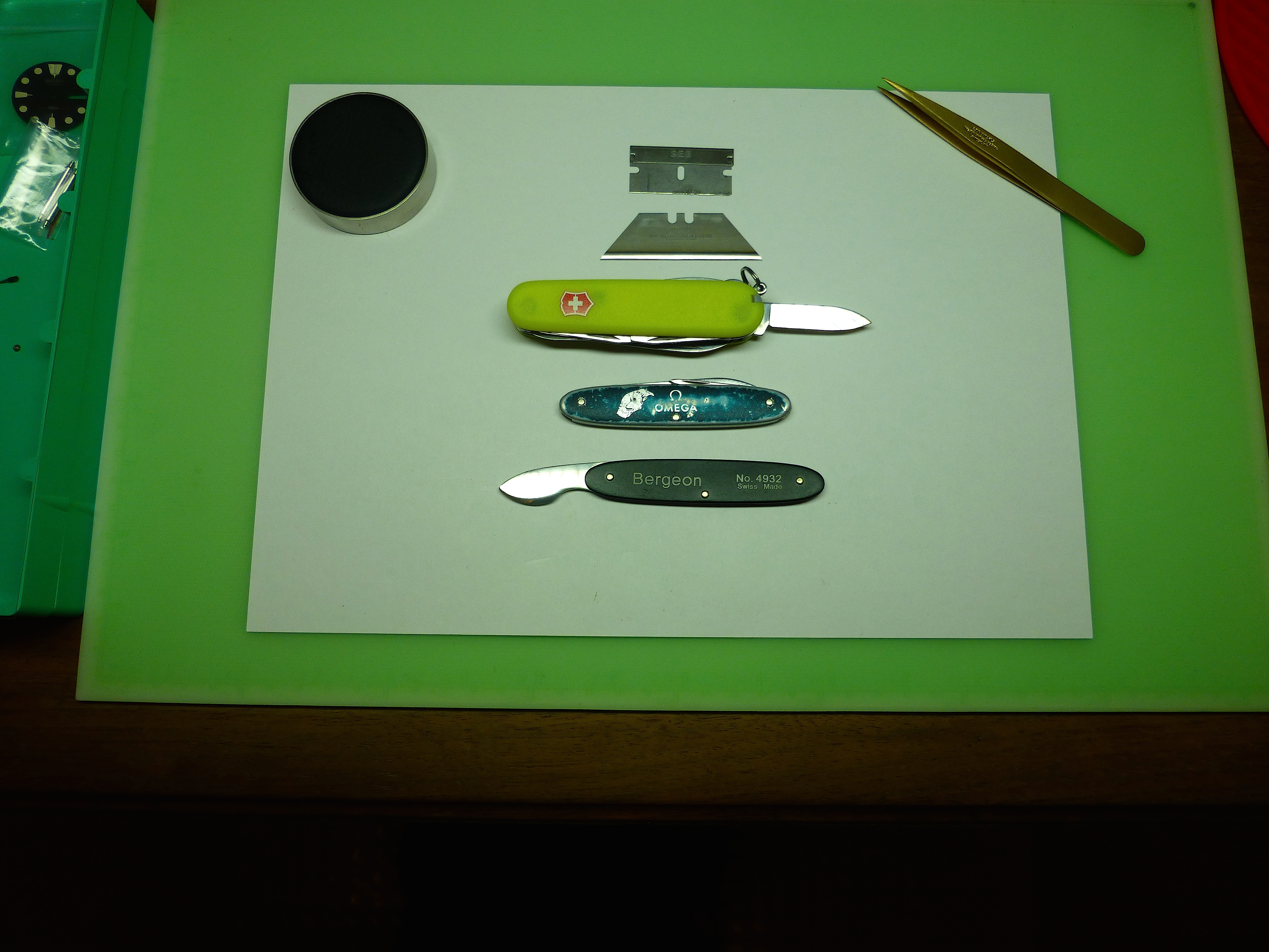

Start with a safety razor blade and use it to go around the case seam a few times.
Next, step up with a Gem razor blade, repeat the edging.
Then a fine blade, I use the pen blade on my Swiss Army knife, just ease it in all around where the previous blades have made a gap.
Follow that with a regular case knife, doing a few degrees at a time and keep going around until it pops off.
Don't be tempted to prise or twist to get it off, you could deform the caseback.
Good luck with it.
These are my usual helpers for snap backs.

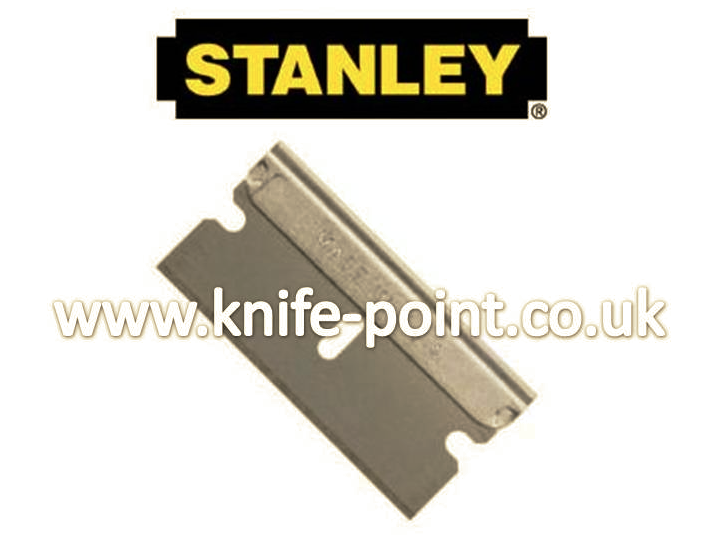

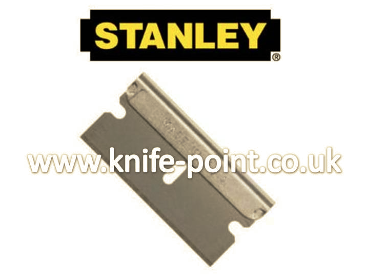

The second blade is generally called a utility knife blade and comes in a variety of thicknesses depending on whether you're cutting cardboard or drywall, etc. The Stanley 1992 is a standard utility knife blade.
