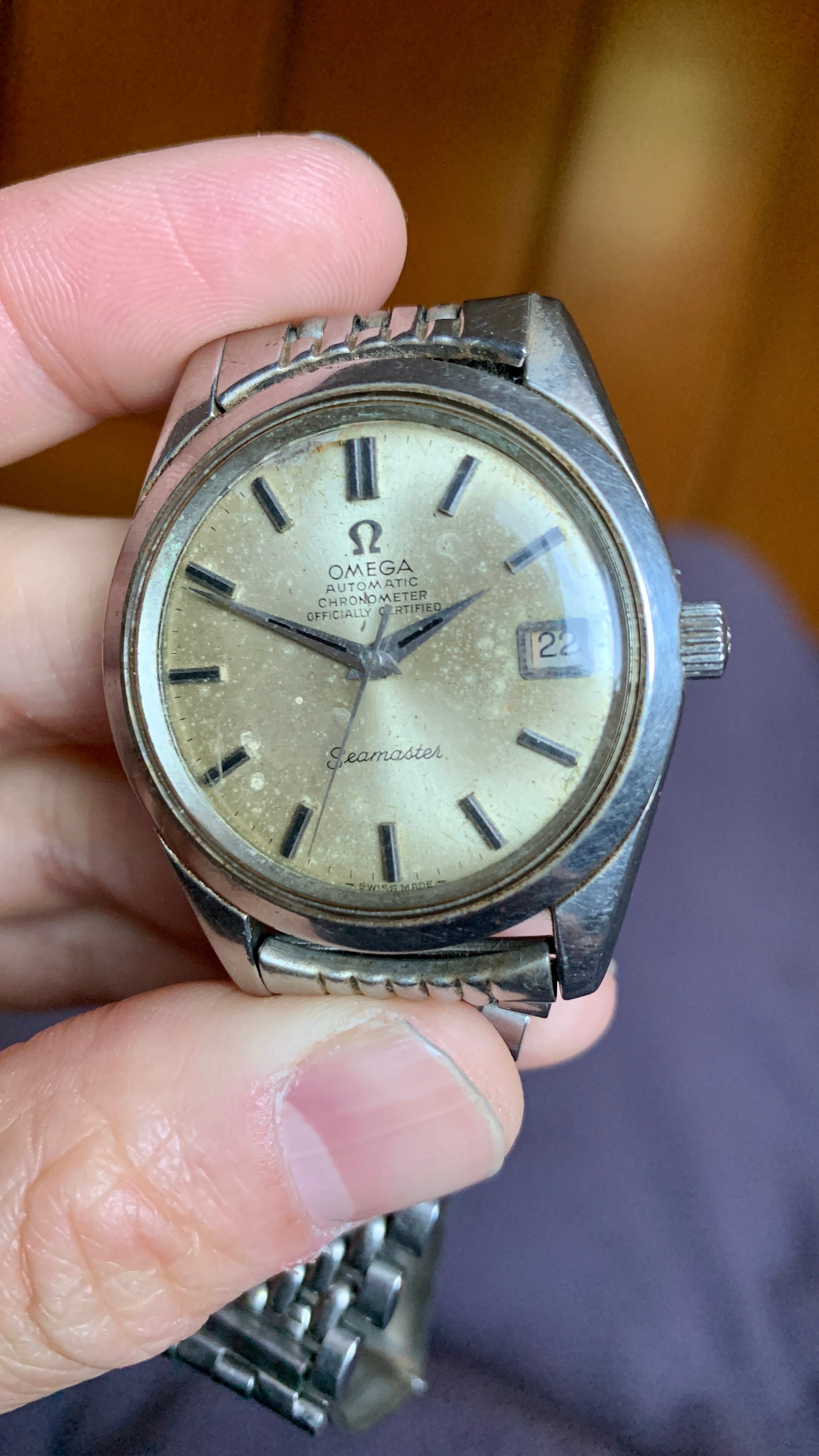

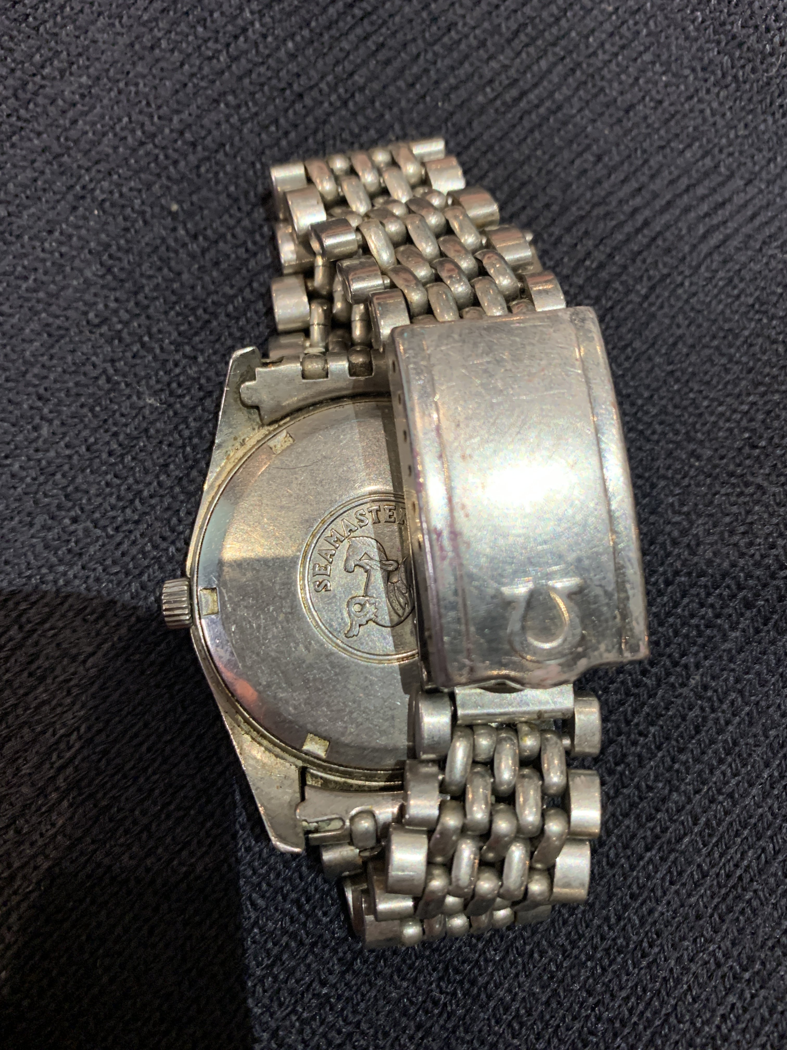

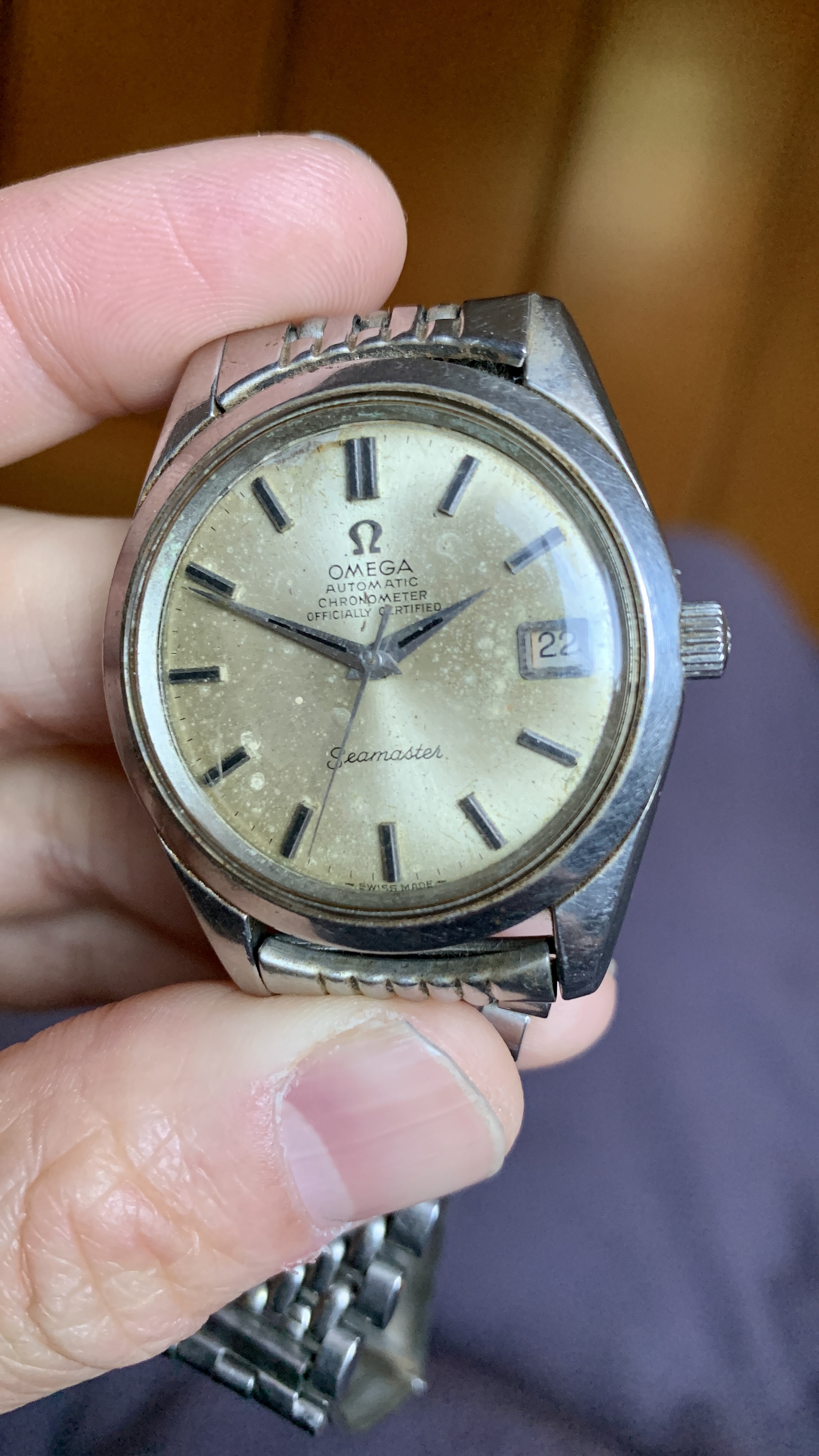

Hello everyone!

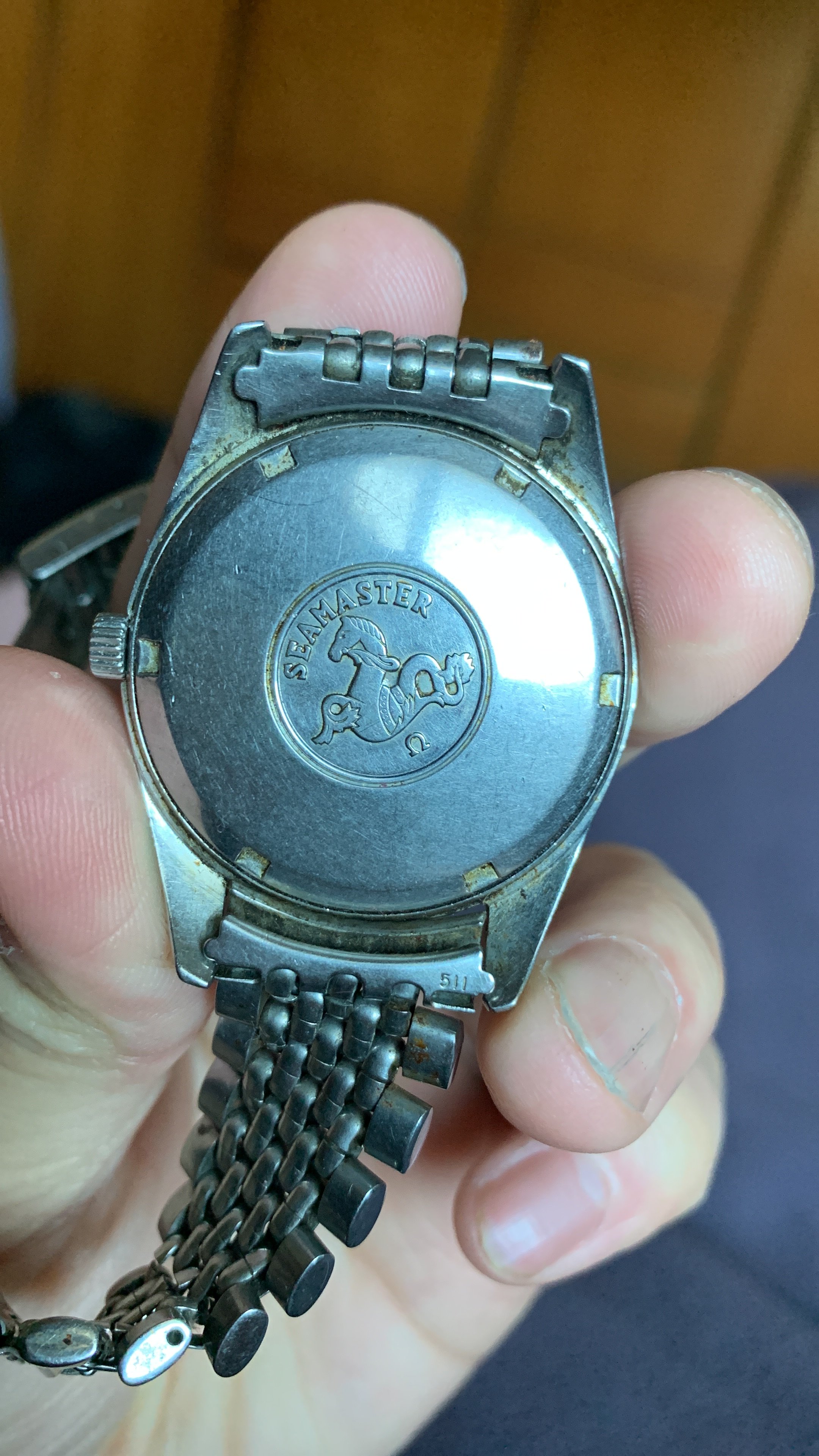

So I visited my dad and found this vintage Seamaster in his drawer, he told me he inherited from an older relative years ago. It’s been in the drawer with keychain and coins for at least 10+ years. He doesn’t wear watch nor he care about mechanical watch, so he gave it to me. Anyways, here are pictures.
I moved it and it started to work, amazing after 54 years isn’t it? I tested for hours and it moves find. However, the crown felt resistant in some spot, and the date adjustment don’t work. So I stop turning the crown to avoid damaging more than I need. Cosmetically, looks dirty and rusted, and it seems like water went in.

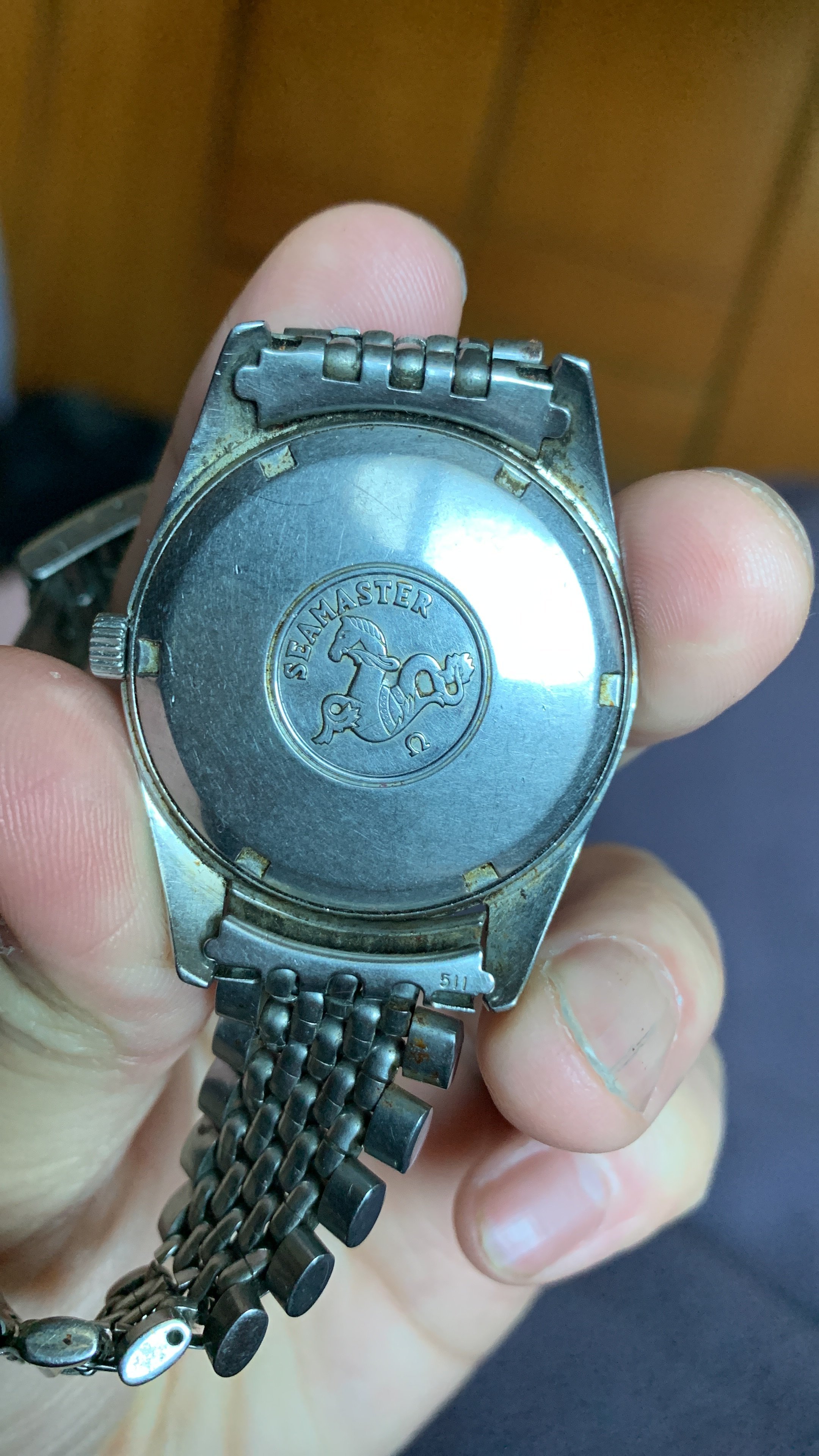

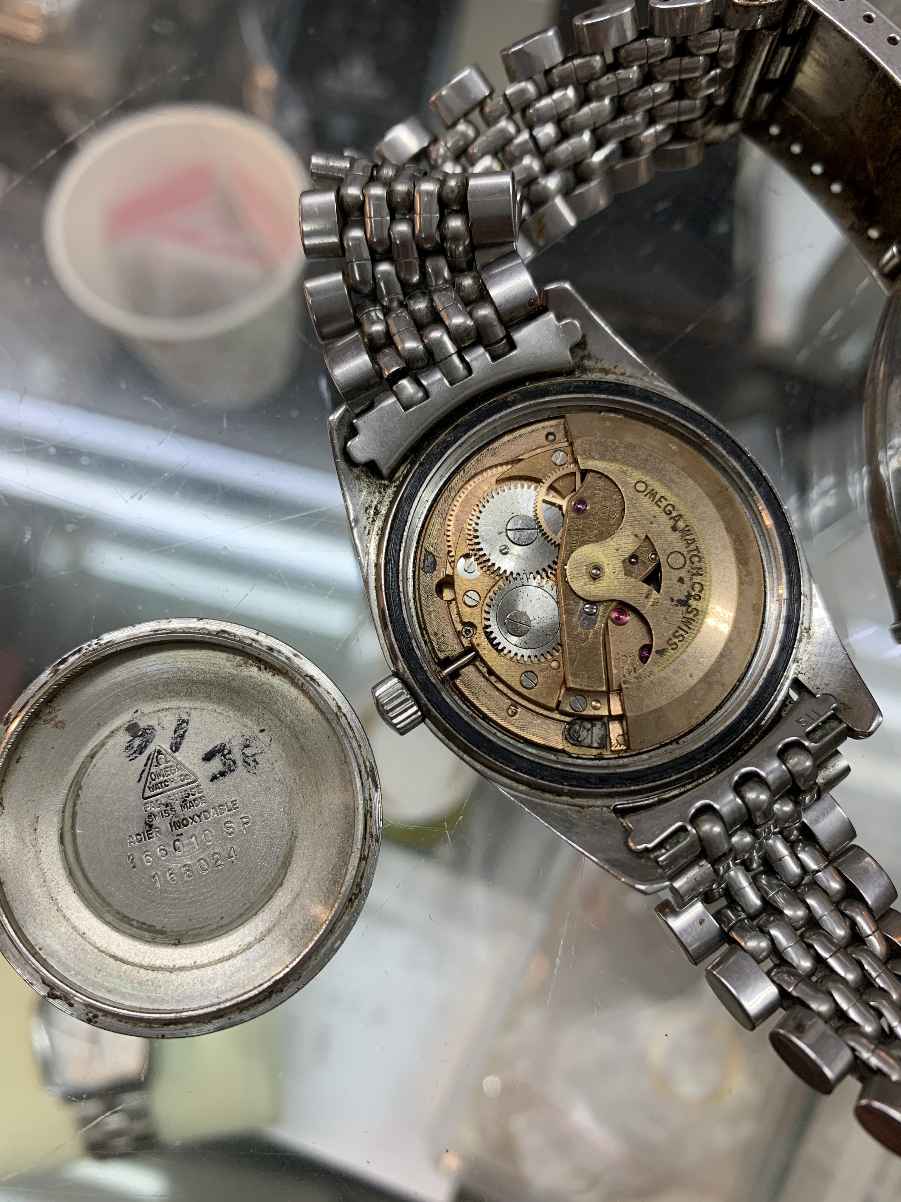

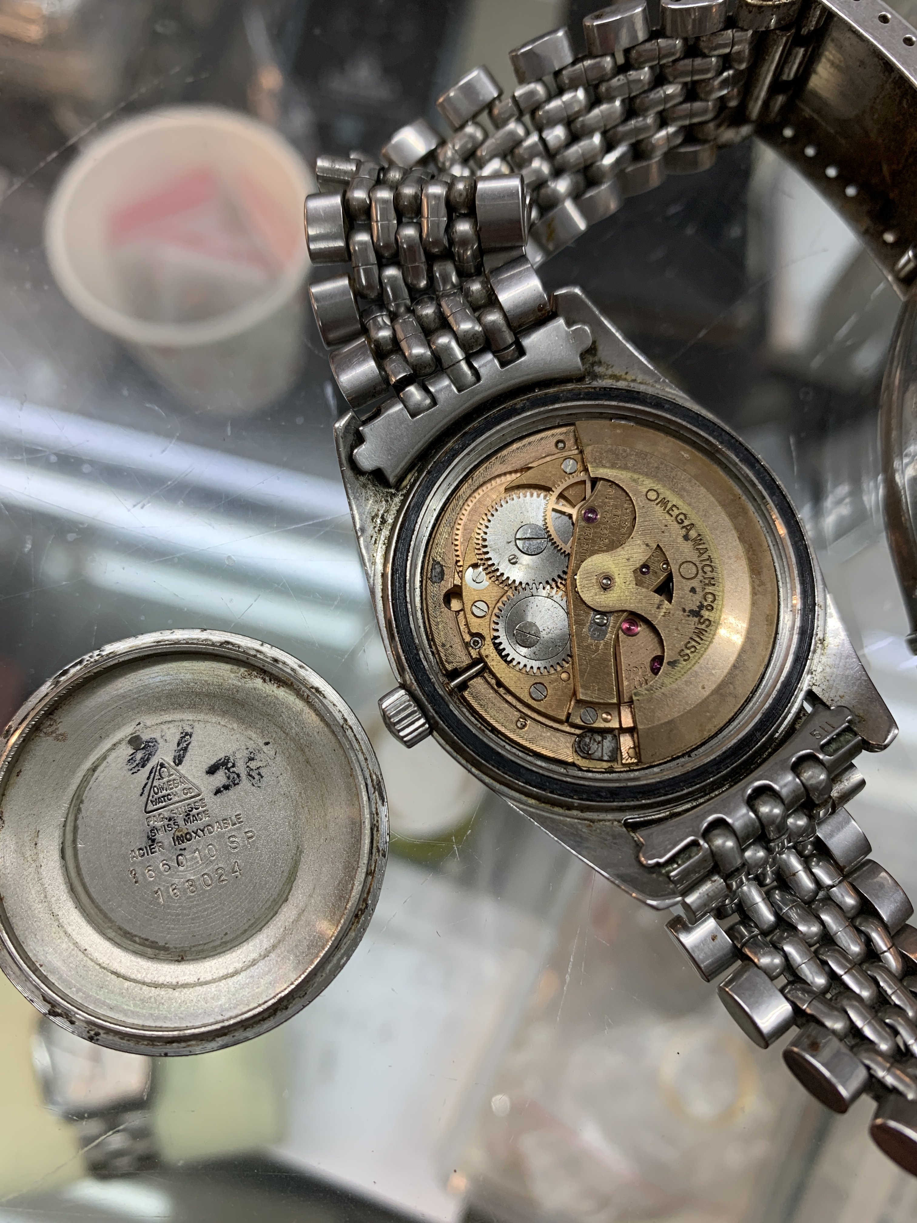

I brought it to a watch shop locally and have them inspect if this is a real Omega. Without opening the back the tech told me most likely it’s real because there wasn’t too much fakes in that generation. And here are some pictures of the back cover opened.
The Good news is, the watch is a real Omega Seamaster. According to the serial number 29xxxxxx. It’s dated 1969, with Cal 564 movement.
The tech inspected the watch and found rotor centre shaft/rod it’s rusted and caused rotor is touching the back cover. Date adjustment has issue too. And water also went in for god knows how long. The crown is rusted and all water seal needs to be replaced. He is willing to do all repair and lube/maintenance for about $300 USD($NT 8000). I figured it cost me $300 for a working vintage Omega, why not right? You can’t even buy an automatic Seiko for this price. So I sent it in for repair and will share more pictures when it’s refinished!!
My question to you all is,
1. Can you guys tell me about more history of this Seamaster?
2. Can you share pictures of yours and the reliability/experience with this watch?
3. Is there anything I should do to keep vintage watch safe?
4. Is it worth it bring it to Omega/Swatch OEM for future maintenance?
5. Is there still parts availability from Omega?
6. Anything else you can recommend
Thank you all in advance! And have a nice day

1. Can you guys tell me about more history of this Seamaster? The Seamaster was marketed as a water resistant watch when most others were not. It has a chronometer rated Cal.564 movement, meaning that it once serviced it will be very accurate. The mechanism of this watch is one of the best that can be had and is very robust. The dial (face) is dirty, but it that does not bother you, by all means get it serviced and wear it. Do not have the dial (face) cleaned. The original owner spent extra money to get the very desirable beads of rice bracelet. Make sure it fits. There is some adjustment but it cannot be enlarged beyond that without great expense. It dates from the sixties.
2. Can you share pictures of yours and the reliability/experience with this watch? This is a very reliable watch once serviced.
3. Is there anything I should do to keep vintage watch safe? Wear it often and enjoy. Don't drop it from a great distance. Beware of door knobs. It may be water resistant, but don't submerge or swim with it.
4. Is it worth it bring it to Omega/Swatch OEM for future maintenance? Do not send this to Omega/Swatch. Have it serviced locally by a qualified watch maker.
5. Is there still parts availability from Omega? There are plenty of parts for this watch out there.
6. Anything else you can recommend. Have the watch maker sonic clean the case and bracelet when service. It is a personal choice, but I would avoid polishing it.

@impalla62ss has pretty well covered it, but I can add that yours is a ref 166.010 from around 1970.
See: https://dannysvintagewatches.com/editorial/a-love-letter-to-the-omega-seamaster-166010
Many parts are indeed still available from Omega, but only to a watchmaker with an Omega parts account.

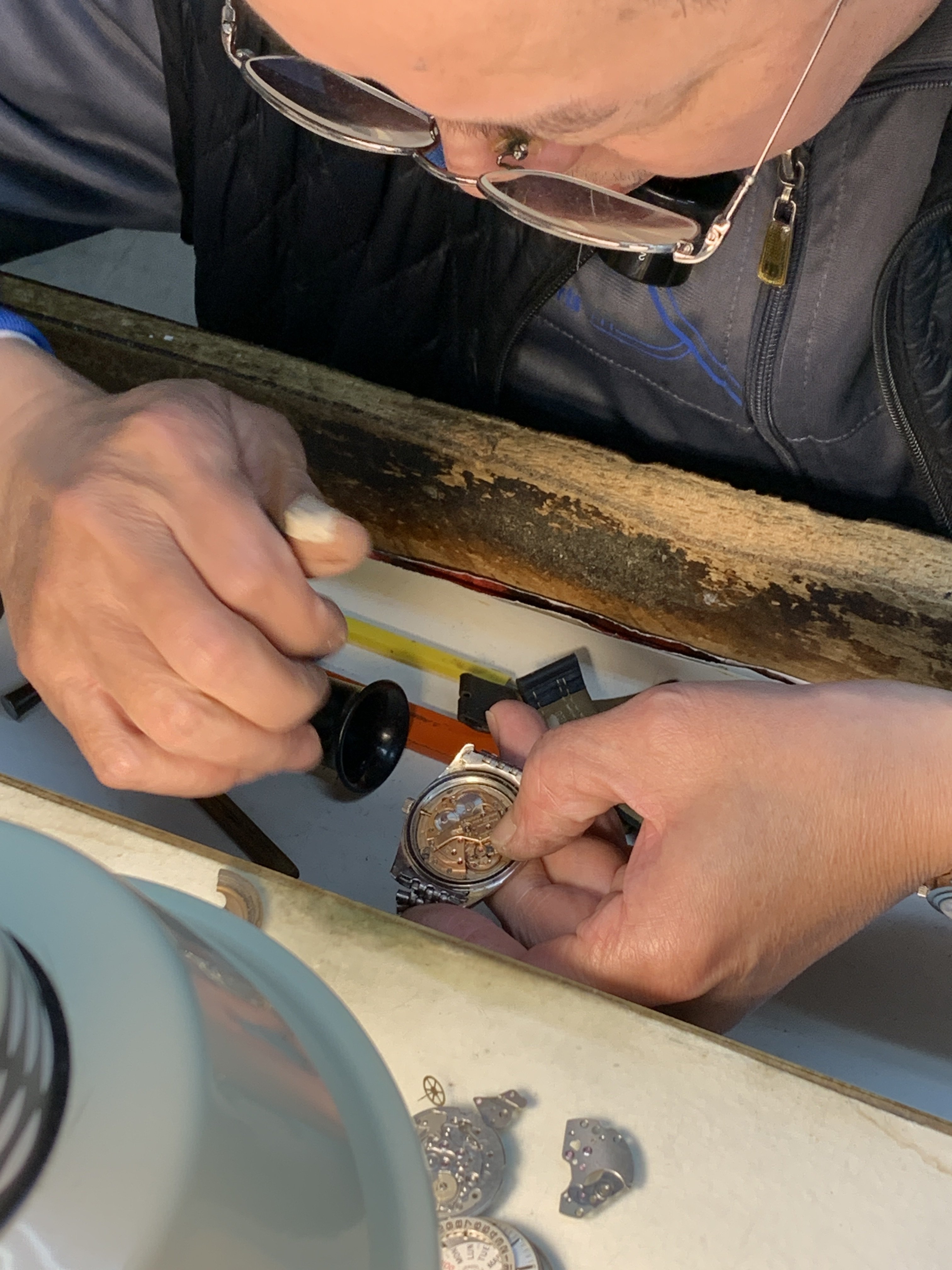

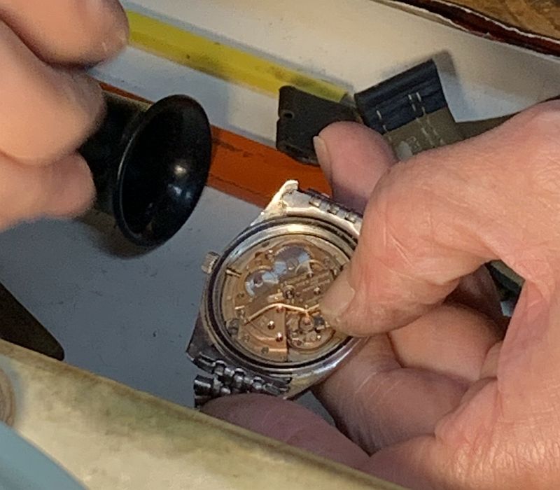

$300 would be a good price to get all this work done, but the this is not a person you want working on your watch. As @tamura indicates, he should not have his bare thumb sitting on the movement. You can find recommendations for a good watchmaker here. If there are significant rust issues I would expect to pay a bit more that $300 for quality work. This is a nice watch and worth the cost of repair. It will clean up nicely, but there is no way to get rid of the spots on the dial without a high probability of complete disaster.

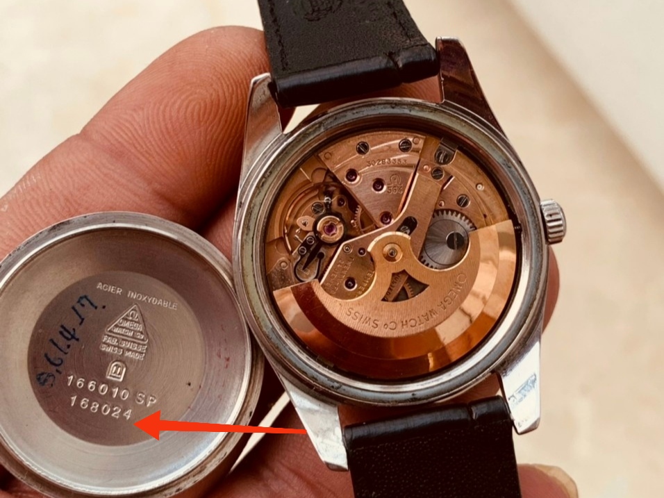

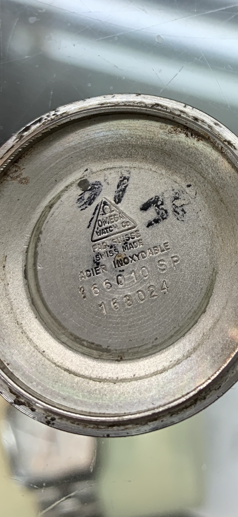

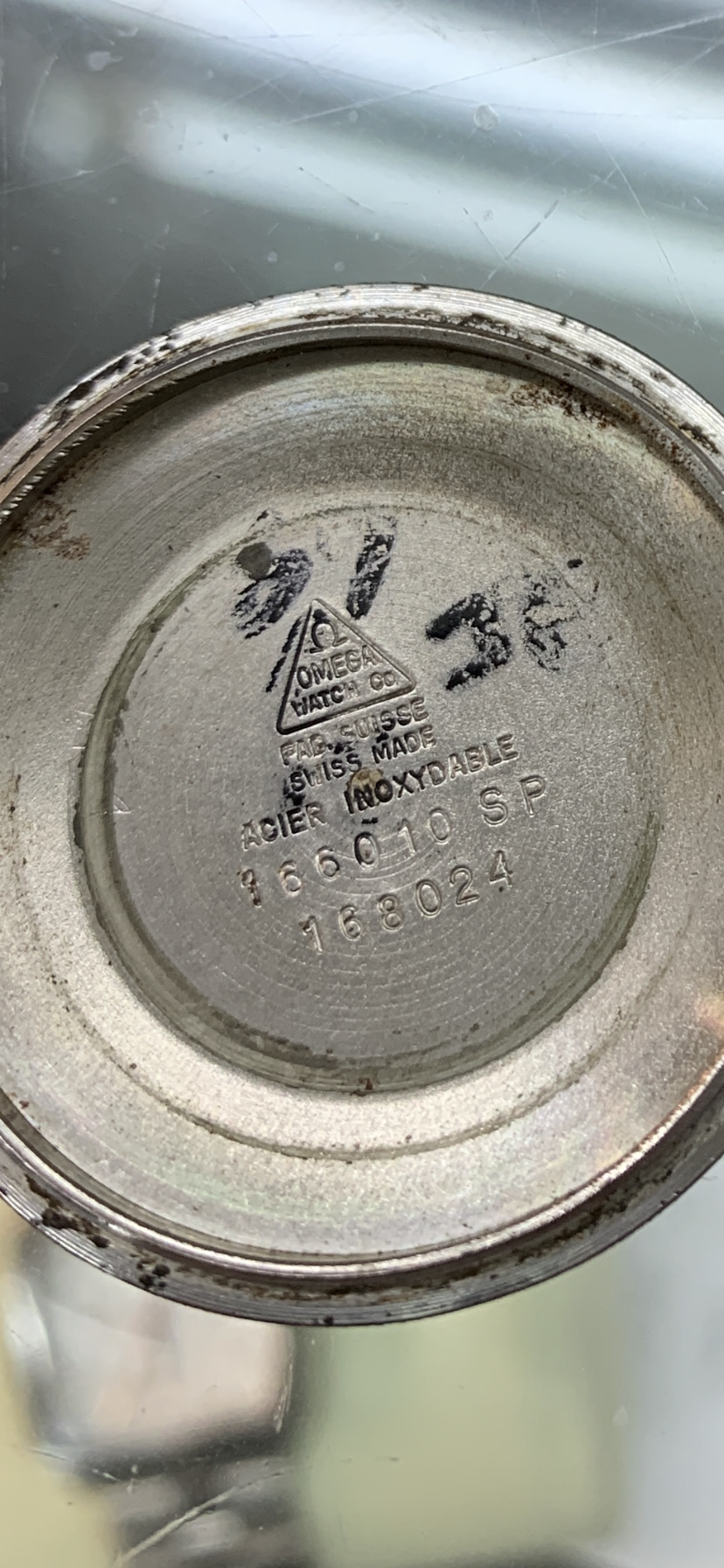

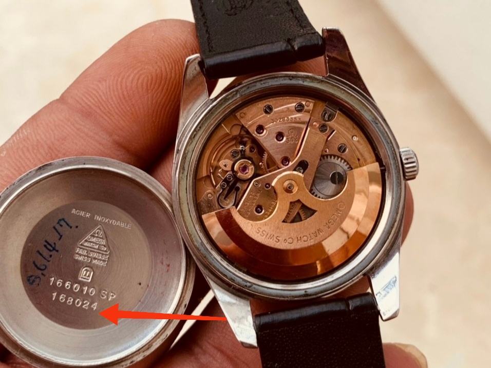

On its back cover, it’s has two number
166010SP
168024
I’ve seen people use both number for this watch, what do they mean? Which one is ref. Number?

166010SP is the standard grade, while Ref 168.024 is the chronometer version of the same watch. You have a Ref. 168.024.
I wonder if this is universally true. I understand that this is a dual reference caseback. But I have seen many chronometer grade watches with cal 564 and chronometer on the dial with only 166.010 on the caseback. So either there is also a chronometer grade 166.010 or all of those watches have swapped casebacks.
I did not know that. No arguments here.
I don’t know the answer. The OVD does not mention a 166.010 with cal 564. This could end up like the other swapped caseback thread. No clear answer.

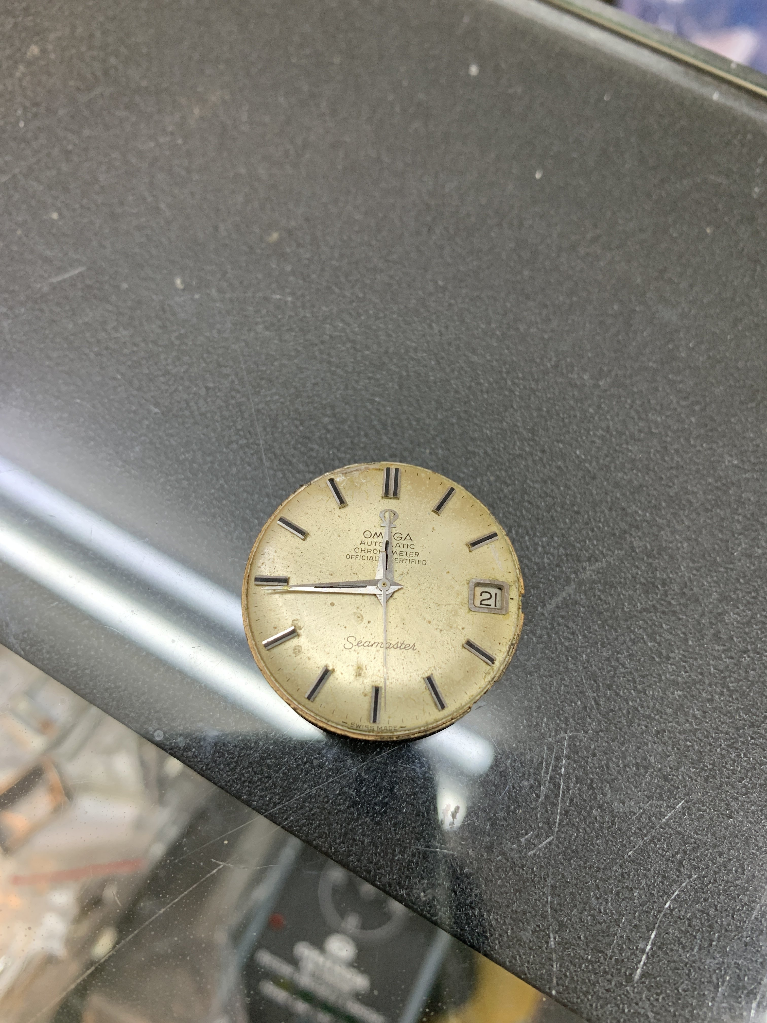

.......Without opening the back the tech told me most likely it’s real because there wasn’t too much fakes in that generation...................
Your watchmaker is obviously unfamiliar with Omega watches.
The 1940s to the 1970s was a very busy time for Omega counterfeiters, there a many thousands of fake vintage Omegas still floating around.
Your watch should come up nicely with a clean and a service and even though the dial isn't perfect, don't attempt to clean it.
If I'm not mistaken the third digit of the case reference has the following meaning:
6 = water resistant with calendar
8 = water resistant, chronometer with calendar
So it wouldn't make sense for a 166.010 to be chronometer graded.
Agree with @Dan S
My ex 168.024 caseback photo below.
To OP congrats on your watch! Pretty unique one since beside sentimental value it is a Seamaster equipped with chronometer grade 564 caliber, bead of rice (BoR) bracelet, original piece... etc.

I think it's unjust rendering judgement based on a single photo, though I probabilistically will agree
However probably the thumb is leaning on the case
Most of us probably open our cases too and I don't wear finger condoms while doing so, I doubt any of you do
I'll only say that the price is really high, here in this part of the world a similar service is $10-$20 - if I have to generalise too, these watchmakers are pretty robust, sometimes too robust, however for your watch, you really don't have to worry, as your watch looks pretty robust too, it's just that the cost is super high, $150 would be more appropriate and you could better enjoy your watch too
4,593
10,813
This I agree with. Obviously the watch in unserviced condition would not require sterile handling of that nasty movement. Maybe a tetanus shot would be more appropriate 😁
And here I thought it was economical to get a watch serviced in the south pacific. I don't know where in the world you are, but those prices you posted wouldn't even get a bracelet adjustment in the Philippines.
