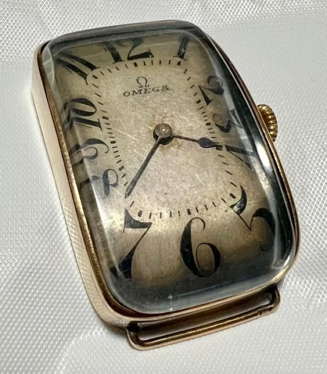

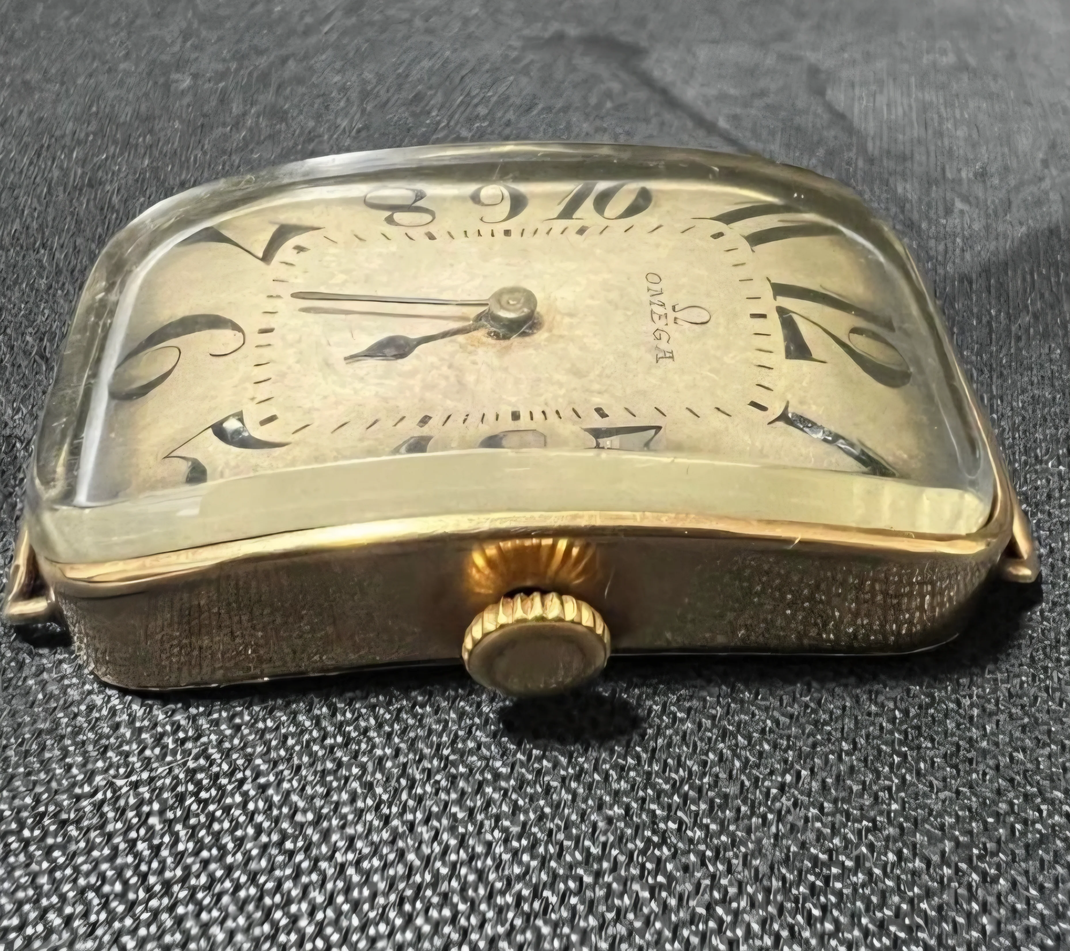

Does anyone here have a contact for someone who can custom make a plexiglass, sapphire etc. crystal for a very unusual watch?
I have a Russian cased 1950s Omega and the crystal popped out somewhere in my travels. Unfortunately as it is a custom made Russian case there is no chance of finding one off the shelf. It is 4.5mm thick, curved, and bevelled all around.
Help a desperate brother fix his new favourite watch 馃檹馃檹馃檹馃檹馃檹
P.S. the watch is not for sale, and never will be 馃グ馃ぃ

I looked into custom crystals sapphire/mineral crystals at one point, and it is a pain to have done by someone else. I simply wanted a slightly oddly detailed ROUND one and it was horrible. I considered grinding one on my own on the lathe, but that was for a round one (I ended up just polishing the crap out of the old one :/).
Plexiglass is actually quite a bit easier, and what I would suggest for you. IF you can model it up in CAD (which I suggest test-fitting with a 3d printer), there are a lot of sites like PCBWay/Xometry/etc that will make something out of plexy for you. You might have to polish it yourself, but it should be easy enough (you can polish from completely unable to see through to crystal clear in like 45 mins).

Can the case be scanned to work out the geometry for the crystal? I don't have a crystal to scan for the dimensions.
I can easily polished one myself.

Probably? A 3d scanner would possibly do a half decent job of a first pass, but I would bet there is going to be quite a few adjustments in CAD over time to get it just right. But any CNC machine could make one out of plexiglas, and there are plenty of low volume manufacturers online.
And yes, they will likely be rough-machined unless you spec them as polished, but polishing would be really easy to do yourself.
IF it were me, I'd pick up a 3d printer (maybe a resin printer for the accuracy? There are actually clear 3d resins...) and get to trying to design one that fits right, and cycle through prints until you get one that matches perfectly. Then, either clear-resin print them (though they tend to be softer plastics?) or have it CNC manufactured by PCBWay/etc.
