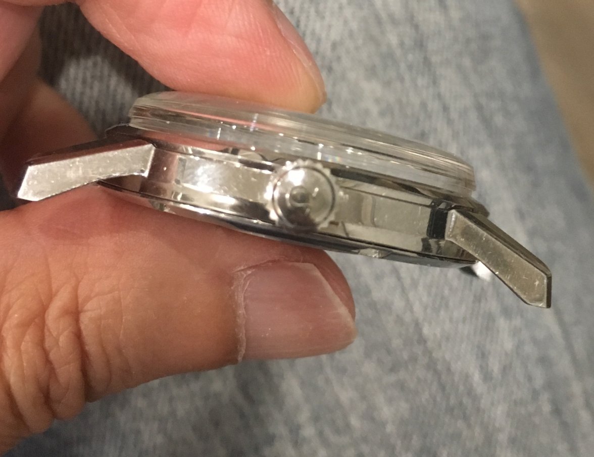

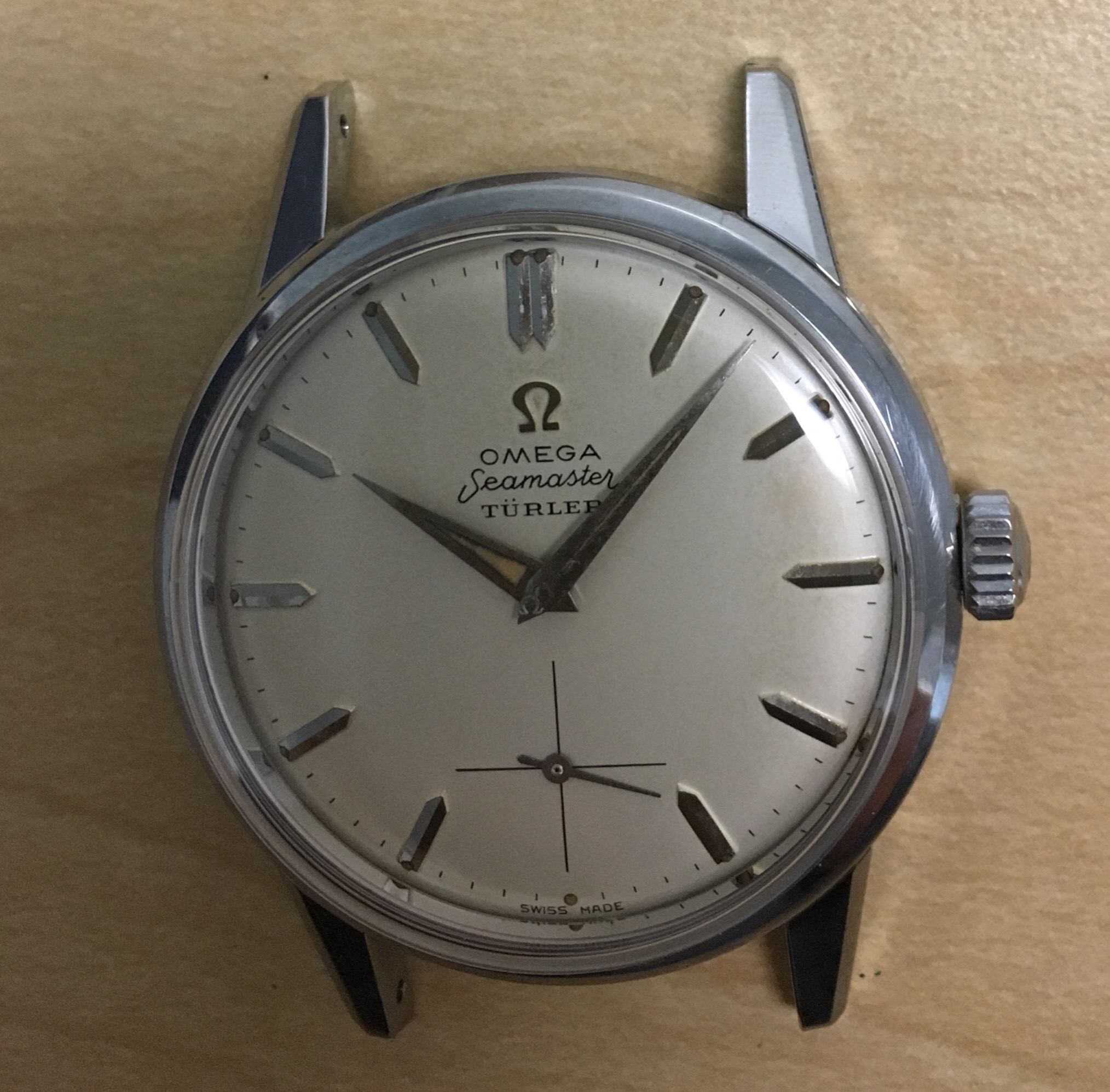

  1. fzhu052 May 4, 2019
    240
    166

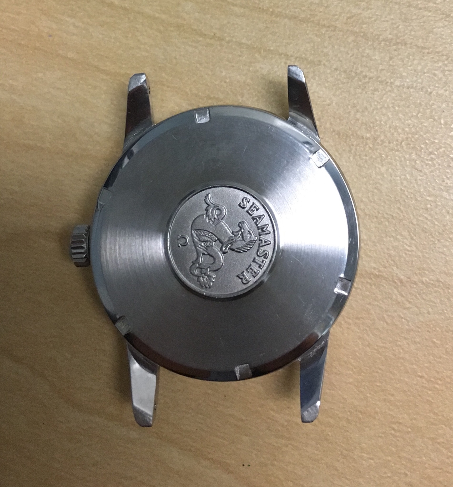

    Guys, I just got the watch serviced and with a new crystal. It looks very ‘tall’. Is it normal? Thank you so much!
    7656B2F6-5012-452A-90F1-5D9B71A0E364.jpeg 444C0E3E-F0DC-437E-A98C-4EAADD661851.jpeg 30A2CA3A-9016-4125-93F8-5D48CF0DB785.jpeg 8EAE578F-0486-4705-BA7E-E4E25B54B13D.jpeg

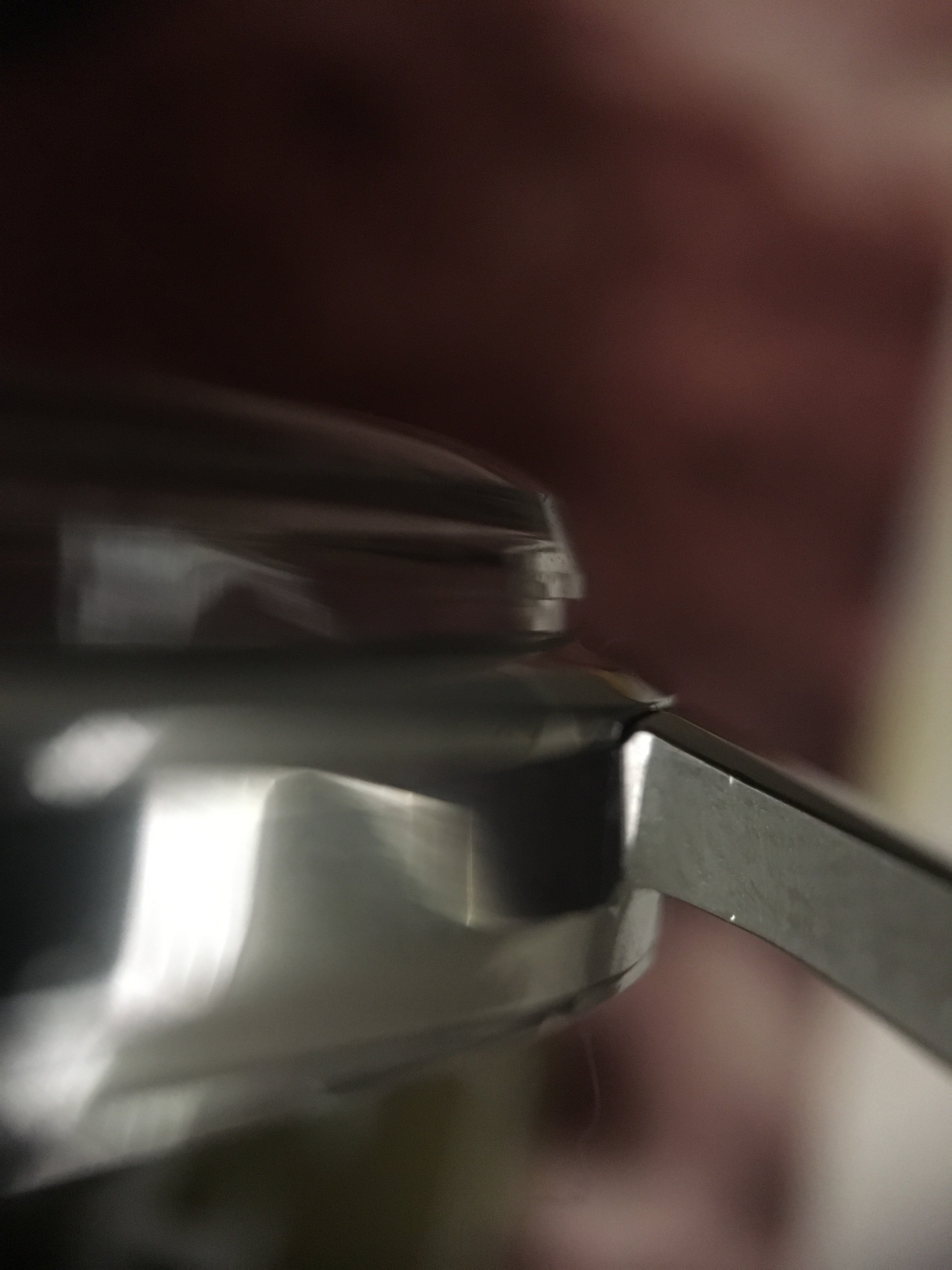

  2. fzhu052 May 4, 2019
    240
    166
    Closer
  3. X350 XJR Vintage Omega Aficionado May 4, 2019
    12,619
    29,918
    Incorrect crystal fitted.
    felsby, Vicke and 89-0 like this.
  4. blufinz52 Hears dead people, not watch rotors. May 4, 2019
    2,757
    6,934
    ::facepalm1::
  5. fzhu052 May 4, 2019
    240
    166
    My watchmaker said the crystal is listed by omega for the case number. And diameter seems right. Not sure how it shows like this.
  6. 77deluxe May 4, 2019
    2,058
    4,613
    well, there was a mix-up somewhere. Happens.
  7. Screwbacks May 5, 2019
    1,682
    4,857
    that crystal base or lower part has extra allowance. therefore has to be shaped or reduced to fit.
  8. fzhu052 May 5, 2019
    240
    166
    Oh really? I always thought as long as if the right one, it should just fit on as is. Is it easy to ‘reduce’ it?
  9. Screwbacks May 5, 2019
    1,682
    4,857
    it is an extra allowance so you can adjust the height to fit. or, it may not be the real corresponding part. your watchmaker will sure have a solution for that.
  10. JimInOz Melbourne Australia May 5, 2019
    15,491
    32,381
    Or it's simply the wrong crystal for that case.
    I've never come across an OEM Omega crystal that needs to be "reduced" when the correct crystal is selected for the particular case.
    77deluxe likes this.
  11. Screwbacks May 5, 2019
    1,682
    4,857
    or, it could be good aftermarket repro but cheaper and needs adjustment. i agree it's impossible not to fit if it is original.
  12. JimInOz Melbourne Australia May 5, 2019
    15,491
    32,381
    It's an Omega crystal. Simply the wrong one.
  13. Archer Omega Qualified Watchmaker May 5, 2019
    26,463
    65,604
    Crystals are not fitted this way if you have the right one...
    77deluxe and Screwbacks like this.
  14. Archer Omega Qualified Watchmaker May 5, 2019
    26,463
    65,604
    What is the case number and crystal number?

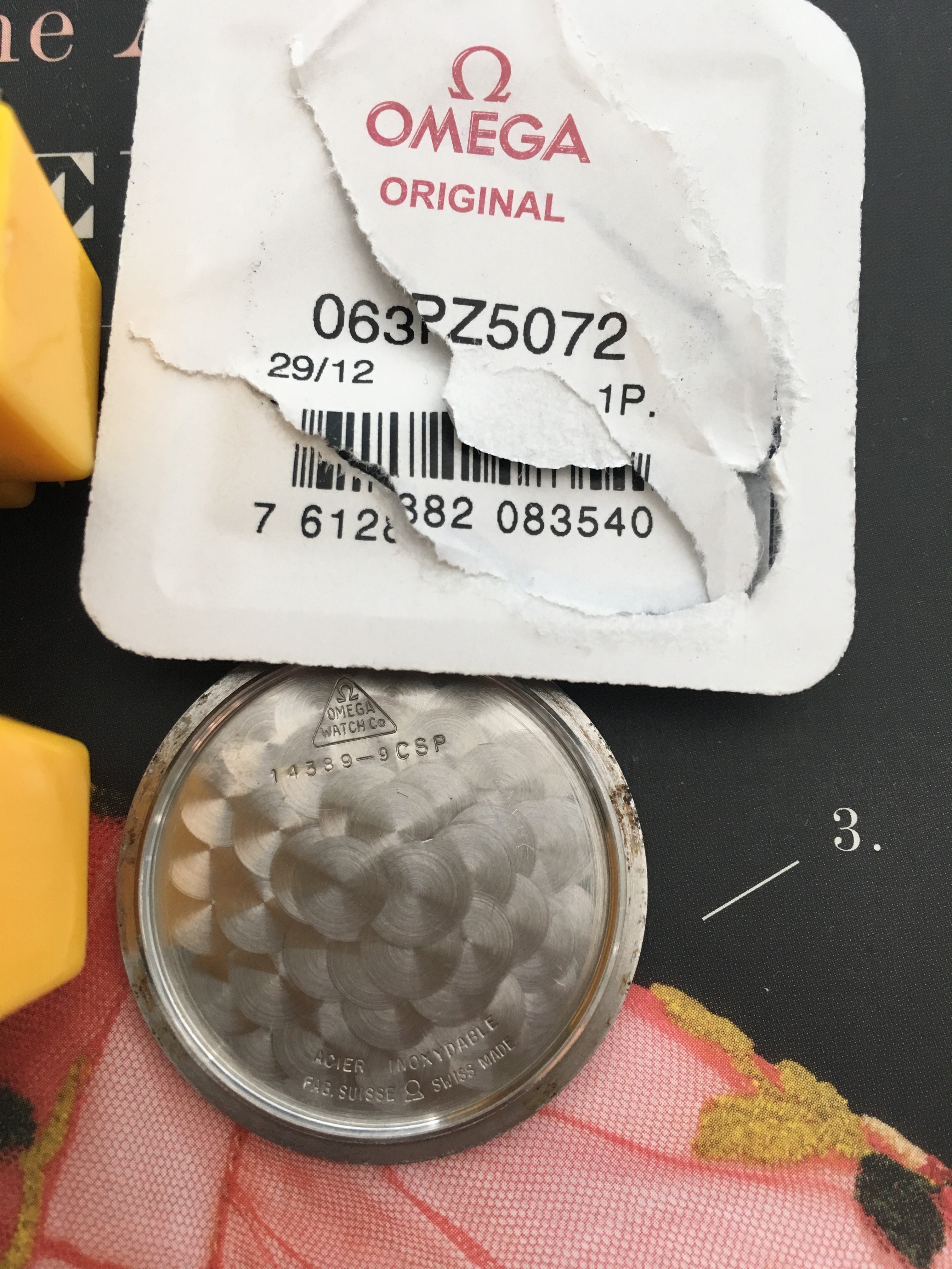

  15. fzhu052 May 5, 2019
    240
    166
    Case number 14389-9
    The crystal put on it: 063PZ5072
    Thank you!
    7CB09AC4-FA69-4304-9892-FAD1083C66AE.jpeg 63B23F05-BDED-404F-AF01-CE07BF0AD529.jpeg
  16. Archer Omega Qualified Watchmaker May 5, 2019
    26,463
    65,604
    For case 14389, the crystal is 063PZ5007.
    AdInfinitum likes this.
  17. fzhu052 May 5, 2019
    240
    166
    Al, thank you! I did some digging. I saw 063PZ5005 and 063PZ5015. What does the difference in the last two digits mean?
  18. 77deluxe May 5, 2019
    2,058
    4,613
    It means the difference between an incorrect and correct fit.
