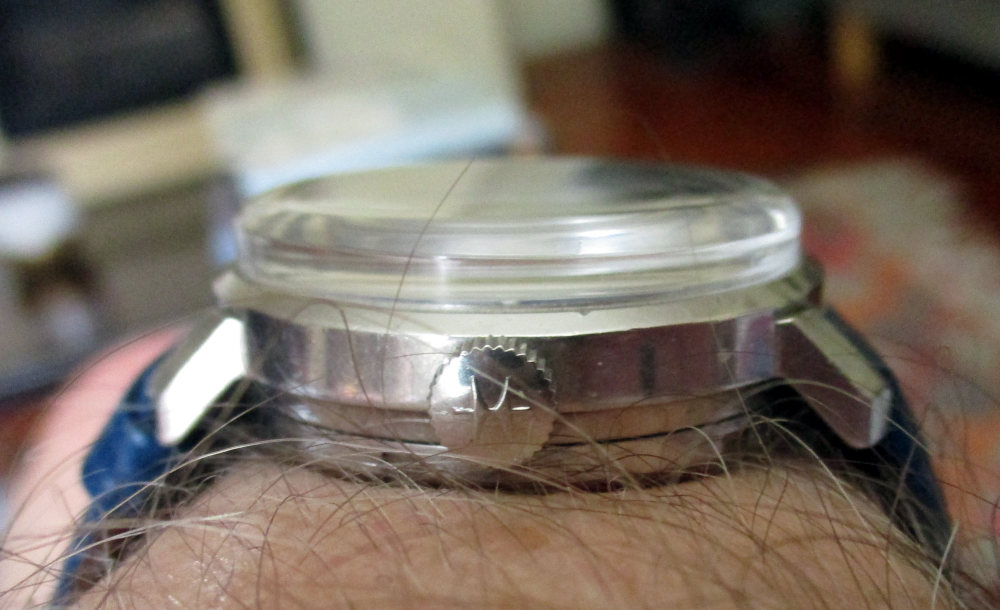

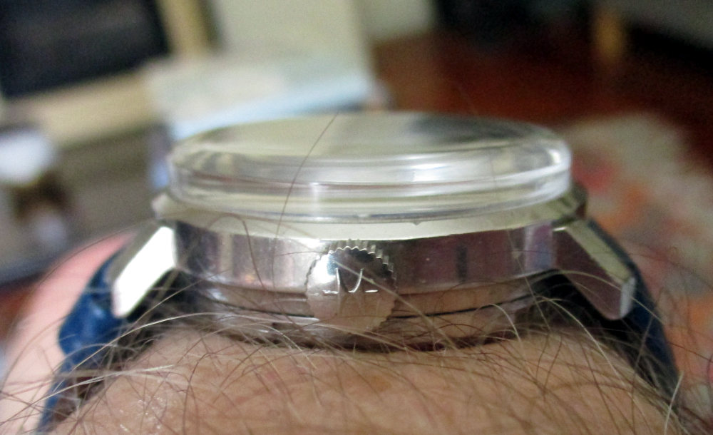

I can report that a Buren Micro-rotor crown does not turn. No movement from this position in four hours of wearing.
