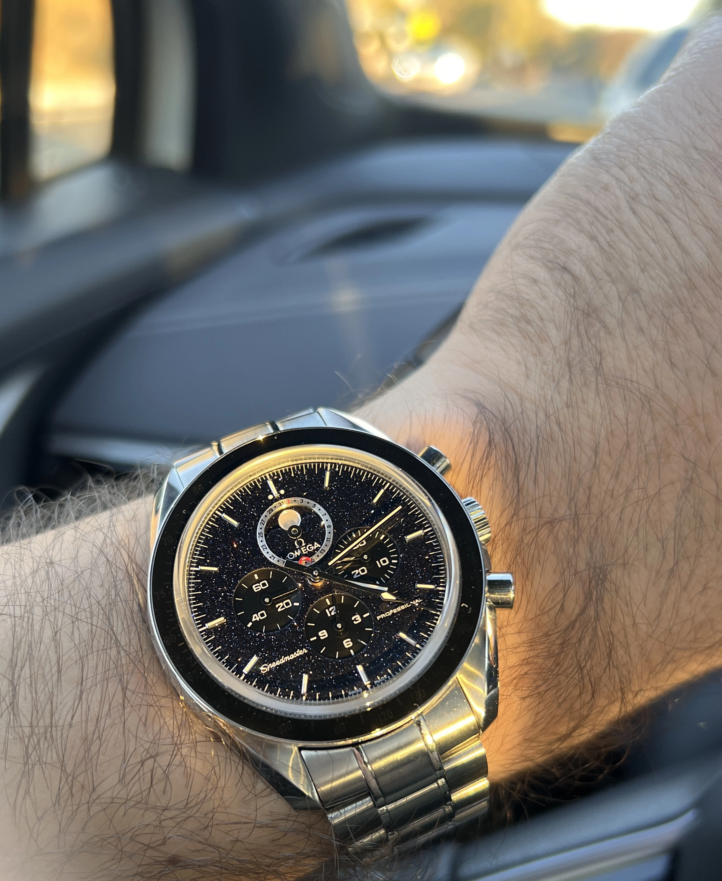

Crown is rigid, Getting a Callus on the thumb from winding this Speedy.
48
73

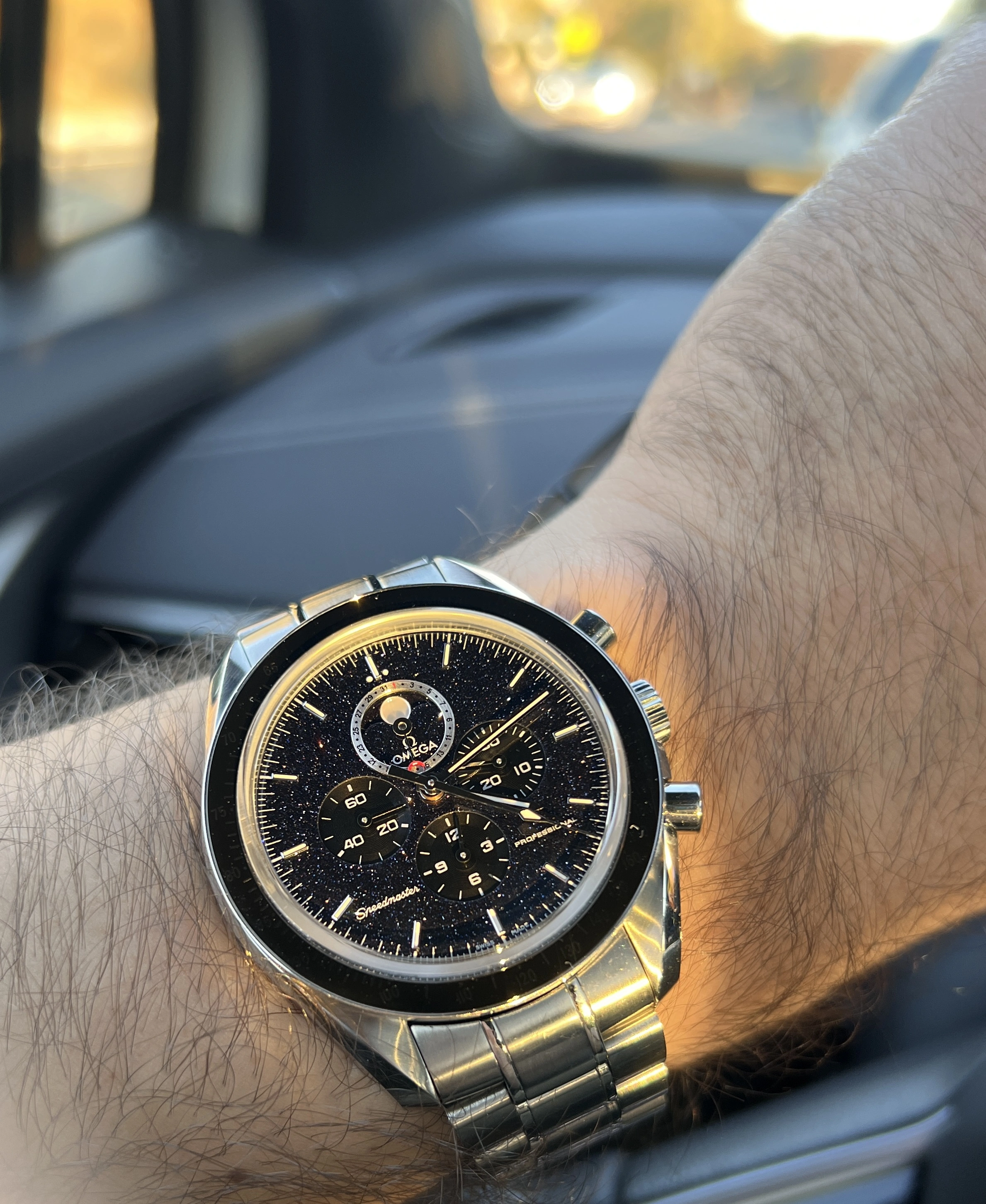

It’s no easy feat to take this piece off to put on another piece... While the dial is rewarding and the 44.25mm** case hovering over the Ulna rather comfortably winding this piece every 48 hours is a task… it’s been precise during my ownership since winter of 2023 the crown is rigid, hard to wind but easy to move the hands. Is there any easy and quick solution out there other than overhauling this piece? Thank you in advance;

If it needs an intervention putting it off won't solve your problem. Something is obviously wrong with the movement.

That’s one of my favorite models, and one of the rarest non-LE modern Speedmasters, very cool.
I have had a couple of Speedmasters with crown seals that were quite stiff and took a while to break in, that one though isn’t a new watch, they came out in 2014 or something and have been out of production for a long time so it might be due for a service despite being new to you.
One other thing is this reference, the 311.30.44.32.01.001 Is actually a 44.25mm rather than 42mm so it’s a bit bigger than most Speedys.

Appreciate the direction and your insight, you’re 100% correct it’s 44.25mm case and surprisingly wears very comfortable. Probably not a good idea to wear it like this until it stops running and then send in for service… I just can’t bring myself to service a piece that runs fine but too stiff to wind smoothly…

That’s true I been wearing it in rotation every 4 weeks 😬 I wonder what the turn around time would be with the Swatch Group Service centre in the States
