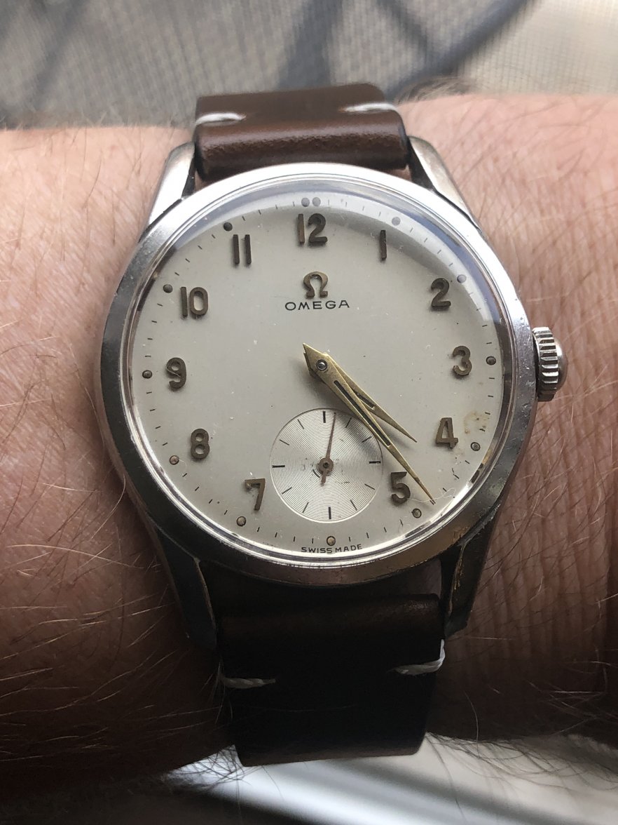

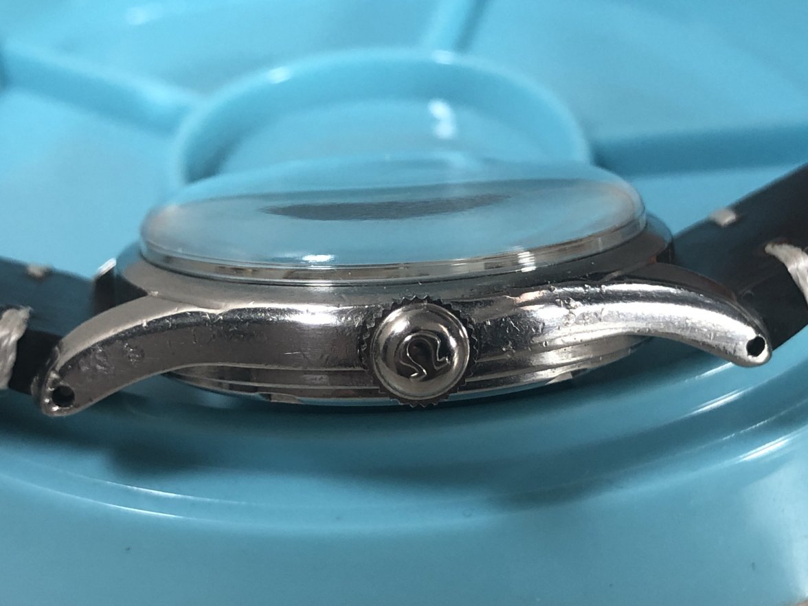

    Here is a picture of my 2639 crown
    but as you will see, it might not give you enough information about what you are looking as there has been so many 2639 references produced that you should share some pictures of your specific watch in order to gain a little bit more traction to your post ;) and see if other people own the same reference with its original part

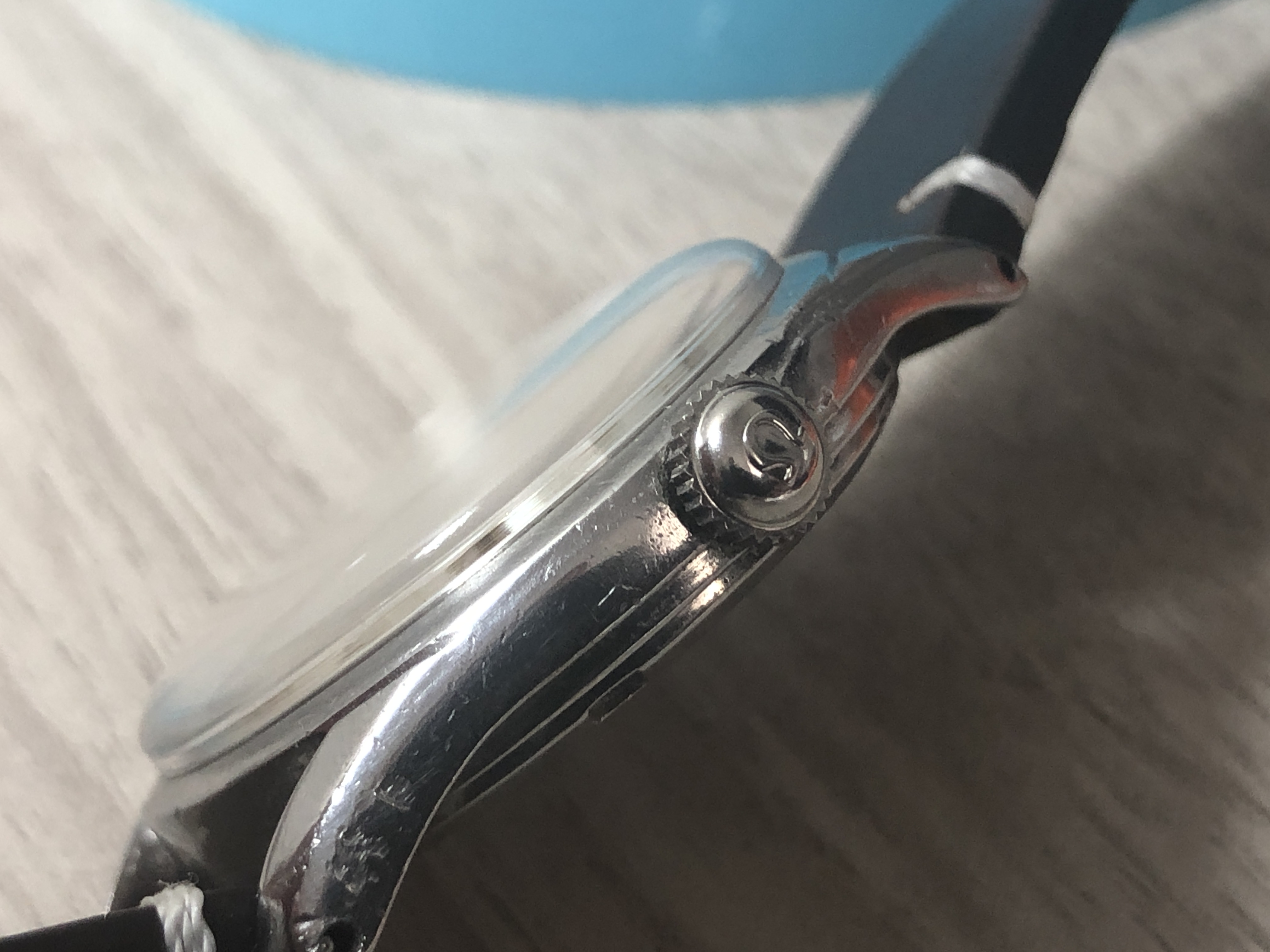

    Sure. But is 50-60$ a fair price at a watchmaker? Then I do that unless I find a 5,5mm which I think is needed.

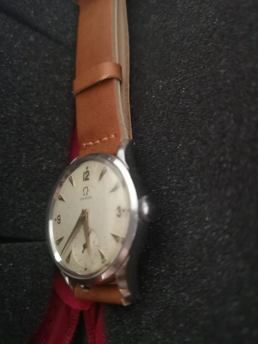

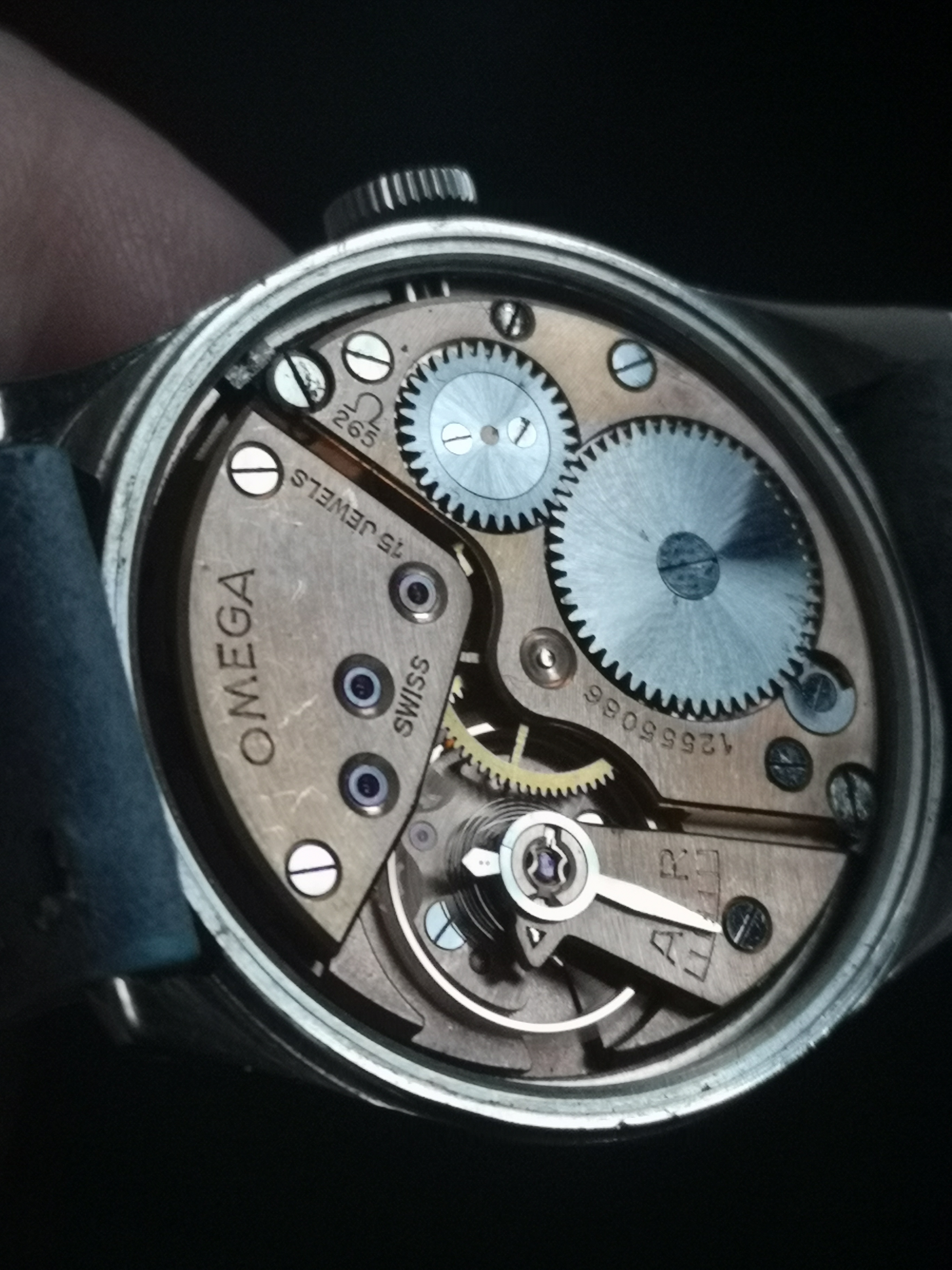

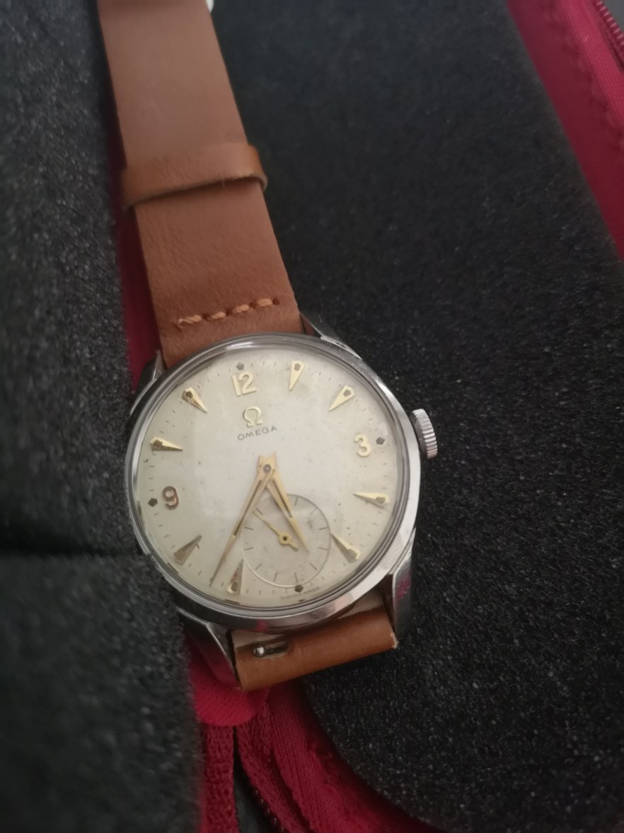

    Some terrible pictures:

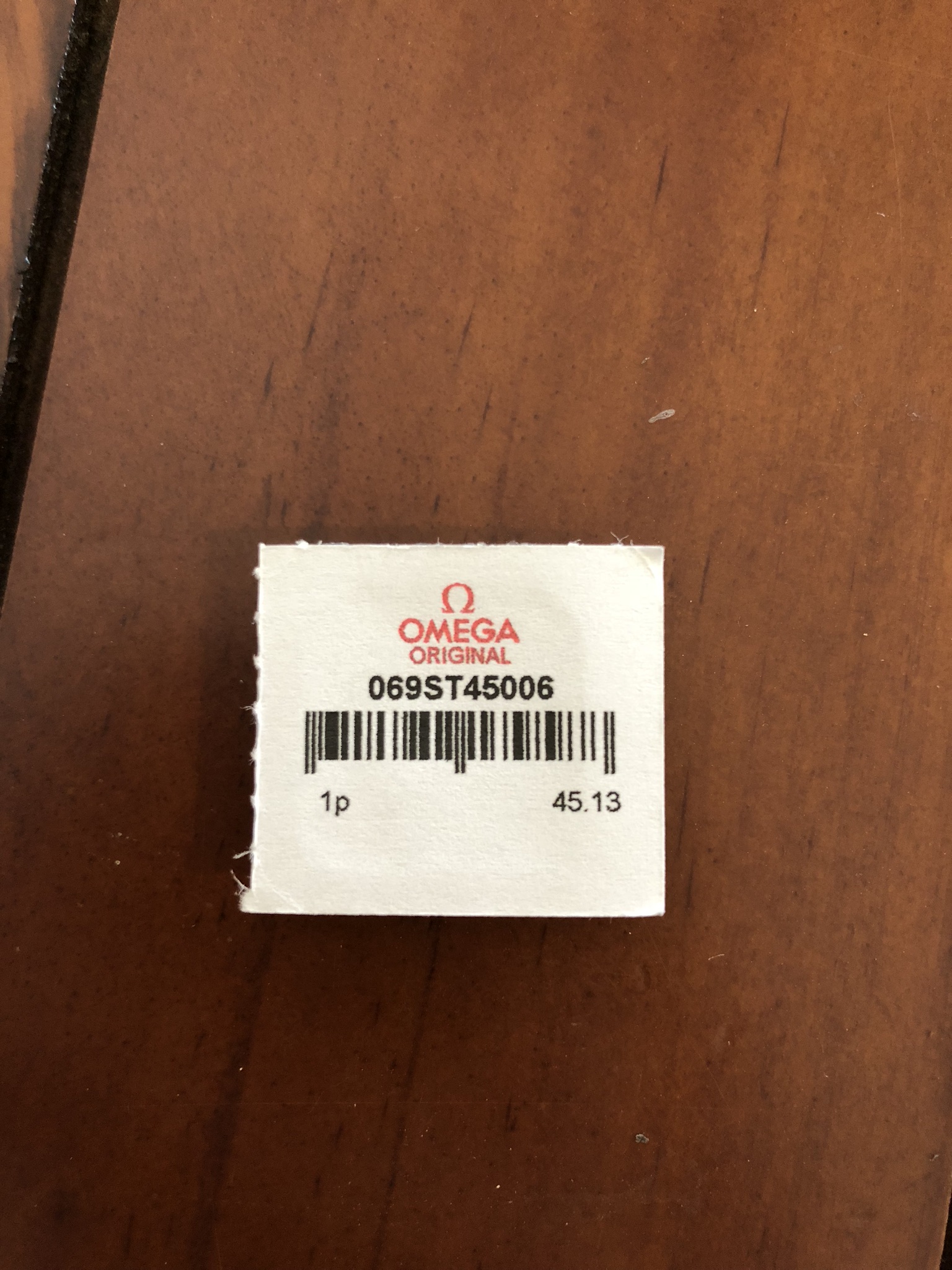

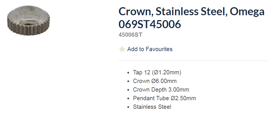

    I had a 2639 that I replaced the crown on. I’ll try to find the thread but here is the part number you need.
    B436C7C2-8F89-4021-8707-0843541B8E38.jpeg DCD6C15E-8880-4554-9062-FAA7729E93C3.jpeg 089B8ED5-B785-41B2-B9E9-3FD88DD4EA50.jpeg

    Will propably be more expensive to ship it to Europe from that site tough than to take it to a watchmaker. If it's true that the watchmaker do it for "only" around 50-60$.
    It's 5,5mm?
    Edit: seems to be 6mm maybe.
    @nurseford25 When you did it, what did you use to remove the stem and then put it back on? Do you need anything else than just tools to remove it? I've seen videos where they use some gluey thing.

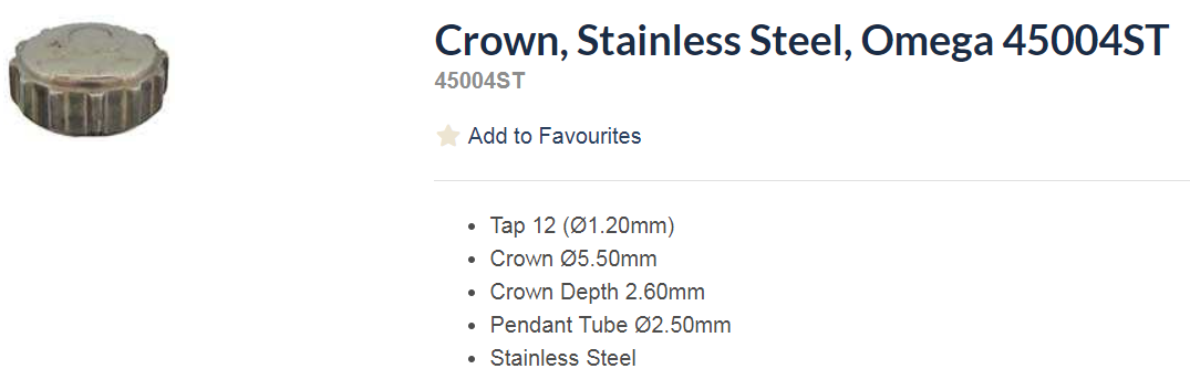

    Either of these 2 will fit.
    Scotch watch seems to have some in stock.
    Edited Jul 5, 2019

    When you buy the crown. Order a new winding stem. The current one was cut for an incorrect crown, so best to have a new one just in case it's needed. Just saves you another s/h fee
