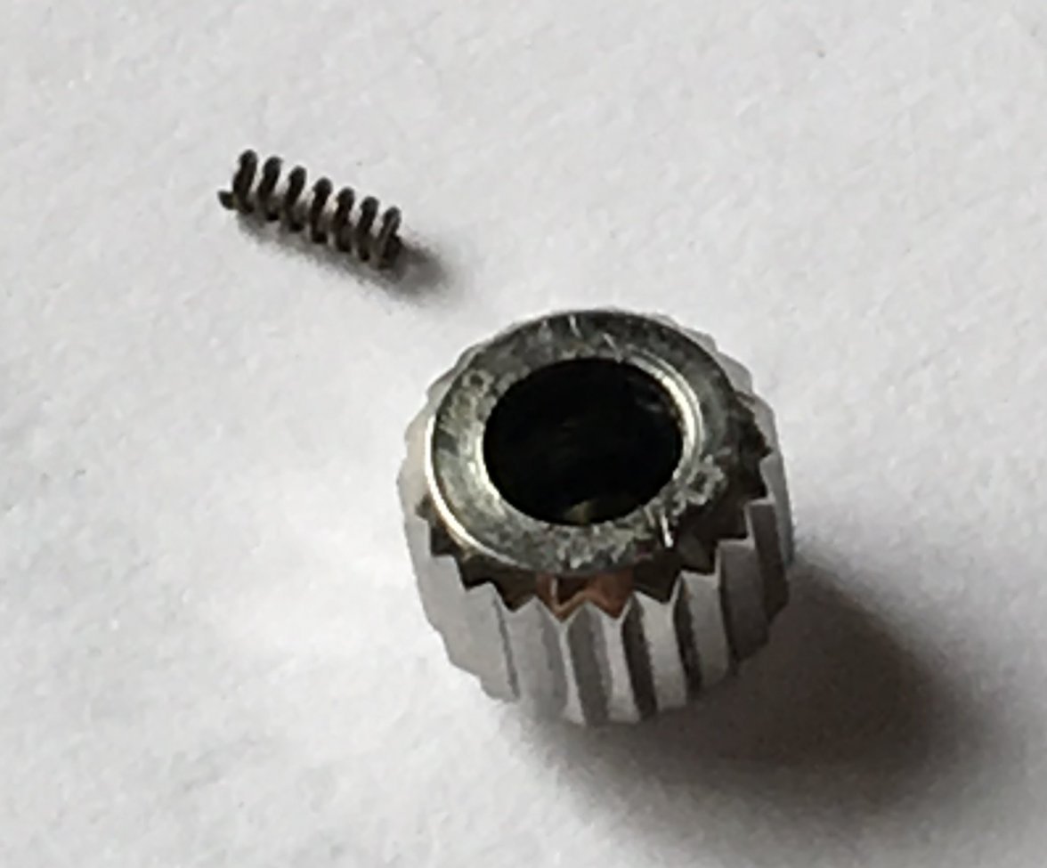

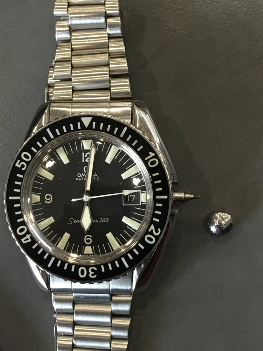

    This is not something that I can easily believe, but it happened and not two weeks from having received the watch back from service. This is a Watchco SM300, by the way. Caliber 565. Supposedly with an NOS movement, one purchased during this forum's group buy (I bought it last Oct. from the gent who bought it during the group buy). I had it serviced as I was moving overseas and did not fully trust Watchco and low and behold the rotor axle had to be replaced. Otherwise they said it was terrific and it was keeping great time when I got it back. LOVE this watch.
    Landed in Beijing last week, sat down and decided to move the time forward 12 hours. Okay and then poof, the crown literally came off. I am still shell shocked. And being overseas and unable to send the watch back to the USA for repair (it would be covered under warranty since it was just serviced and again, by an independent) I am wondering what my options are. Sending it back to the U.S. is out. That's $590 via Fed-Ex Economy! I will not be returning to the U.S. until 2017. I can't go that long with it sitting in a drawer.

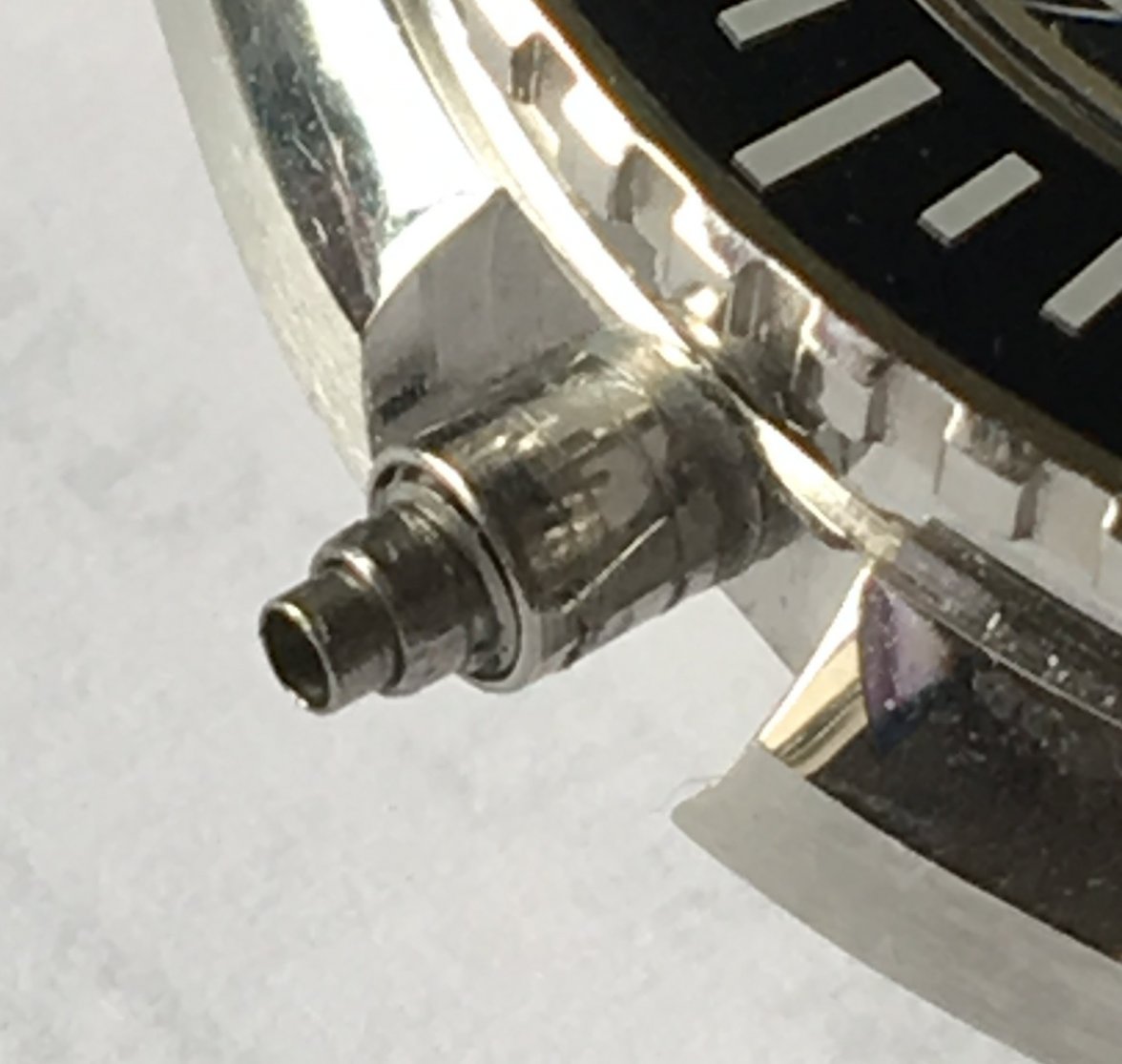

    Based upon these photos is there anything anyone here can tell me at how painful this will be? Or what will be involved with fixing it? Will this require a full service? Or not? What's it look like?
    Should I purchase a crown and stem from Ofrei and have them shipped here and find a decent local watchmaker? If yes, any other parts I should add? Any gaskets/seals?
    Or is this nowhere near as severe as I am thinking and any skilled watchmaker can take care of this without new parts?

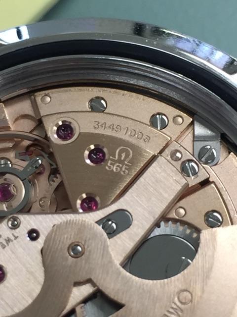

    Also attached is a pic of the movement with serial number of anyone knows how to find out about that movement.

    Did they change crown on service? If they did then send it back it must be manufacturer failure and will be done under warranty. I do not know why would you pay $750 for sending watch to anywhere in the world???
    If service did not change crown + tube, then I would go to watchmaker (anywhere in the world) that can get you original parts and replace it. There is no need for whole service, only crown(+ maybe tube) replacement.

    First off, this should not be a major issue so you can relax. I am pretty sure I read somewhere that Al, @Archer has seen this. Hopefully, he'll get involved and explain better than me.
    It needs a new crown and a stem (the stems are cut to length and the new crown might be slightly different than the failed one). The part of the crown that screws down is still screwed in the tube but a Watchmaker will get that out. To be honest, he could probably fix this crown by flaring the part that is sticking out of the case but a new crown would be best. The little spring is there to allow the movement when you screw the crown down.
    In my opinion, this is a failure of the Omega part of the crown as this is pre-assembled. I suppose if the stem was cut incorrectly then when you screw it down, it might overstress this joint (Al?). Both parts available from Cousins, for example, and an Omega Authorised Watchmaker.
    By the way, the tube looks scratched in your pictures which seems odd and won't help the sealing. I hope it isn't as that might mean a pendant tube replacement. The screw down threads are on the inside of the tube and are obviously working.

    I had this happen recently on a 565 SM300 which I had put together. It felt like it happened when I tighten down the crown, the crown was new from Cousins. I assumed it was because I had not cut the stem to the exact length required. I ordered a new stem and crown from Cousins, recut the new stem and the watch has been fine with the new ones.

    The tube is not scratched. That is a reflection of light in that picture. I just looked at it under a magnifying glass.

    Yes, this is not uncommon. I keep spare crowns on hand for this very reason, as I've had brand new ones fail pretty much the first time I screwed the crown down.
    [​IMG]
    [​IMG]
    As Chris noted a new crown and a new stem would be needed for good measure. People always want to crank the crown down to an extreme amount, but that really isn't needed - it just needs to be snugged slightly.

    My approach with this defect has always been to repair the crown. Repair is 1/10th of the cost of replacement, maintains originality, is easily done and permanent, so far of the dozens and dozens of crowns I have repaired, not one has failed.
    There is a good reason why Rolex crowns have the pipe and crown threaded to each other and not friction fitted like the Omega. With a Rolex the only time the crown comes apart, is when the cannon friction is excessive and forces the crown to loosen during time setting, otherwise winding only tightens the threads and there is no risk of failure.

    In general, compared to some other brands, Omega's crowns are quite reliable in my experience. For example it seems you have to work pretty hard to cross thread and strip them compared to some others out there.
    For this specific failure, the Watchco SM300 screw down crown is the only Omega crown I've had this happen on that I can remember. The OP's description sounds like the crown was cranked down very hard, so the crown pipe will be in the case tube quite tight I expect. Getting it out without causing damage may be difficult if it's really in there tight.
    The crowns are not expensive by any means, and clearly originality is not a concern in this instance as it's a new crown on a new case anyway, so spending the time to repair it is not something I would do on this one certainly.
