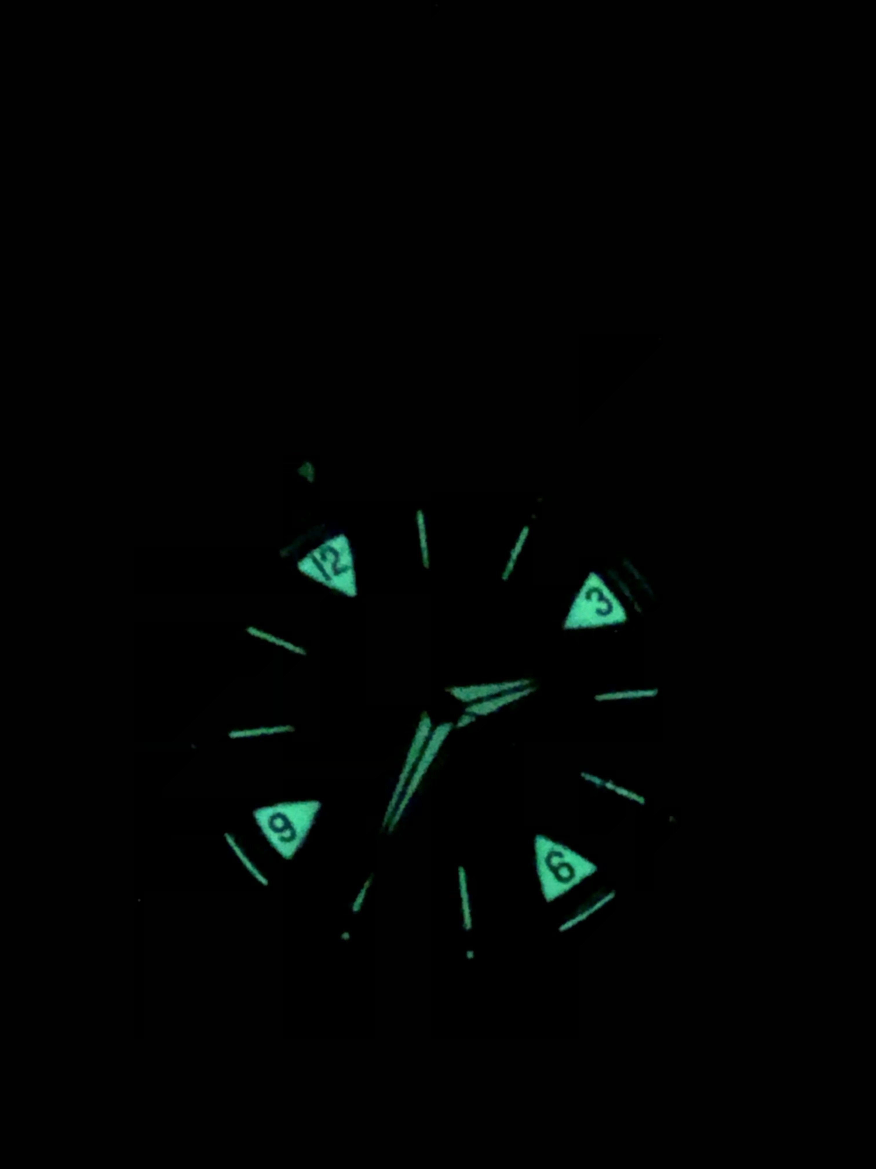

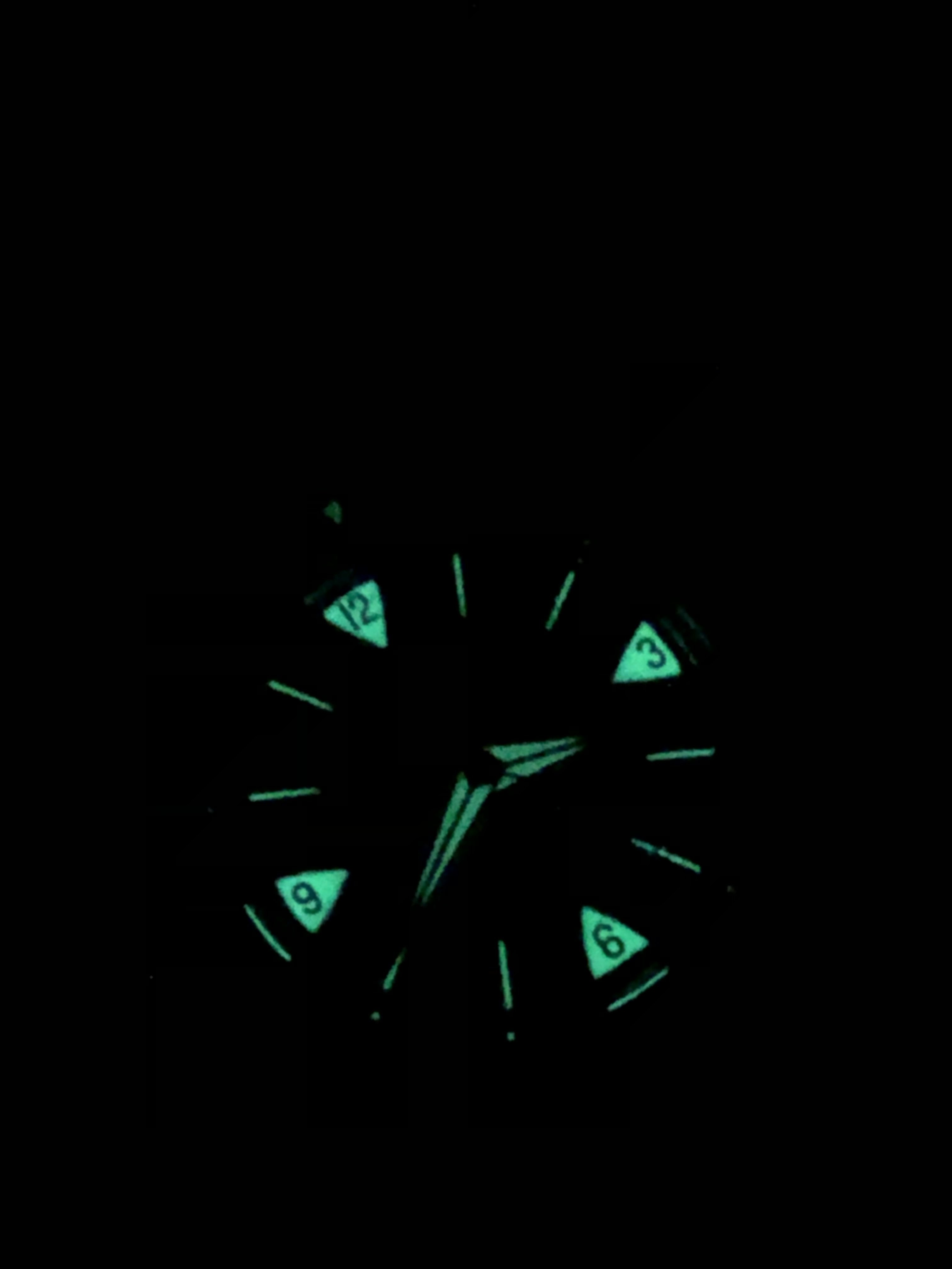

Now, be careful because I think the Chronograph Sea Diver used radium, not tritium.. A Geiger counter should go crazy next to this one, confirming radium presence. If it would be for my own usage, I will contact a skilled person and ask to relume the hands as they are flaking, making the watch especially dangerous if opened...
The hand relume would be the only cosmetic work I would do. You can eventually replace the chrono (central) hand as it seems bent a bit but good luck finding an original one I guess. Mine (Gen2) also had a slightly bent chrono hand, and I did not even bother to search for one
Cheers for the advice. Got the watch from Dad today and will be taking it a local vintage watch specialist to get it serviced and repair the movement. Although I hear it can be hard to find some Venus 210 parts. Sub seconds is working fine and it seems to keep good time, the pushers aren't working though - I think there's a broken spring somewhere.
Not sure about reluming the hands, may leave them if I can for the time being. The lume actually still works on the hands which I found surprising.
Radium can still light up when it gets a blast of light. Just don’t lick it.

The relume is only a matter of personal preference here. I will feel safer because of the flakes but no one will blame you not doing it (most may still consider it as a crime even if it flakes 😁)
Just tell your watchmaker about radium presence to be sure he is aware of it (especially as all other CASD used tritium)
