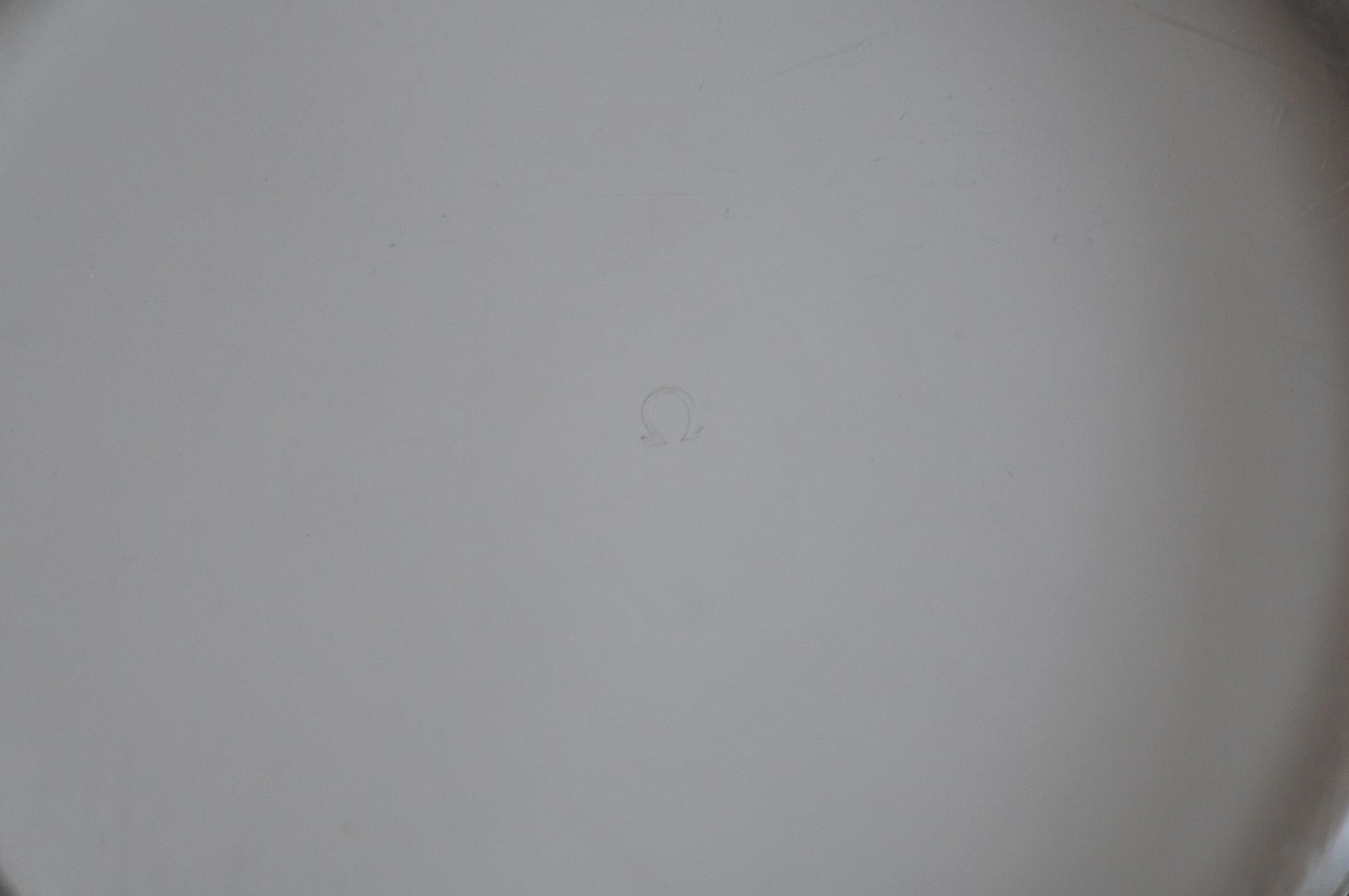

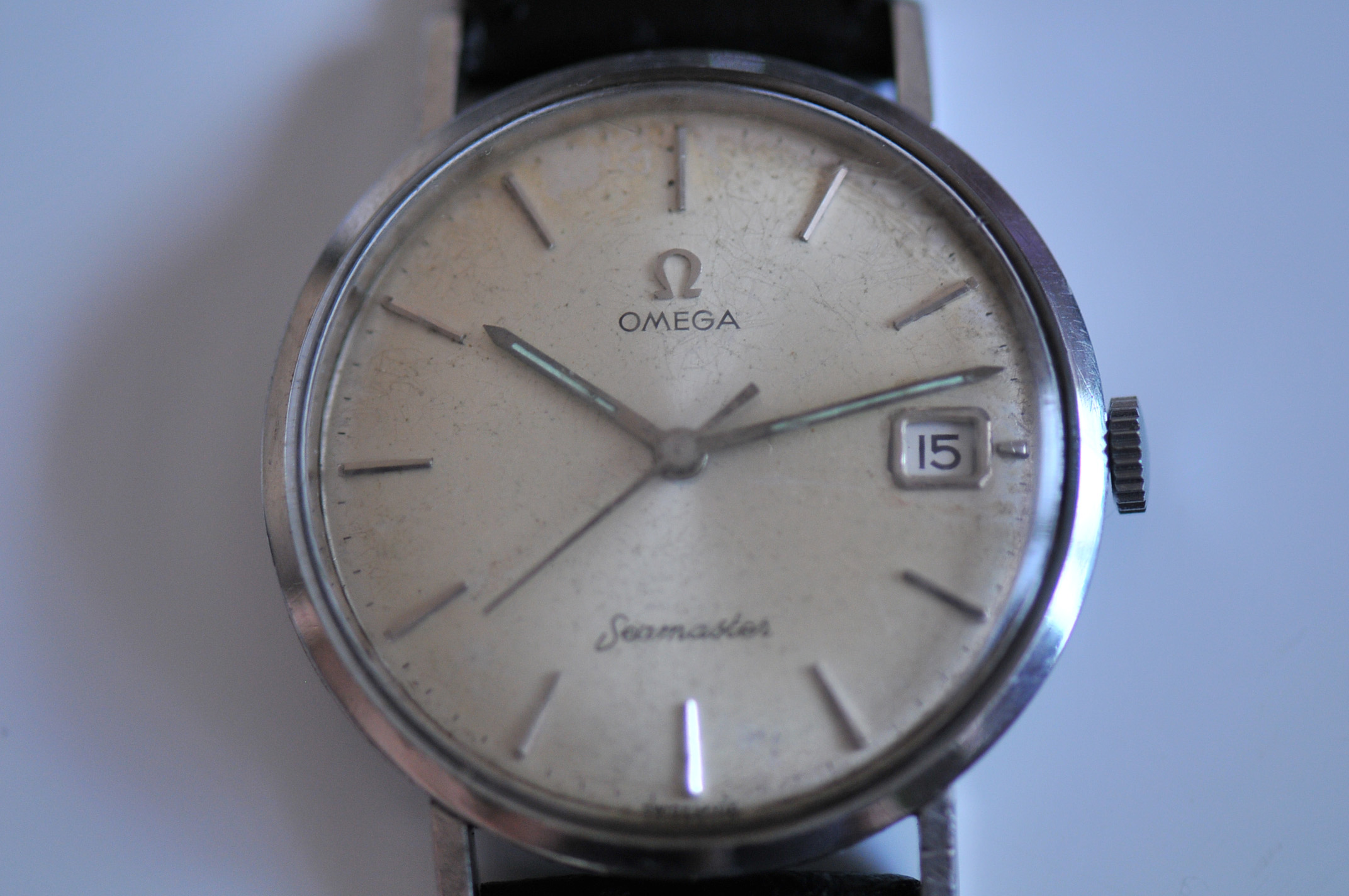

    Hi

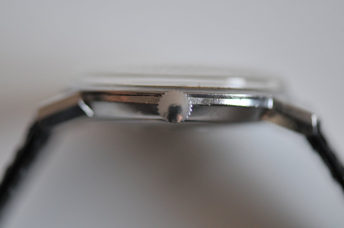

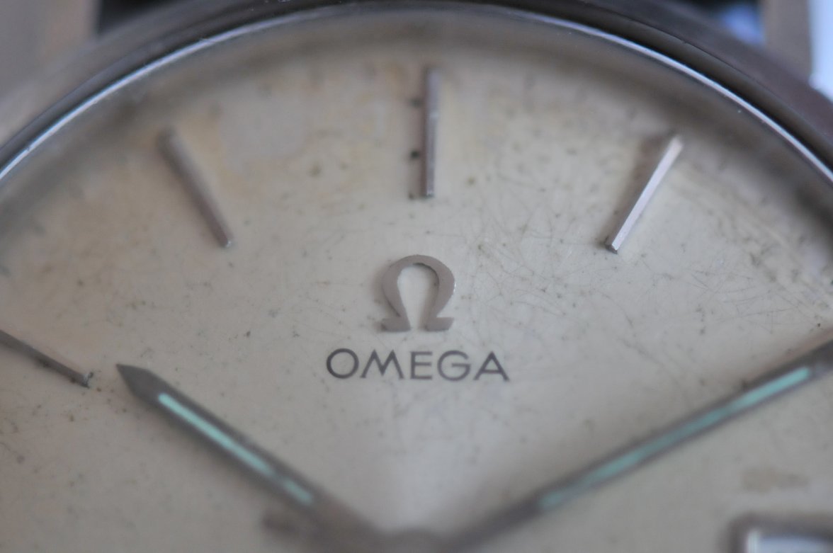

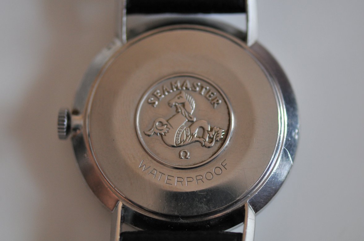

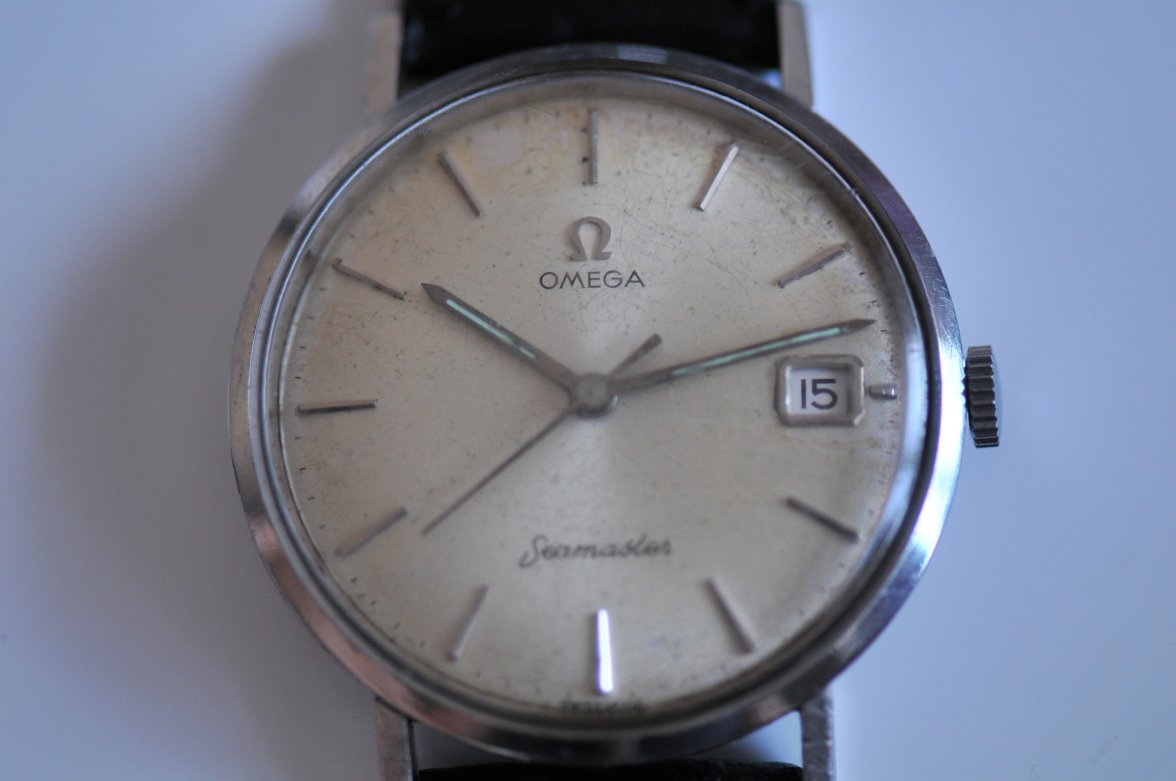

    I recently purchase this watch but I am not able to see the mechanism because the movement has to be removed from the front..I removed the glass but I don't know what to do next...so could you tell me the reference number of the case, caliber, etc from the pictures..?
    Thank you in advance

  2. hoipolloi Vintage Omega Connoisseur Dec 23, 2017
    3,516
    5,795
    Ref 14775 caliber 610. I guess.

  3. François Pépin Dec 23, 2017
    1,531
    1,081
    I think there is a case back you can open.
  4. numero27 Dec 23, 2017
    131
    170
    I think it is monobloc , you can not open the case back , 610 or 613 probably ...

  6. François Pépin Dec 23, 2017
    1,531
    1,081
    Yes, probably. I thought there were a spot to open the back on some picture, but the case definitely looks like a monocoque.
  7. Seaman Dec 23, 2017
    239
    461
    It's definitely a monoblock..I removed the glass but I didn't knew what to do next..thank you for all the answers.
  8. François Pépin Dec 24, 2017
    1,531
    1,081
    Usually, with a monocoque like that, you have to pull out the crown - the stem should split as it is made of two parts - turn the movement a little bit in the case and let it fall on a cushion.
    But do not try yourself if you do not know what you are doing!
  9. JimInOz Melbourne Australia Dec 24, 2017
    15,491
    32,381
    There's no such thing as "monobloc" Omega case.
    It's either a "Monocoque" case where the movement is accessed by removing the bezel/crystal assembly with a case knife after removing the crown/stem assembly.
    The somewhat similar "Unicoc" style is the one where the removal of the crystal with a crystal lift is used and then the movement can be accessed.
    You can usually spot a Monocoque case by the small gap between the bezel and the case (under the crown if it's been correctly assembled).
