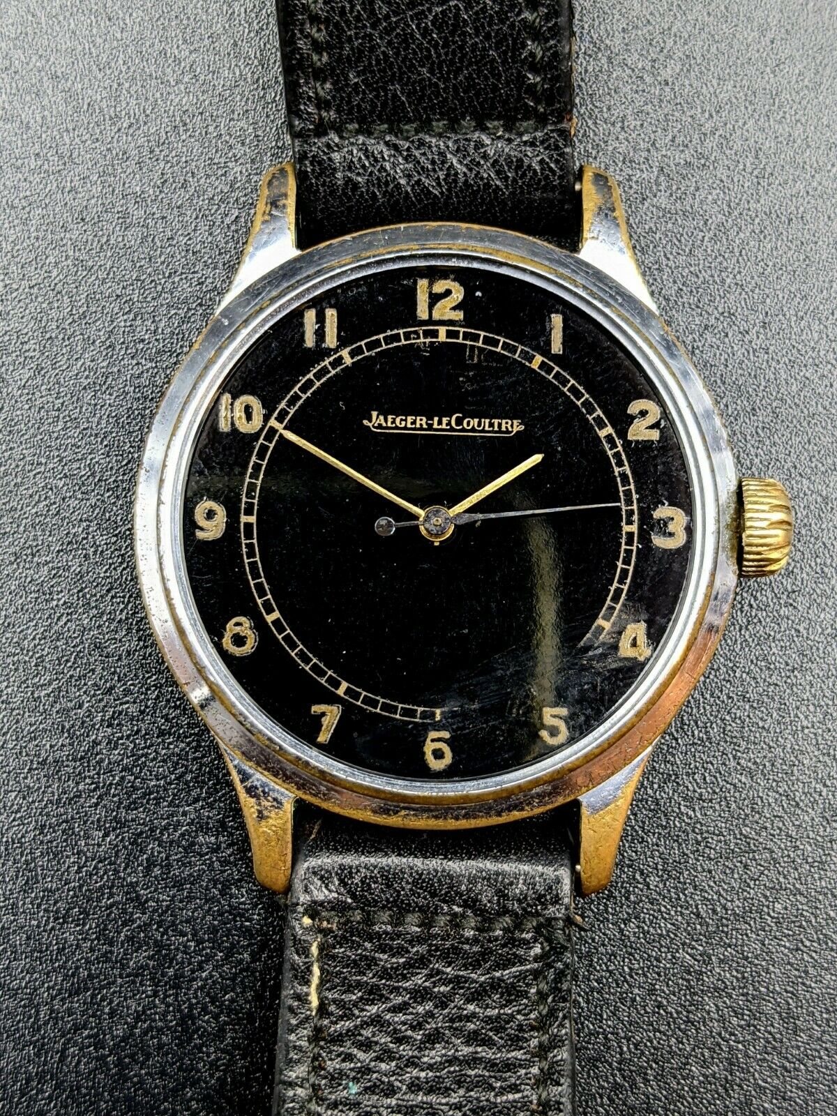

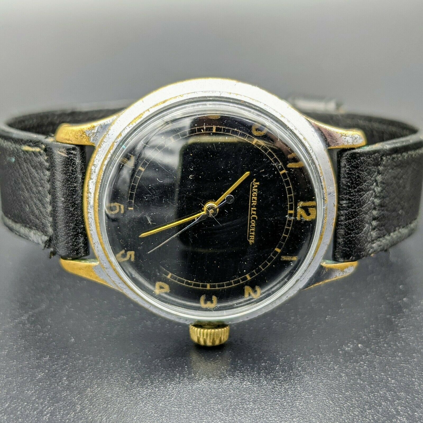

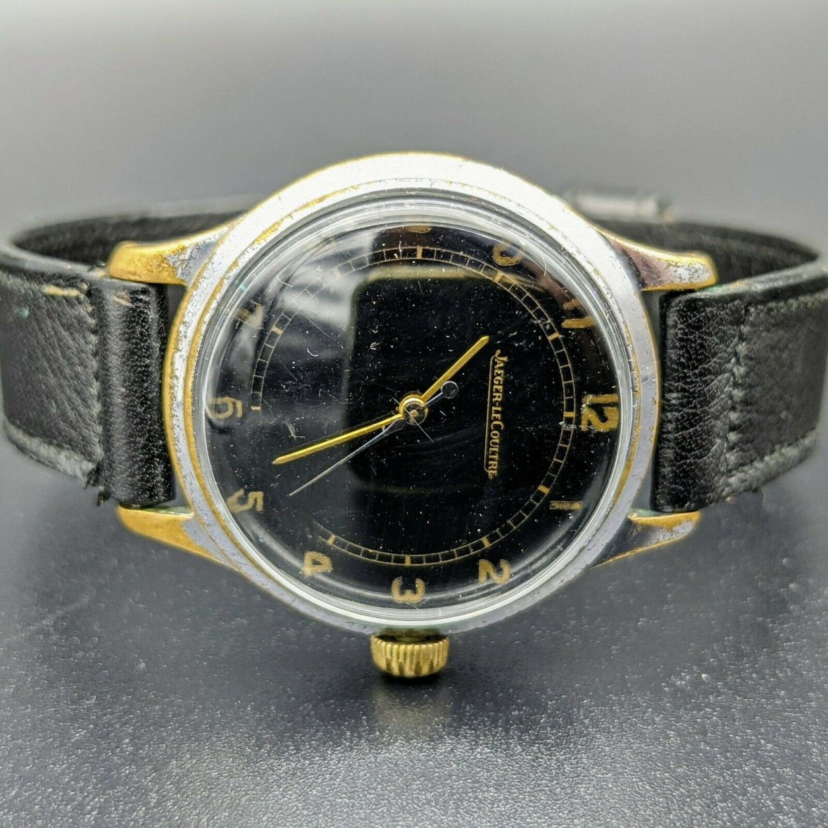

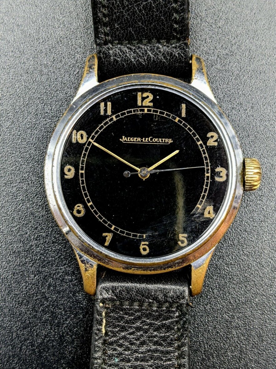

Could I get yalls opinion on the JLC watch
16
6
I would like to get yalls opinion on this watch. i sort of think the crown and the dials are not original, but i am not trained enough to spot other things, could I trouble yall for your opinion on this watch. Thank you!
16
6
grr i mean to say the crown and the hands dont seem to be original. sorry :/
24,743
54,960
I agree that the hands and crown are not original.
9,985
56,690
Agree. The hands and crown are not original. Case is pretty beaten up too.
24,743
54,960
If we are commenting on condition, the dial is also poor, since someone has completely removed the minute track between 4 and 6 o'clock.
16
6
i noticed that too, well it is kind of hard to miss, out of curiosity what would cause that problem? was it the minute hand dragging there or maybe some other reason that is a more serious problem?
7,738
14,322
Very rough condition, it's not something I would want to strap on. There are far better examples out there.
7,677
22,018
It looks like someone made a botched attempt at patching up a part of the dial with paint.
16
6
are you referring to that same area at 5 oclock or do you see something else? i thought the 5 oclock problem would be from a dragging hand, but again i am not super confident in my analysis. thank you!
24,743
54,960
Most likely an attempt at cleaning IMO. That does not look like hand-drag to me.
13,549
18,851
I think the dial is an older redial to begin with. The only value I see here is in the movement, and it isn’t much.
gatorcpa
16
6
gatorcpa
i am curious how you know this? what leads you to believe it was an older redial? I ask because I would like to learn these things.
13,549
18,851
1. Jaeger-LeCoultre watches of this vintage (1940’s or early 1950’s) generally had “Swiss” at the bottom of the dial.
2. Black dials were relatively rare during this period, except for specific military issued watches. This is clearly not a military watch.
3. Having a black painted seconds hand on a black dialed watch make almost no sense. Very difficult to see.
4. Radium numeral look very crude, like they were inexpertly hand painted.
Too much evidence points in the direction of this watch not leaving the factory with a black dial.
gatorcpa
16
6
gatorcpa

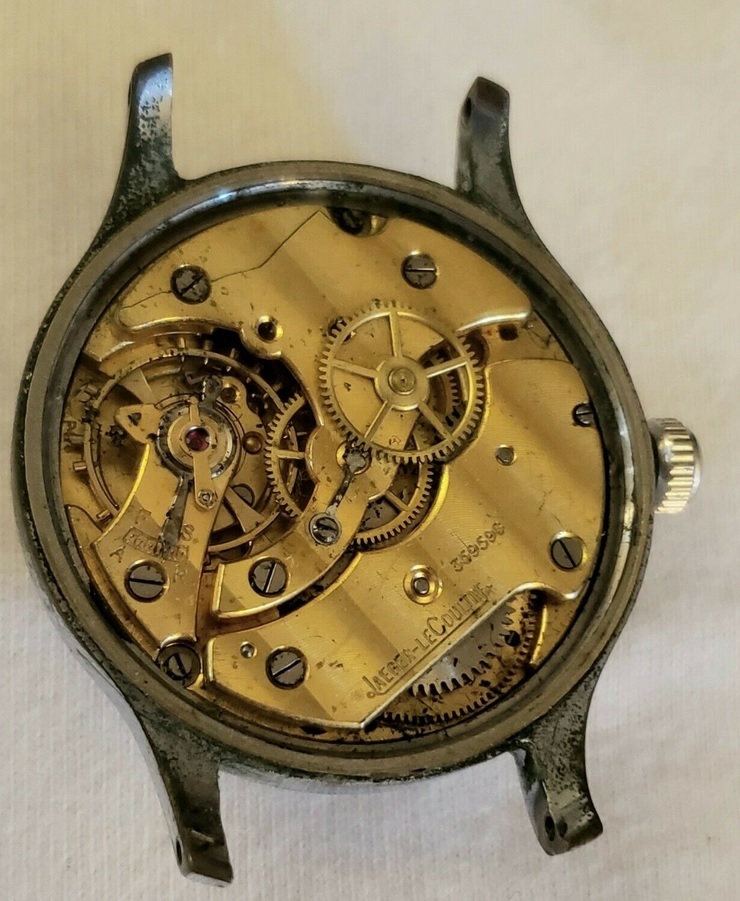

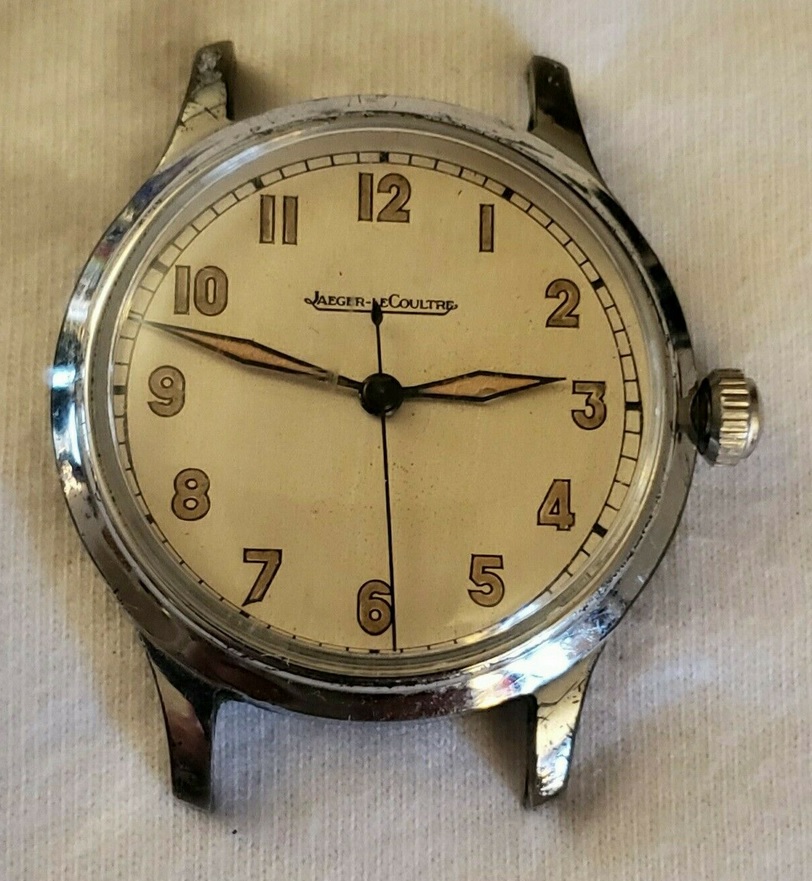

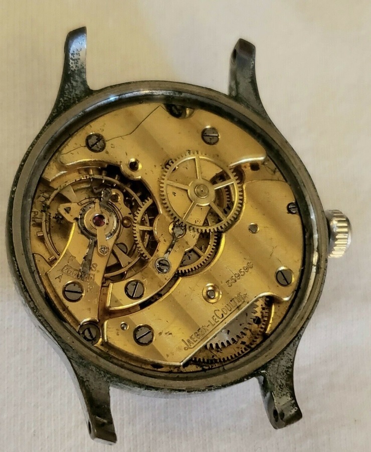

Thank you for explaining, I see exactly what you are talking about. Also I hate to be a bother, I am just learning and dont want to make a costly mistake, but would you mind giving me your opinion of the JLC in the photo attached here.
13,549
18,851
Lots of rust on this one, but I think the dial is original. The case is in poor condition also.
You really want to stay away from chrome plated cases. One little scratch and moisture gets under the plating. The brass case starts reacting with the water, gas forms, and then the chrome plating starts coming off in chunks.
gatorcpa
16
6
gatorcpa
Thank you for your advice and taking the time to explain it to me.
