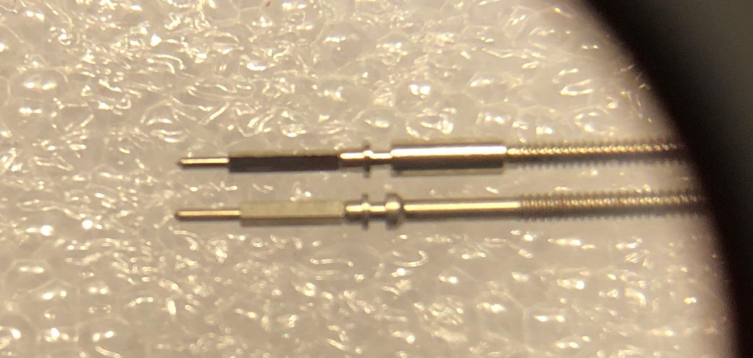

    Hi, sorry for digging out this old topic, but I need advice in the 550x563 stems. What is the difference between those two stems I should look for/measure??
    I have mixed up by accident my batch of stems for those calibers. Can you just by seeing the picture guess, which is 550 and which 563?
    I had I think the upper one in the cal561 tray (550.1106) and the lower stem in cal565 (563.1106), but I`m not sure... big thanx.

    The stem with the longer pilot diameter is the 563 - so the lower one in your photo.

    197
    155
    ..as I thought, as it has to travel more for the date quick change. Thanx a lot for confirmation. As always, you are the master!
