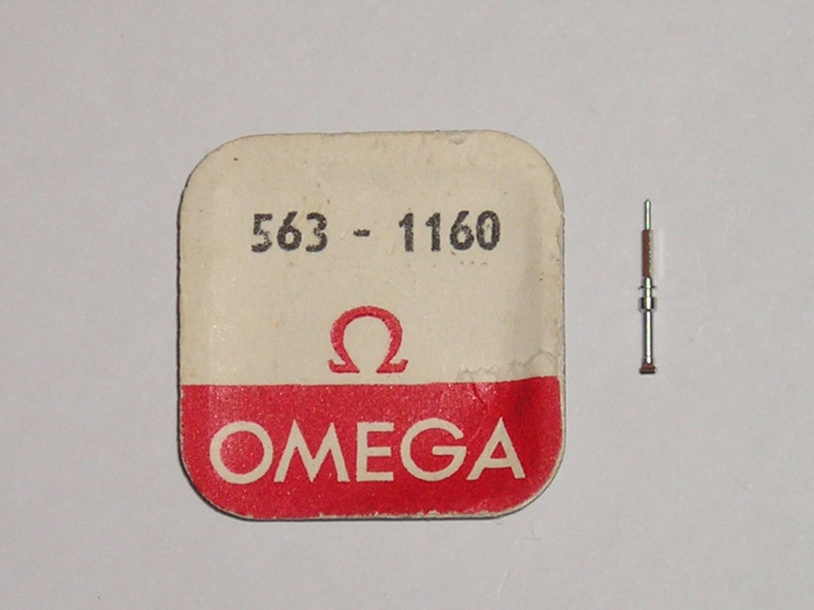

    Hi have been looking for the correct stem for a Seamaster 166.032 / 168.023 case and according to the 751 / 752 technical documents there are 2 different stem design styles available:
    1- Winding stem length (72205631125):
    And what seems to be a 2 piece design (72205631160; winding stem movement part with beak):
    Which would be the correct one to go with the OEM stem 069ST42527 ?
    Thanks
  2. X350 XJR Vintage Omega Aficionado Jan 1, 2019
    12,586
    29,833
    You need the one piece stem, the split stem is for a front loading case like a Seamaster de Ville 166.020.
