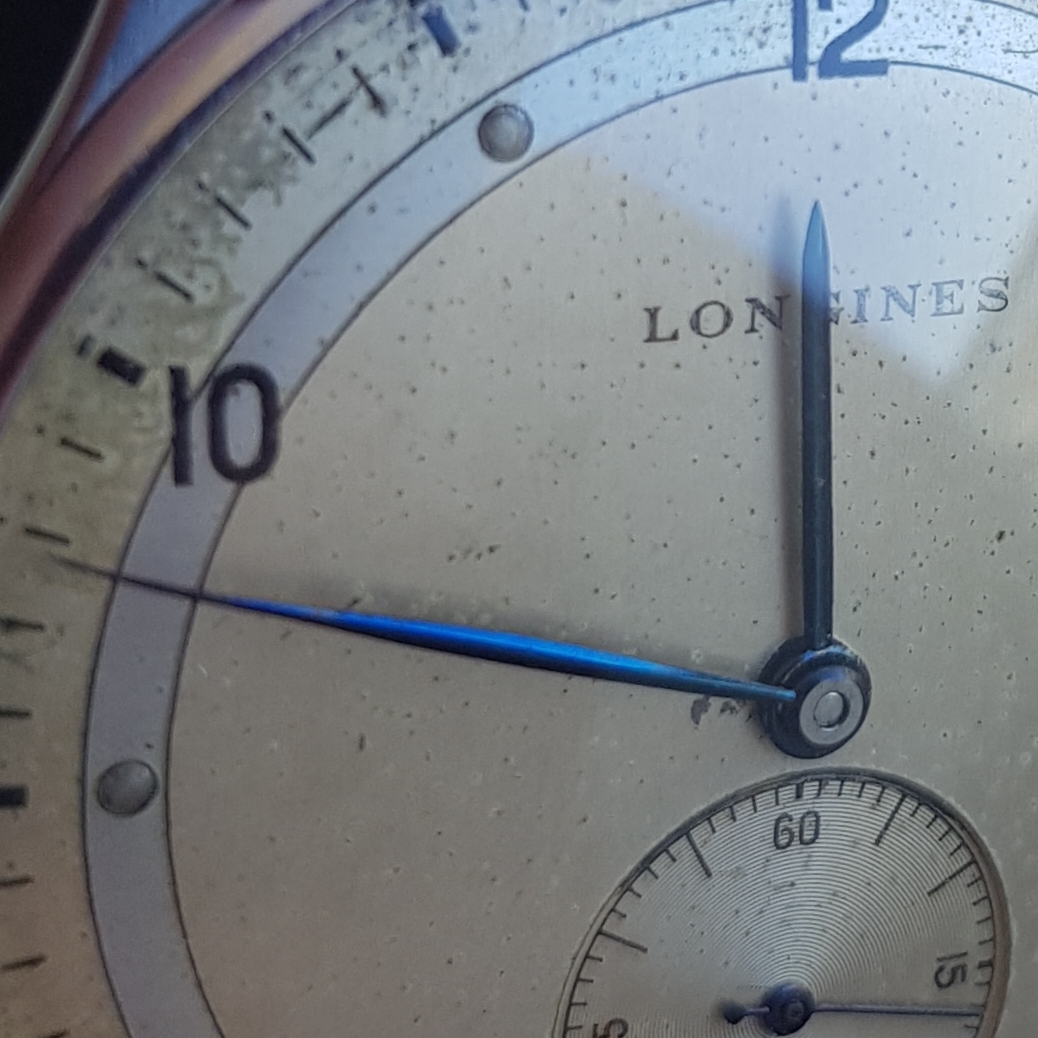

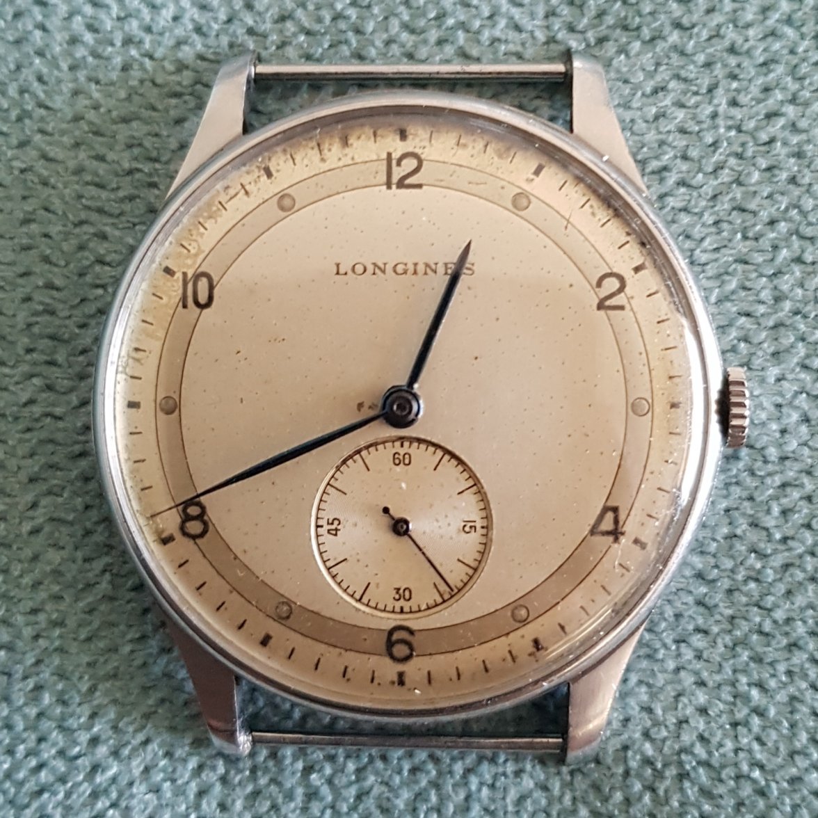

Hi there, just wondering if anyone knows where I could get correct hands for my Longines 5581. It has a 27m movement. As you can see the hour hand is a baton hand rather than a leaf hand.
Longines have recomended I send it back to Switzerland for a full refurbishing, but I really just want the hands, and can go to a local jeweler to fit.

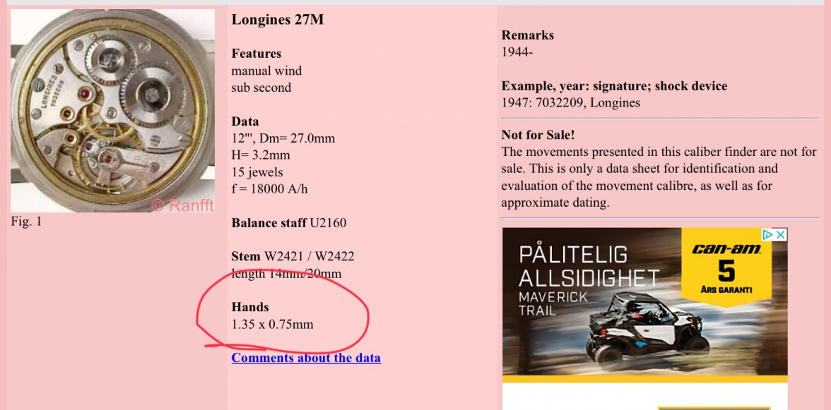

Currently the minute and seconds hand look correct, but the hour hand is a baton hand and too short, probably from a regular sized 27m watch.
Perhaps another way to phrase it would be does anyone know the exact dimensions of the hole for the hour hand for a 27m? Is it standard for watches of the period?

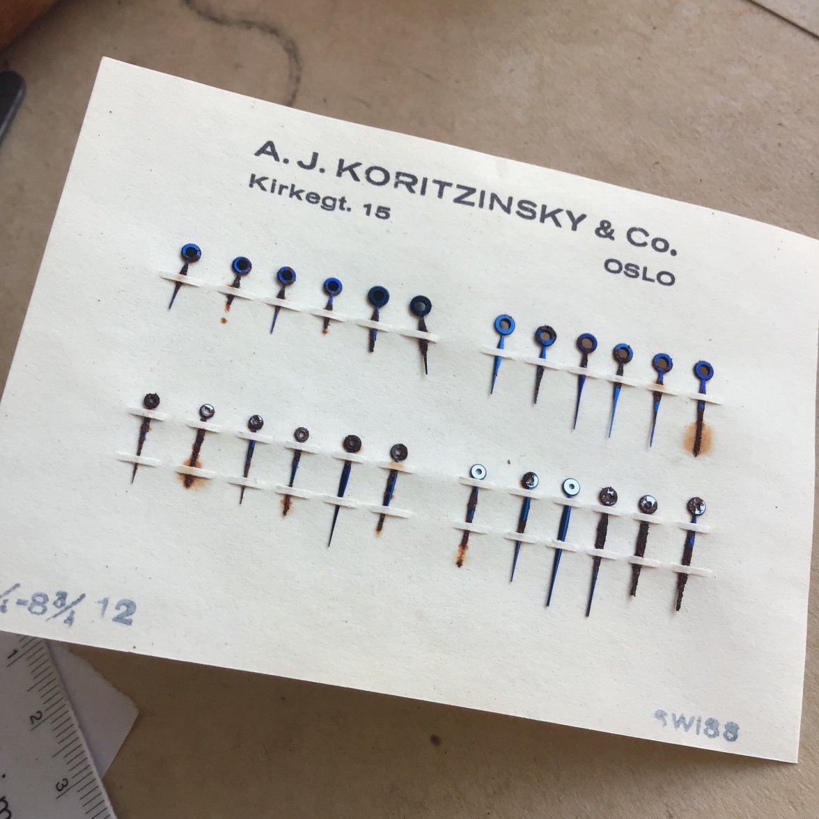

Proper hands can be sourced, but your best chance is to find someone
who has a complete hands assortment from Best Fit, Ronda or simular.

If you know the length that you need, I think you can find something approximately correct from a parts supplier like Ofrei or Cousins. It might not be original, and the bore might have to be slightly adjusted, but it will look a lot better than what you have.

I just wanted to correct what I mentioned, the hands I was trying to source seemed to be from the same watch but it seems they were from a model with the Cal.12.68z. The dimensions are almost identical however the 1.35 x 0.75mm is the measurement for the 27m where the 12.68z is 1.32 x 0.75mm....not sure how much of a difference that would make but probably something.
24,801
55,084
A knowledgeable watchmaker can make small changes in the hole sizes. There is certainly no need to obsess about a hole that is 0.05mm too small if otherwise the hand meets your needs.
