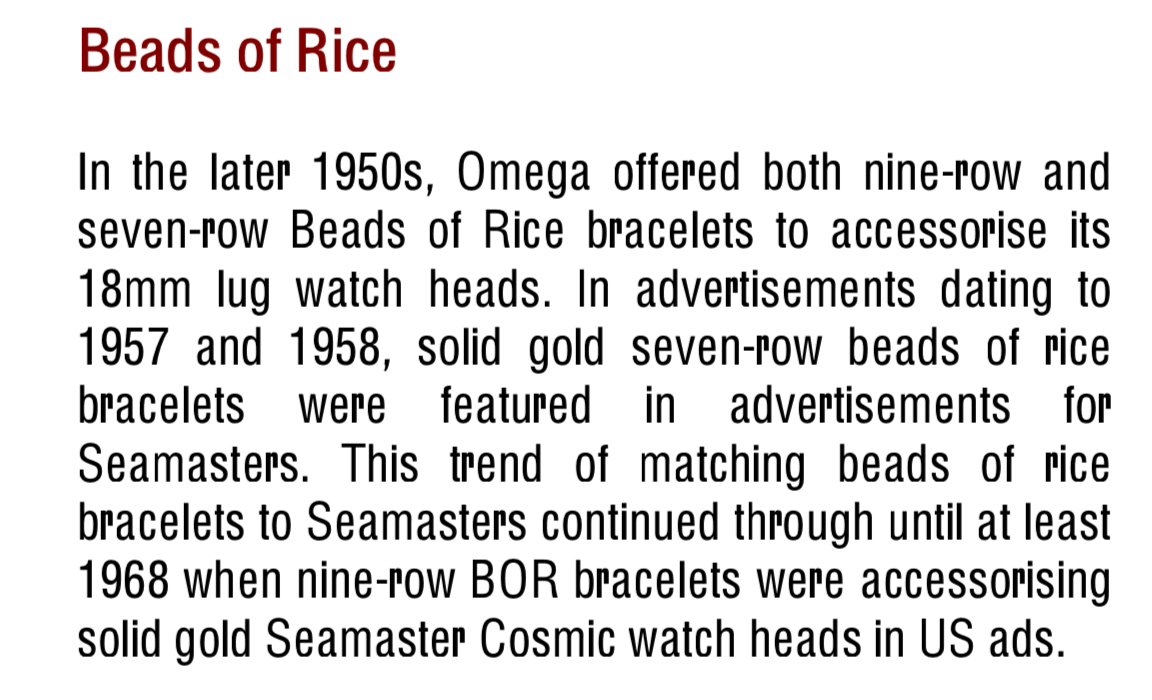

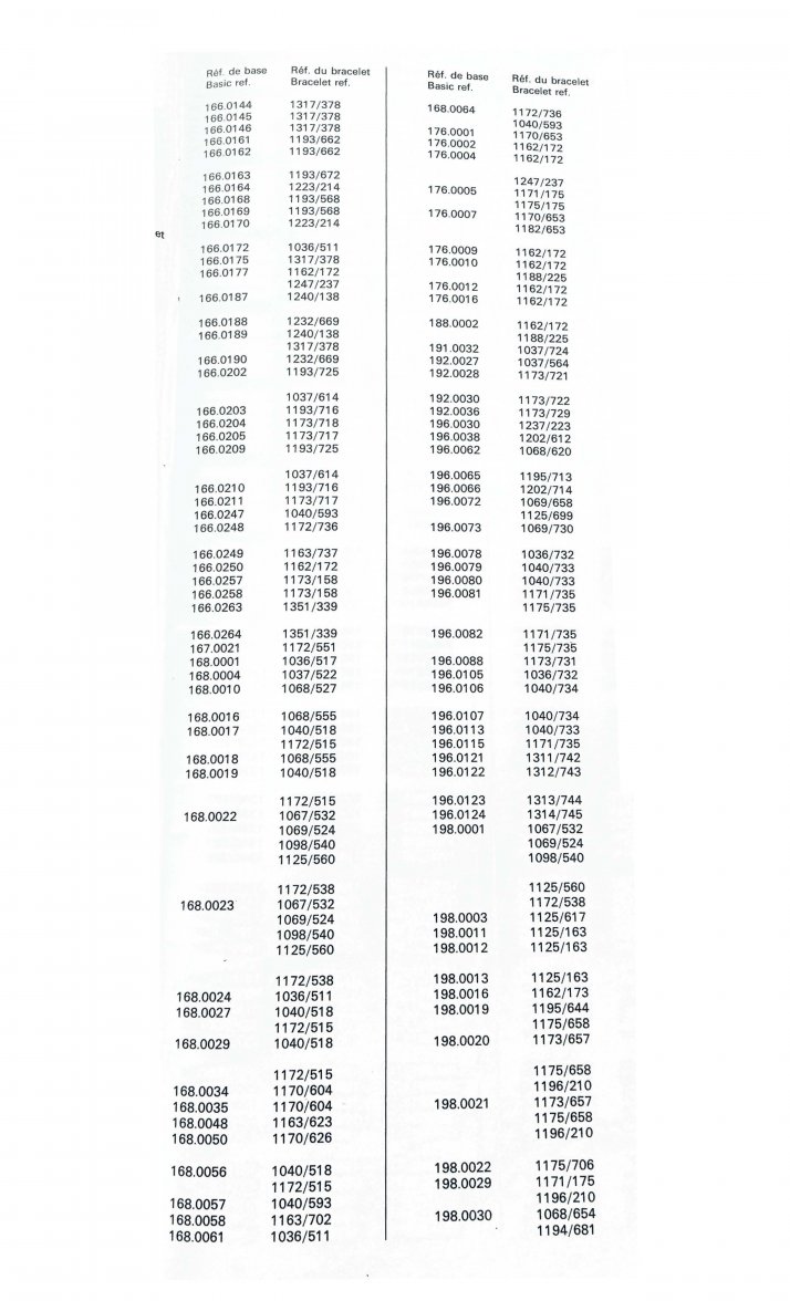

To list all the references here would be a futile exercise. The 511 were the successors to the 11 endlinks. Bracelets were an option at the boutique, so often it is difficult to determine exact references which fit on exact endlink references, particularly before the 6 digit references.
In my opinion the change between the 511s and 11s was around the mid-late 60s. If your watch is after that, and has an appropriate curvature and has 18mm lugs, then it is possible that the 511s could have been offered on that watch from the boutique.
Do note that the 11 endlinks were on the 7 row instead of 9 row beads of rice; the more "angular" watches (think Dog Legged Connies) look better on the 9 row, where the curvier watches look better on the 7 row.
But if you do want specific references, have these two: 165.010, 166.009, or any fat lugged seamaster.
It is probably best asking here when you find a watch which you think will fit, the endlinks, to make sure that it is period and style appropriate.

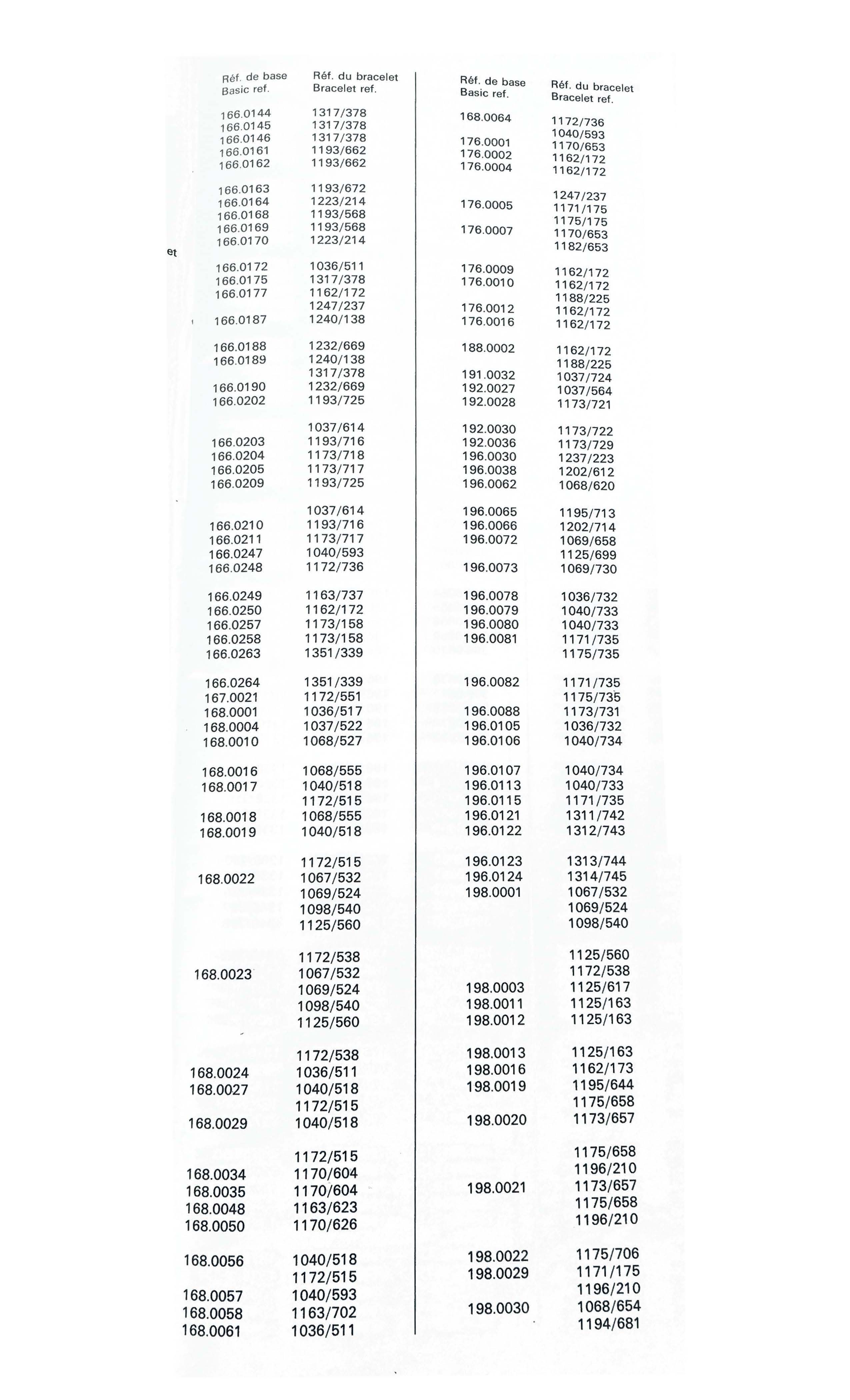

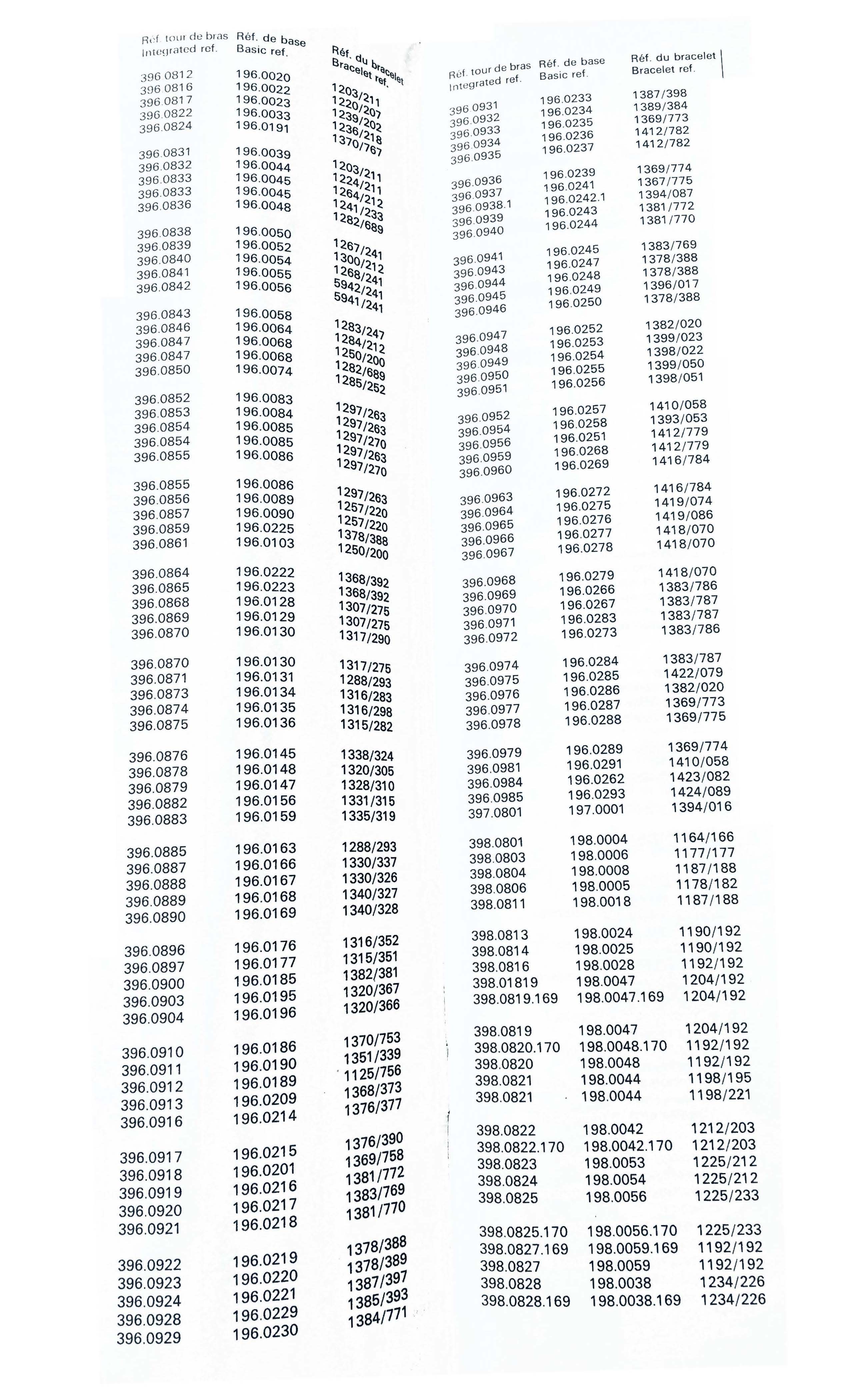

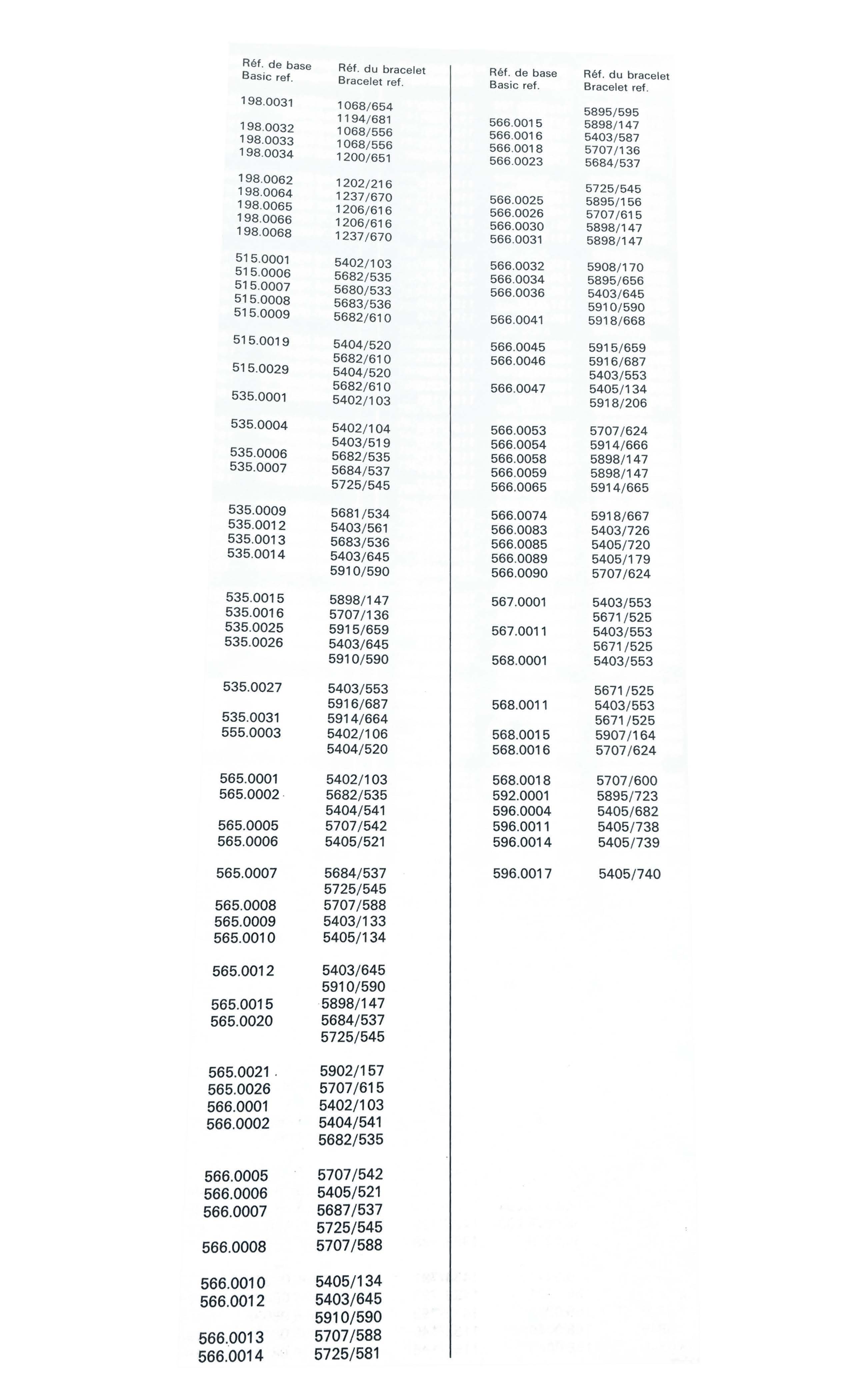

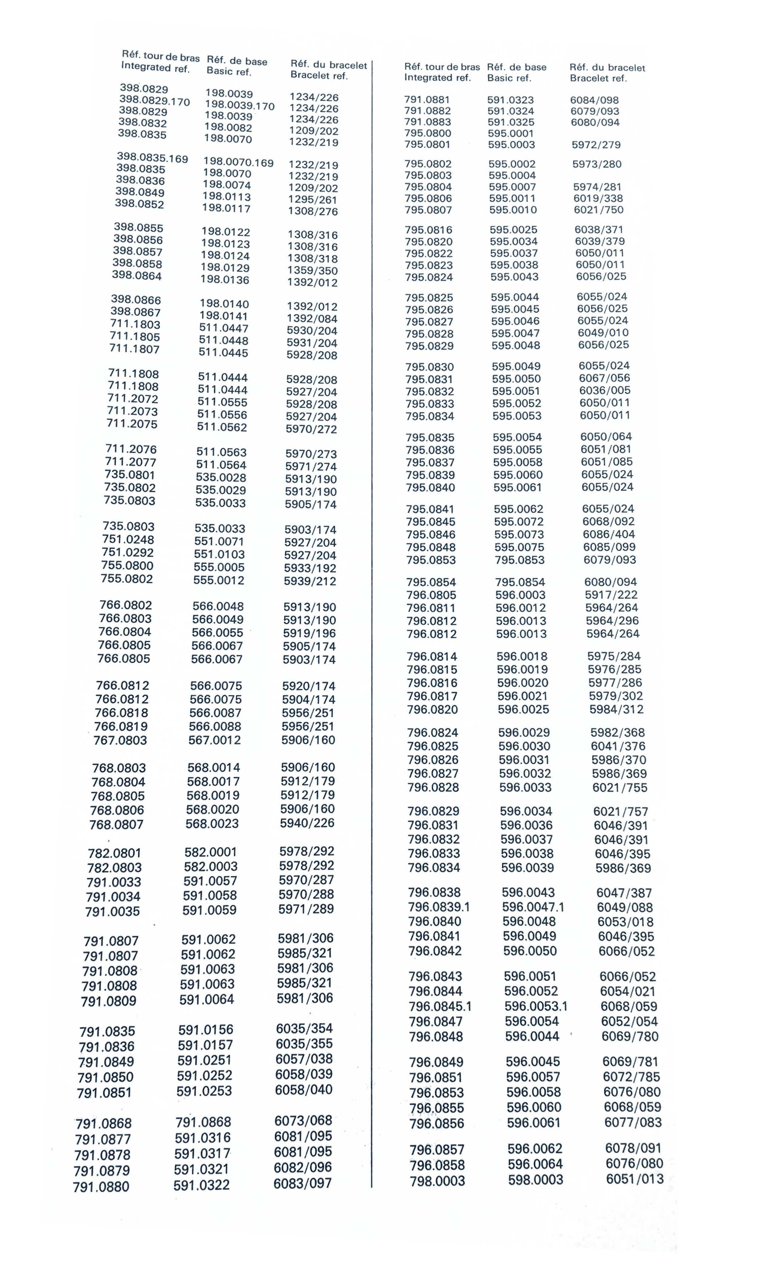

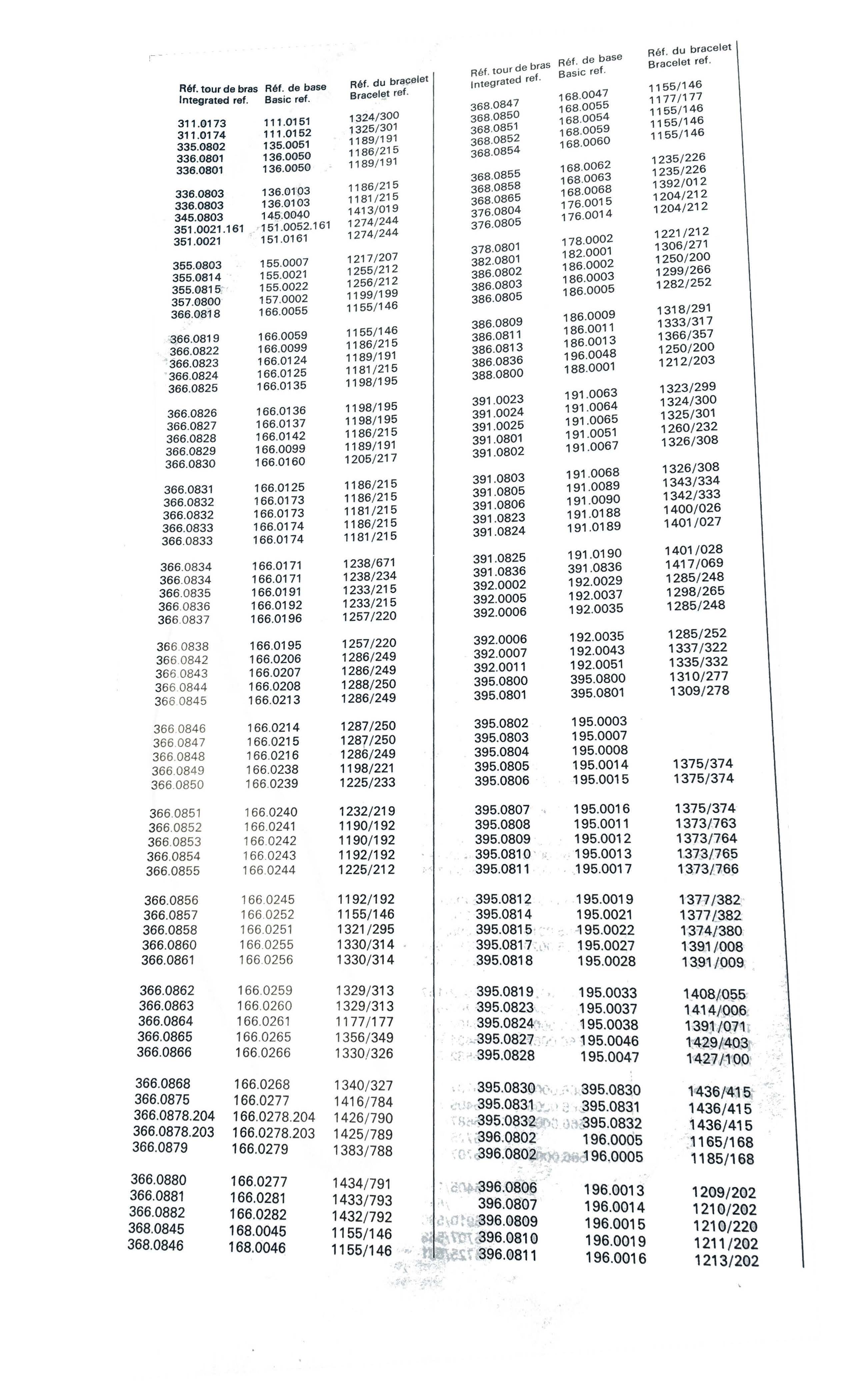

1,193
6,193

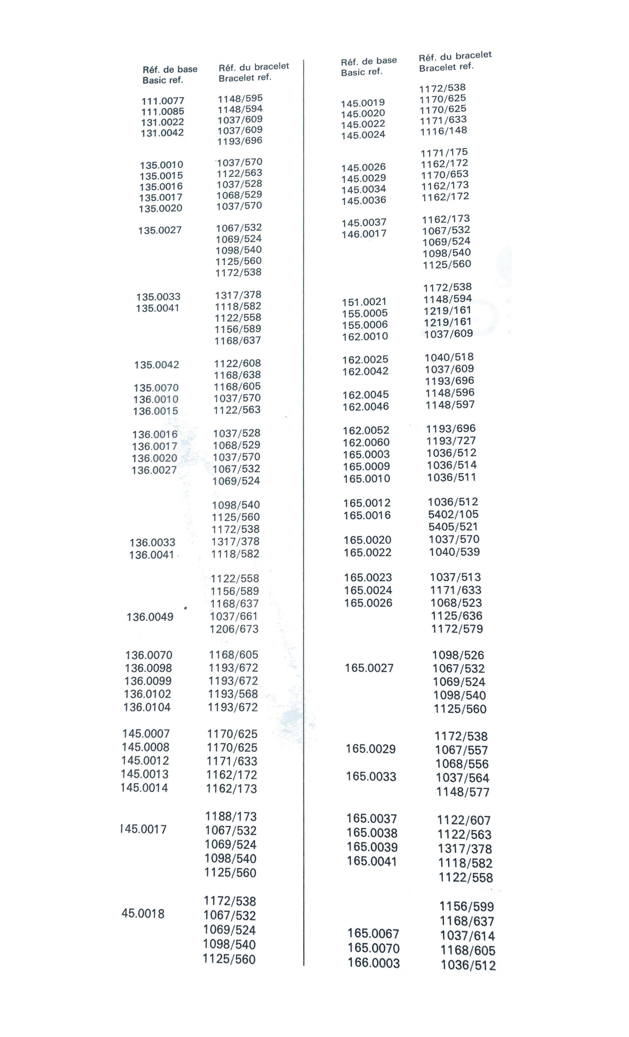

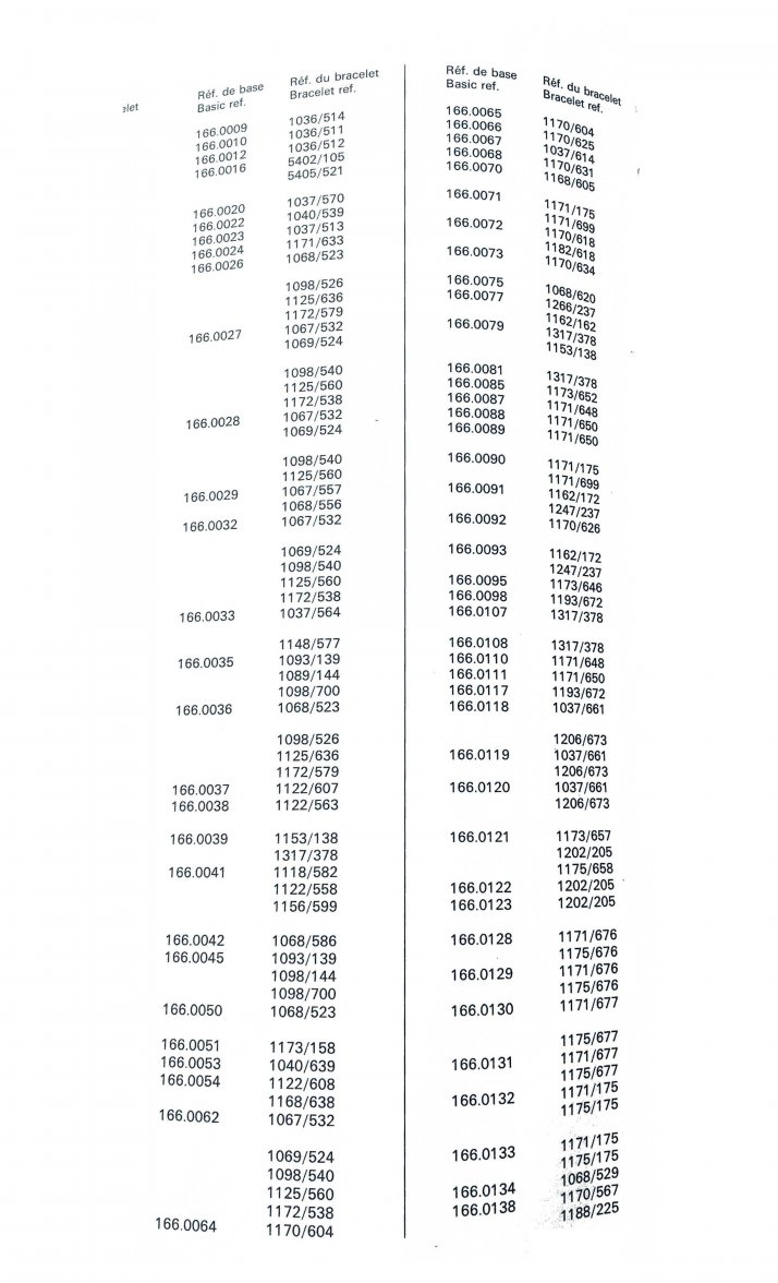

This was originally posted by @tdn-dk. I cleaned up the files. I hope it is helpful. Message me and I'll send you a pdf that is searchable.
13,492
31,811

More commonly referred to as 5-row and 7-row, the outer links are not counted.
I know that it is sometimes referred to like that, but I have found many people to be confused by this.
The specific problem is that a 7 row, could be 7, if you don't count the outerlinks, and 9 if you do. So when I explain that some people need a 7 row, I invariable get asked what I mean.
Changing it to 9 and 7 removes the confusion (or at least some of it).
Im not sure I have explained this very well though.
6,832
10,502
It certainly is confusing - which is why, for ease, I’ve recently started to refer to them as ‘Rounded beads’ and ‘squared beads’.
(But I’m probably only adding to the confusion)
Desmond refers to them as 7&9 but I can’t disagree that the beads (or grains if you prefer) of rice are in fact only 5&7.

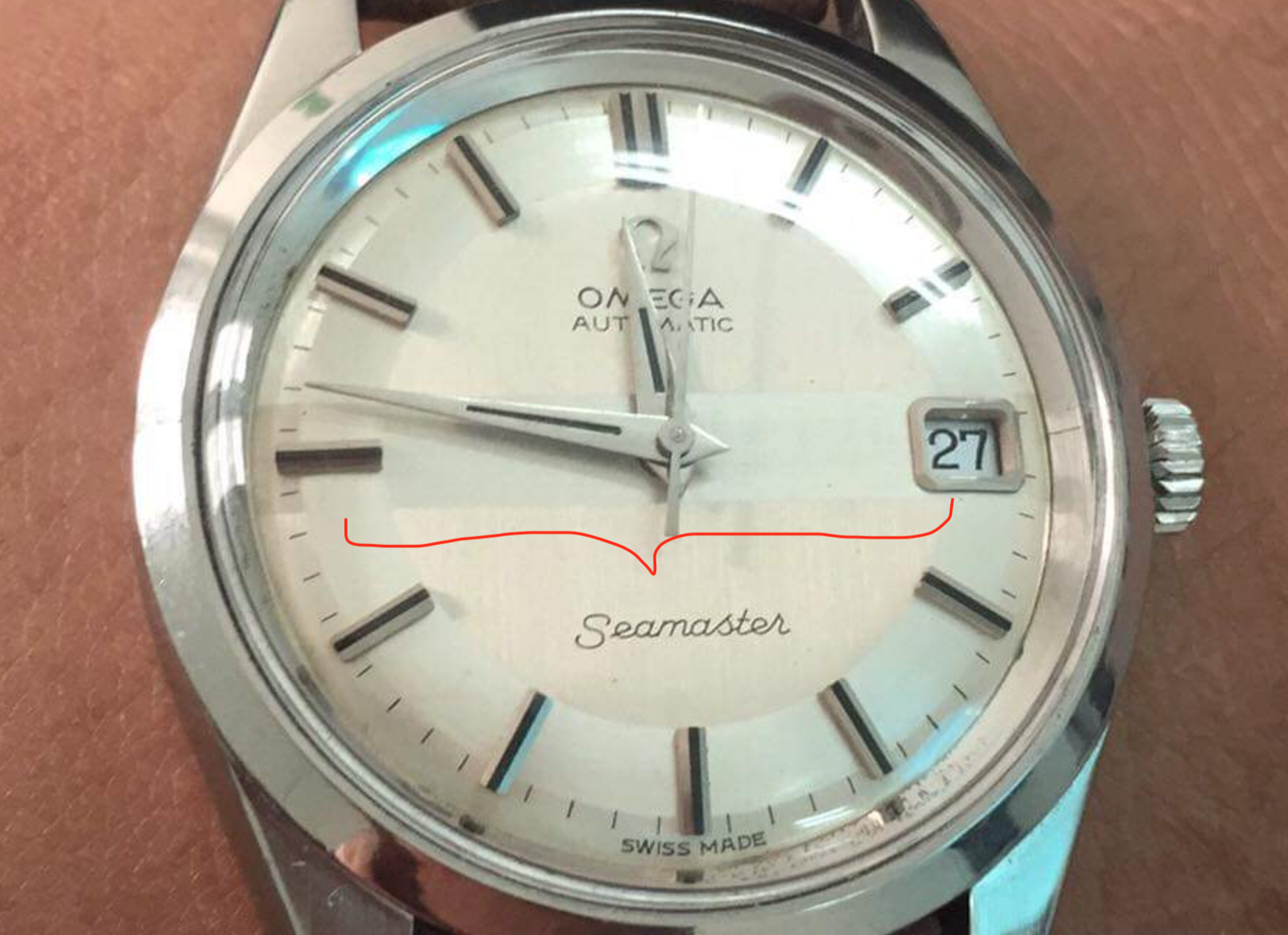

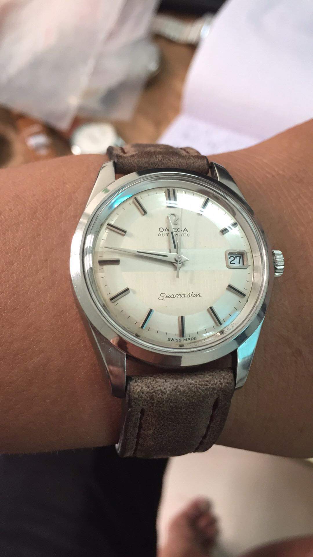

I am about to pull the trigger on a 166.010, looking for your opinion on the dial originality. The font seems corect to my eyes, however the dial looks like in piepan shape and I am not sure if I have ever saw one in this shape be for. This is the seller' s picture.
Thanks guy.

My 166.010 does not look like that with respect to the dial. However, I think it's original.
You make your choice but I would not doubt it.
However, the caseback said it is 166010 with cal. 565 dated 1968. Do you have any ideas? Could this be a franken piece? Many thanks?
5,631
5,815
Anything is possible but it’s the right movement and time period.
Thanks guy.
I'm having an issue with this horizontal band across the dial. It looks like it's not a reflection. I'm having an issue with the owner's foot as well, but I suppose that can't be helped.
Now I notice the band, should it be something to be worry about. Thanks
