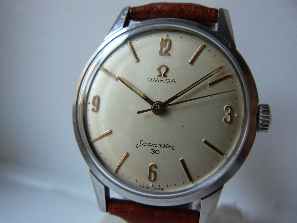

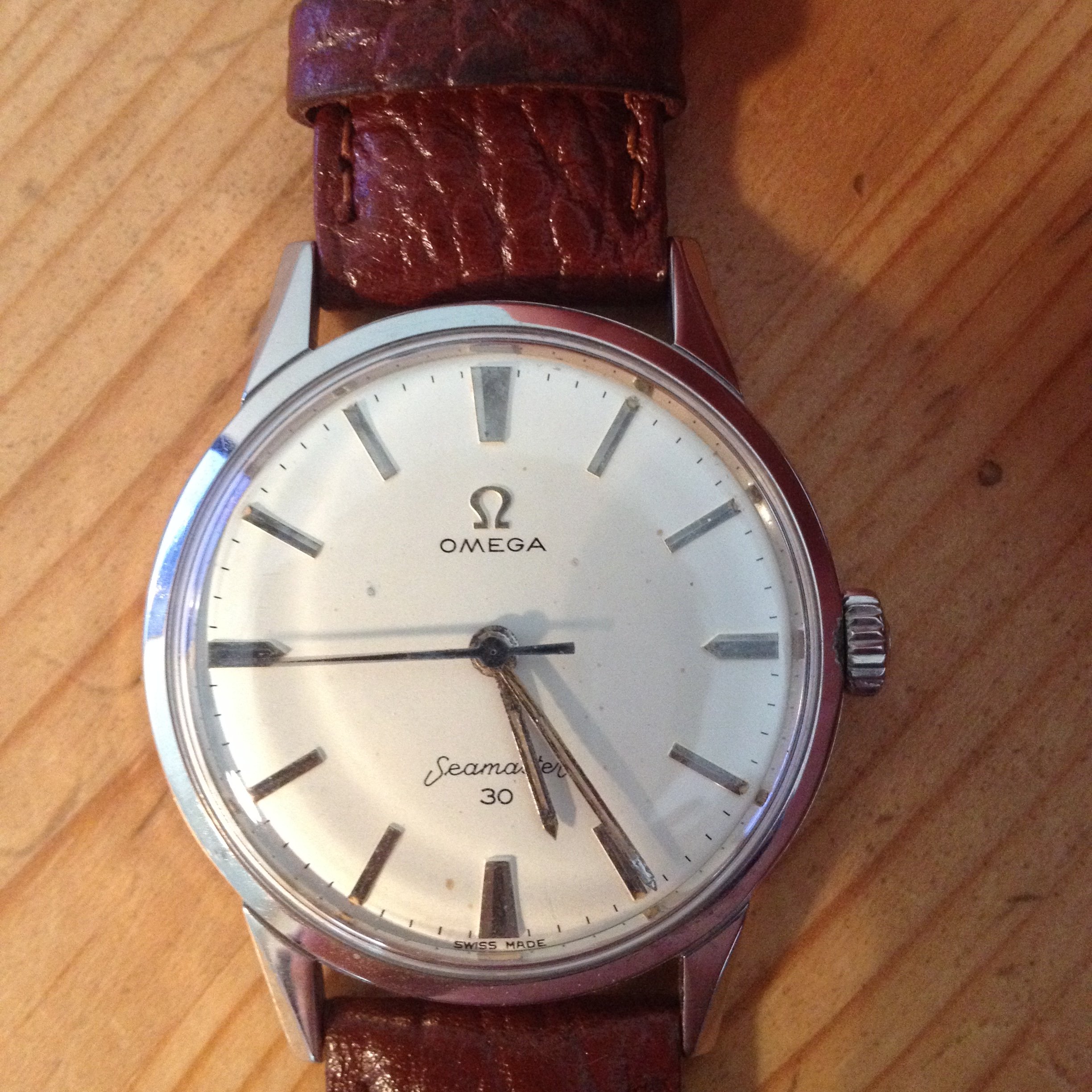

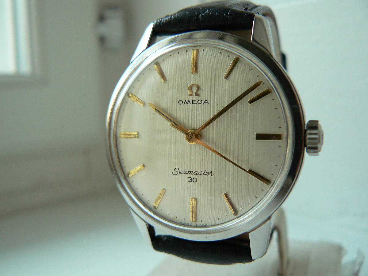

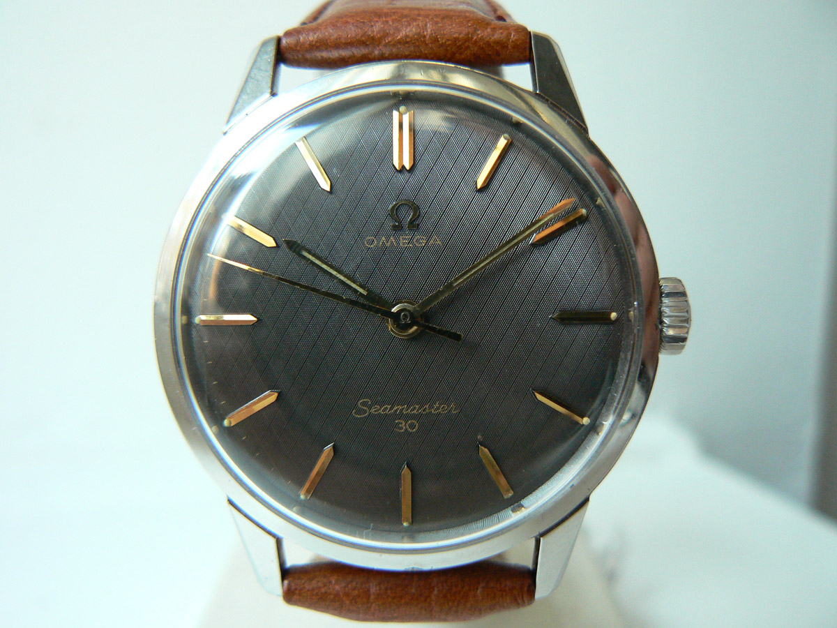

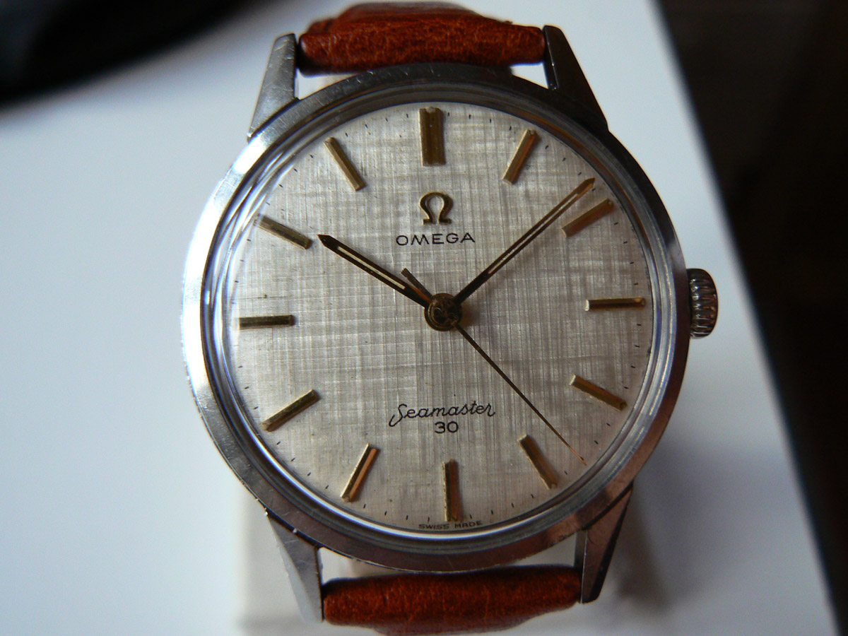

    Also I saw that dial in Omegas link (135.003) has no "30" on it. I have had some 30-40 Seamaster 30 (both with 286 and 269) and still have not encountered one without "30" on dial. I attached some of my ex Seamaster 30 so you can see that there was quite a variety.
    Here is link for related 135.007
    https://www.omegawatches.com/planet...ache=1&cHash=e37da2d73836a0bea8dcc9d89bd9115f

  8. Pete1 Apr 19, 2016
    8
    5
    By the way, your one with the black dial is so gorgeous.
    I'm gonna have to keep my eyes open for one of those.
