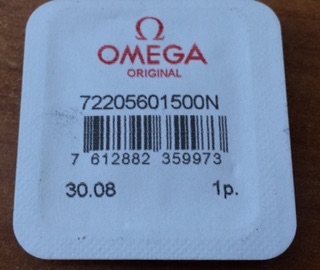

    Hi,
    may I ask for your help?
    Is this the right serial number for the black background/white letters date wheel for watchco Seamaster 300 ?
    Thanks alot
    Watchme

    Sorry for the missing picture. ::facepalm1::

    Same one I used. You don't need to get these from eBay, if that's where you're looking, Cousins in UK and Ofrei in USA still sell them. The one you're looking at is nearly 7 years old if I read the code correctly not that it should be a problem.
    These are actually a slightly convex shape and the SM300 dial is flat so, it is not perfect but you don't notice it. I think the correct one ends in 'A' and is flat but, I don't believe you can get these any more.

    I think the 1500N is not the correct one as it has a curved surface. The 1580N is the flat one and is still available, or at least Al has just ordered one for my 166.068 and a couple for himself for SM300's.
