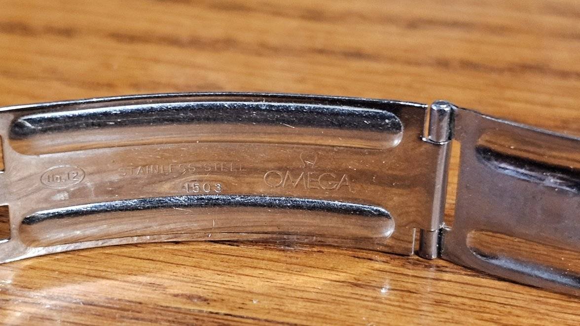

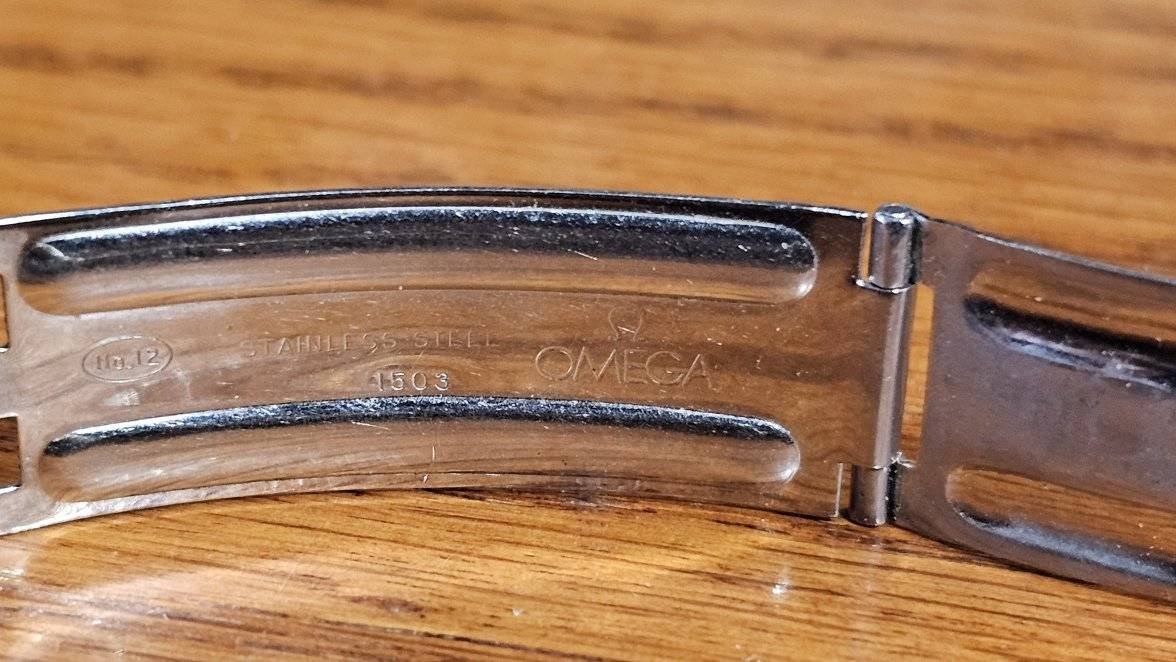

A 5-row Beads of Rice (BoR), references are 1502, 1036, 8220 or 3010. The endlinks are number 11, 511 or 12. 11 and 511 are identical, the 12s are slightly less curved at the end that sits between the lugs of your watch. Note that there are unnumbered endlinks and bracelets that are still correct. Some have a circled 12 in the clasp which has nothing to do with the reference number. All look like this:
or
a 7-row Beads of Rice (BoR), references are 1503, 1037, 1068, 8270. The end links are numbered 70 or 570. Note that there are unnumbered bracelets that are still correct. Some have a circled 12 in the clasp which has nothing to do with the reference number. All look like this:

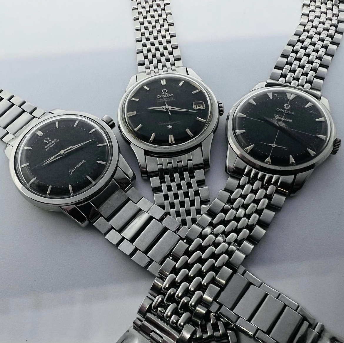

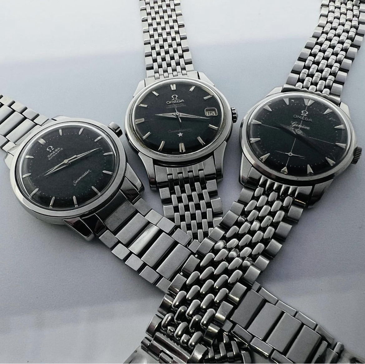

And not sure if that does anything for you, but here’s a picture I took a while ago for another thread. It’s of all three bracelets (with a flatlink), albeit attached to watches. Still, might help emphasizing the differences:
(left to right: flatlink, 7-row, 5-row)

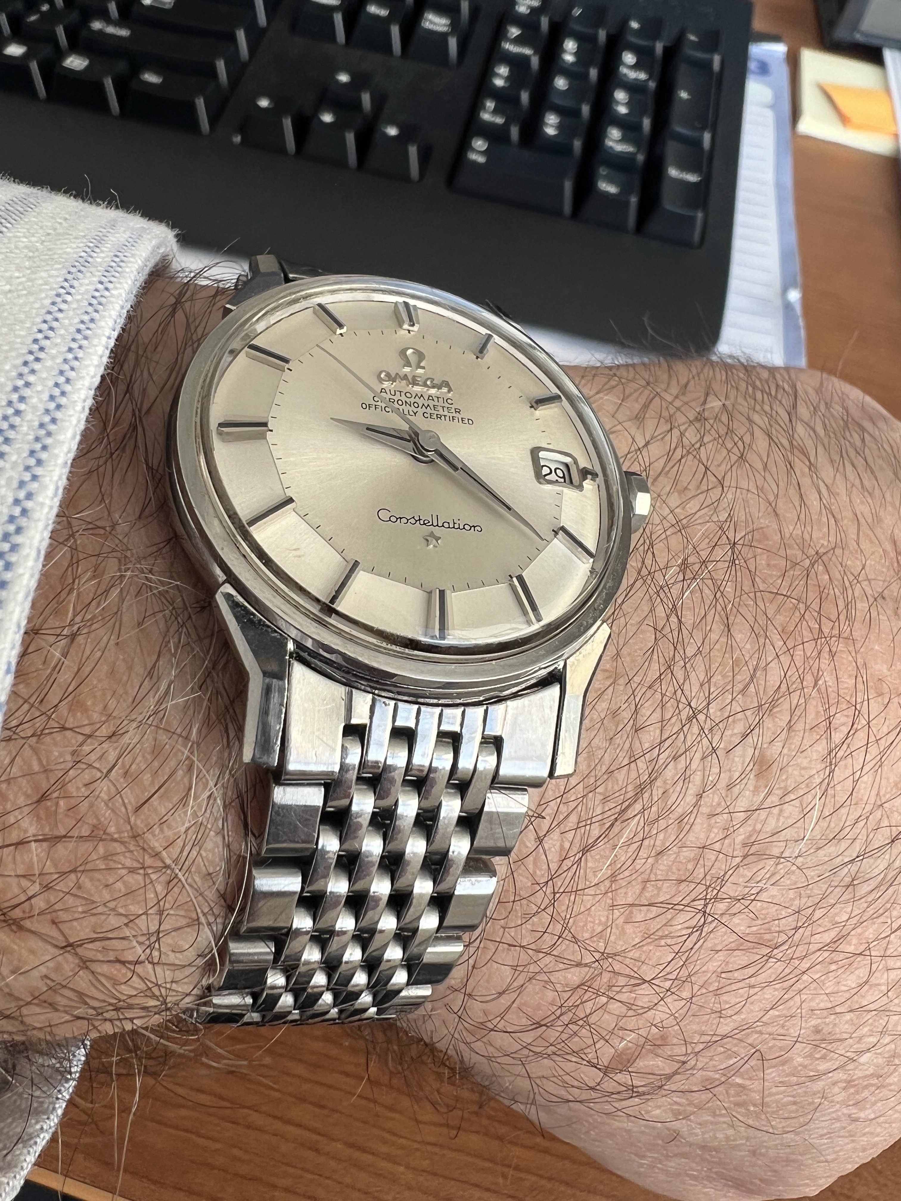

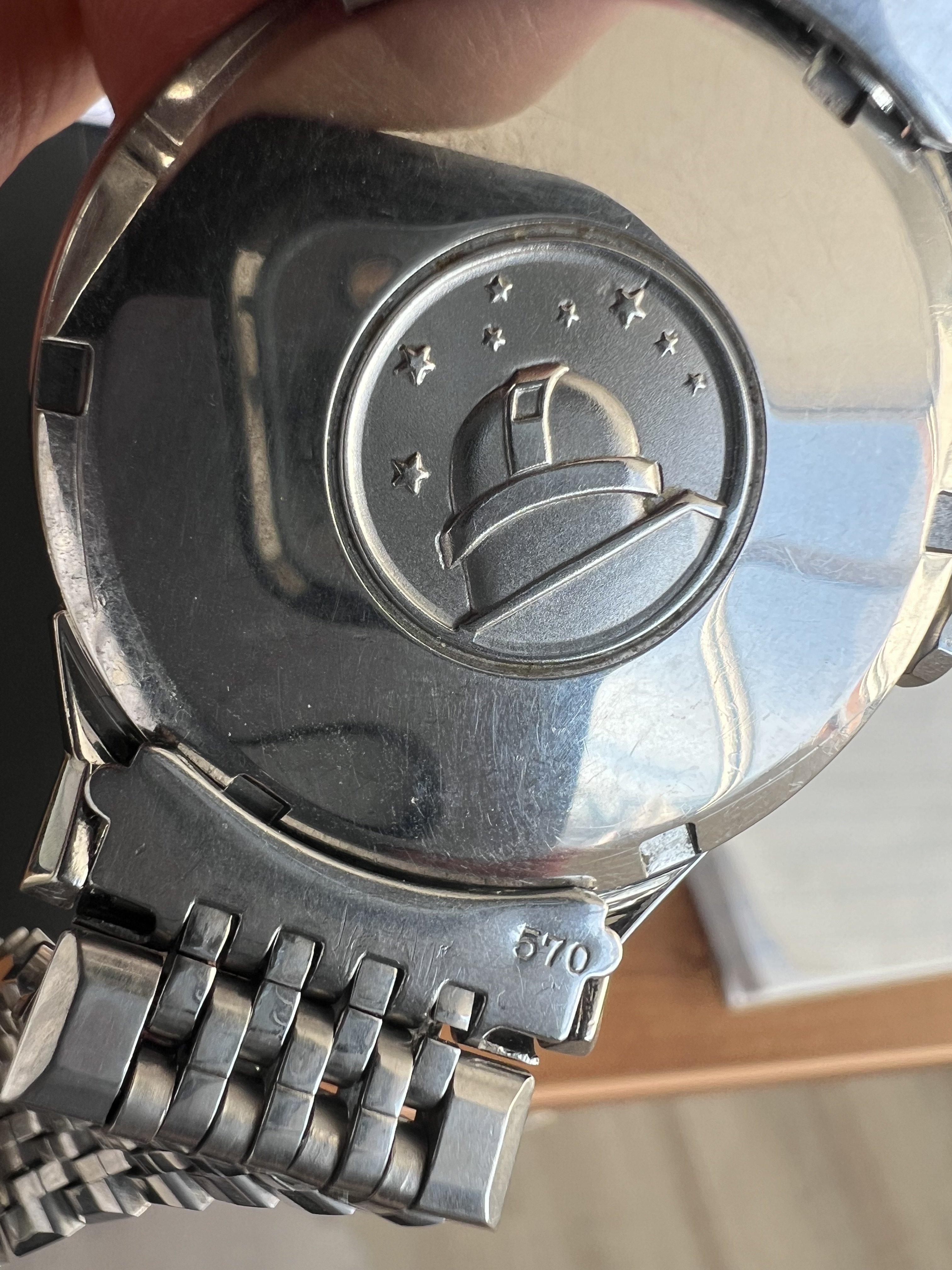

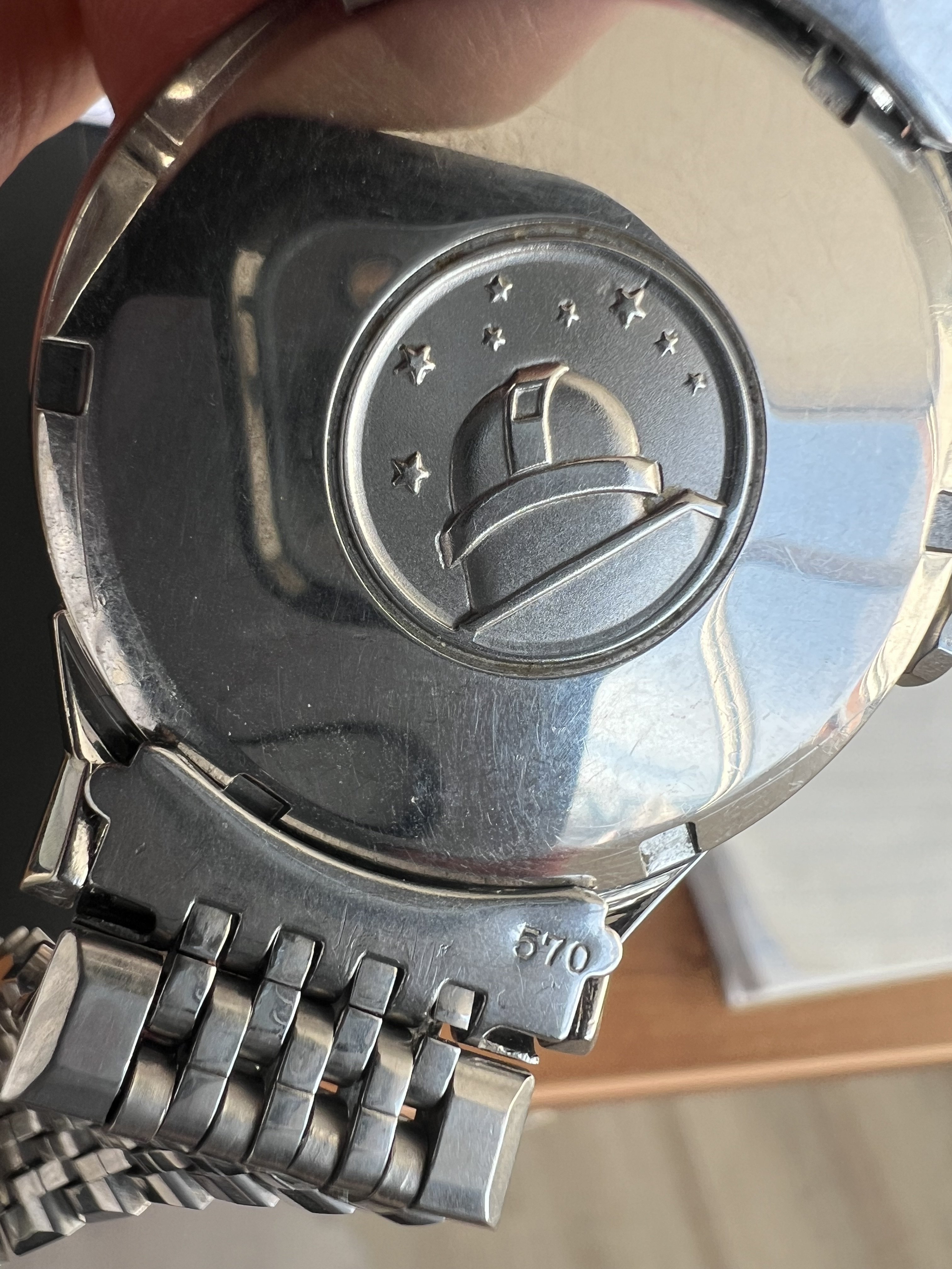

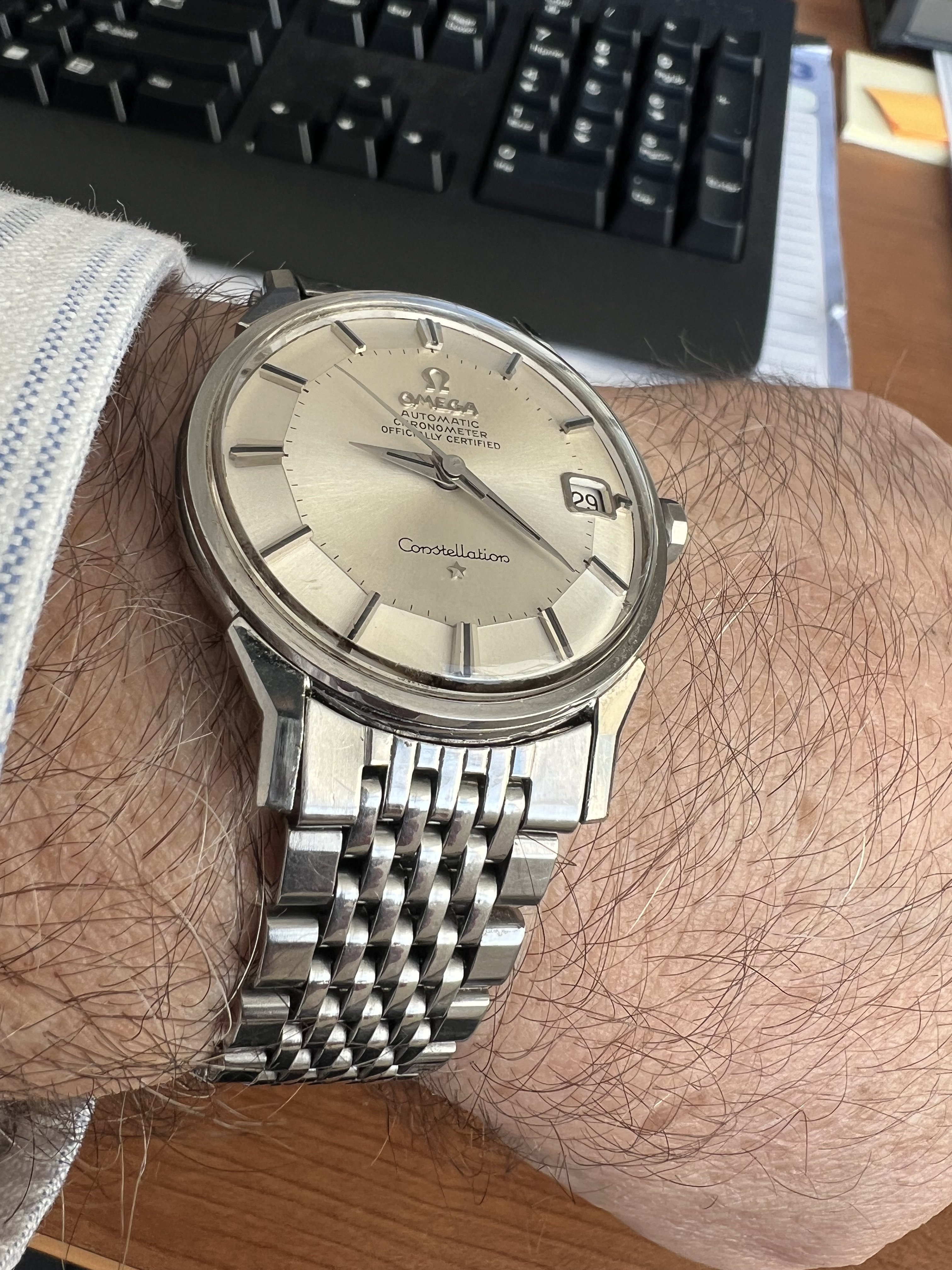

168.005 on BOR 1503 with 570 endlinks
Very comfy looks great and affordable. Good place to start IMO
