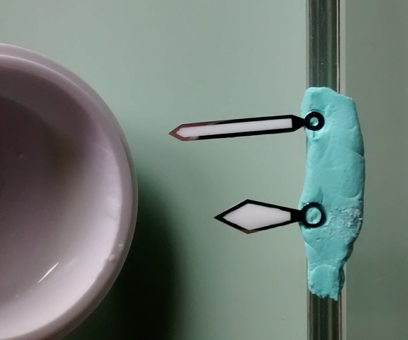

    This is the result:
    As you can see, lots left over to throw away. A tiny amount has crept onto the front of the hour hand that will clean off later. This is still wet but starts drying quickly when spread thinly and takes about six hours to set fully or you can bake at a low heat...
    That hour hand lume may yet sink when it dries so, will see how they look tomorrow and fit to the dial to see if they match.

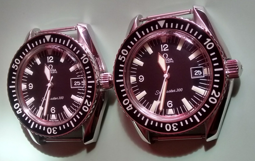

    So, this is what I started with, the one on the left is the C1 but with C3 hands and us very mismatched. The one on the right us all C3.
    I can't get a lume shot at the moment but, there is a colour difference in daylight too. It is subtle but, noticeable on the wrist. The C3 has a green tinge. On the left, now all C1 and on the right, all C3. Not 100% happy with the hour hand but decided to put it back together:

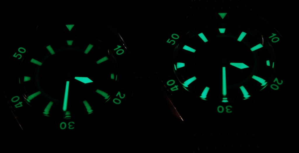

    Will post a lume shot later. I didn't change the second hand lume as it is really not a noticeable difference but might revisit that decision....
    And, yes, having let the movement down to fit the hands, I started the left one to be within a second of the right.... Got to try and relax more.

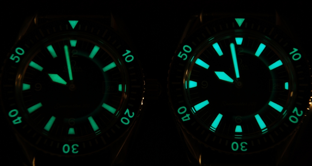

    This is what the two look like now. The C1 is on the left and the hands are now a fine match.
