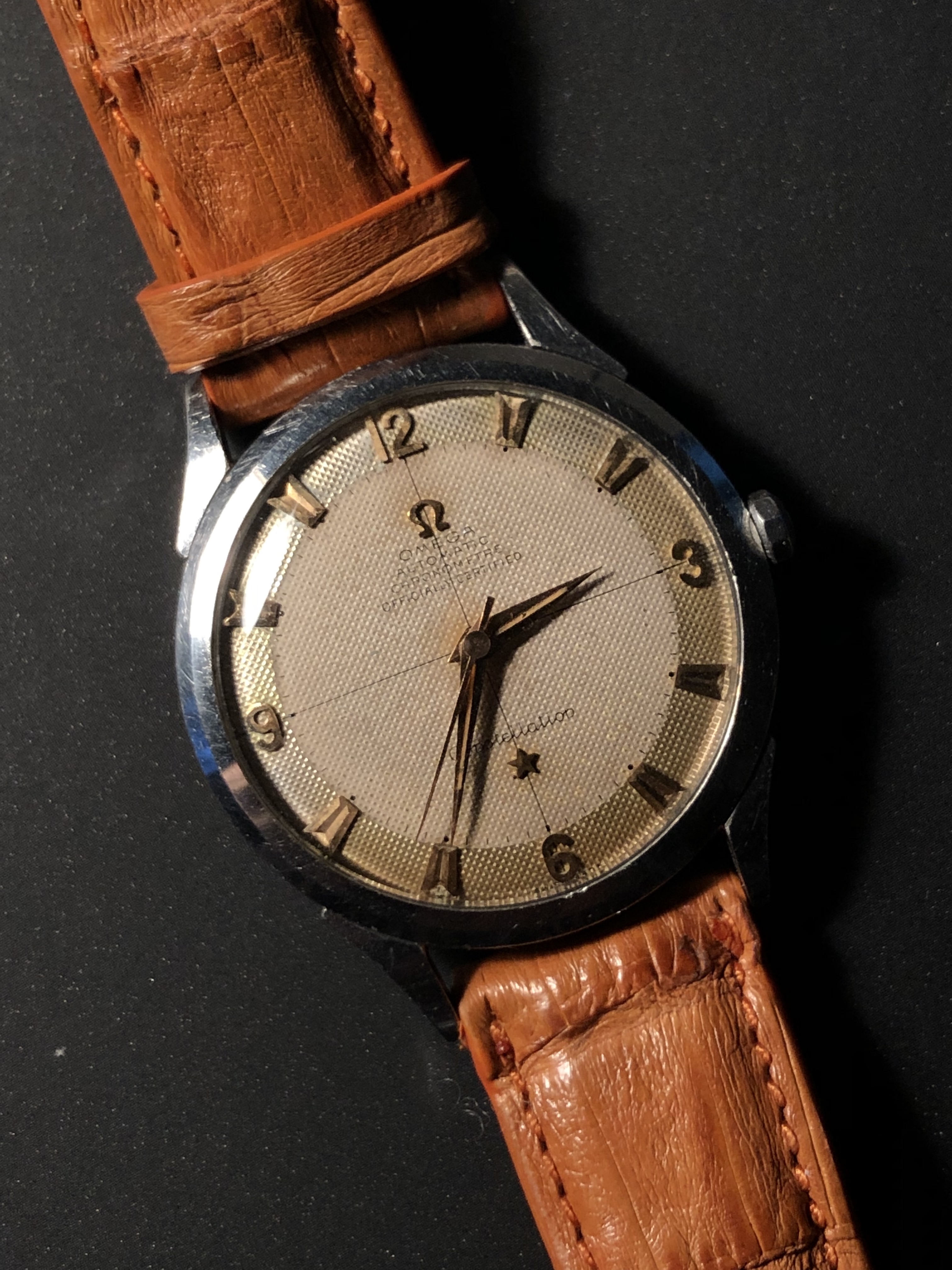

Hey people, just looking on opinions on this piece. It's a Constellation with Honeycomb and crosshair dial, which is a nice combination. This is apparently a version that predates the fully automatic movement, as this one is a "bumper" automatic.
The only thing that weirded me out is those hands, as I've only ever seen dauphine hands on Constellations, although the seller has told me that these hands have been used on bumper constellations, and that it was purchased from a reputable watch dealer in my area.
He's asking $1200 CAD for it. All original apparently, besides the strap. What's everyone's opinions? Thoughts on the hands? On bumper movements? I've had my eye on a Constellation with a crosshair dial for a good while now. Just want a second opinion before I move further.

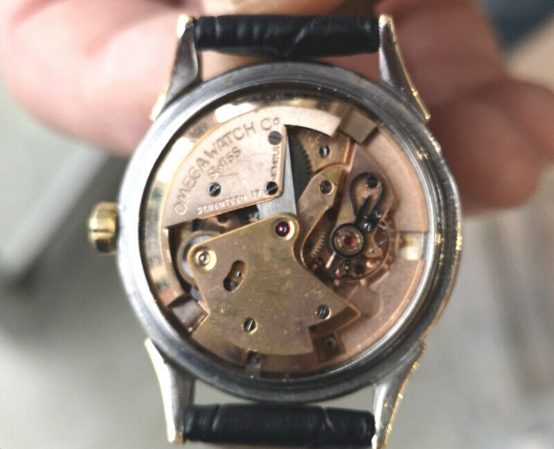

There's a few problems here apart from the incorrect hands which have never been seen on a Constellation.
The most serious of which is the state of the 354 movement, which as a chronometer, should have the 5 adjustments engraved on the rotor. Also I'd expect a serial on the other bridge which is also miissing. Conclussion: full movement swap or multiple parts swapped.
Secondly it has a wrong crown and thirdly I'd like more pictures of the dial before giving it a "buy pass" as it looks to maybe be missing minute hash marks.

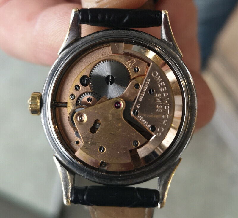

I don't have that information on hand, but I'm sure I could ask him for it. Here is the only other pic of the movement I have.
Thanks for your help! I noticed the crown looked odd too. I think I'll steer clear of this one for now, but I'm always interested in learning more about Constellations. Really appreciate it.

The dial looks repainted to me at first glance, but I'd really need to see higher resolution photos with the hour hand not obscuring the print.

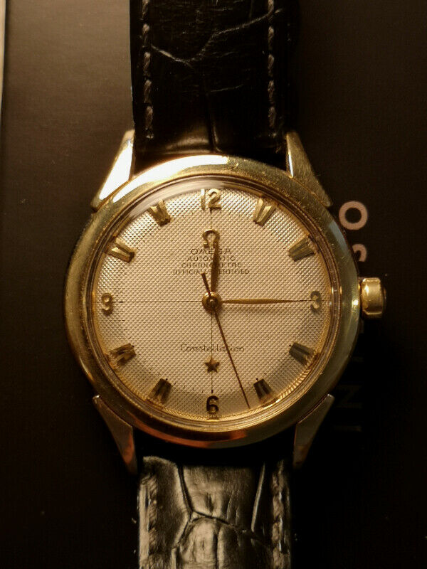

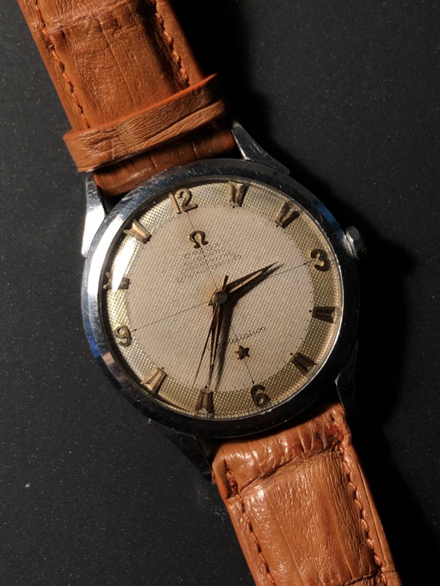

I think the dial is original. Could it be a ref. 2648 like mine, shown here?

I think the dial is original, but the hands have been replaced. The movement is also not used for the Constellations.

I can't tell if its a snap back or a screw back, OP? Then I'd go either 2782 or 2652, the bezel on a 2648 is thinner and the dial slightly bigger.
