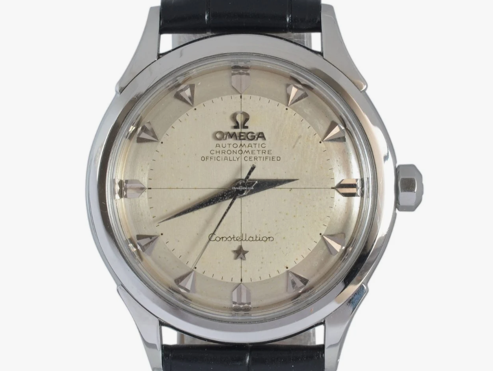

I don't see anything drastically wrong with the watch, except for the price. The case is polished and the dial patina-ed. With some patience you can do better, especially for that price.
4,857
12,285
Also, the crown is a later replacement, it has the wrong logo for the era.

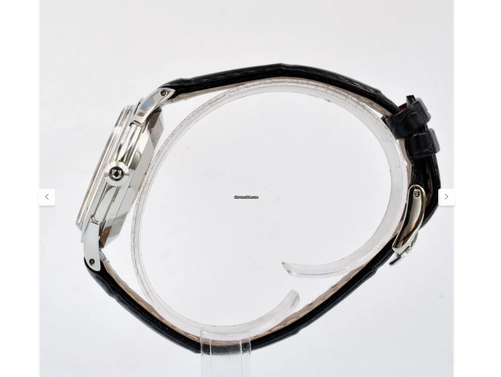

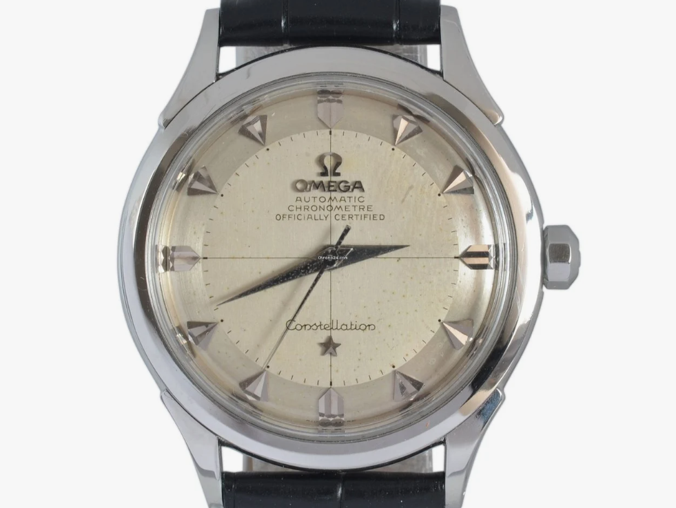

Hello, I would like to know your opinion about this watch. Does everything seem correct to you? Thank you very much
REFERENCE:2783 -10 SC
CALIBER .Automatic mechanical “bumper charge” caliber 354 - 17 Jewels
MOVEMENT SERIAL NUMBER:14767xxx ( 1954?)https://www.chrono24.es/omega/omega...lver-dial-bumper-charge-1954s--id23977295.htm
Were there connies 2783- 10 SC with silver indices?Thanks a lot.
I noticed there is a similar watch listed here at half the price: https://omegaforums.net/threads/c-1...whead-crosshair-1550-usd.159852/#post-2183436
The 505 movement will be much easier to have serviced than the bumper because parts are easy to find.
