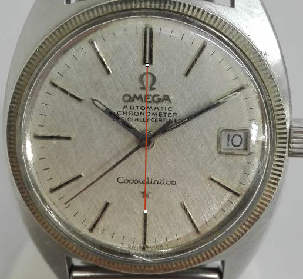

[Constellation] Opinion on 2 MOY failures - I believe one genuine, one re-dial

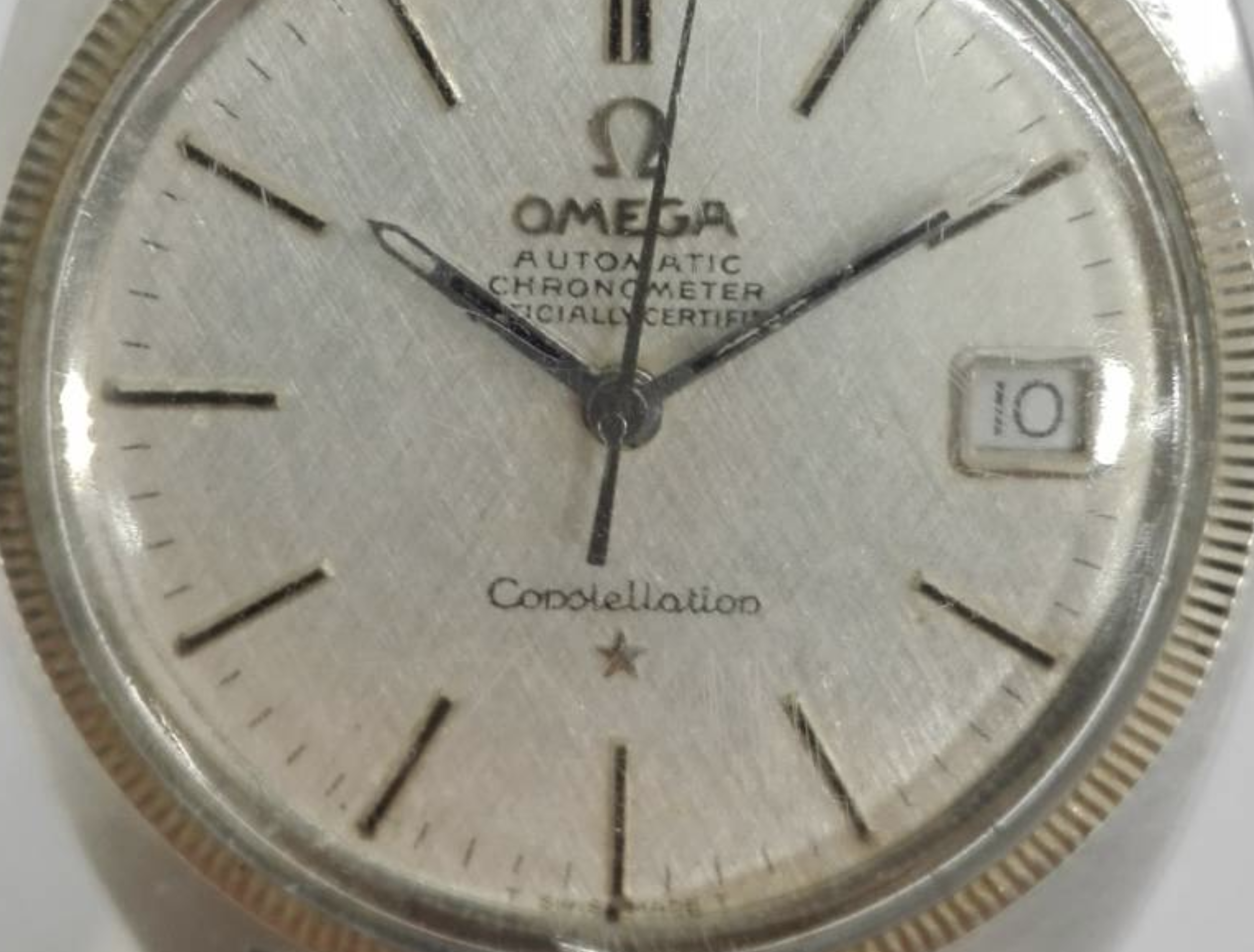

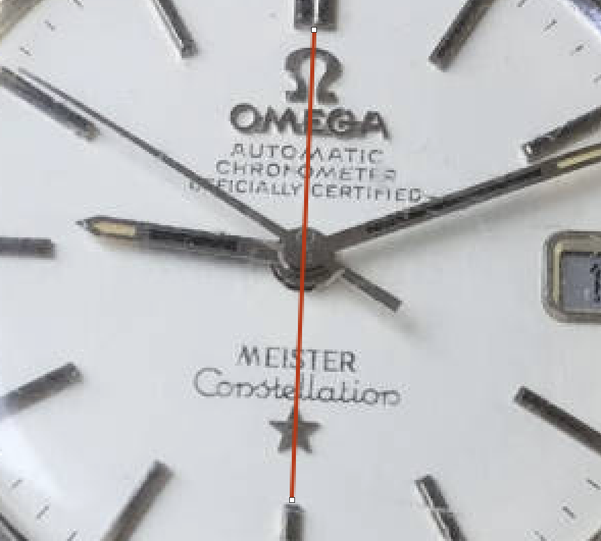

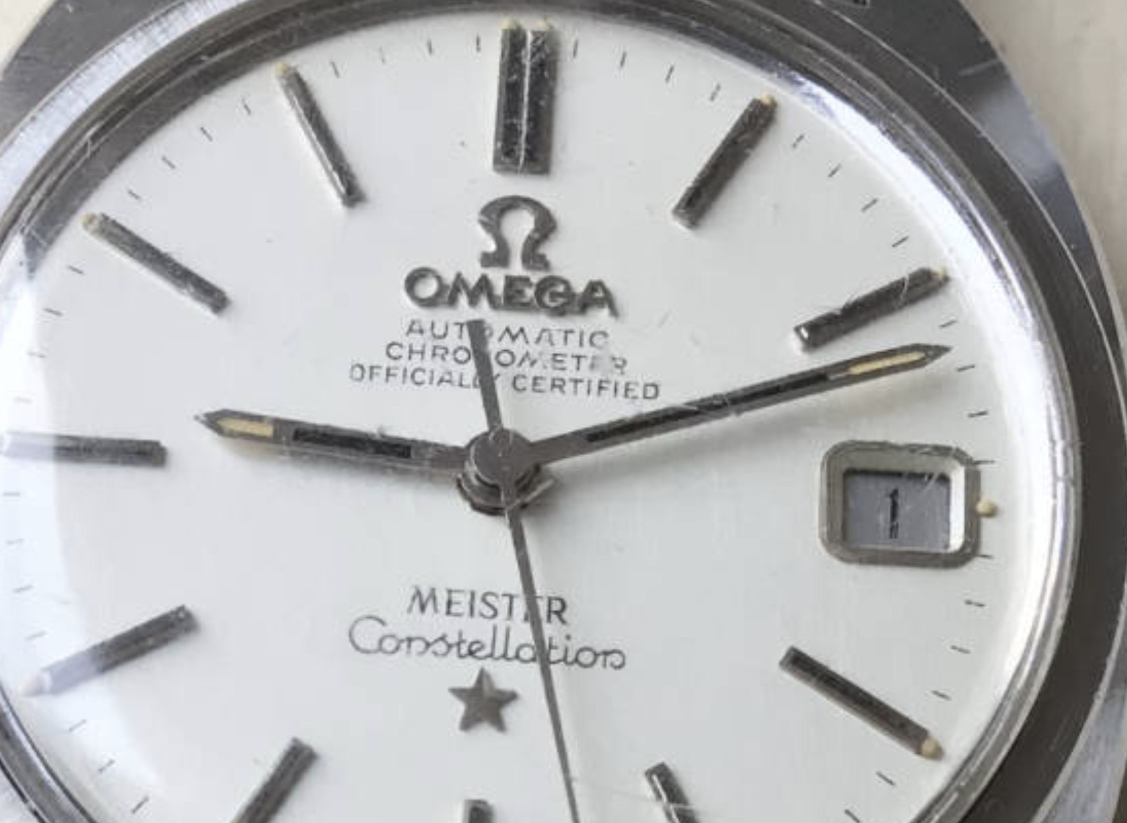

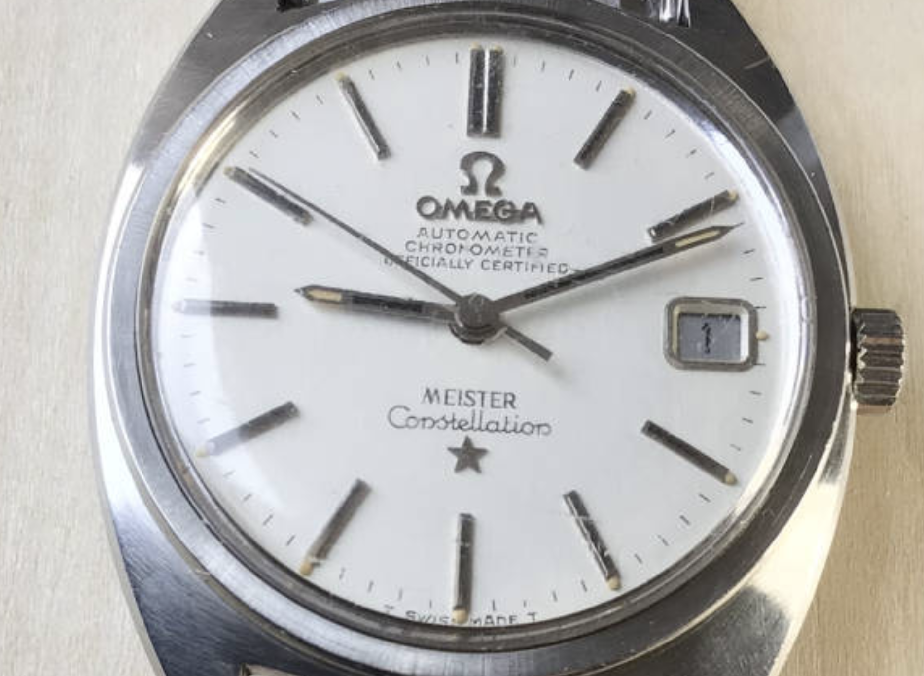

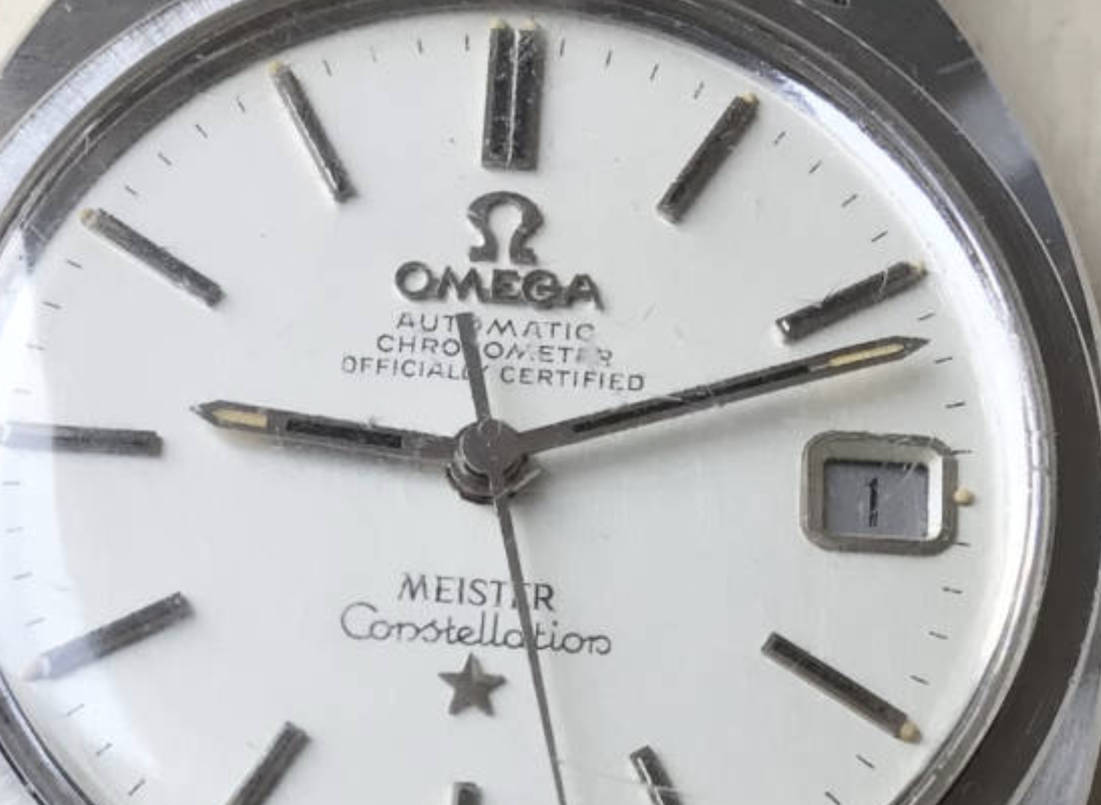

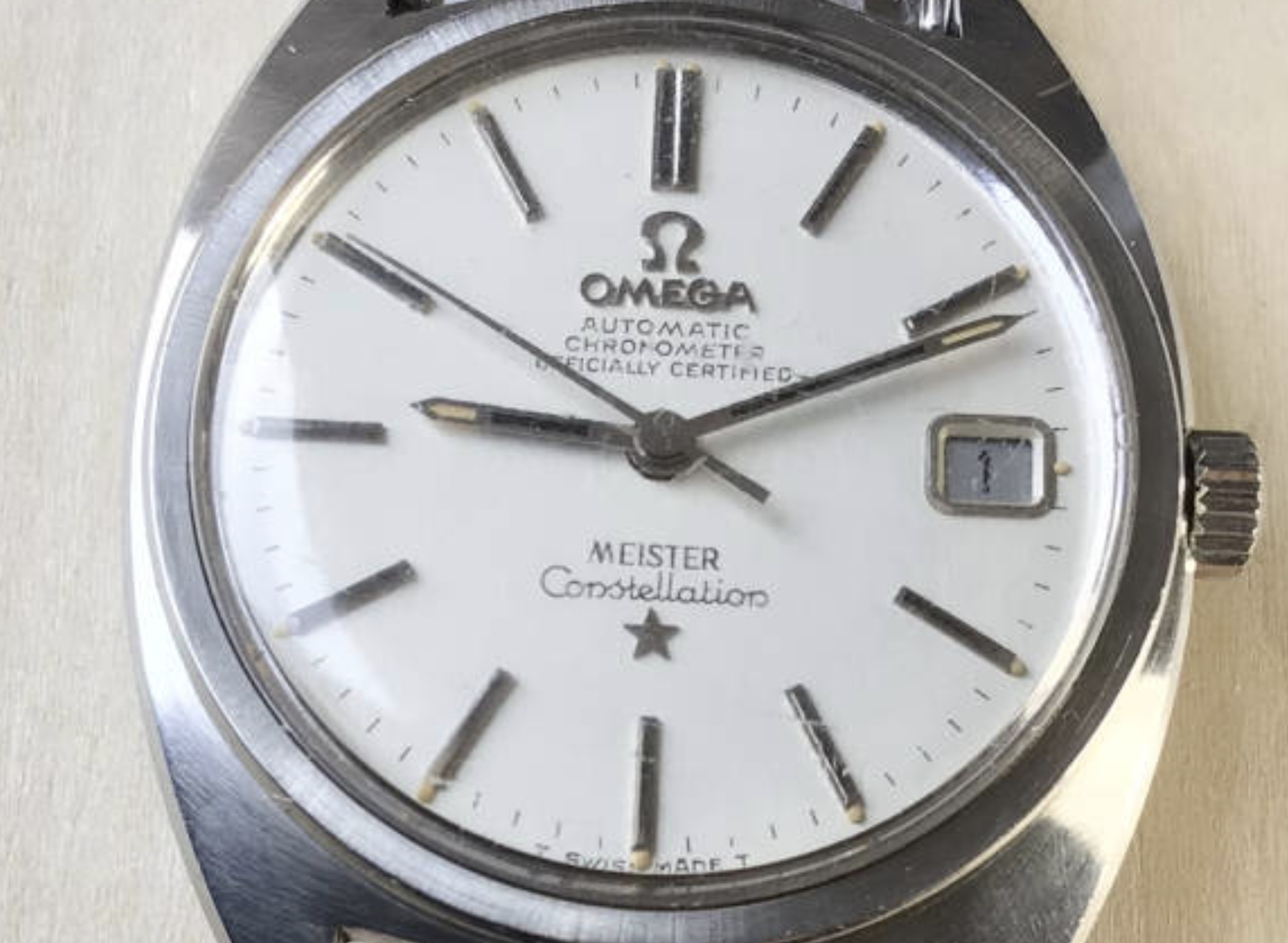

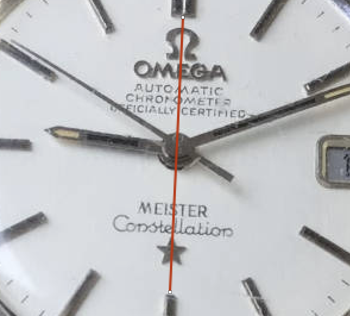

First one is a MEISTER dial that seems to fail, but from lume pips etc. - it should be authentic I assume

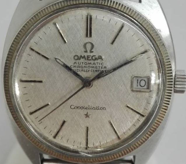

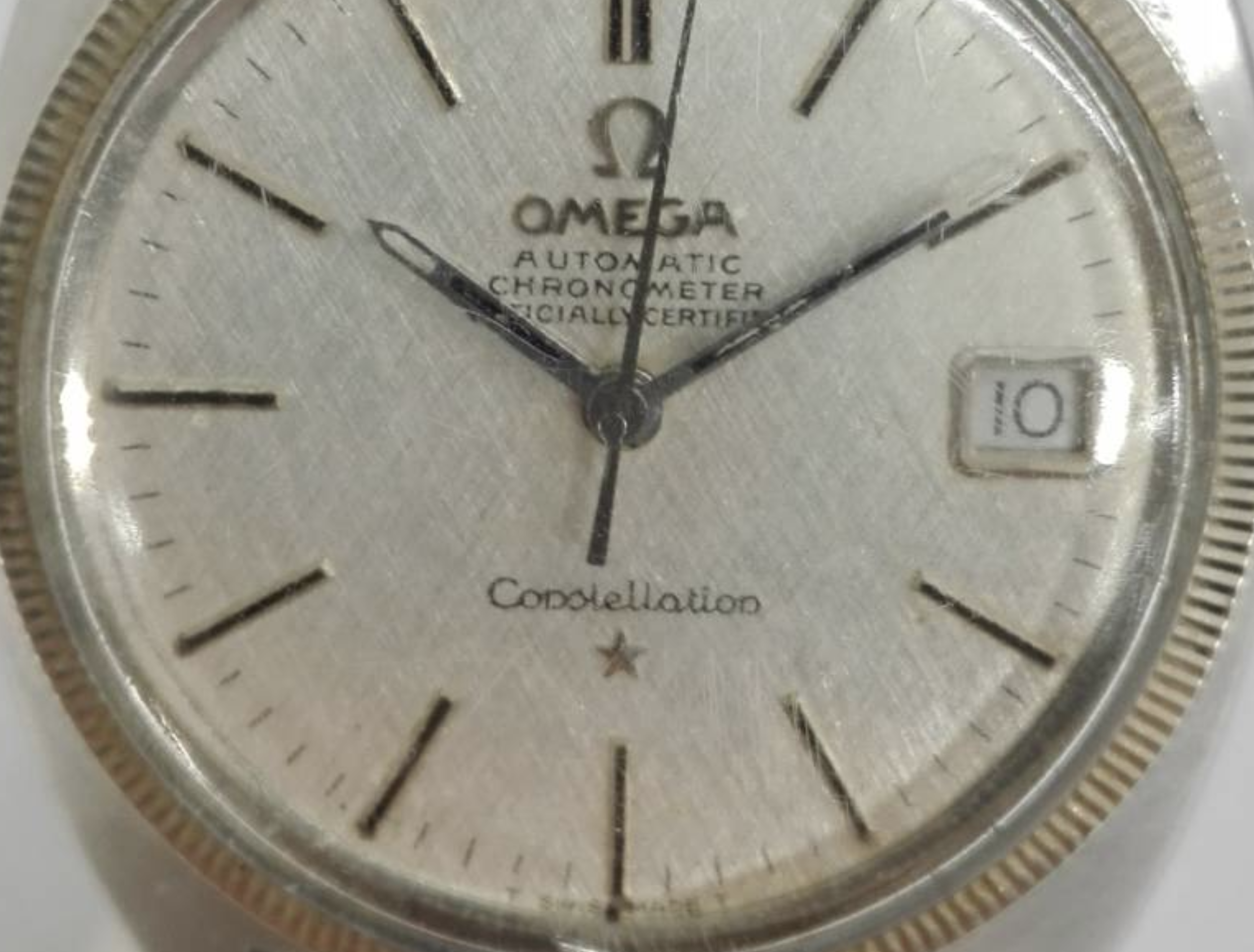

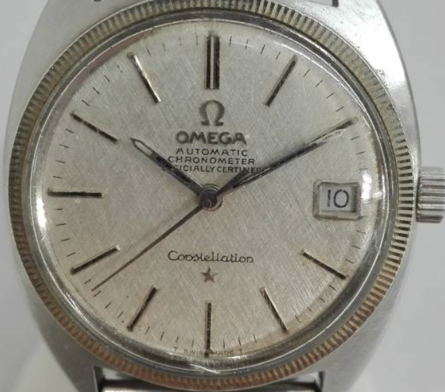

Second one is a meteor dial, I think it's a re-dial
505
738
Those C-case have something special... the MOY test does not works everytime! There are many dial variation.
hard to tell from pictures you provide, but both of them may be original to me

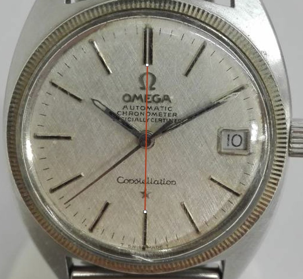

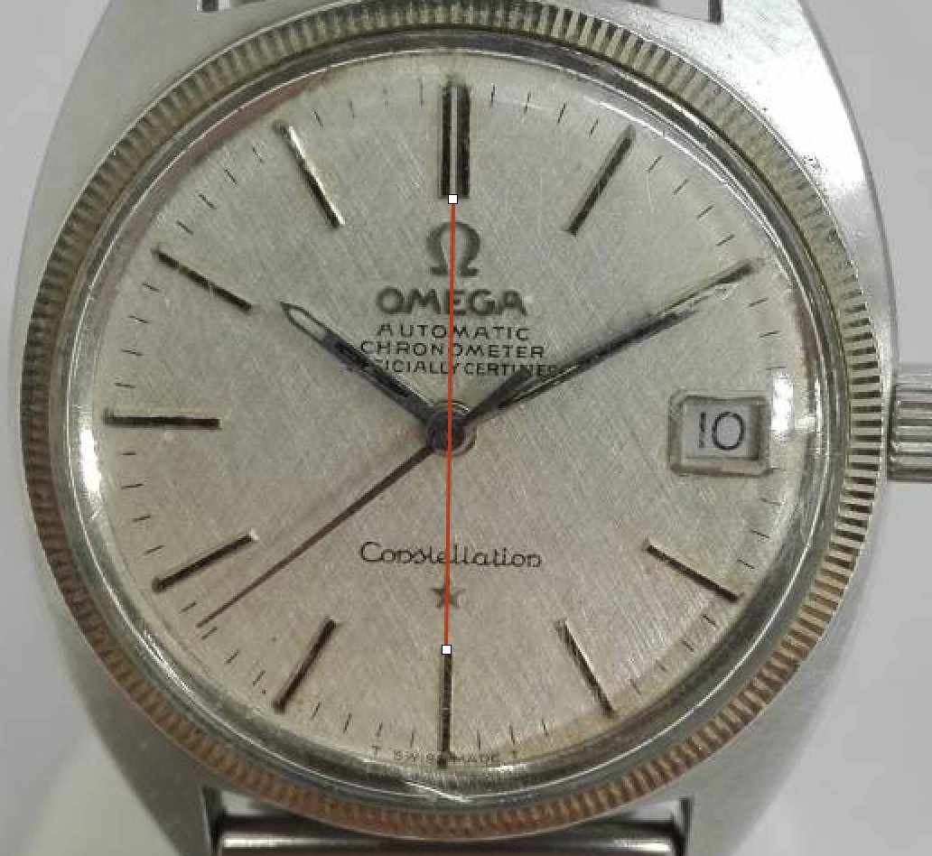

The second watch has 2 deeply curved n's on Constellation, usually the first n is slightly curved, second n is deeply curved
AUTOMATIC is more like A U TOMATIC
So the second one seems fishy to me
What's special about the second one by the way, does it have a rarity that I didn't notice?

@Gui13250 means that C cases are special, in that they have many more variations than any other Connie.
whilst I agree that the 'automatic' looks oddly spaced, if you move the red line to the right slightly it would bisect the Omega symbol, the first part of the M, the O and the star and miss the 'e'
it still fails the MOY test but this is common on C cases.
better pics would help in assessing the dial

Second looks like someone touched or redid the luminous. Looks sloppy compared to the first
