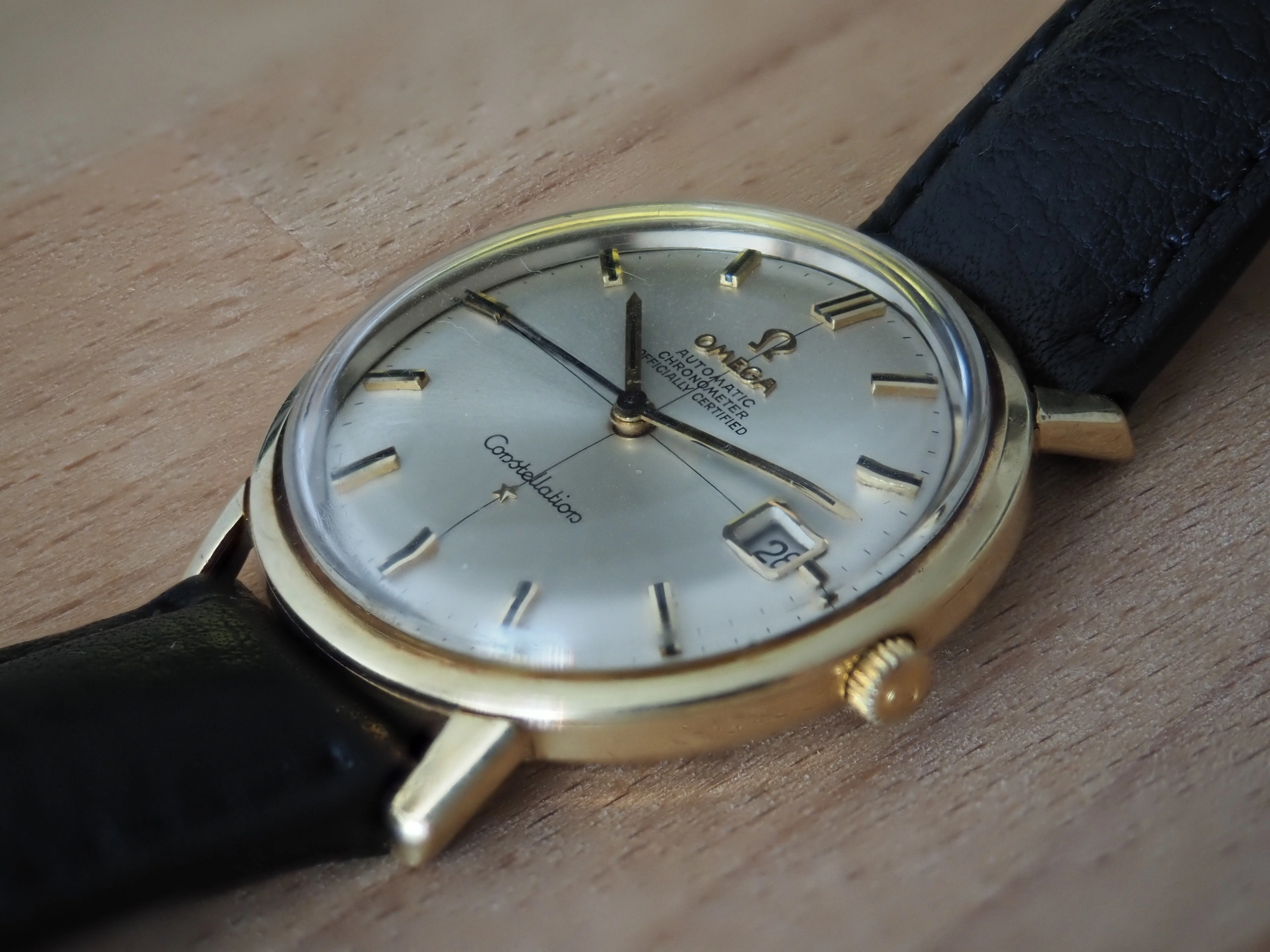

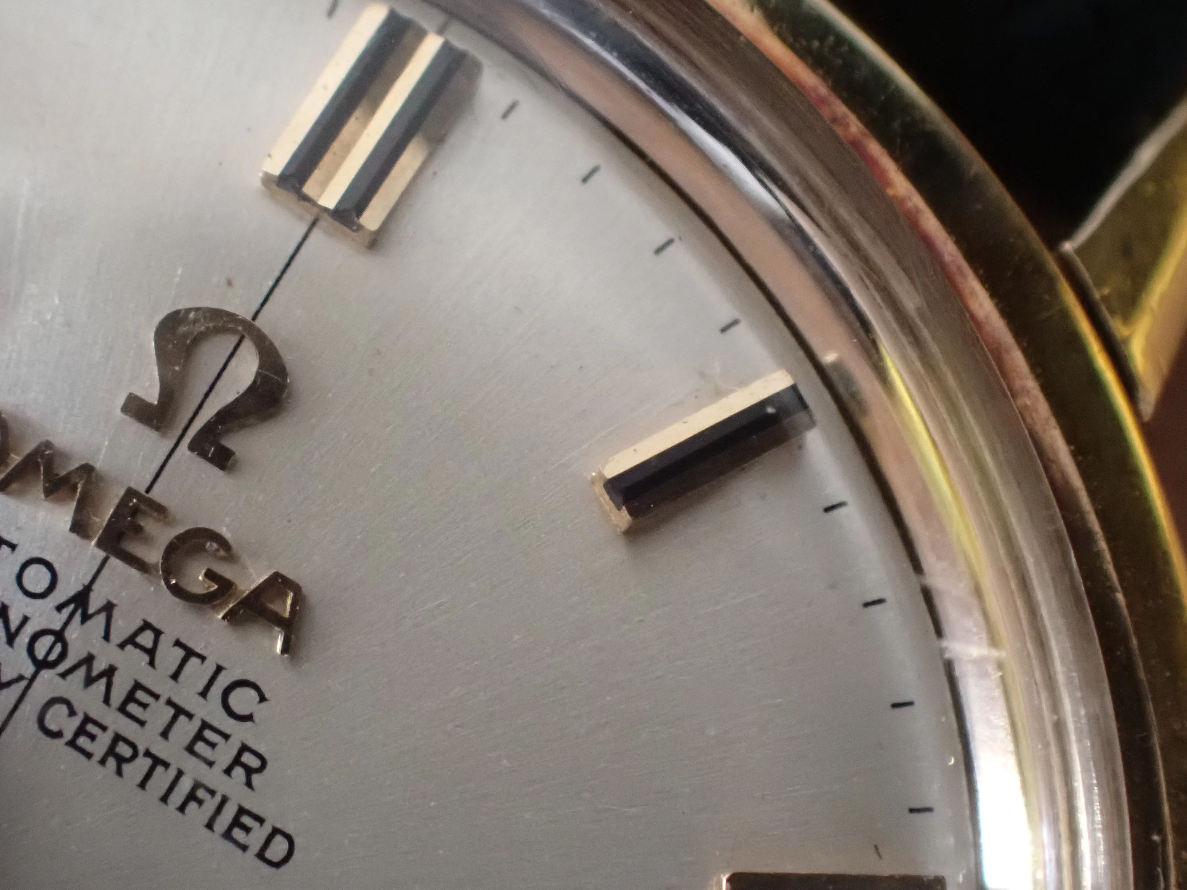

Hi all!
I was enjoying some macro photography of my 1964 Constellation, and started wondering what metals were used in the dial furniture/hands?
  • Hour markers
  • Date window
  • Star
  • Hands
  • Omega logo/writing
    I know the hour marker inserts are Onyx.
    Also, how impressive are the faceted Onyx inserts! Presumably this is so the light doesn't reflect in the same angle as the metal surround, leading to a darker black?

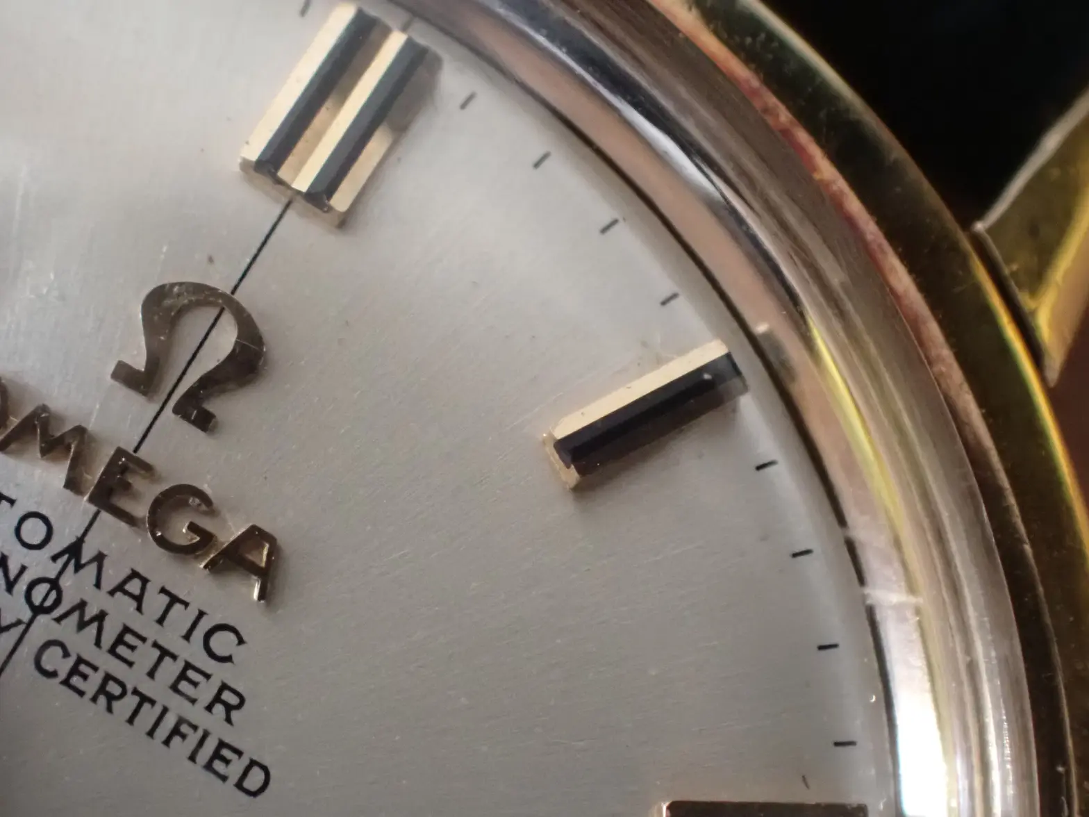

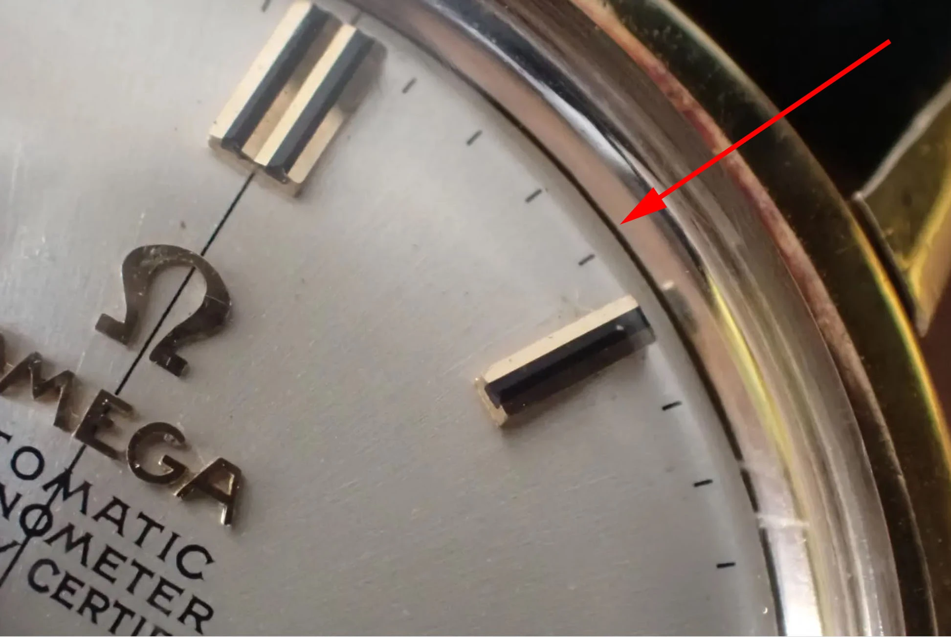

Sorry - any chance of being more specific?
The gap between the dial and the case/crystal tension ring...

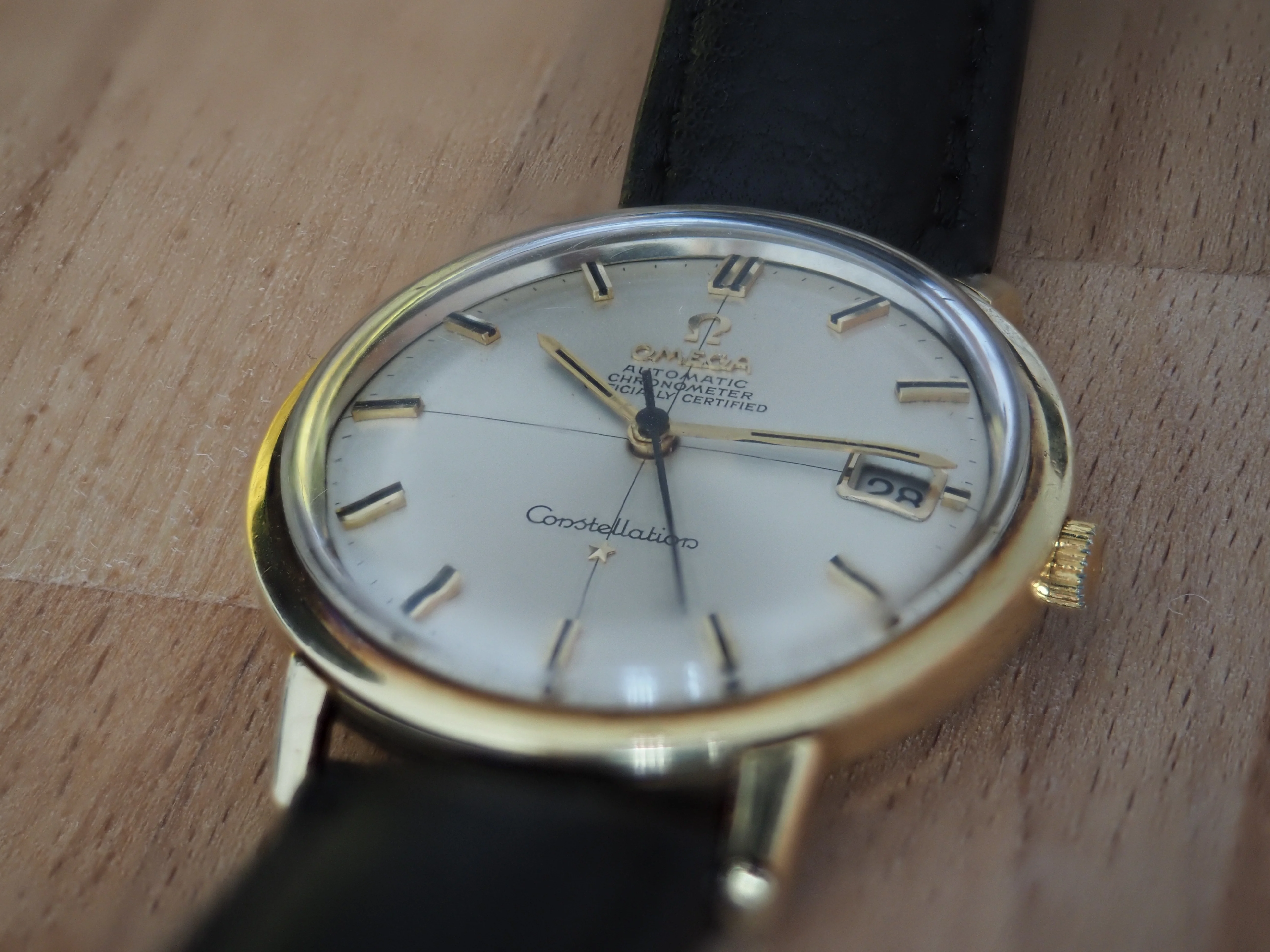

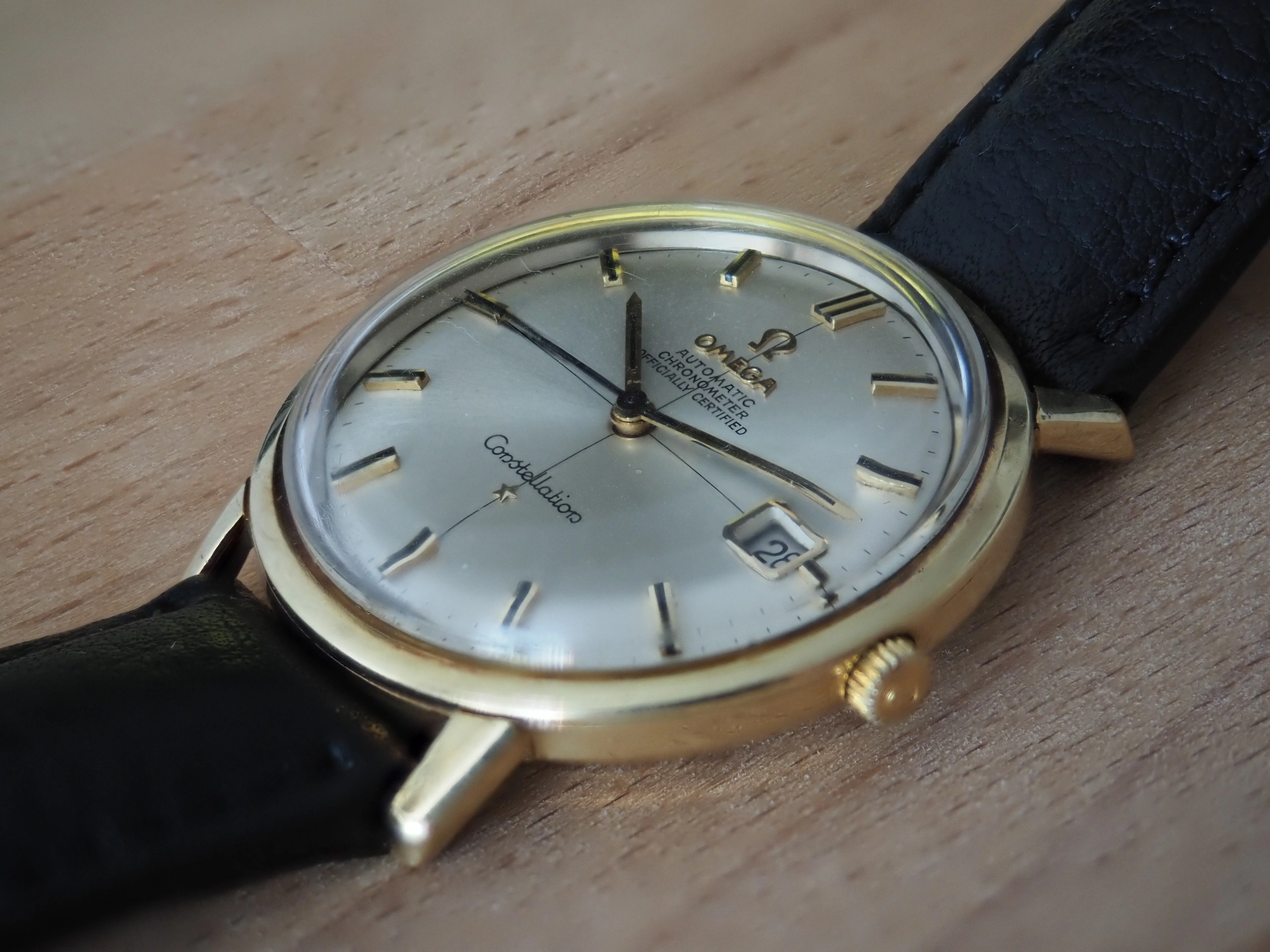

This is the watch in question, there are more photographs on the thread
60
41
Interesting, which parts in particular? Do you mean the dial and the case are mismatched, or something like movement holder ring?

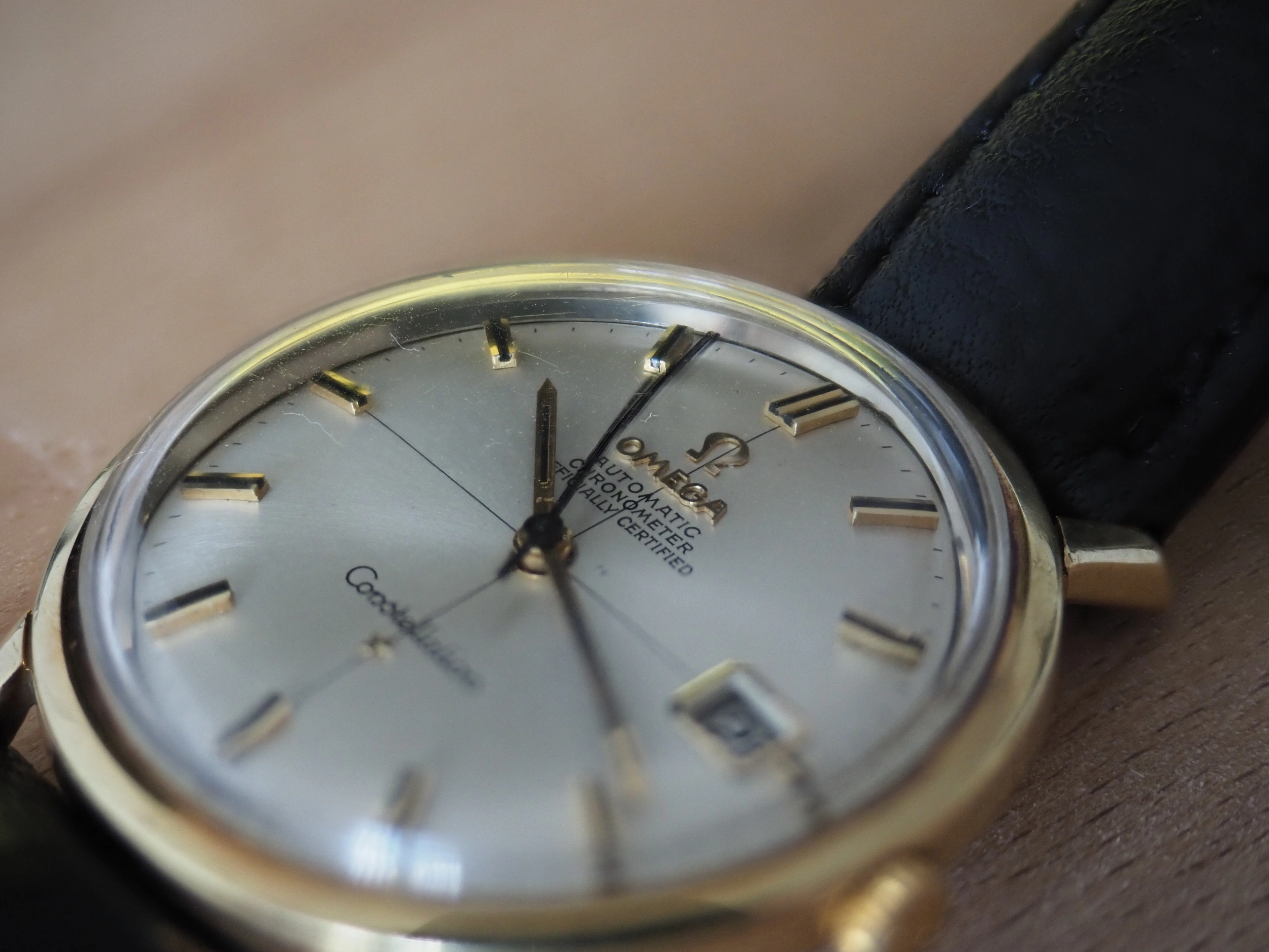

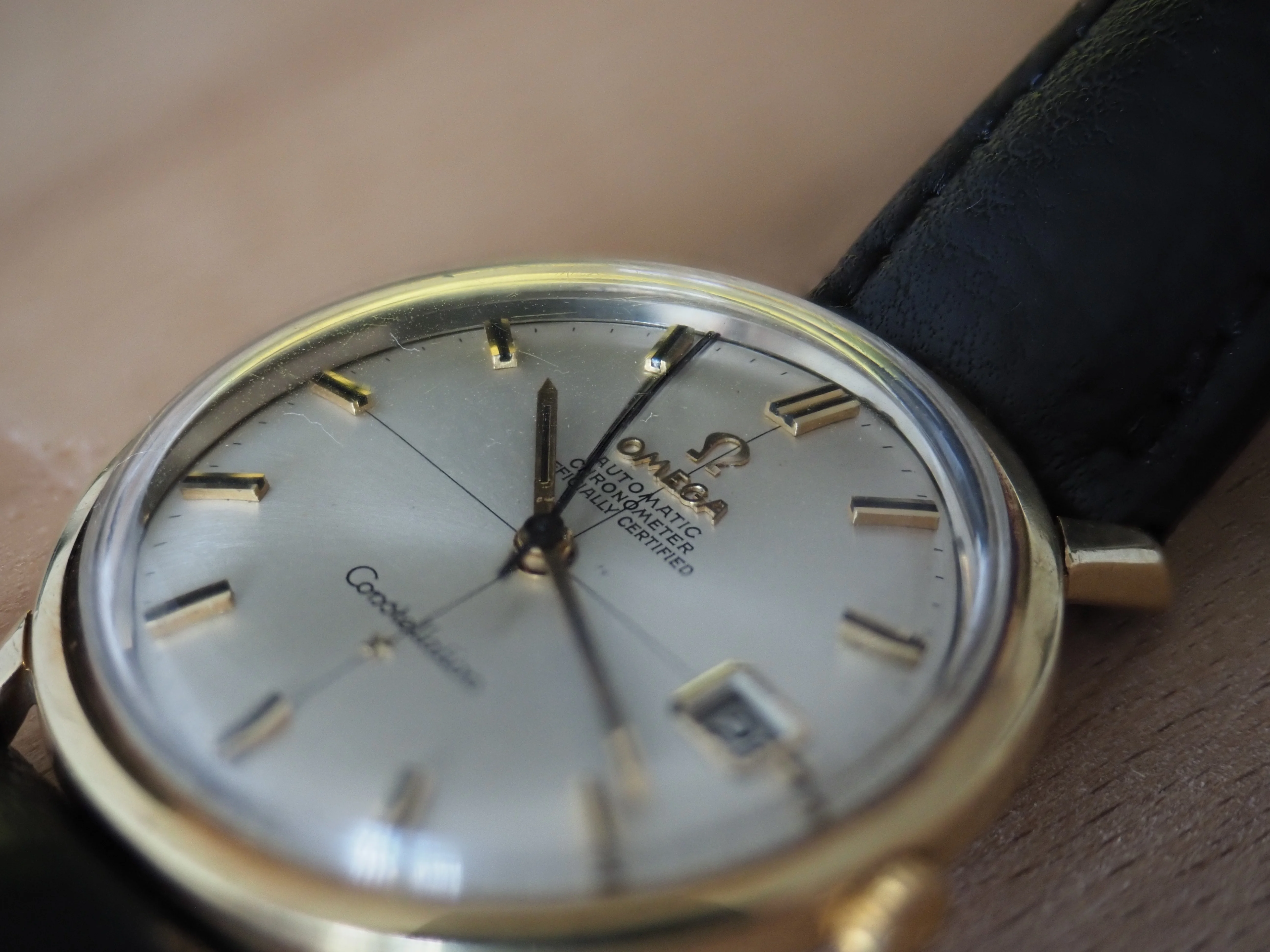

You've piqued my curiosity @Dan S / @Archer
I've taken some more shots, the gap isn't uniform and appears most pronounced at about 11 and 4 o'clock.
Would be interested to hear your thoughts on the cause. I think the dial seems to match with other examples from around 1964, which is the hallmark date of the case, so I'd be surprised if they were mismatched?
Is it possible there's some other component inside that's incorrect? Or is there something responsible for holding the dial in that perhaps isn't tensioned/tightened correctly?
Or indeed, just manufacturing tolerances?
Thanks for your help!

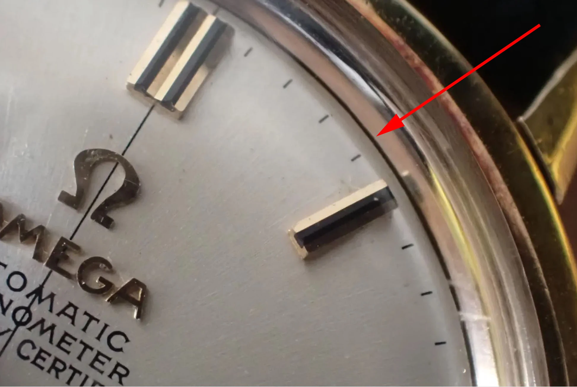

Hard to tell for sure - is there a tension ring for the crystal, and if so is it silver or gold tone?
60
41
I can certainly see a reflection around the edge when viewing from the outside in, so I would think yes there's a tension ring, I think it's silver if so.

maybe a wrong tension ring - should be gold coloured on a gold watch...
60
41

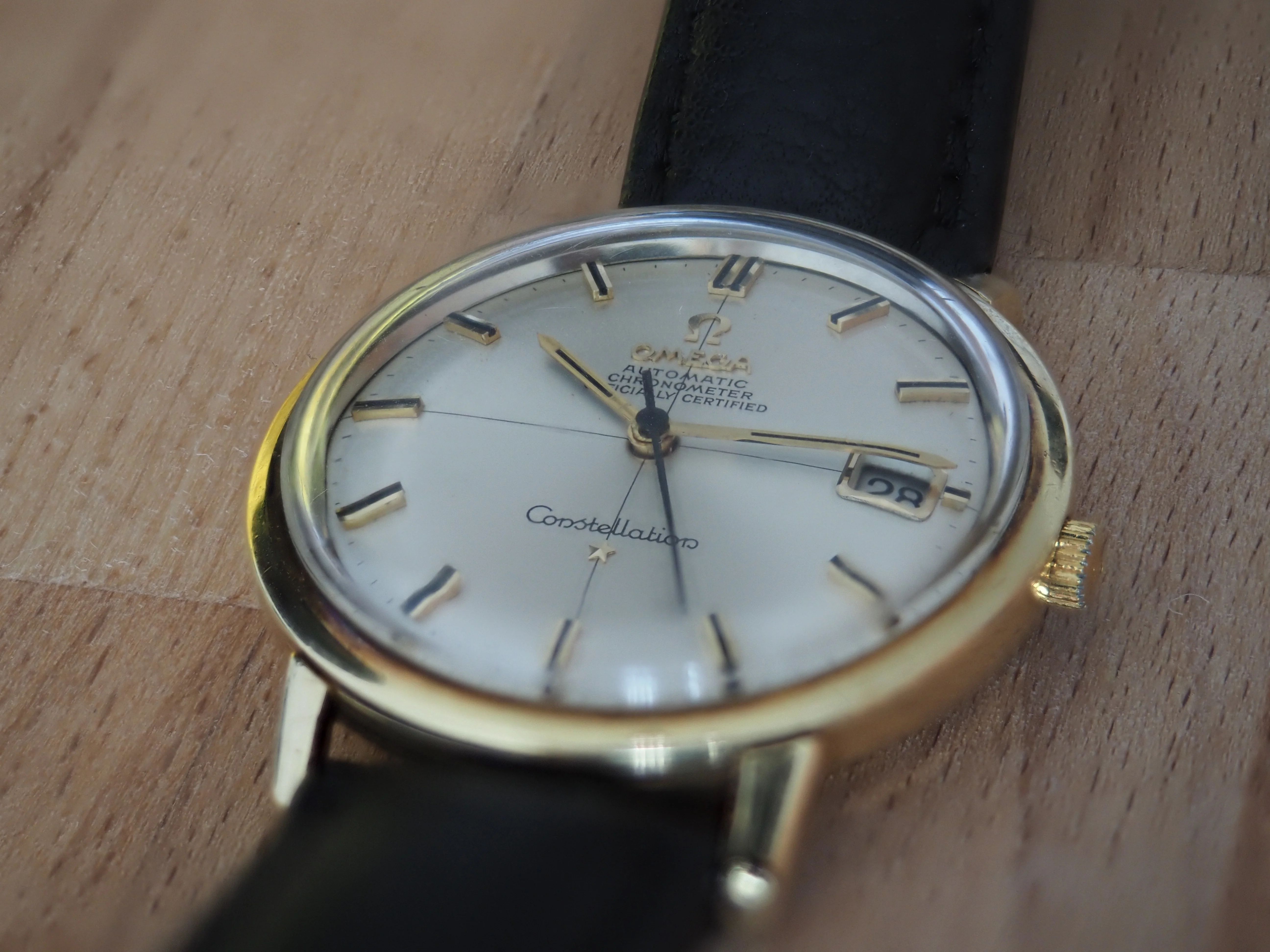

Would anyone be able to let me know the correct part number for a replacement crystal with gold tension ring (or how I can look this up myself)? My case reference is 168.5004.
Many thanks!
29,865
77,275
Thanks, that makes sense.
Many thanks!
The original crystal was 063PX5029 - GLASS PLEXI 2N RING D31.62 H4.4
That is discontinued, but there is a replacement:
063PX5006 - PLEXIGLASS ARMED YEL. RING D31.62 H4.85
Basically the same, but the replacement is a little taller.
60
41
Thanks Archer!
