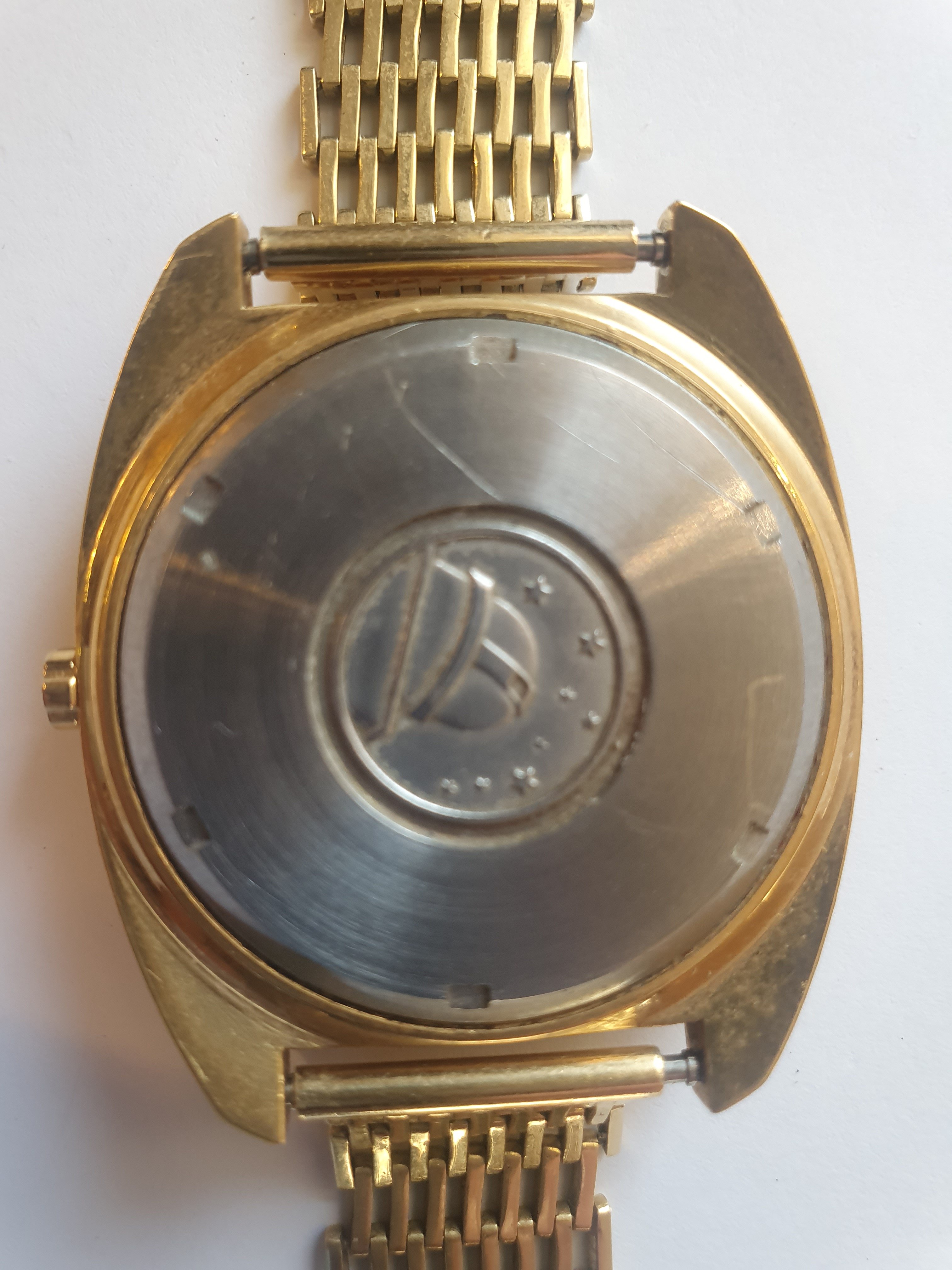

I have inherited an constellation chronometer electronic f300hz from 1976 that does not work with a new battery. It was last serviced and repaired in 2009.
It also have a damaged/scratched glas, visuable on the picture.
Is it worth to repair and how much does it cost to replace the glas?

These are mine and I got the blue dial back from repair/service today, so obviously I think yours is worth repairing. It looks to be in nice condition. Is it gold? Is the bracelet gold?
I’ve two suggestions. First, you probably don’t need a new crystal. Get a tube of Polywatch and polish the scratches out of the crystal.
Second, let us know where you’re based and someone should be able to recommend a watch repairer who can service and repair your watch.

It wort repair it but you will also need other bracelet because the one from the pictures do not fit well to your watch.

Hi, and congrats on a nice watch, and maybe with some nice memories since it was inherited??
Here are some helpful links and posts.
https://electric-watches.co.uk
http://members.iinet.net.au/~fotoplot/accrepth.htm
I have read that both Paul and Rob does magic and are skilled with this type of watches.
I don't know where you live/stay, but there are a few more skilled watchmakers that can help you.
And here is a Forum member that helped me out when I was looking/learning.....😀
Cheers (again) ! @davidswiss
Good luck, and please do posts on the project?

Hi, thanks for the answer, nice watches.
It is gold on steel and the bracelet is 18k gold but as you say it does not match...
I'm based in Norway.

I can recommend Ludmil in Bulgaria, a pleasure to deal with, has parts, works fast and very reasonable rates.
