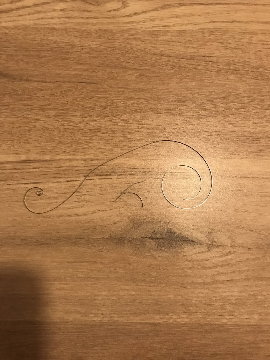

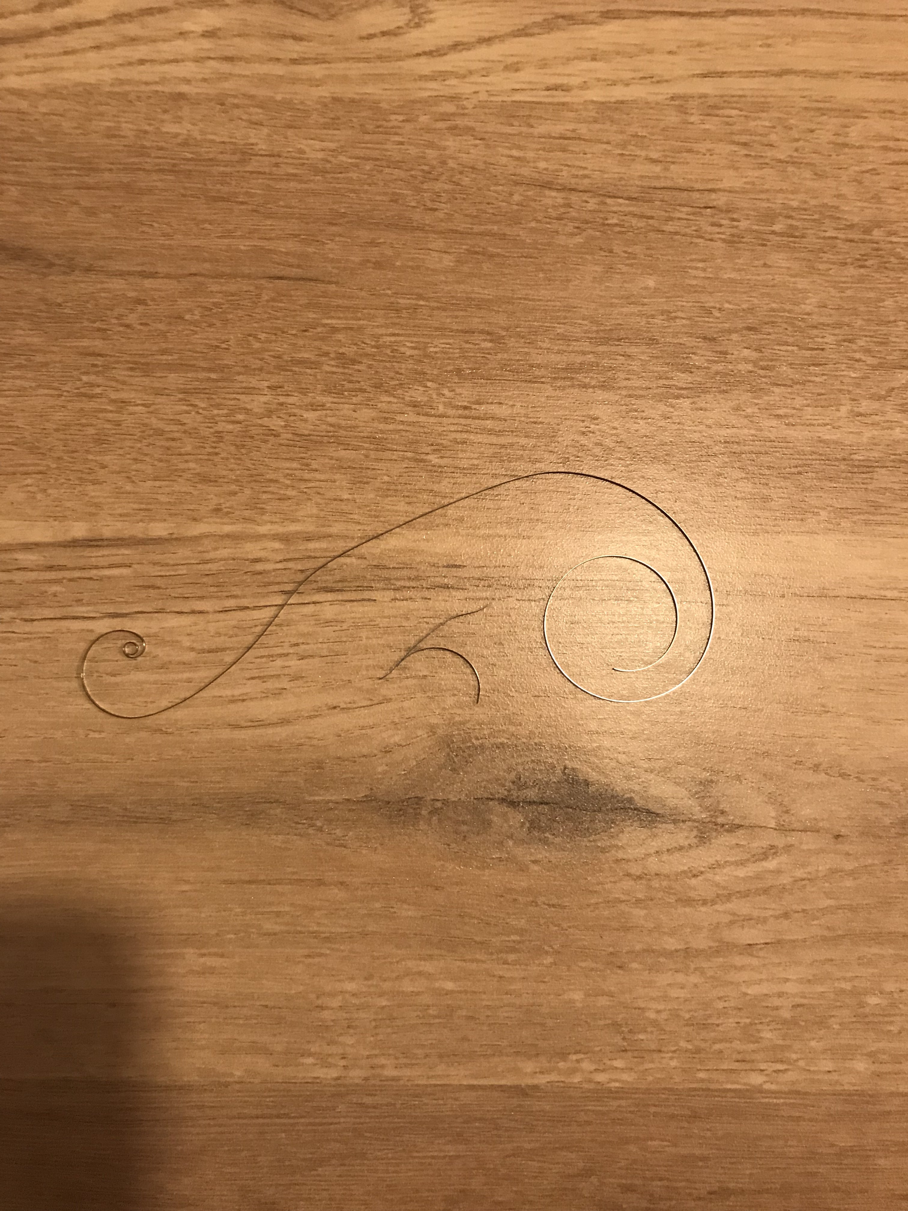

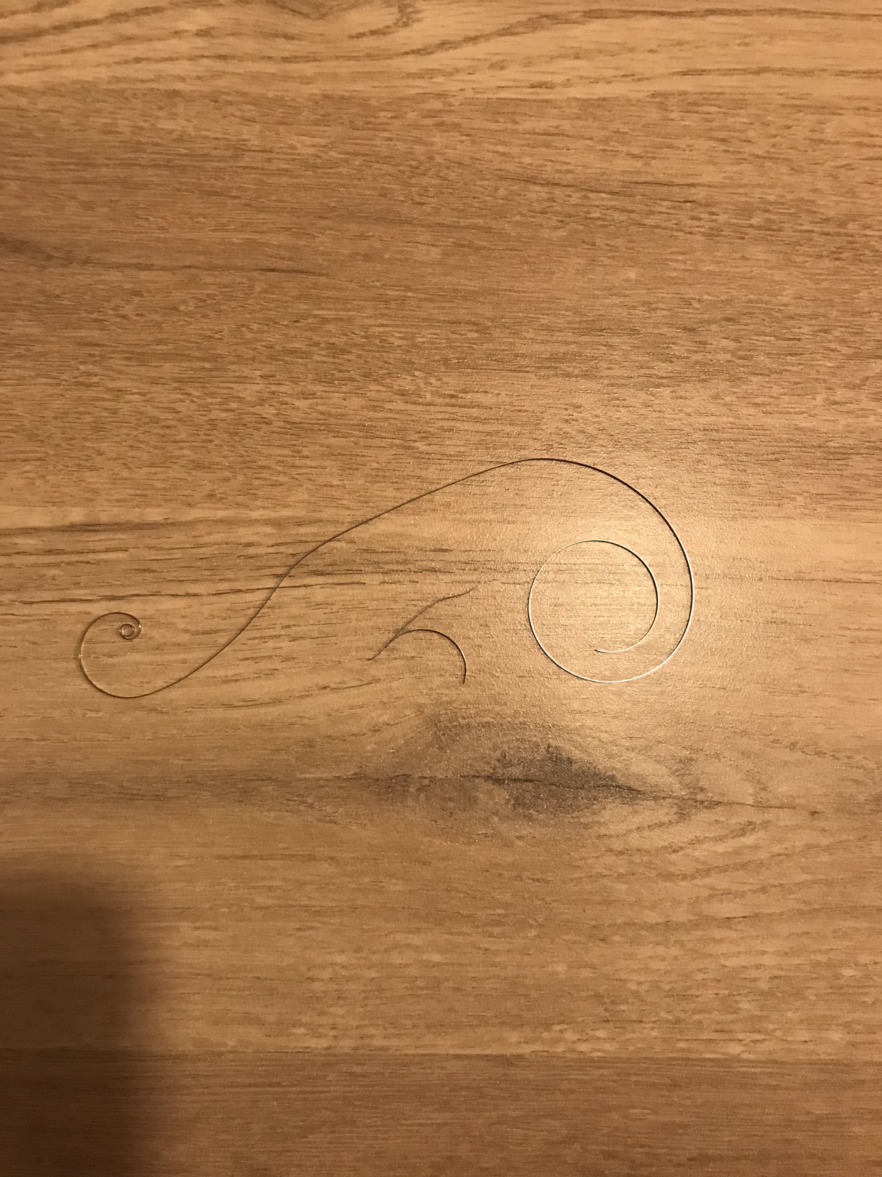

Guys,
This is the old springs that I got back from the watchmaker.
I tough the « Y » part of the spring was only for mecanic and not automatic watch
1,615
3,862
C'est bien un ressort pour montre auto... cassé en 2. La partie en Y est la bride glissante.
(it is really a broken mainspring for an automatic)
