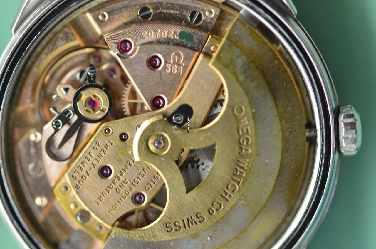

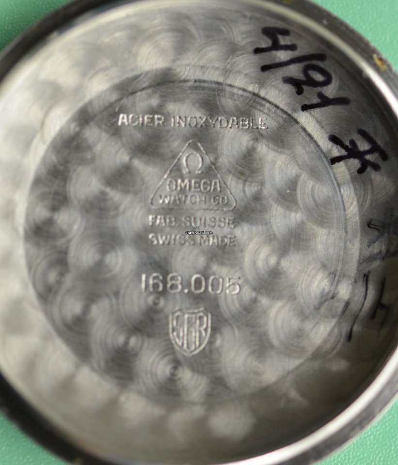

Hi everyone,

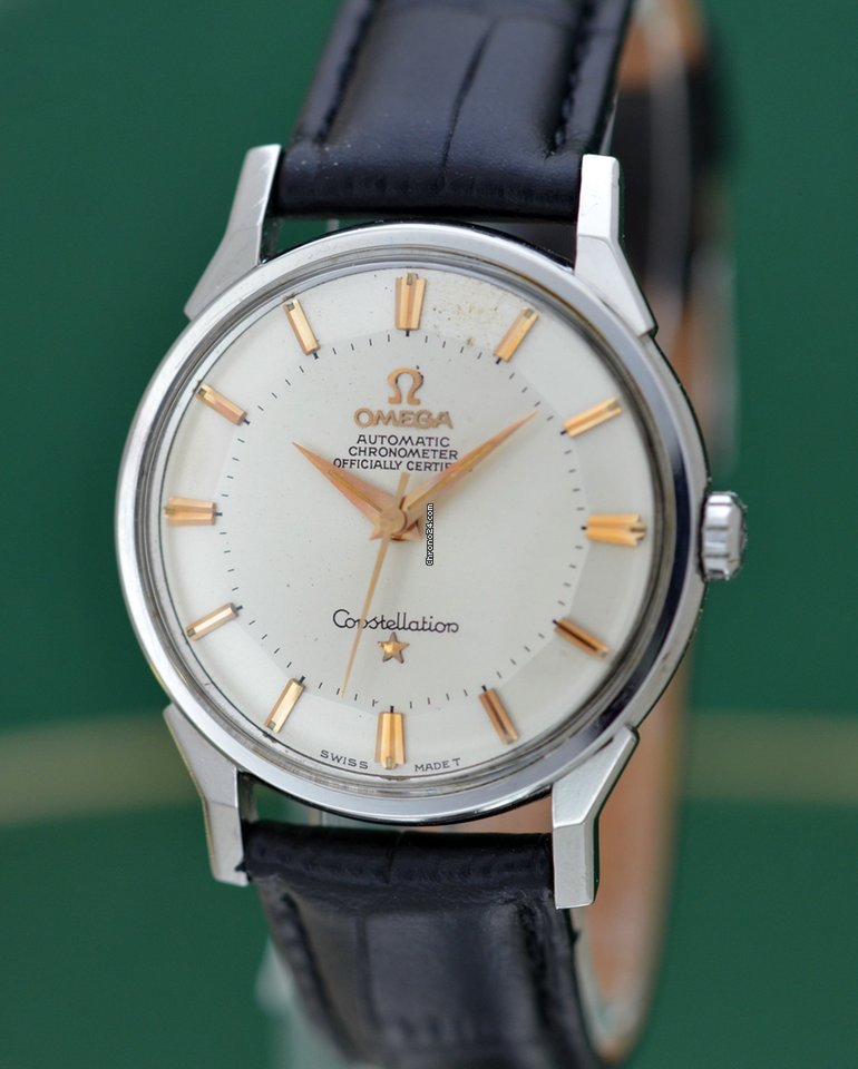

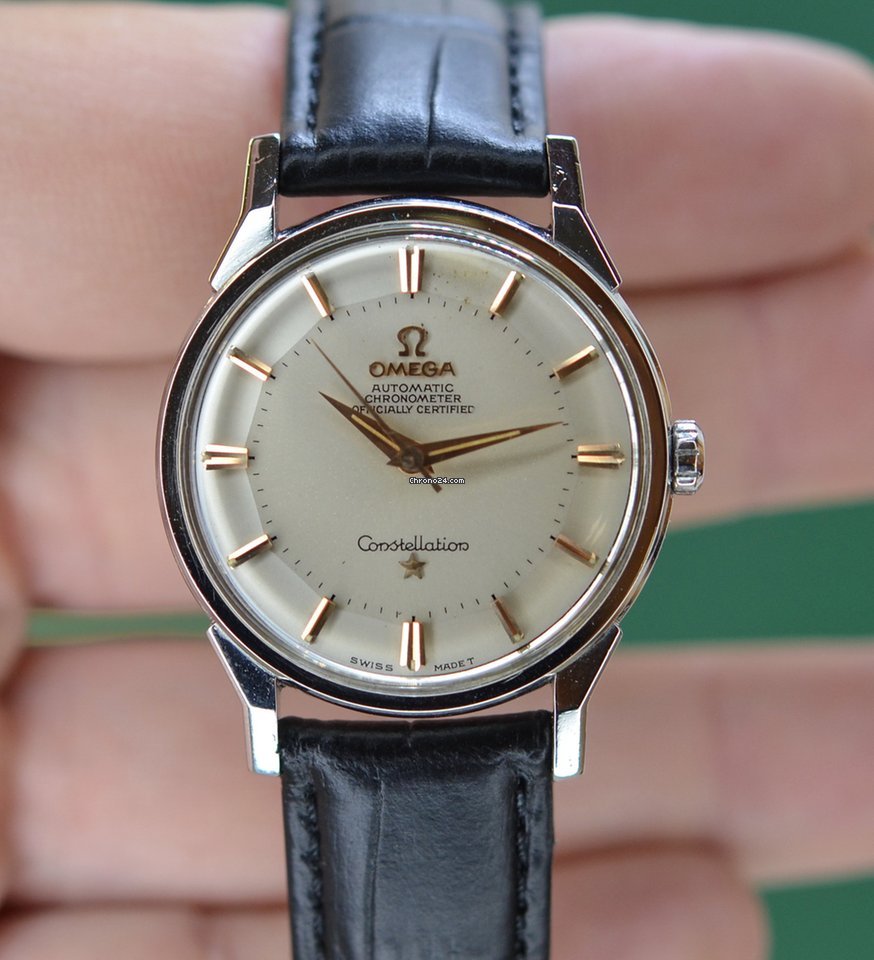

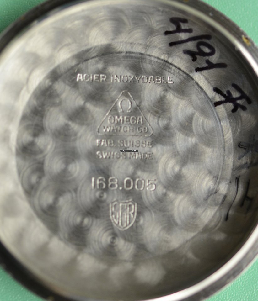

I came across this 168.005. When checking Desmond's Constellation database, it appears that this model was supposed to have a calendar function - or I must have misread the file. Any folks here that know of a version without calendar? A quick search on chrono lists 1 or 2 out of many.

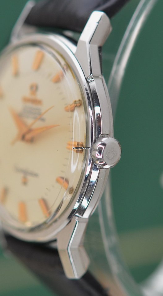

I'm not considering to buy the watch, but hope to learn more from it. Looking at this example, would the dial be correct? The star seems to sit very close to the Constellation text. Furthermore the crown seems wrong and the case quite polished?
1,275
5,687
168.005 always has a date and the calibre 561 (which is correct for the ref) has a date complication. So as @Caliber561 already mentioned, Franken alert.
17,667
36,965

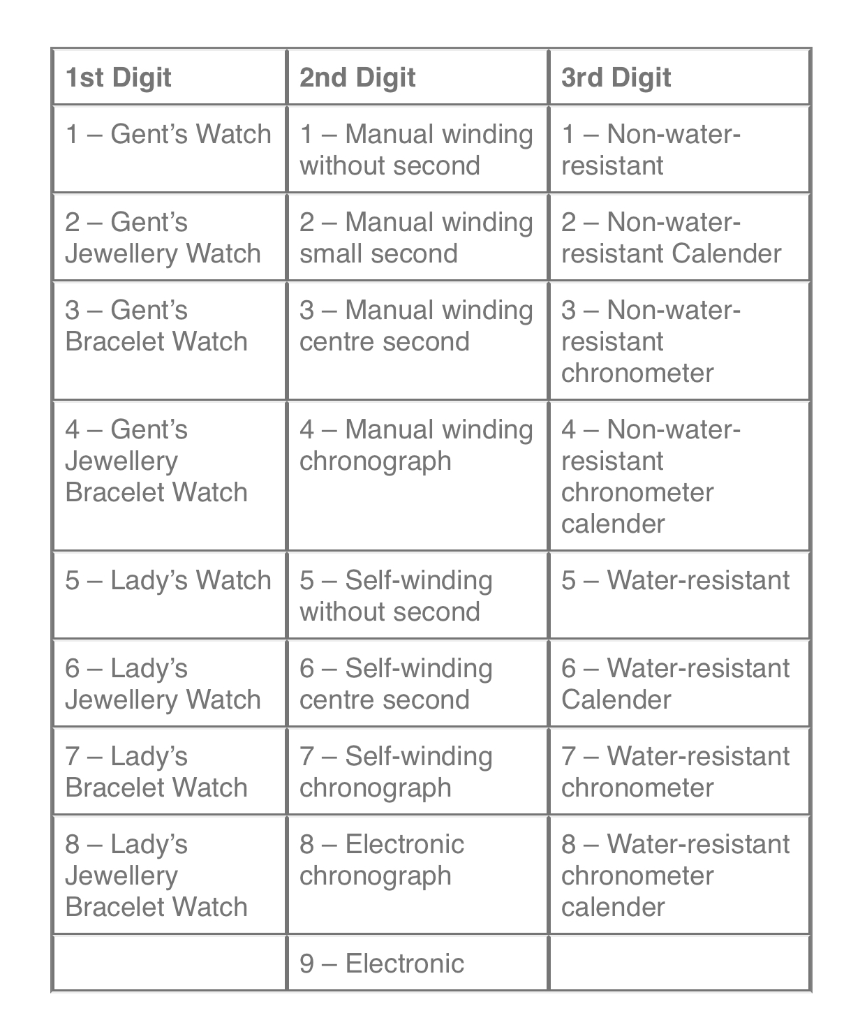

1 = Gents Watch
6 = Self-winding centre second
8 = Water-resistant chronometer calendar
I'd say above comments are spot on.

This might help for the future, it’s what @JimInOz refers to:
Note that it’s only valid for the references in the format xxx.xxx

It’s a frankenstein watch. Run away. Also, no-calendar ref. should be 167.005
