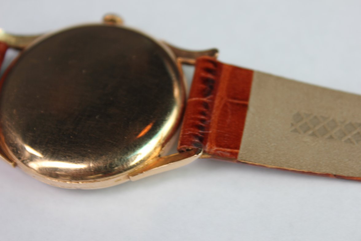

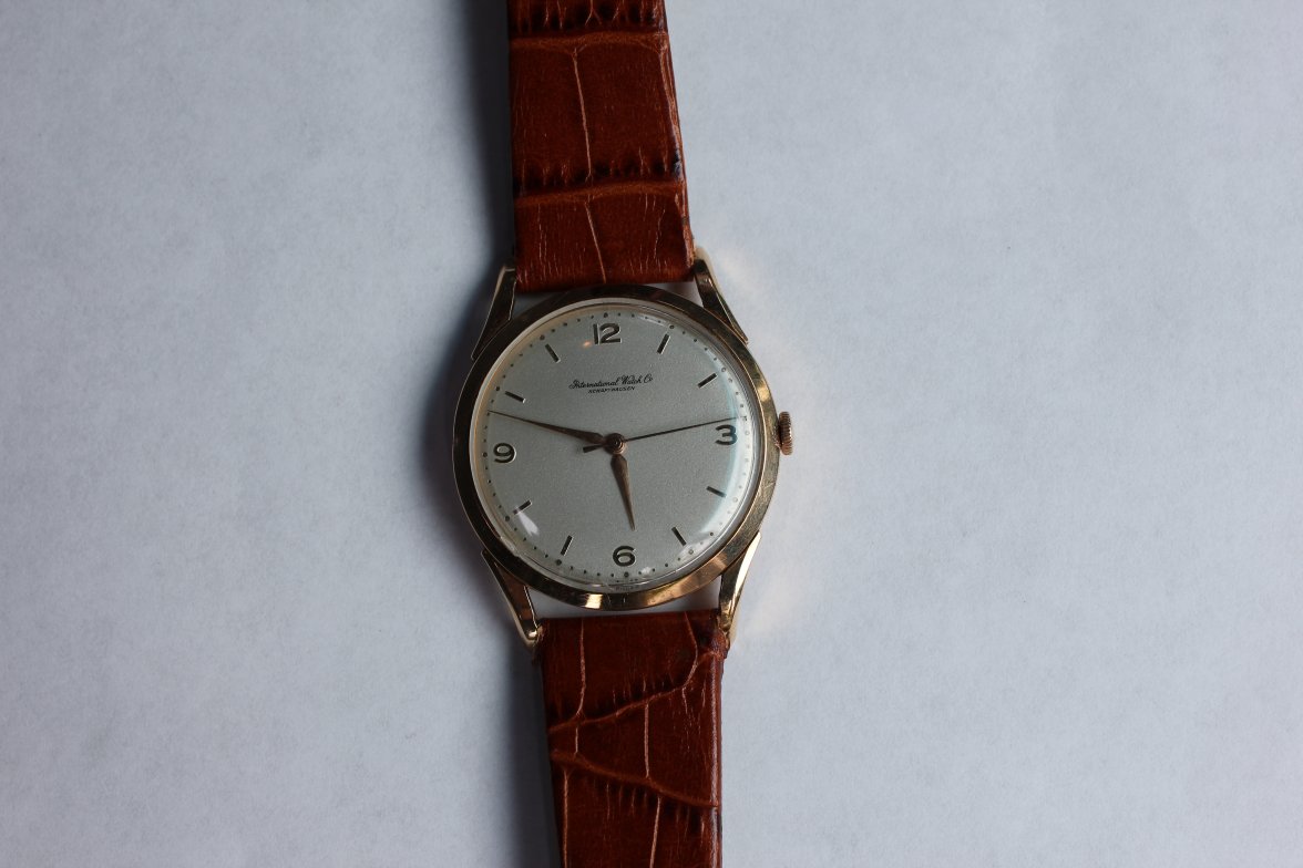

    On craigslist in my area I found an interesting IWC cal 89 in 18k. I met the seller in person today to take a couple pictures myself as the photos he provided appeared to be taken with a potato and not a camera. The reference number is not known by him, or I and we did not go to a watchmaker to open the case back as I was just taking an initial look at the watch and promised myself i would not buy anything without the forums valued opinion on said watch. I tried to find the same reference online by surfing through pictures and comparing it to the ones i took but this proved to be unsuccessful so the research I did did not provide a abundant amount of information.
    Here are my concerns:
    Do you feel this is a redial? please note the _ under the o in Co. The swiss is not visible in the photos but it is present, and centered under the 6 o'clock. If you zoom in a lot you can see the dial is dimpled, i think this is a result of patina / aging although no visible discoloration is present. Also in 1 of the pictures of the dial the F looks faded, but this is just the picture, as it is not so in real life as well as in the second picture of the dial.

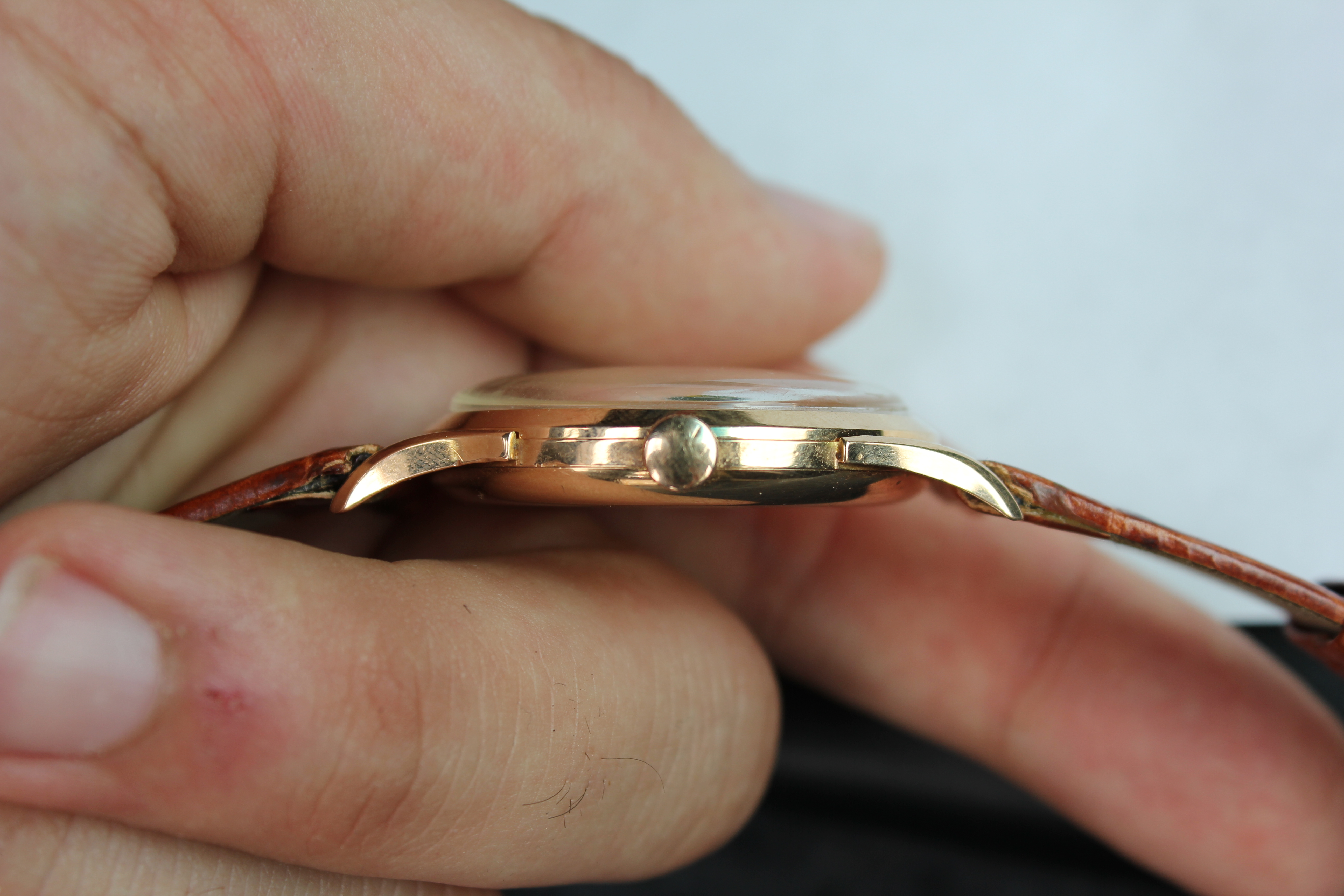

    The crown is unsigned, but looking at a bunch of cal. 89's I see this is really common, but i'm unsure of this is because a lot of the watches have replacement crowns or if this is how they were produced. Opinions on this?
    I think the case is relatively unpolished, although it has a couple dings. Opinions on the edges of the case / lugs?
    I am sorry for my lack of information on this watch, but without knowing the reference number I could not do better before turning to the forum, and I greatly appreciate your input.
    If i do purchase this watch with the approval of the forum i will definitely have the case open and the movement inspected / measure the amplitude and such!
    If you have a ball park range of the worth of the watch feel free to post, I feel this is competitively priced.
    p.s sorry to be asking these questions, I feel like a leach, but I promises as I learn more about vintages I will defiantly be contributing knowledge to the forums, this is not a 1 way street after all!
    edit: incase this helps i.d the watch its a 36-37mm without crown, and 20mm lugs.

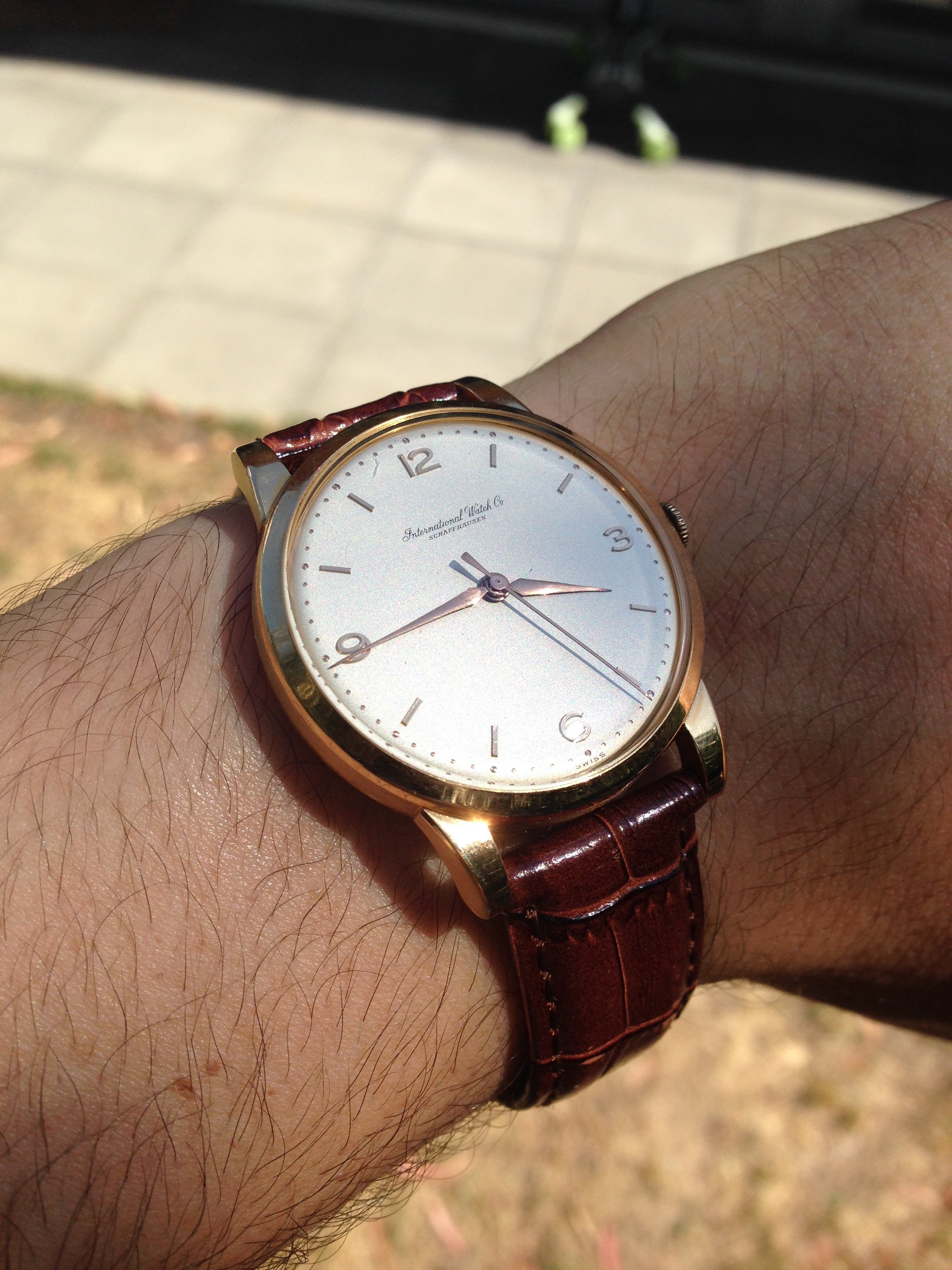

  2. CanberraOmega Rabbitohs and Whisky Supporter Jun 20, 2016
    5,570
    6,208
    NT931 and Euxinus like this.
  3. Tony C. Ωf Jury member Jun 20, 2016
    7,385
    24,214
    It may be a redial, though I cannot be sure with the photos that you have provided. This model would have had an unsigned crown, but I am skeptical that the one on it is original. The case appears to me to have been polished, though not badly over-polished.
    I doubt that anyone on the forum will "approve" a purchase, as photos – especially those that are not especially good - are not sufficient in order to make really confident judgments. More importantly, you need to take full responsibility for your actions, irrespective of how much or little encouragement you may receive from other collectors.
    The watch of @CanberraOmega shown above has a different case, though the crown does appear to be quite similar.

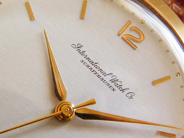

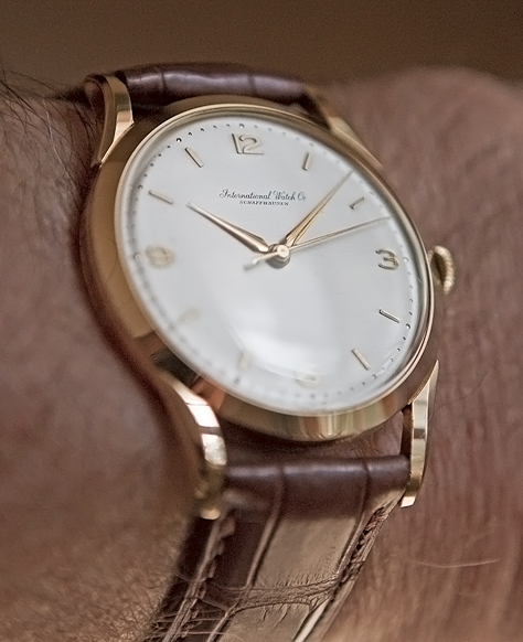

    I believe it is a redial. The script is faithful in most respects but the the lettering is not all correct, too thick and not neat enough.
    The lugs are a little worn and polished.
    Same case/model

  6. cicindela Steve @ ΩF Staff Member Jun 20, 2016
    15,047
    23,790
    Of course a lot depends on the price....

    I am after an all original example, so unless it was priced at he value of the gold i wouldn't buy it! I appreciate the amazing picture of the IWC text, it will allow me to make way better comparisons myself in the future.

    There is also another version of that script with points on the W. It maybe an in house refinish by IWC, very well done and general accepted a legitimate. IWC will refinish these on requ$st.
