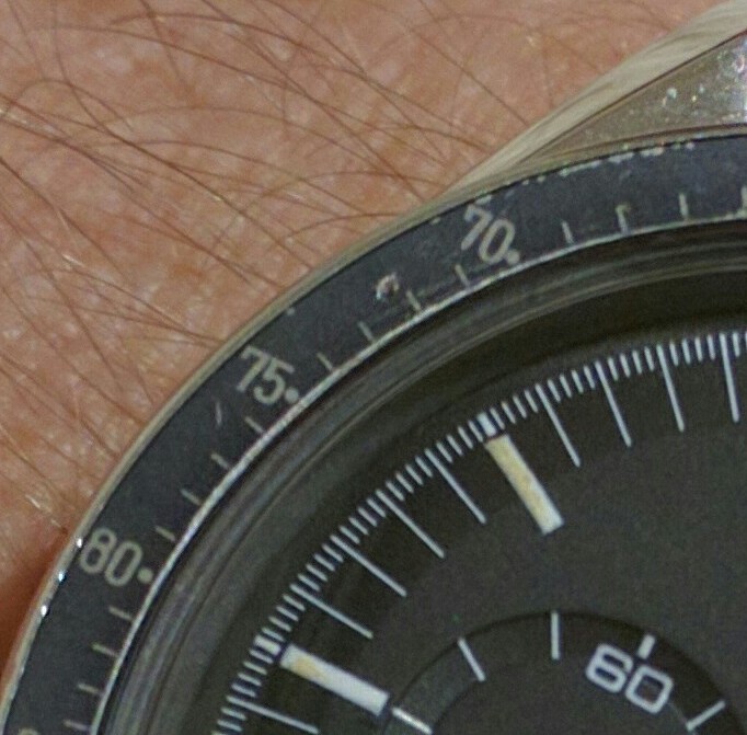

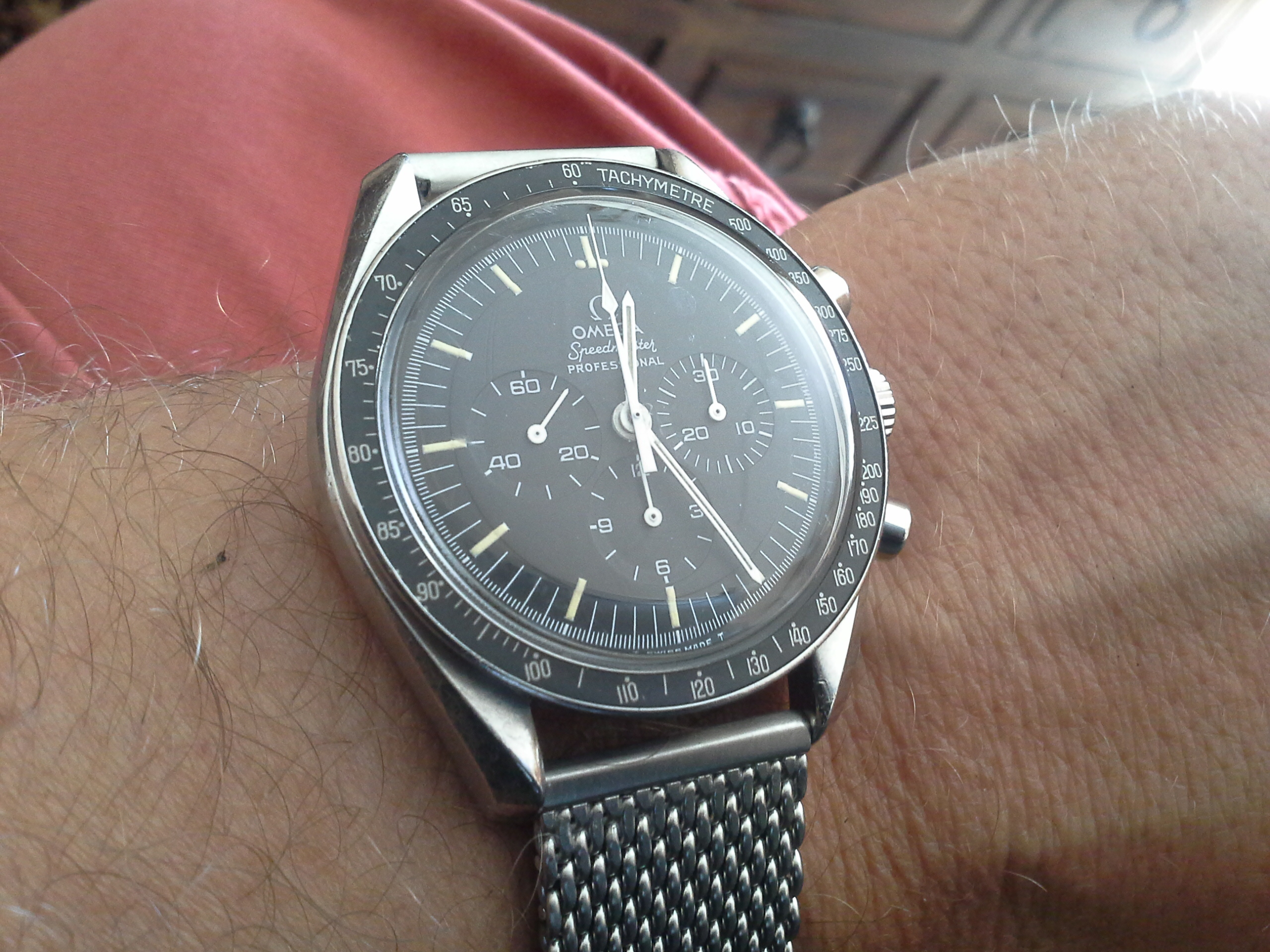

As I understand it a couple of relatively easy things to look for on an original -74 are seriphs on the bezel 7s (edit: which you correctly spotted) and the mid-sized S in Speedmaster (not as tall as that which immediately followed - like the one you linked to - but not as squat as the most recent version). Pics from my -74 below.

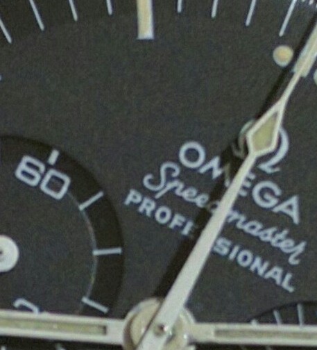

Easy a 74 should have the short S that does not drop down to the bottom of the P. The R should have a drop on the tail. It's unique in domed dials only on 74 and some 76's. A 74 could have a step dial. Basically they have the step dial font on Speedmaster on a domed dial. The picture is my 76 with the early 76 -74 dial. Sourced from @abrod520 actually. The bezel looks great in person that's just a high contrast shot...
The linked watch presents well but the 76 and later dial and wrong Bezel hurts value. The 74 dial has potential to become collectible as it's a rare dial variation. Personally a 74 without it is worthless. I've got a feeling it was serviced in the 80's and acquired that dial and bezel.

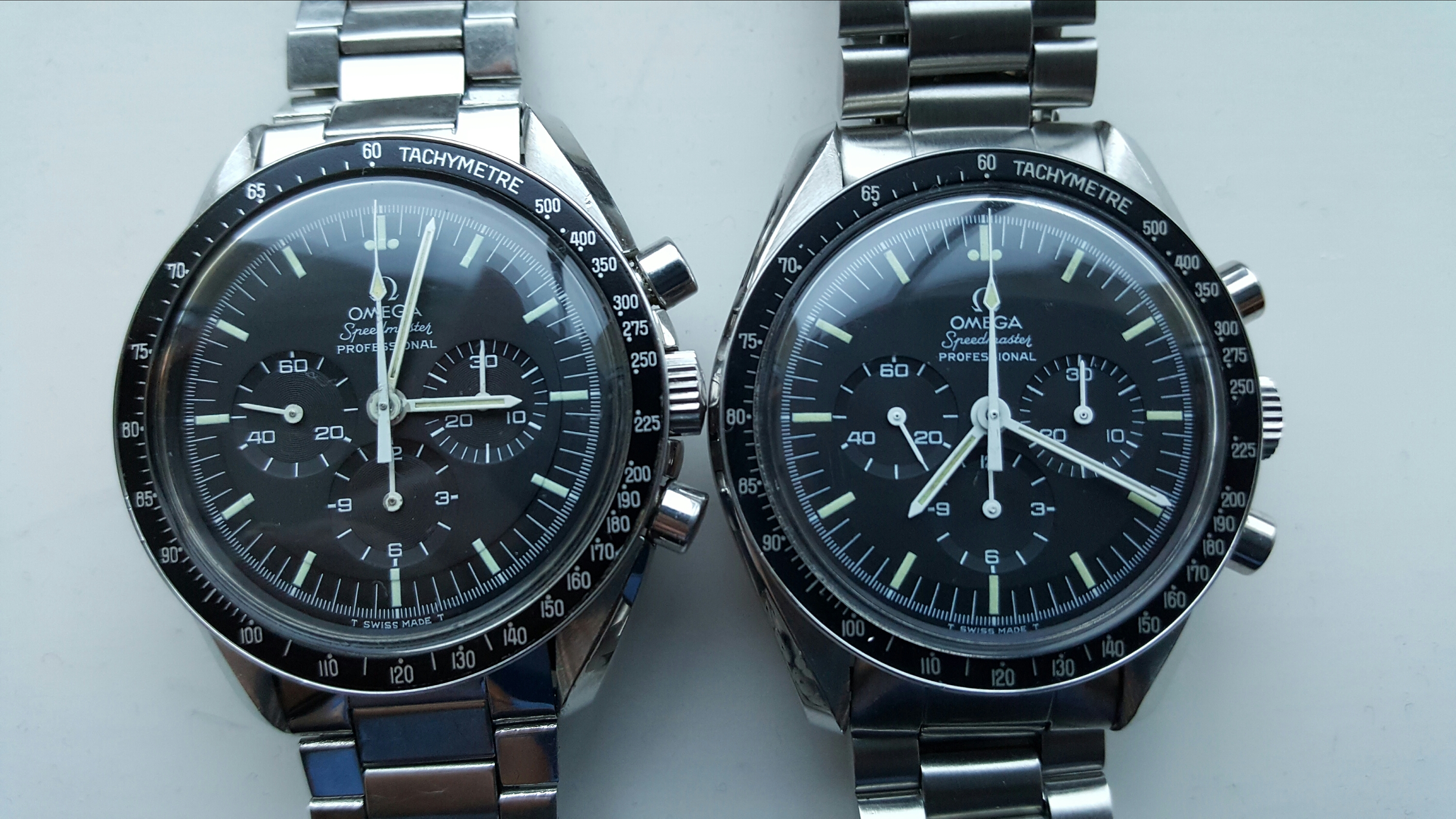

I have not seen a 74 with a step dial but agree with everything else from @Foo2rama
Here is a 71 and 74 side by side. Only difference the step dial.

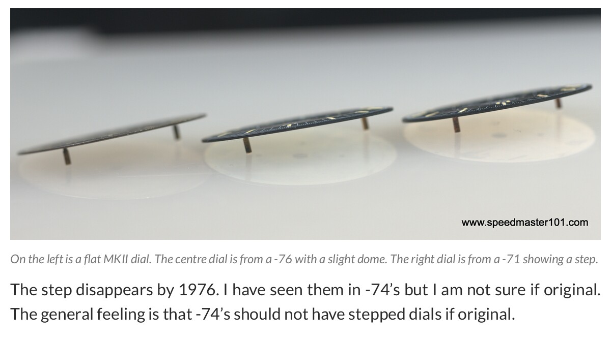

Interesting! So Speedmaster101 has the following to say on the topic of stepped dials on 74s ...
It strikes me as unusual in the watch game - particularly when it comes to vintage Speedmasters - to have such ambiguity around such a relatively major difference. "General feeling"? Do watch collectors even have feelings? 馃槈

I was a bit guarded in my response when I stated " a -74 could have a stepped dial"
The stepped dial -74 is a little up in the air, there are some examples on the forum, and logic would dictate that an earlier dial would not be placed on a -74 at a later date with no 76's showing up with a step. If step dials where retroactively applied to -74 you would assume an almost equal number of -76 would also have this modification. I am no where as big of an expert on these as many of the people on this forum are, but I would accept a -74 with the stepped dial the same way I would take a -76 with the shorter "S" in Speedmaster. It just makes little sense that both of these variations show up in small numbers but are not found in later references. IE no 76 with a step, or a 78 with the earlier Logo. Logic dictates that they are carry over from the previous reference.

I'd say -74s with stepped dials are like 145.012s with flat end chrono hands. Supposedly they could have been produced as such, but are so rarely seen and impossible to verify that I would rather stick with what's known to be correct.

I think it is preferred if it is original, but the consensus is that a step dial may or may not be original to a 74. Doesn't mean it couldn't be original, just that it would be hard to verify. That's my understanding anyways...
