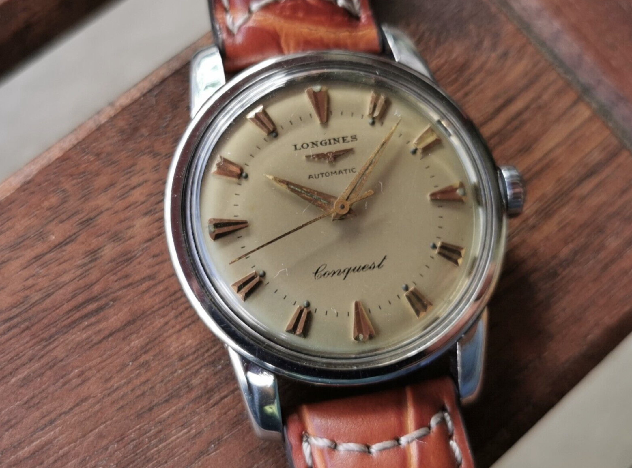

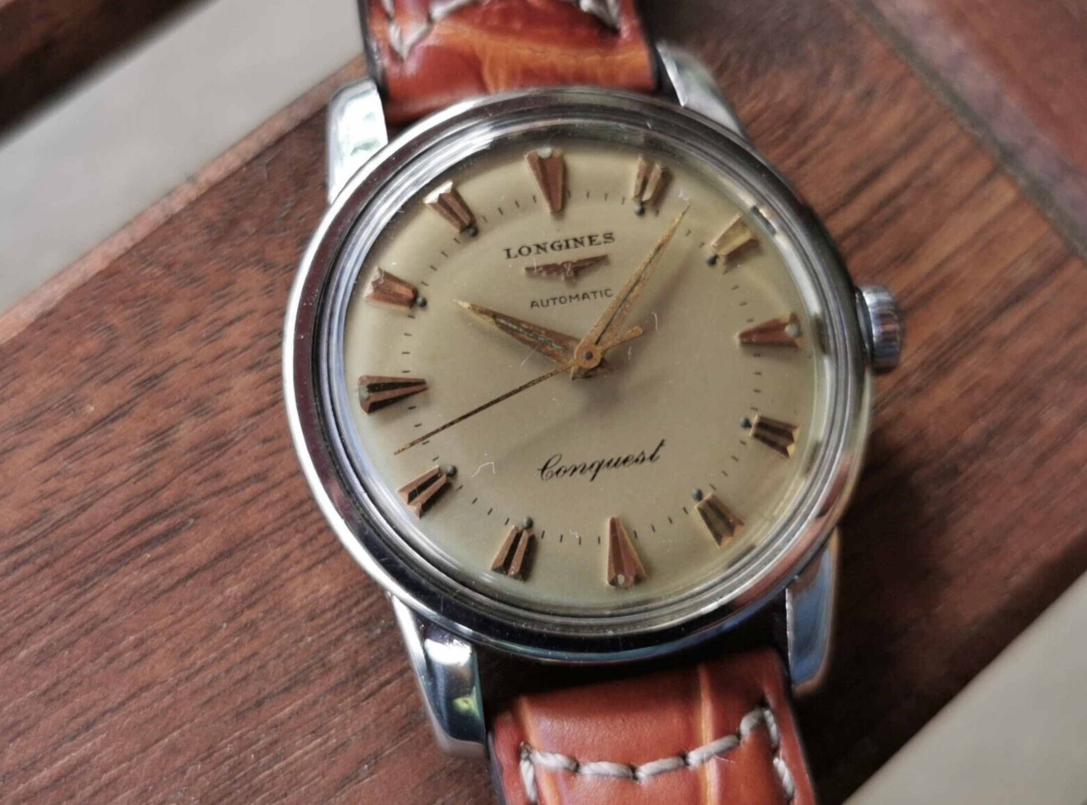

I am in the early stages of researching, prior to hopefully finding, a 9000 Conquest. This particular watch has attracted my attention. It is described as a 9000-5 dated between 1953 and 1955. I cannot find pictures of another Conquest online which uses the same font for the word 'Automatic' that this one does. This makes me think that perhaps the dial has been restored, or the watch has been redialled. But I don't know enough about Longines to be sure. I feel sure that there is someone here who has seen something similar and can share their knowledge with me...

I don't like the dial or the case. Wrong font as noted, missing SWISS, lume dots instead of rectangles. Overpolished lugs as well.

No me gusta del todo... I concur with the above

That dial is not original. See the one below for comparison.
