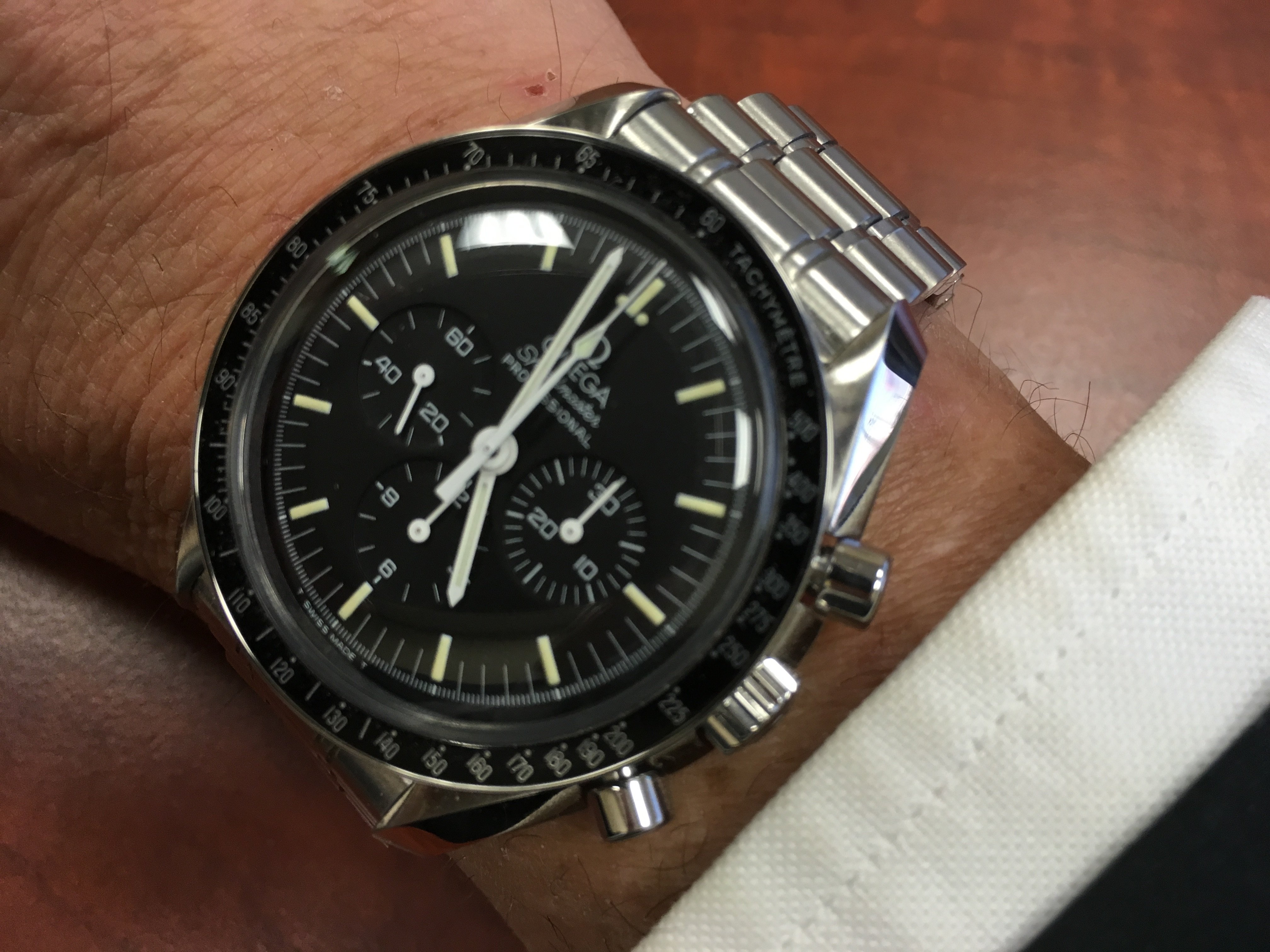

  9. Shailor Jan 17, 2018
    415
    480
    Every time I wind my Speedmaster, I rekindle my relationship with an old friend.
