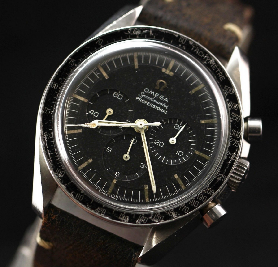

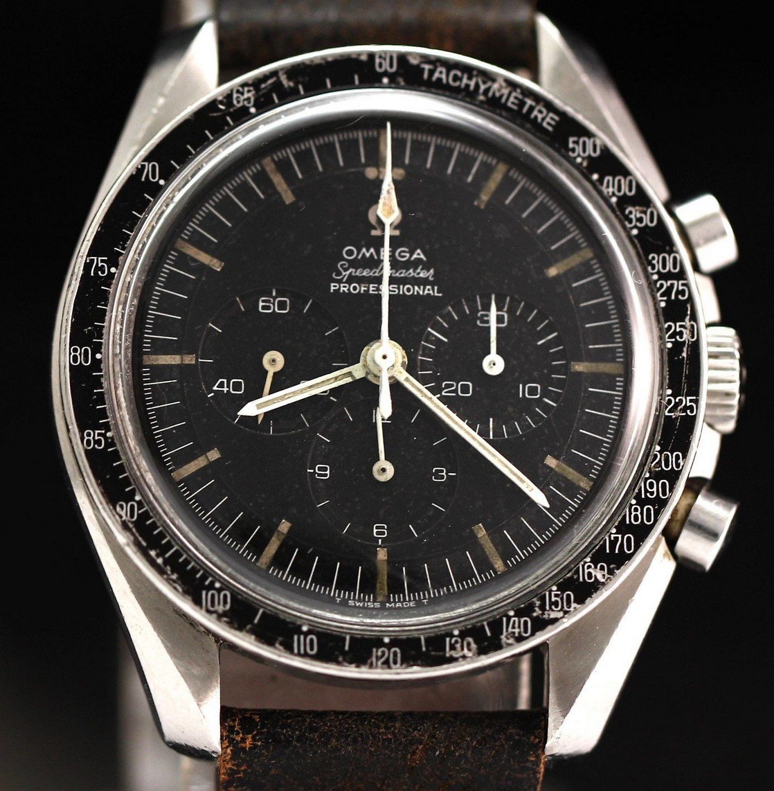

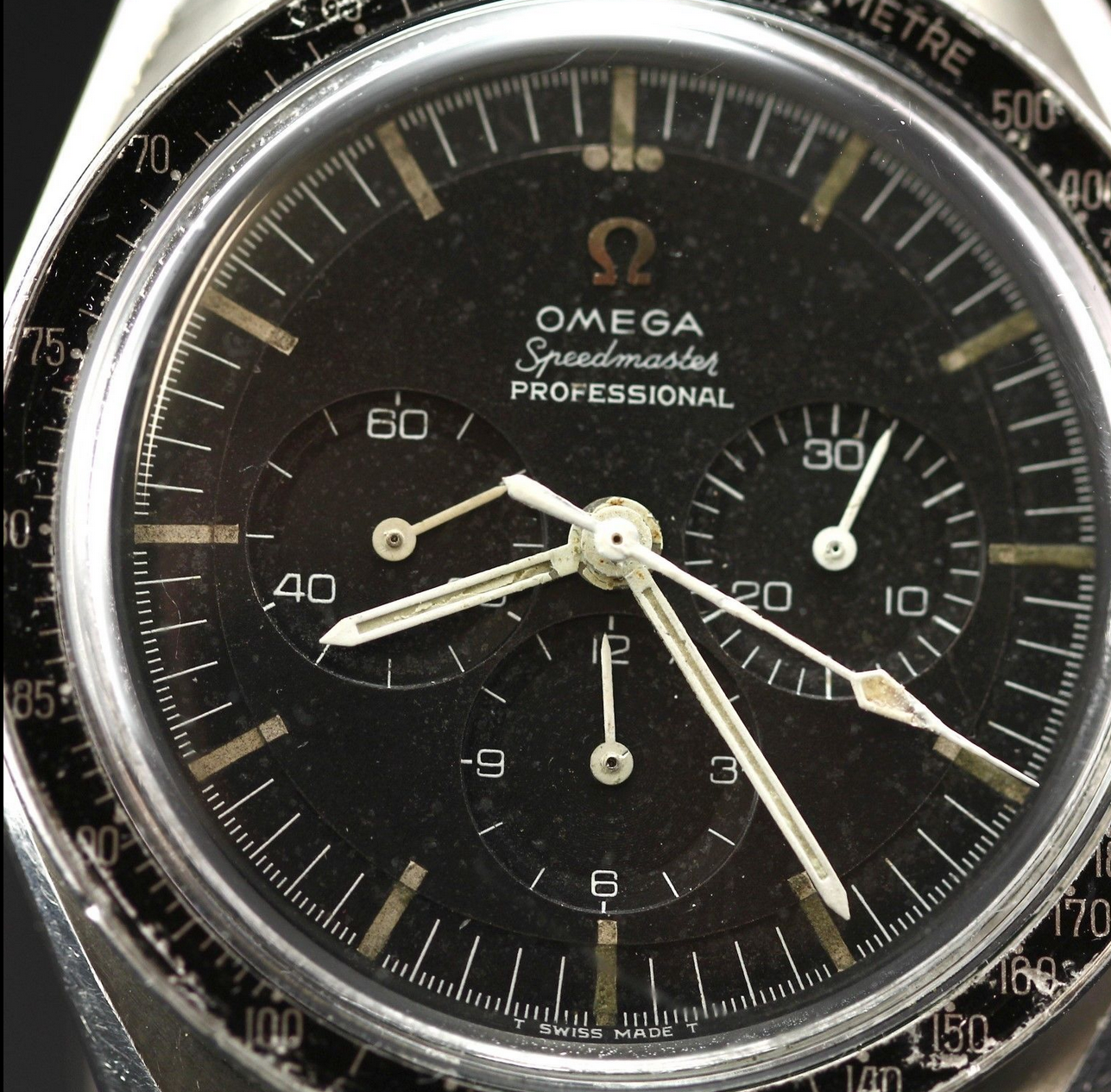

    New to the forum. Curious how you guys would rate the condition of this speedmaster? Poor-Running?

  2. oddboy Zero to Grail+2998 In Six Months Feb 15, 2018
    9,217
    23,880
    Is the watch running? If so, it's better than poor.
    Hard to tell about condition in these pics. Appears to be some spotting on the dial which often means water damage. Is it a 105.012-65?
    Dial is not super great, but looks OK from afar. Case looks OK, but the pics are taken to accentuate the edges. Pushers are obviously different. DON is better than many, but not great
    As always, depends on price and whether it calls to you.
    For me, somewhere just above running, maybe 6.5k or so by The Chart.

  3. sjg22 Feb 15, 2018
    879
    2,880
    - correct DON bezel (ok condition, not great but we’ve seen much much worse here)
    - hands look to be correct and in good condition and pleasantly patinated to my eyes (although we’d need a photo of the reference number inside the case back to be 100% sure)
    - case: I see a few dings but it’s an old watch( it looks like it might be sharp but it could be the light so we’d need better photos in more natural light from multiple angles and a photo of the caseback as well.
    - correctness of pushers and crown would need reference number to confirm.
    - dial..... dial plots have algae coloration, suggesting to me that moisture has been inside the watch. Furthermore, difference in patina colourarion between the hands and plots - although they simply could’ve reacted differently to moisture (or hands were replaced or relumed). Dial seems correct (although we’d need the reference to confirm 100%). Finally, it looks like it has spots (again likely due to moisture incursion. I’d give the dial a “C”.
    - movement - it’s a 321. It almost certainly has seen moisture in the case. That said, likely nothing that a $500+ service couldn’t fix...
    Overall, not “poor” because all the components are there and most look to be in reasonable-to-pretty-good shape.
    I would say “Running+”, although I’d want more case photos.

  6. Davidt Feb 16, 2018
    10,397
    18,064
    I agree with the posts above but would add that the bezel looks dirty around the inner edge, so a clean would improve it significantly.
    The dial is the issue for me. Just not attractive.

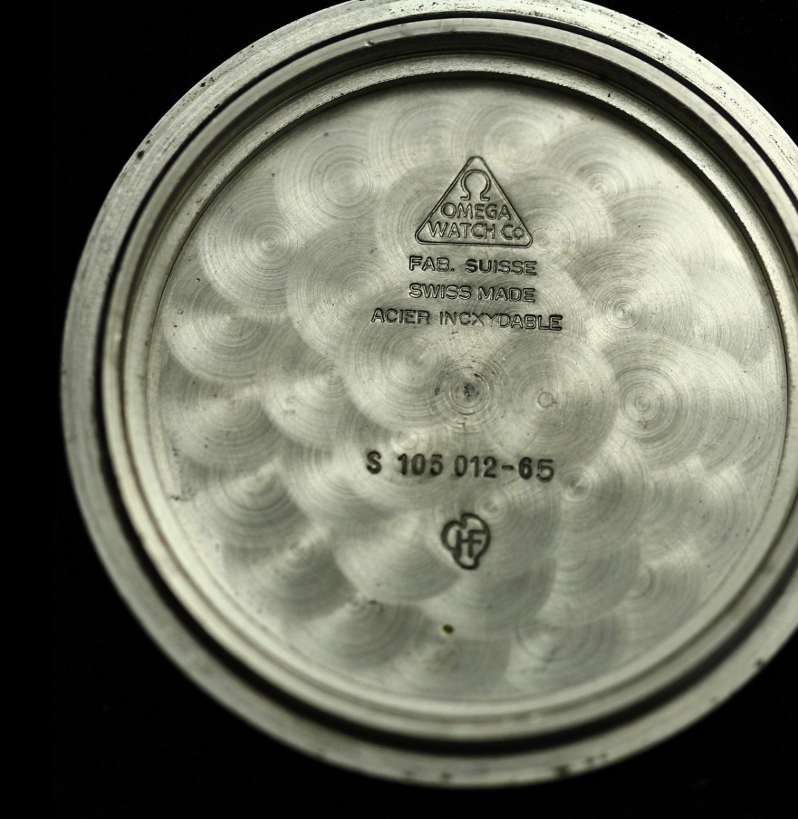

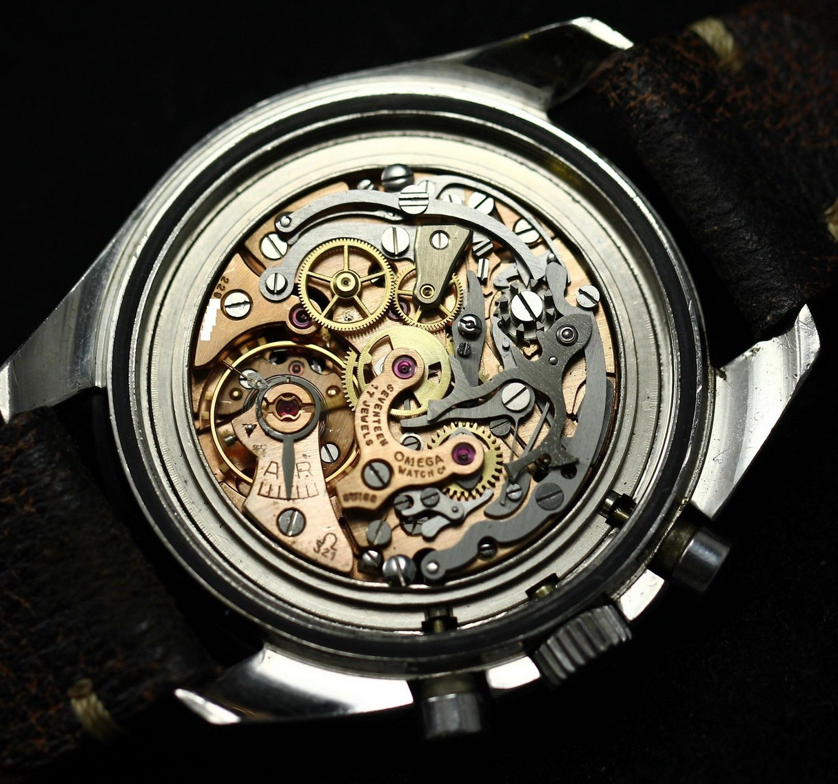

  8. hokenstien Feb 16, 2018
    Thanks everyone.
    Yes, a 105.012-65.
    And was thinking those were moisture spots too... wasn't sure how those age, but the movement didn't look like any water damage. The other pics below.

  9. Spacefruit Prolific Speedmaster Hoarder Feb 16, 2018
    5,200
    23,002
    A watch like this has its place. For a price it is a lovely wearable satisfying acquisition.
    It is a watch that sounds better on paper:
    "Original dial, unserviced, DO90 bezel unpoished 105.012-65 speedmaster."
    However the dial is damaged and degraded the plots a miserable colour, the hands look painted, the bezel is fair at best, and the movement will need a service (note the non aligning middle subdial). The case is worn, and there is some engraving on the otherwise good back.
    None of this will prevent enjoyment, and if it brings the price down it will be a rewarding watch to own, as all the pieces are correct.
    Unfortunately I bet this is a dealer watch who just sees the words, not the watch.
